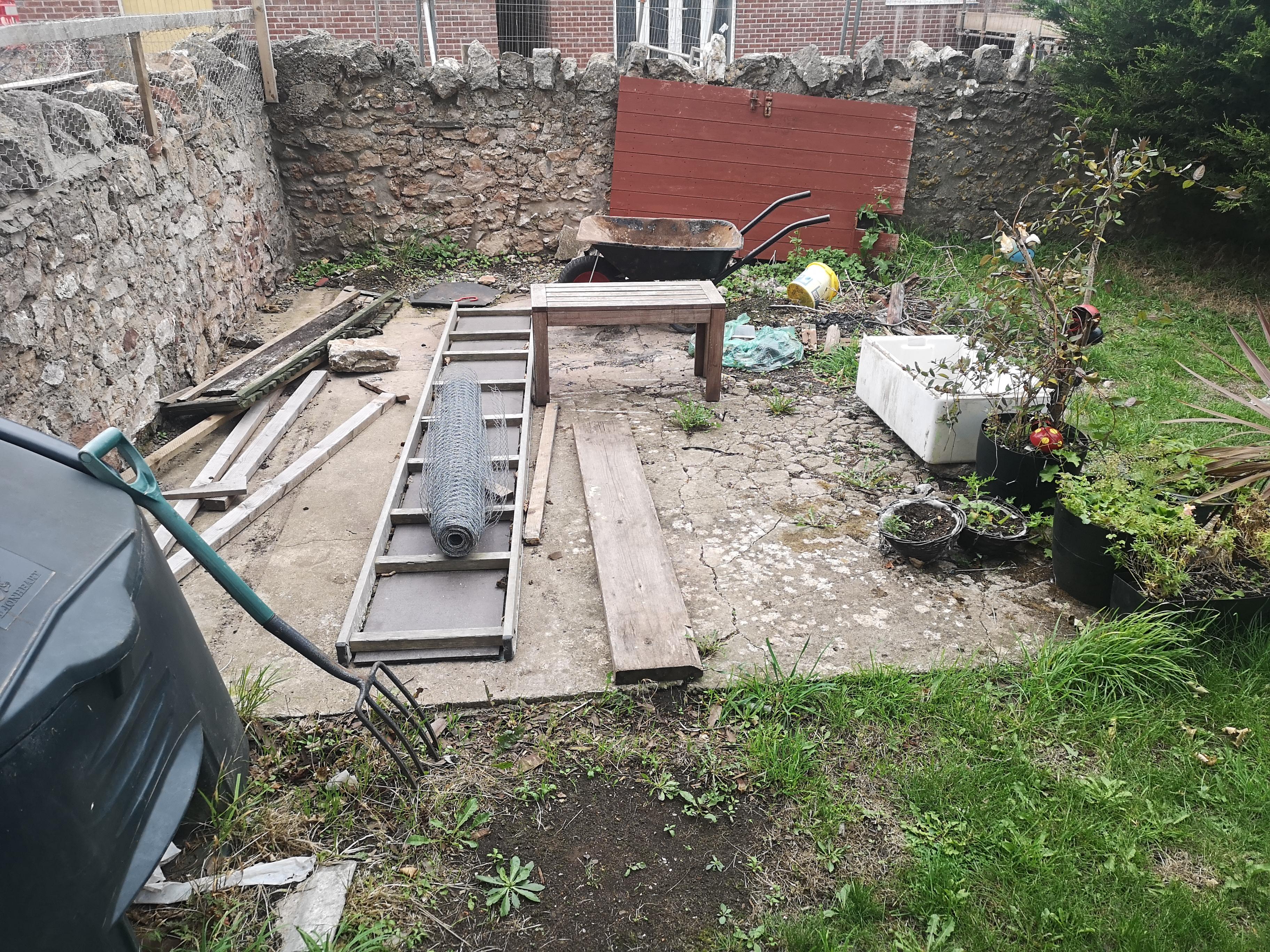

I'm planning to build a concrete block workshop at the end of my garden, replacing a rotten old wooden shed. Although I would consider myself to be more than competent at general building work, I have never built a building from scratch, so would like some advice!
I currently have an old concrete slab which is a bit broken and cracked, but I believe will make a reasonable base to eventually pour my new floor slab on to. (Photo attached) The workshop will be 4m X 4m, with a door on one side and a window to the front, I also want it to have a pitch roof.

You're limited to a ridge height of 2.5m as you are within 1m of a boundary. I think, like mine, you'll be limited to a flat roof. I would be worth digging out the existing concrete and pouring new footings and a slab. An extra weekend of work with a micro digger.

I plan to hire a micro digger to do the footings, Above I see @Conor suggested removing the old slab. There was a few reasons I though it best to keep it there, despite it being a bit cracked and old, I thought it might provide a solid base? Then there is the issue of removing the old concrete waste and having to hire a bigger skip, more cost etc, and where the workshop is being built is at the end of our garden which is quite long, so quite a number of wheelbarrows up and down the garden to remove it all!
However, as I said, I am a novice to this, and if the advice is that it is best to remove the concrete and start again then I will do.
