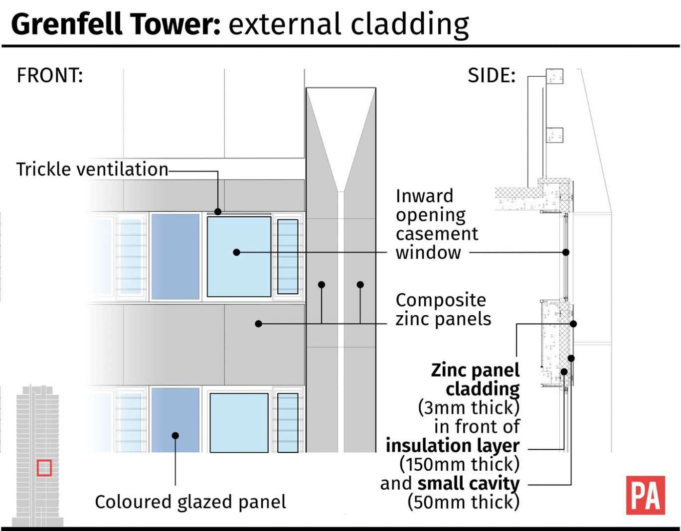

Gone West Posted June 18, 2017 Posted June 18, 2017 AIUI this is the image released by the Press Association which Phillip Hammond is referring to. This shows zinc faced cladding as referenced by @JSHarris earlier in the thread not aluminium. .
Jeremy Harris Posted June 18, 2017 Posted June 18, 2017 Yes, that's the original architects detail (it's where I got it from earlier in this thread). At some point both the cladding specification and the insulation specification seems to have been changed, but that change seems to have been made with approval, as Harley Facades referred to the aluminium composite cladding on their (now deleted) web pages. The aluminium composite rain screen was almost certainly cheaper than the zinc; currently zinc is around $2500/tonne, aluminium alloy around $1500/tonne. In addition, the aluminium composite panels may well have been significantly lighter, so giving an additional possible cost saving on fasteners. I can't believe that the aluminium composite was substituted for the originally specified zinc without some sort of sign off, probably by three or more parties. Whether they considered the altered fire risk I don't know, but from what's been revealed or uncovered so far I doubt they did. 1

Jeremy Harris Posted June 23, 2017 Posted June 23, 2017 (edited) That fits well with everything I've looked at and researched about this fire. There are many issues involved, each of which on its own may not have been a major hazard, but when combined they created what amounted to a "perfect storm". The insulation seems to be Class O rated for spread of fire, making it apparently suitable for use on an external wall of a building with multiple dwellings. The same goes for the aluminium composite panels, they also seem to have a Class O rating. The problems that I've found, just from a few hours of digging around, seem to be: - The insulation fire resistance rating doesn't seem to have taken into account the effect of the ventilation gap, and the consequent chimney created between the insulation and the outer rain screen cladding. - The openings in the building don't seem to have adequate, if any, fire stops, so a fire coming out of a window was able to set light to the material on the outside of the building. - The window surrounds and cills were made from PVC, which may have provided the initial fuel source outside the building that allowed the fire to penetrate to the insulation and cladding system. - The PIR RS5000 foam gives off flammable gases when heated, and when combined with a source of fire that was directed and funnelled up behind the rain screen cladding, this created what amounted to a large blow torch burning upwards, with a very strong updraft from the chimney effect. - Once the fire was established behind the rain screen cladding, the thin inner layer of the rain screen aluminium composite burned away, exposing the normally sealed-in polyethylene foam core. This then added further fuel to the fire, allowing the temperature to increase to the point where the aluminium itself started to burn. - At this point, the fire was probably incapable of being extinguished by any appliances that were available. The fire spread vertically at such a speed that it quickly got above the reach of any appliances. Additionally, once the aluminium was burning the fire would have been hard to suppress with water alone. - The high temperature on the outside of the building breached the windows to the other dwellings, allowing the fire to penetrate inside the building. Apart from the combination of design and material specification failings that created the fire risk, there also seems to have been major failings in the fire safety assessment and planning for the whole building. I can find no reference to any fire risk assessment made after the cladding was fitted (the last is dated 2015, before it was fitted). The building control register shows the status of the building as "Completed, Not Approved". There are several stories from residents of the fire alarms not working. The evidence from escaping residents also indicates that the supposed new smoke clearance system for the stair well failed to operate, as smoke in that area, and on the landings, seems to have been the major cause of loss of life, by stopping people from escaping. The fact that the management company still believed that the building was "fire proof", and that they were still giving advice to residents to stay in their flats, shows that there was a major failure to properly assess the changed fire risk. All told, there seems to have been criminal negligence, by several responsible parties, as this was far from being an unknown risk - there have been many facade fires over the past few years, enough for anyone undertaking a project like this to have had the external fire risk near the very top of their risk register. Edited June 23, 2017 by JSHarris 1

Jeremy Harris Posted June 23, 2017 Posted June 23, 2017 (edited) It seems likely that there would already have been an air handling unit in the roof top plant room, and that may have been modified as a part of the refurbishment, but with no indication of this on the planning drawings, as these only show the new ASHPs on the roof. The refurbishment wasn't carried out fully in accordance with the planning drawings, either, the cladding material was changed from zinc to aluminium and some minor details seem to have been changed, perhaps as non-material changes. Edited June 23, 2017 by JSHarris
