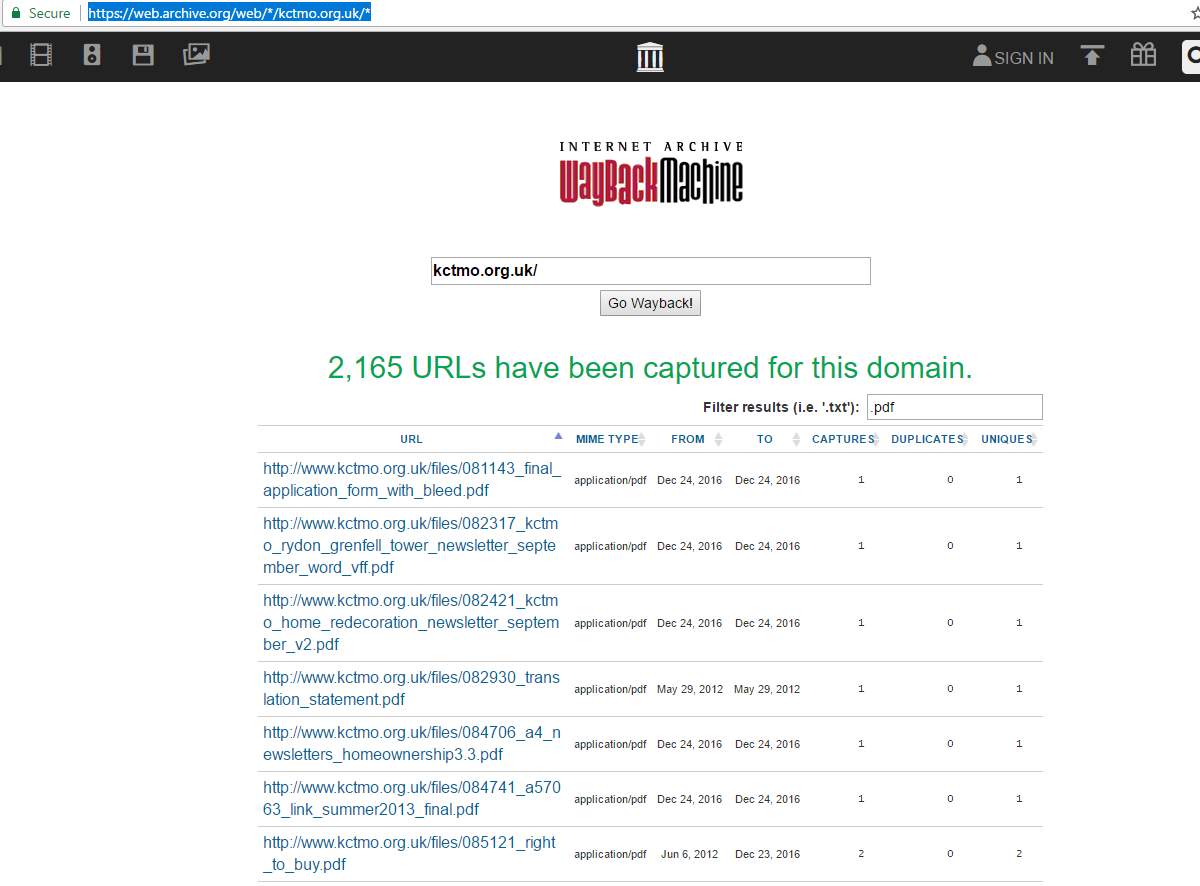

Are you using the Wayback Machine?
Spidering kctmo since  2002, and presumably most of the others.
https://web.archive.org/web/*/http://www.kctmo.org.uk
Edited by Ferdinand

Yes, I've been searching the Wayback Machine, the problem is finding the original deleted page URLs, as searching the Wayback Machine without them isn't that easy, as some of the pages don't have a "friendly" URL.
I've copied a lot of the original pages from KCTMO, Harley Facades and Rydon, plus a few news sites that had reported on this project.
As an interesting aside, the project manager for this project seems to have no internet presence at all now, which seems odd.  It's pretty much mandatory that major public sector projects are managed in accordance with PRINCE2, and that the project manager for this project should have been a PRINCE2 Practitioner, and I'd have expected them to have passed either IPMA Level C or Level B (I had to have IPMA Level A to manage a £200M construction project).  The majority of those working in non-sensitive areas, including local government and its associated bodies, have some form of public profile, via Linked In or whatever, yet I can't find anything at all about the qualifications and experience of the project manager who will have been responsible for many of the key decisions in this refurbishment.  Not sure what conclusion to draw from this, but the most obvious may be that the project manager wasn't formally qualified - that would fit with my limited experience of local authorities..............
Edited by JSHarris
If you go into the "summary" option, and list the urls, you can then filter by type.
eg list of urls
https://web.archive.org/web/*/kctmo.org.uk/*
That would let you zero in on eg all the newsletters.
filter by *.pdf
Hope that helps for your searching rather than repeating things you know and are doing.
Best of luck anyway.
Ferdinand

Thanks, @Ferdinand, the KCTMO info isn't to hard to find, it's mainly other stuff, like the information from suppliers and main contractors that's a bit of a challenge.  Some of the sites had rather un-friendly URLS, often just a sort of random string of alphanumerics, making finding a particular topic or subject a bit challenging.
You can do the same for any site, and hopefully the technique transfers and there are a small enough list of urls of each type to spelunk through.
