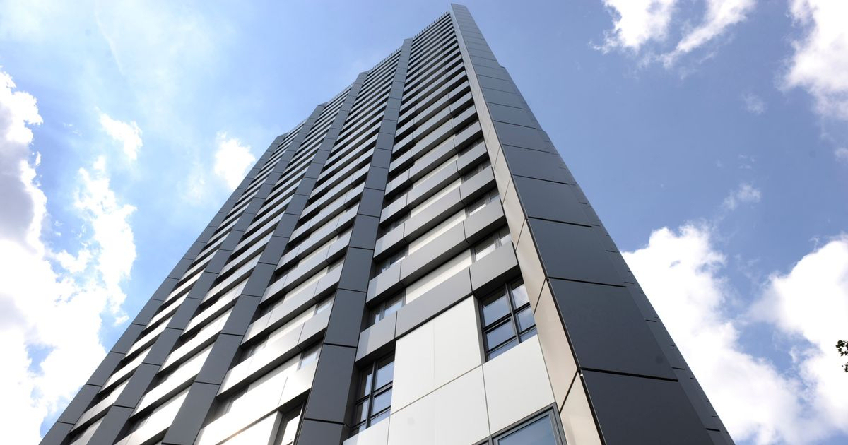

Ian Posted June 15, 2017 Posted June 15, 2017 @JSHarris its now being widely reported that the overcladding system comprised Reynobond aluminium rain screen (the version with a polyethylene core); a 50mm ventilation gap and Celotex FR 5000 insulation
Jeremy Harris Posted June 15, 2017 Posted June 15, 2017 (edited) @Ian, Thanks, I think that, if true, then that would have been a lethal combination. In particular, there has been wide publicity of the risks of having an air gap with flammable EWI, because it massively increases the oxygen supply, from chimney effect, and accelerates the vertical spread of fire. However, there should have been fire barriers to reduce the risk of vertical spread, as this was identified as a problem several years ago. Looking at the remains of the building, and the photos of the fire in it's relatively early stages, when it was confined to one corner, there is no indication at all of any fire barriers being effective. If there had been, then I would have expected there to be some indication that the vertical spread was being restrained, with the fire spreading out horizontally below the fire barriers, but it looks like the initial fire just went straight up to the top of the building, relatively unrestrained. Edited to add: I've just found a good photo of the exterior of the building, before the fire, that shows the cladding, with the air gap between it and the EWI behind fairly visible, and no indication of any fire stops running across the clad areas at the corner: Edited June 15, 2017 by JSHarris

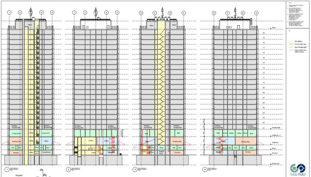

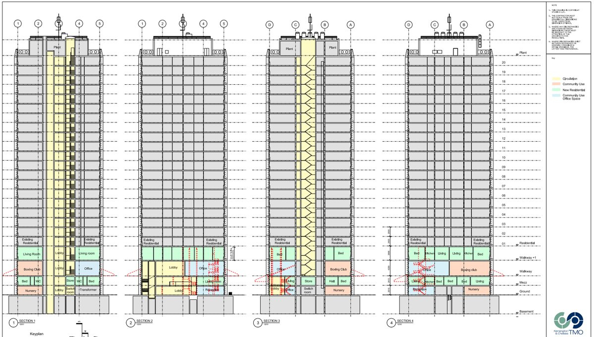

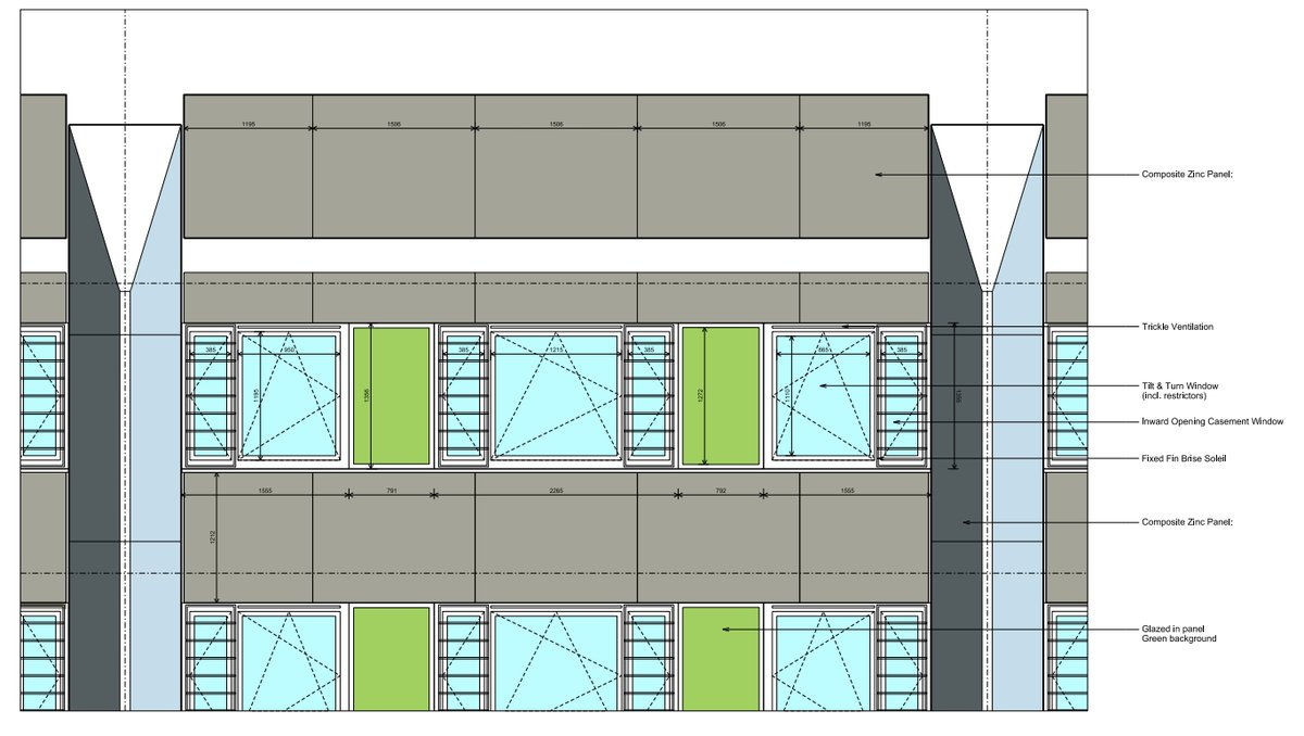

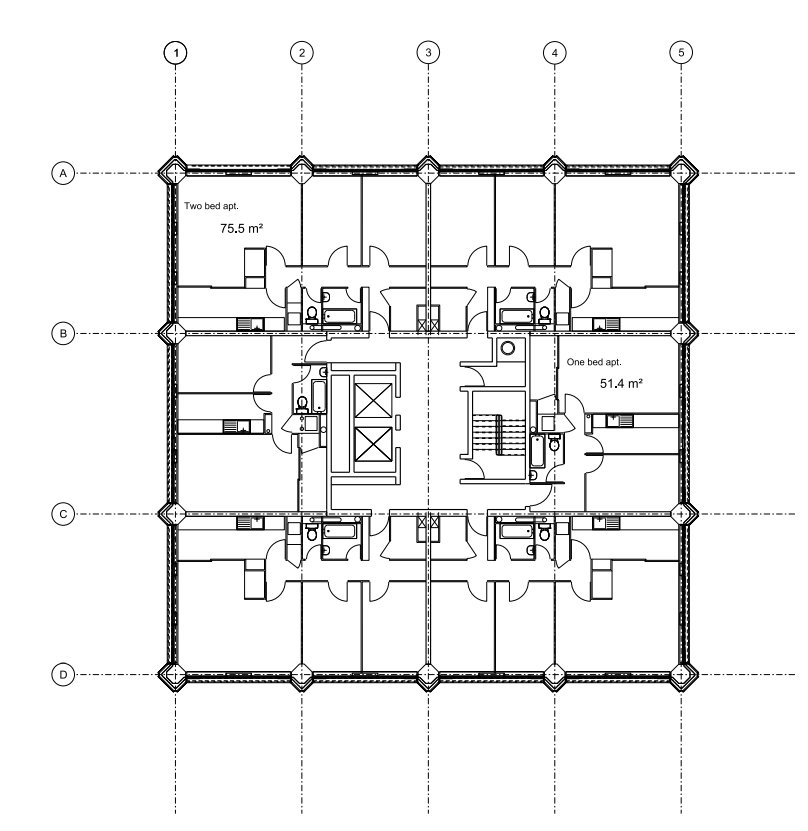

Jeremy Harris Posted June 15, 2017 Posted June 15, 2017 (edited) I've just found the plans for the renovation of Grenfell Tower, that give more detail on the materials used and the design of the building. First off, it seems that the cladding was zinc composite panels, rather than aluminium, as widely reported, and so the fire risk from the cladding itself was lower. However, zinc fires should not be tackled with water, as that can accelerate the fire. The problem with the single, narrow staircase is apparent from this plan section of the building. With the lifts automatically out of action in a fire, the escape route for several hundred residents, and the entry route for firefighters, must have been a nightmare: Finally, here are the elevation drawings of the renovated tower block: Finally, a video of the fire, around an hour after it started, that shows just how absolutely horrific it was. Do not watch this if you're faint hearted, as it's pretty distressing: https://www.pscp.tv/w/1RDGlZqozBDxL Edited June 15, 2017 by JSHarris

Jeremy Harris Posted June 15, 2017 Posted June 15, 2017 Thanks @ADLIan, that confirms part of what seems to be on the plans, but conflicts with part of it, too. The plans say the outer cladding is zinc, yet there are several reports that it is composite aluminium. Given that there is a significant cost difference between zinc and aluminium, with aluminium generally being cheaper and lighter (which may have had an impact of the cost of fixings) I wonder if the plans were amended at some point to change the cladding material from the less flammable zinc that was specified, to the more flammable aluminium composite? Looking at the fire, it has all the hallmarks of a burning aluminium fire, so I'm inclined to think that there was a switch from the originally specified zinc to aluminium. If this is the case, I wonder if the change to the fire rating was taken into account? I think the simple answer is that, even it it was, then there were some very serious errors of judgement by whoever made this decision. The original design with the zinc cladding and air gap over the EWI was bloody awful, but changing that outer skin to aluminium composite seems downright criminal. This is not a view with the benefit of hindsight; the high fire risk of having an air gap over flammable EWI has been well understood for many years.
jack Posted June 15, 2017 Posted June 15, 2017 It will be interesting to see whether aluminium was used to replace the approved zinc without approval.
