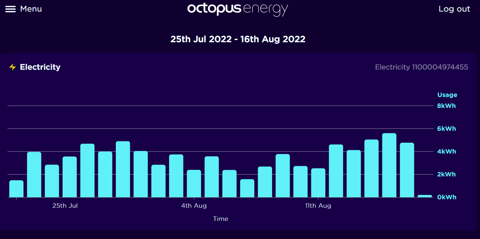

Ferdinand Posted August 17, 2022 Share Posted August 17, 2022 Just having looked at my Octopus, it says I am using between 2 and 5 kWh of leccy per day. Family of one. 200 sqm house. 10kWp solar, which faces 80% E 20% W and is filthy. Away for night of 6/7 Aug, and less sun the last few days. 1 shower per day, usually gas. The Smart Meter app has not detected the gas yet, but I read the meter just for you and it says I have used 1.714 m3 in 3 weeks, which is around 0.7 kWh per day. It was installed and zeroed on July 25th (says the label). Link to comment Share on other sites More sharing options...

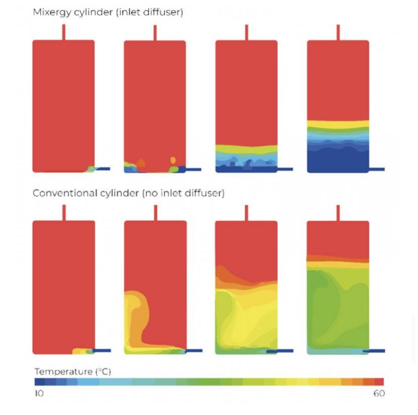

SteamyTea Posted August 17, 2022 Share Posted August 17, 2022 4 hours ago, Adsibob said: my understanding is that by taking temperature readings at different locations within the cylinder (at two or three different heights) it can work out how much hot water is in the cylinder). This is one of its features (and probably the most useful). It would have to settle for at least half an hour before the readings have any value assuming it is heated from the base. Link to comment Share on other sites More sharing options...
Ferdinand Posted August 17, 2022 Share Posted August 17, 2022 1 hour ago, Ferdinand said: Just having looked at my Octopus, it says I am using between 2 and 5 kWh of leccy per day. Family of one. 200 sqm house. 10kWp solar, which faces 80% E 20% W and is filthy. Away for night of 6/7 Aug, and less sun the last few days. 1 shower per day, usually gas. The Smart Meter app has not detected the gas yet, but I read the meter just for you and it says I have used 1.714 m3 in 3 weeks, which is around 0.7 kWh per day. It was installed and zeroed on July 25th (says the label). To wrap up, the electric meter is telling me that I have imported 83 kWh and exported 283kWh in the same 3.5 weeks. I am switching to Octopus Outgoing Agile tariff, as I will make some more export payments. Link to comment Share on other sites More sharing options...
Adsibob Posted August 17, 2022 Author Share Posted August 17, 2022 1 hour ago, SteamyTea said: It would have to settle for at least half an hour before the readings have any value assuming it is heated from the base. I think it has a diffuser to stop that being a problem: I also heard somewhere that the sensors take temperature readings pretty regularly and then use a clever algorithm to model what is the most likely amount of hot water left in the tank is. That figure outputs as an approximate value, something like a percentage to the nearest 5% or 10%. I believe @joth, @Robert Clark and possibly @Dan F have one (or at least did a lot of research into them. Hopefully one of them followed through with their purchase and can give us all their review. Link to comment Share on other sites More sharing options...

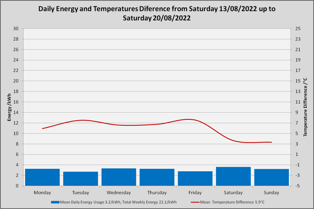

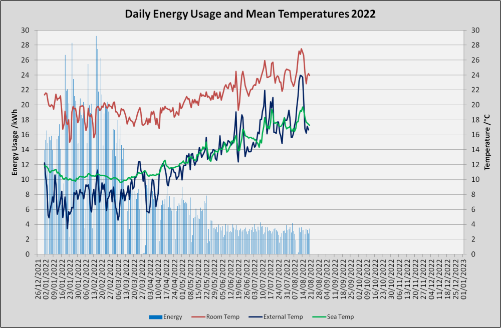

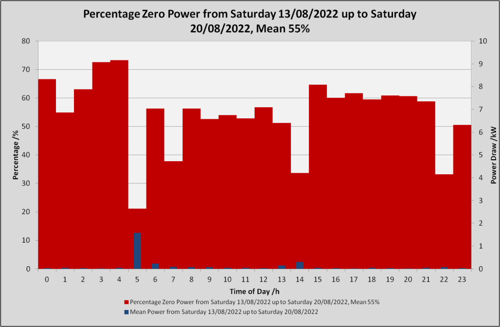

SteamyTea Posted August 17, 2022 Share Posted August 17, 2022 Back to summer energy usage. Last week I used a total of 14.7 kWh (a new record low for me) 68% of that was at night on E7 (so mainly water heating and the washing machine). From the 1st May to 1st August I used 359 kWh, so 3.9 kWh/day. I cannot remember when I put my new imersion heater timer on, I think it was about 15th May. Just had a look after tha date til beginning of August and my daily usage is 3.5 kWh, so a 0.4 kWh/day saving on DHW. 8p/day. Saved £6.25, or close to half the price of the timer. Result. Link to comment Share on other sites More sharing options...
Adsibob Posted August 17, 2022 Author Share Posted August 17, 2022 4 minutes ago, SteamyTea said: Back to summer energy usage. Last week I used a total of 14.7 kWh (a new record low for me) 68% of that was at night on E7 (so mainly water heating and the washing machine). From the 1st May to 1st August I used 359 kWh, so 3.9 kWh/day. I cannot remember when I put my new imersion heater timer on, I think it was about 15th May. Just had a look after tha date til beginning of August and my daily usage is 3.5 kWh, so a 0.4 kWh/day saving on DHW. 8p/day. Saved £6.25, or close to half the price of the timer. Result. Wow, that does seem low. What’s your home situation, do you live alone or with others? Link to comment Share on other sites More sharing options...
SteamyTea Posted August 17, 2022 Share Posted August 17, 2022 (edited) 12 minutes ago, Adsibob said: Wow, that does seem low. What’s your home situation, do you live alone or with others? I live alone. I did have a lodger once, and once I had beaten her into submission, the annual usage was around 5 MWh, lat year I think I got it down to around 4 MWh. So far this year (228 days) I havve used 1892 kWh, which is better than I imagined. I also don't live in the cold, and now I have removated my back door, I should save a bit there (had a 6mm gap and the bottom and the seal had totally failled. I do try and think about what I am doing, so no use of a tumble dryer, I use a clothes line, not much oven usage, induction hob, cook twice as much paster and sauce as I need, then either 2 minutes mircrowave or eat it cold. I wish my car usage was the same, last week I used arround 270 kWh of deisel to travel 320 miles. Cost 50 quid. At least this month I am not travelling the 600 extra miles to see my Mother every weekend. Edited August 17, 2022 by SteamyTea 1 Link to comment Share on other sites More sharing options...

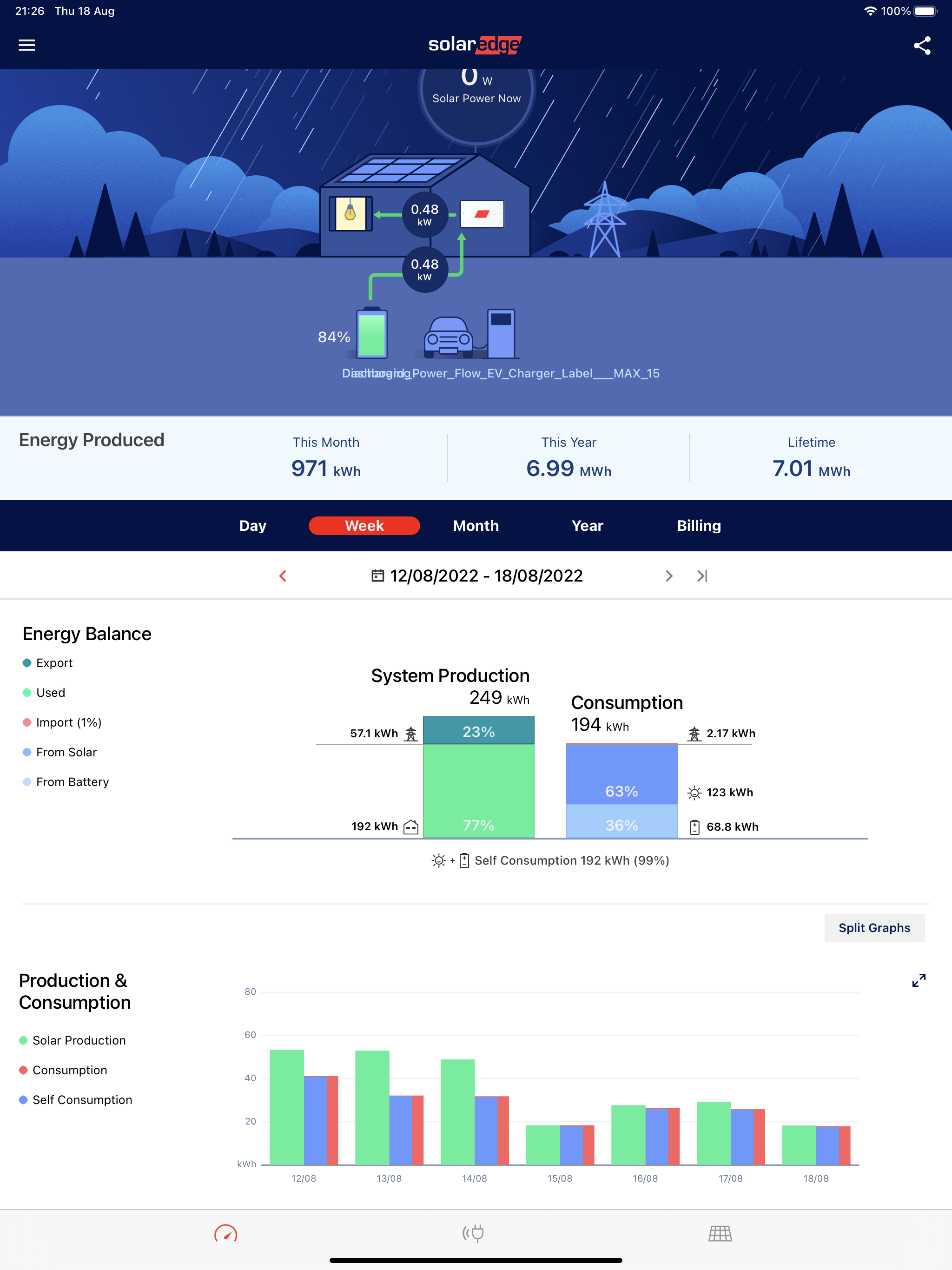

Johnnyt Posted August 18, 2022 Share Posted August 18, 2022 Had my SolarEdge dc coupled battery for a week and temporary immersun dhw divert until SolarEdge unit becomes available. Only 2 kWh import, which is taking up some of the reaction time for the battery I think. Screen shot shows you everything. I’m happy! 1 Link to comment Share on other sites More sharing options...
