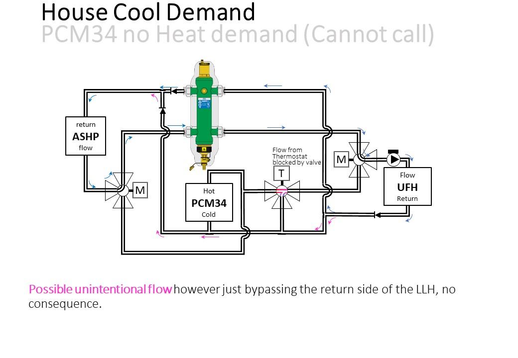

le-cerveau Posted August 5, 2018 Share Posted August 5, 2018 21 minutes ago, volcane said: Is there a way to bypass the Sunamp and have a totally separate circuit to the ASHP specifically to allow cooling. Yes, that is what I have done, though mine are pre UniQ units. I have a Panasonic 9kW Split. 1 Link to comment Share on other sites More sharing options...
Nickfromwales Posted August 5, 2018 Share Posted August 5, 2018 29 minutes ago, volcane said: @Nickfromwales do you know much about this proposed system? Just a bit Ok, cooling first. You either go mono block ASHP and reverse it a-la @JSHarris, or you go for air-con. Simples ( ish ). For one current client we are working with an ASHP + Sunamp solution so they have the ability to cool the ground floor slab. They will also be able to cool individual rooms via fan-coil units wet fed by the ASHP ( with the same cooled water that will circulate the slab in 'cooling mode' ). Pointless fitting air con in a house that'll have an ASHP imo, unless theres no UFH loops of course. I may look at taking chilled water to the MVHR inlet and send that through a duct heater ( cooler ) for maximum cooling effect. As its a bigger than average home the ASHP remains, but it would still have been possible to do away with it TBH if cooling wasn't part of the remit. Having a 'non-optimum' PV array there also reinforced using the ASHP for the primary heat energy source, basically for charging the PCM34's as quickly and cheaply as possible leaving the remainder of PV and grid ( economy ) to top up the PCM58's ( DHW ). 2 hours ago, volcane said: I'm trying to grasp at positives and one is the advance of the Sunamp units available. Well that is a positive as they've come on leaps and bounds. Now very simple units with nowt to go wrong other than a failed immersion which is now a 5 min job to replace. 2 hours ago, volcane said: We should have a near passive house (at least that was the plan but we have no real idea of what we have or what we will end up with, just over 400 sqm, 5 beds). 2 hours ago, volcane said: Sunamp have proposed a UniQ Dual (26 kWh) paired with a 11 kW Daikin split ASHP, with Economy 7. Which exact (e)Dual units? PCM34 or PCM58 or mix of the two? With an ASHP I assume they're suggesting 2 units to get to the 26kW, ( 2x 'size12' units which will store an average of 26kW actual useful heat energy at peak charge state ), which would give you a decent chunk of cold mains uplift ( to 30oC ) and then into the PCM58 for DHW, which will then have extended capacity due to reduced duty. 2 hours ago, volcane said: I need to be able to supply 5 bathrooms (5 showers, 1 bath) with a request to never run out of hot water! And heres the 'gotcha'. Does that mean 5 staggered showers, or 2 - 3 running simultaneously / 1-2 showers plus a bath filling etc? A huge question but needs answering before even getting within a mile of choosing an end solution. You have to remember that a SA is an instantaneous water heater, just like a combi boiler, so the faster the water flows through it the cooler the flow can become. An UVC for eg will give you full wallop and empty all of its guts out in a very short space of time, AT FULL STORED TEMP, but will then just go stone cold and then need time to recharge before doing the same again. So, for the aforementioned clients SA spec; there will be a pair of smaller PCM58's ( 2x 'size 6' units to get near the required 12-14kWh required for DHW ) specifically being done to get the 2 pairs of DHW heat exchangers inline with the DHW max flow rate requirements. So ( rough figures for eg ) 1x 30 l/p/m flow rate through one SA unit = 60 l/p/m through two units in parallel. More if preheated. That incurs additional capital expenditure so the pros and cons need weighing up. You do not get higher flow rates with bigger unit sizes as they all share the same H-Ex afaik. I'm still getting info through on these so I can update as I go along. A single SA H-Ex will happily run 2 high-flow showers or 3 average showers simultaneously but thats about it. After that you'll need to look at pre-heat. That would then allow you to use a 4th shower alongside the other three. From there you'd then be looking at multiples of SA units to get the flow rates up higher and then onto additional preheat to go crazy. Yes it makes my head hurt too! With an ASHP + PH you'll need to go to a DHW priority setup which allows the ASHP to fully recharge the 34's before allowing space heating to continue to draw heat, that way the DHW system will be fortified for pre-heat by the HP, and the DHW can either be maintained by PV, or if the 58's call for help, grid electricity too. That arrangement lends itself to the space heating depleting all of the stored PV before the ASHP has to kick back in again. Hopefully with a correctly sized setup that would be for a good few months of the year. For absolute peak usage, the ASHP AND grid electricity ( via the immersions ) can all join force, for what we refer to as "boost". Space heating is, by contrast, a doddle. One PCM34 will act as a buffer, an option if you only actually want to dump excess PV into space heating. You could just have a cheaper 'eHeat' unit then, ( ASHP on one H-Ex and the space heating on the second H-Ex ) but the eHeat cannot carry potable water for DHW as its not WRAS approved. You can only use an 'eDual' for DHW / DHW uplift as that can carry potable water, but the 'eHeat' isn't WRAS approved so is only good for heating grade water. The eDual is the highest SAP scoring unit too. Design is the key tbh and treble-thinking your requirements is paramount before moving forward. It can be as easy or as complex as your situation commands ! Hope that is of SOME help to you. Link to comment Share on other sites More sharing options...

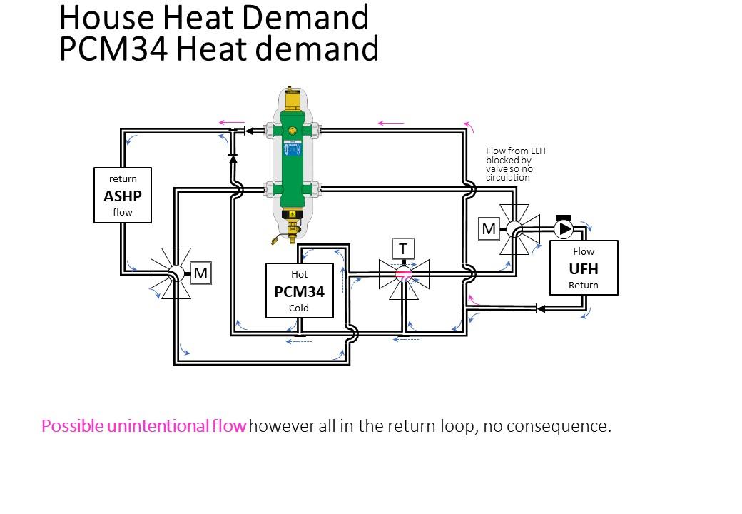

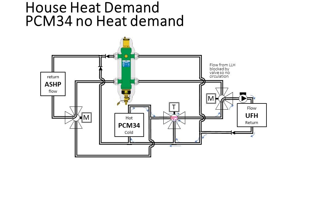

le-cerveau Posted August 6, 2018 Share Posted August 6, 2018 My system is based on the old cells, UniQ equivalent would be 4 x UniQ HW6 (2 with PCM58 and 2 with PCM34). They are wired in Parallel to give higher flow (ie 2 x PCM34 in parallel, followed by 2 x PCM58 in parallel) so parallel (same PCM) and series (PCM34-58). The ASHP heats the PCM34's (low pressure circuit) and the UFH takes heat from the same. The PCM58's are heated by a boiler (may change in due course) (low pressure circuit). DHW is parallel into High pressure circuit (PCM 34) followed by (series) parallel into the 2xPCM58 high pressure circuit. There is a tap off at the interface for the DHW mixing valve to mix the Hot from the PCM58 with warm from PCM34 to give distribution water temperature, also the circulation system returns to this point. We have 5 showers and 2 baths. Though the showers are Hansgrohe ecoflow (9 l/m), we have a Rainmaker Select 460 2 jet with a hand shower and a highflow valve so I can select 2x overhead jets and the hand shower all at 9 l/m each = 27 l/m and the system easily copes (though officially it is a 9 l/m shower). Our house is just over 400m2 and PH standard (not certified). As @Nickfromwales say DHW is the key, heating an aside and just taken from the preheat system. My cooling does work and has been kicking in, though it takes all day for the house to heat up and it is in the evening when cooking that the greatest effect is, cooling then starts to kick in, as night comes in and the outside temp drops the MVHR goes into bypass and helps cool the house down so by morning it was back to normal. I had the cooling set not to come on until above 24 and it would only kick in in the evening when we were all home and cooking. By morning the house would have cooled back to 23ish, mostly based on MVHR bypass as the cooling will shut down below 24 (as currently set). 2 Link to comment Share on other sites More sharing options...
