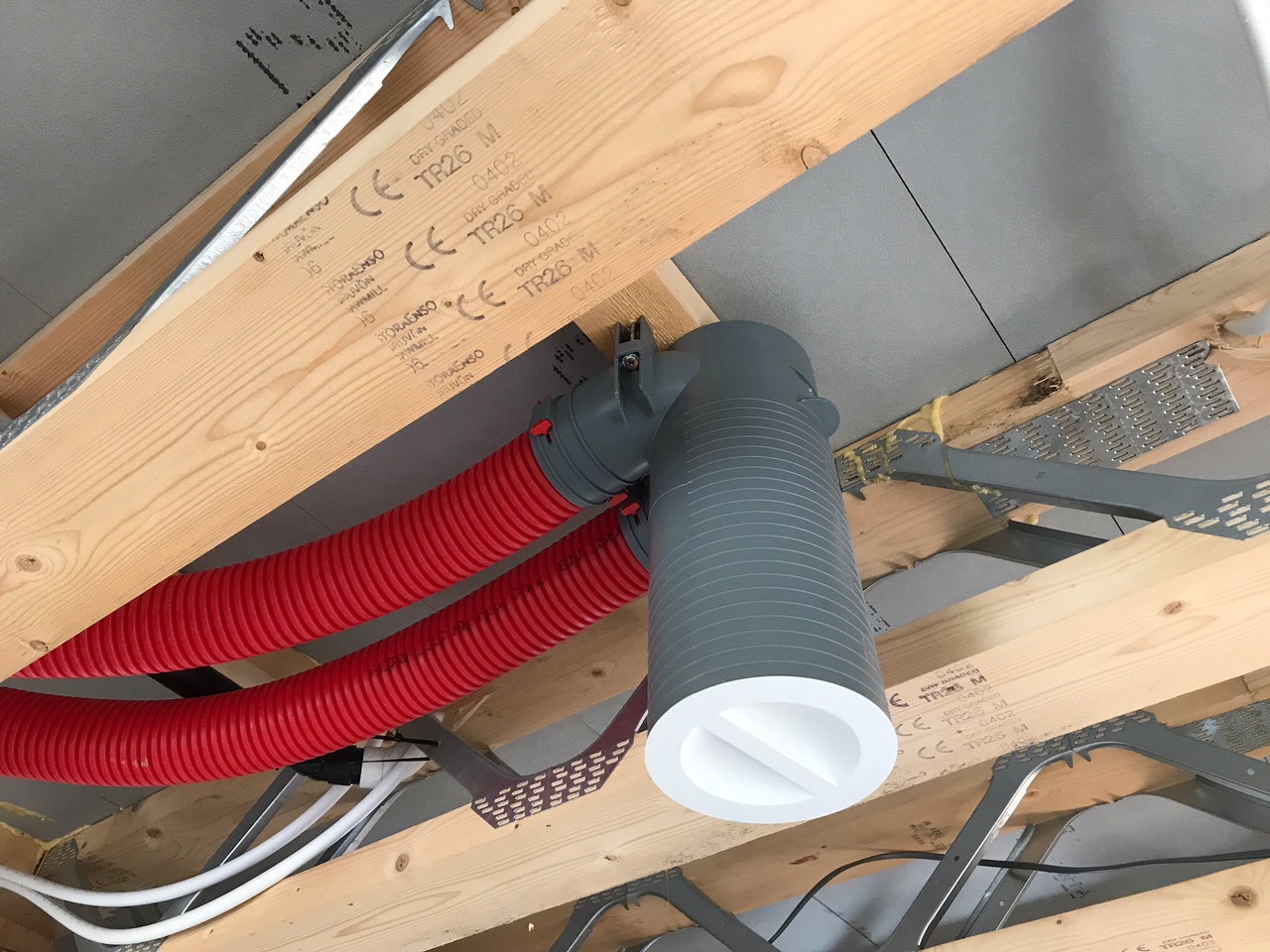

Jeremy Harris Posted June 6, 2017 Share Posted June 6, 2017 Just now, CC45 said: @JSHarris I just followed them. Dont they follow this site? Not an uncommon situation, we all seem to have different terms, I was brought up with gable ends of a house being called pine ends, still find it hard to remember to use gable ends. I appreciate that, but a supplier using incorrect terminology like this just causes confusion. The word plenum, in the context of air handling systems, is well-defined, and has never been applied to a terminal or vent, as fair as I know. Even the disambiguation entry in Wikipedia seems to be clear on this. Link to comment Share on other sites More sharing options...
PeterW Posted June 6, 2017 Share Posted June 6, 2017 Odd one and I agree with @JSHarris - plenum is usually where pipes join although I've seen a Lindab outlet described as an Rectangular Extract Terminal Plenum so I've got no idea now ..!! Link to comment Share on other sites More sharing options...
dpmiller Posted June 7, 2017 Share Posted June 7, 2017 The plenum being referred to here is a two- or three- pipe manifold acting as a header for the terminal. Plenum generally implies a change in dimension or velocity too, in my experience. And that's exactly what these terminal *headers* do- taking a number of pipes and transforming the flow from them in speed, and direction, whilst changing size. A restricted terminal installed on one then offers resistance which brings damping/silencing into it also... Link to comment Share on other sites More sharing options...
Jeremy Harris Posted June 7, 2017 Share Posted June 7, 2017 (edited) I'm pretty sure that what is being referred to here is not a chamber of any sort, but a ceiling terminal. By definition, a plenum is a chamber, it comes from the Latin, plenum spatius, meaning a full space. To refer to an open terminal, that feeds air into or out of a room is wrong and misleading, especially so when there is a long-standing use of the term plenum in ventilation systems to refer to the chamber used to collect the ends of the ducts from each terminal before they are connected to some form of air handling unit. Edited June 7, 2017 by JSHarris Link to comment Share on other sites More sharing options...

RandAbuild Posted June 7, 2017 Share Posted June 7, 2017 Here's how I fixed our terminals - the plasterboard is cut around it, before the pipe is trimmed off prior to skimming. The Airflex stuff from BPC is very good by the way - fits together well and is well made. 3 Link to comment Share on other sites More sharing options...

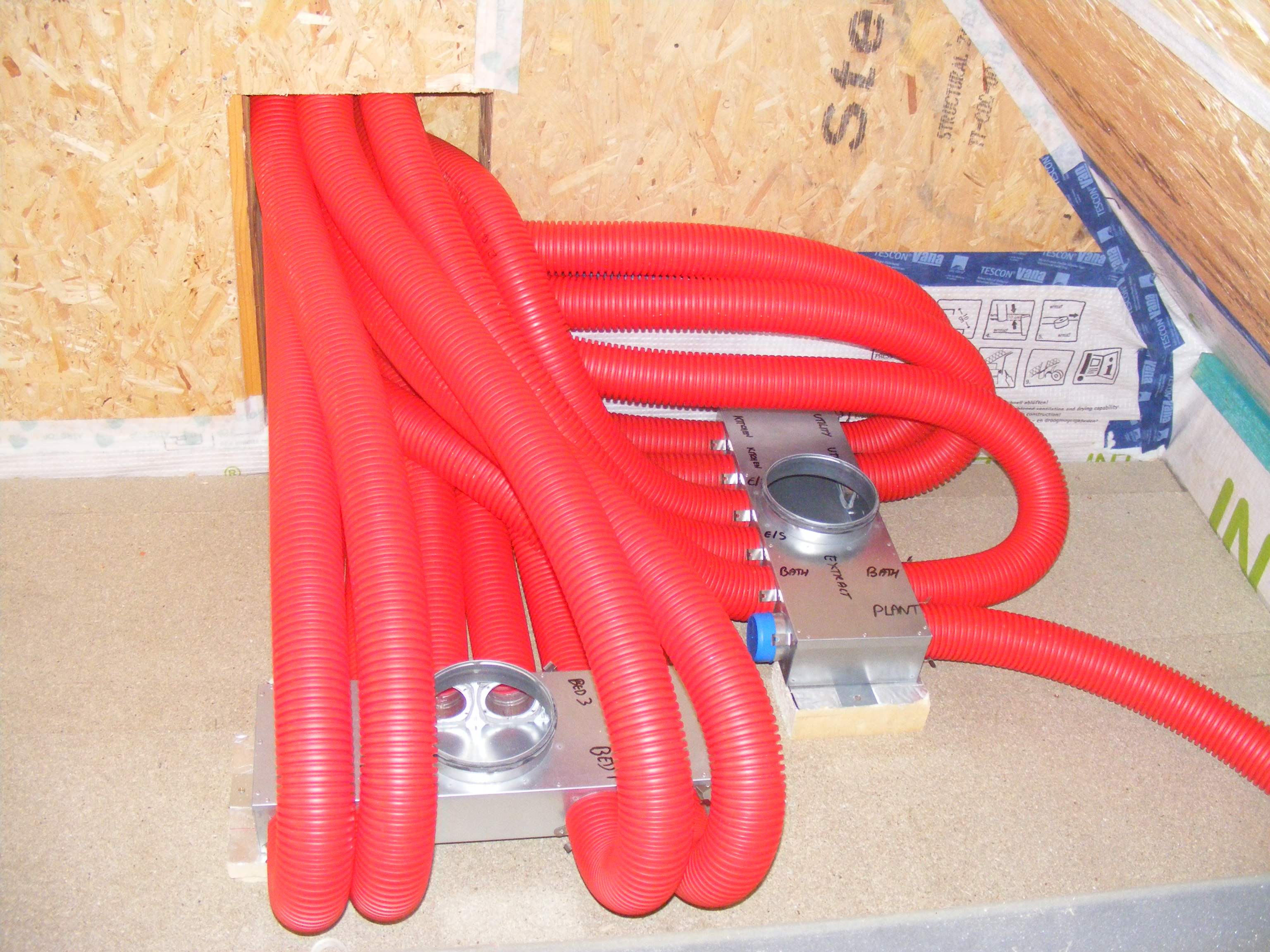

ProDave Posted June 7, 2017 Share Posted June 7, 2017 THIS is a plenum, actually two of them. 1 Link to comment Share on other sites More sharing options...
