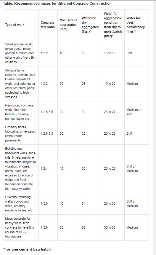

So...going for the wet room corner slab this weekend as I am I'm looking for some validation for the above 1 : 1.5 : 1.5 cement/sand/10mm aggregate mix I'm going with as I'm aware it's a bit "out there"! Nearest I could find was the 1:2:2 mix here:
It is in effect a small pre-cast area I'm thinking. Recommended for "garden furniture" I'm thinking those concrete benches you see are as tough as old boots. Or would the 1 : 2.5 : 3.5 in the above table be better?
Dithering over the mix here! :)
You really are a worrier. Screed is usually about 3-1 so just stick with what you originally planned.

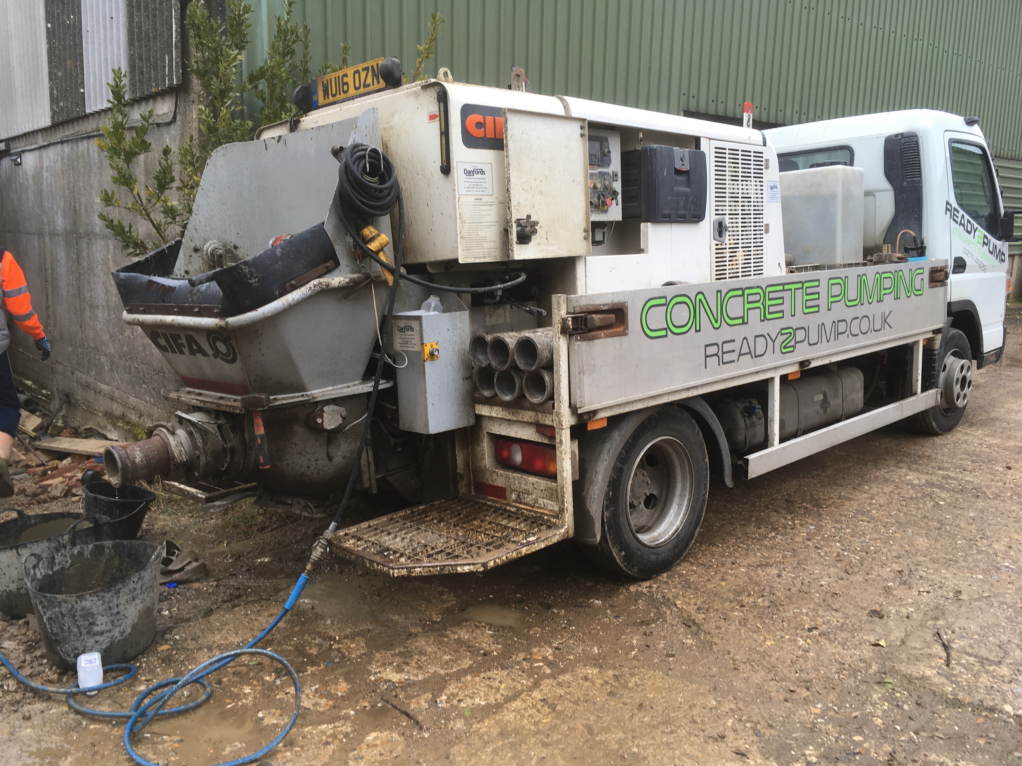

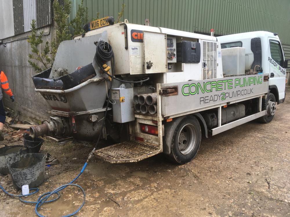

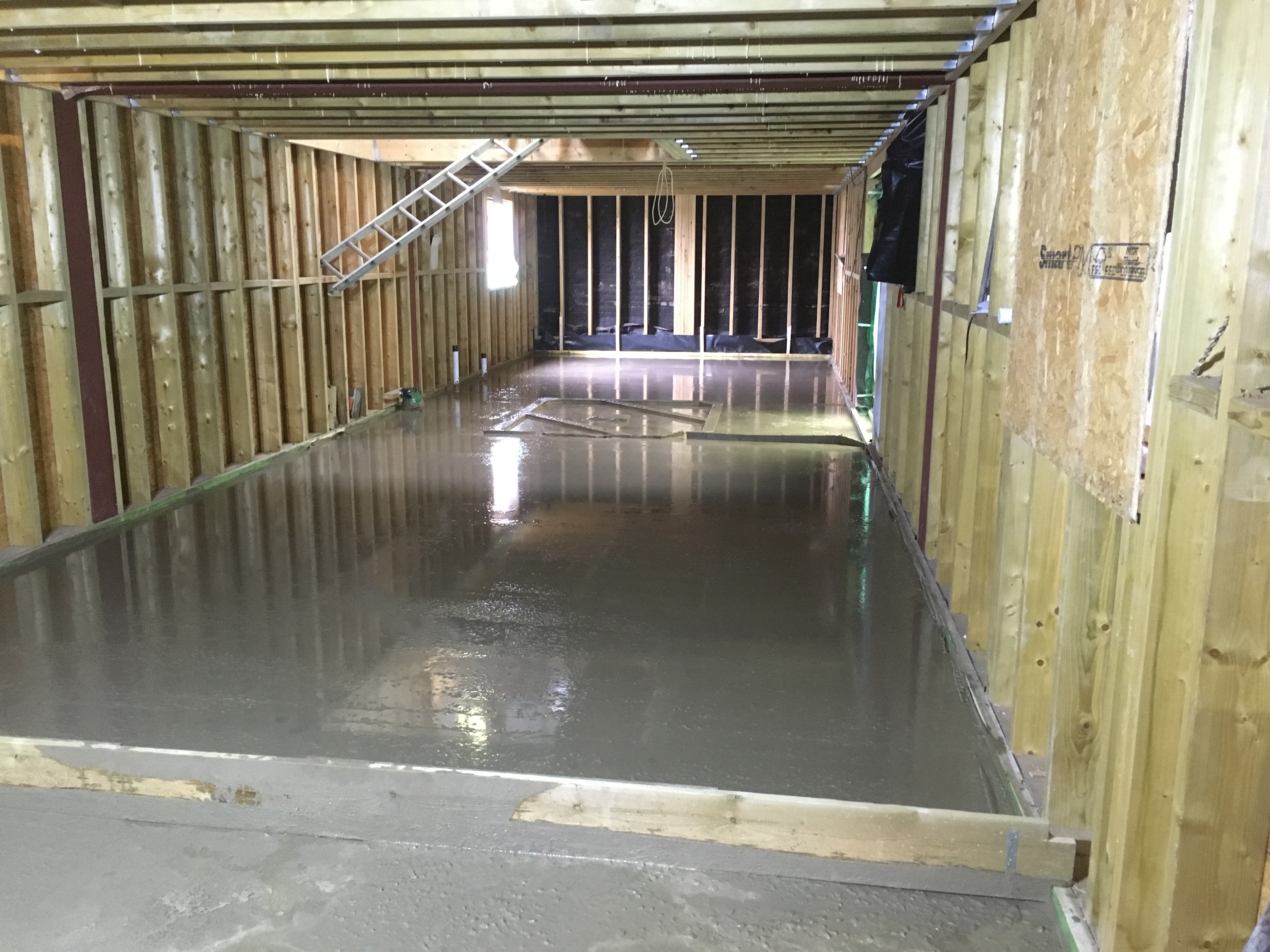

Im concreting Saturday as well. Iv even booked the pump so there’s no turning back now. :-/ also got to be out for lunch by 2:30 so hopefully I can get an early start on it.
Pumped??? You're never going to drop that weight by CHEATING!
Doh! If I hadn't have taken the pi$$ I could have lined the boot with a tarp and scrounged a couple of barrows worth! :)
I'm sure I will have a few barrows spare if you wanted it, Its only gen 3 so might not be up to your standards,
as for cheating, iv got 9.9 m3 to lay, by myself, in one hit before lunch, there will be a lot of swearing if the lorry isn't here before 8
