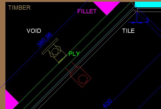

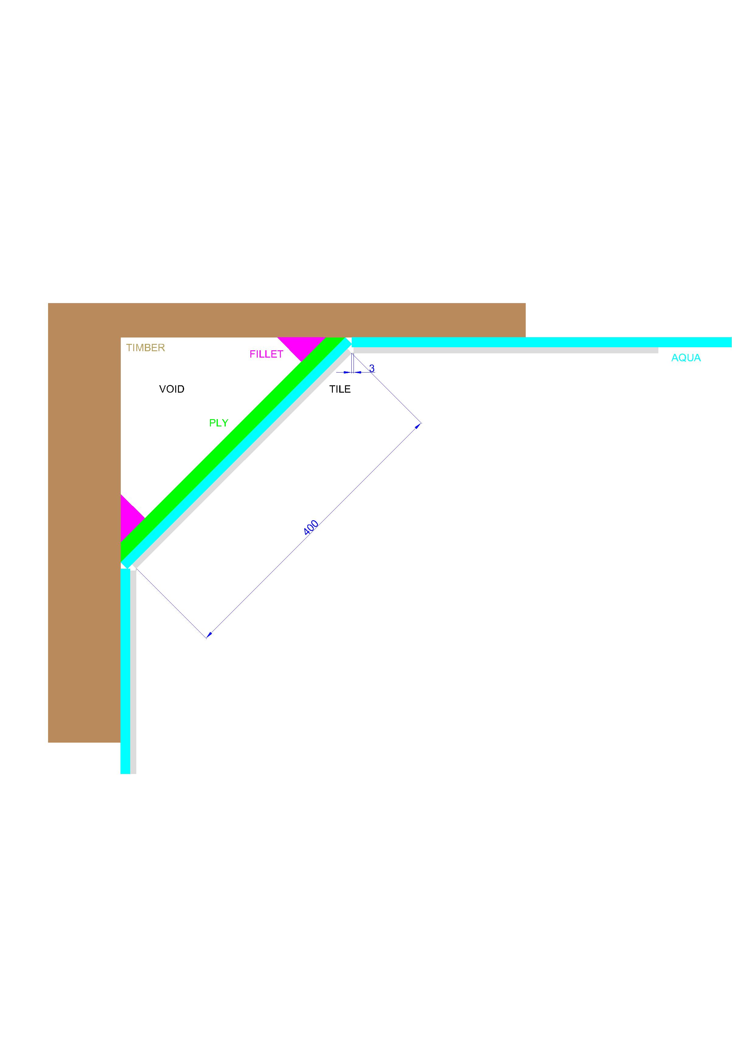

Trying to figure this corner out. I've found some seemingly decent 18mm ply although not marine, that I can rip to do the full height, something like this on plan:
What thickness do I allow for tile adhesive, which I've not accounted for? As in if I use a 6mm notched trowel does it squash down to 3, 4, 5???

Scored a couple of 3/4 size 18mm ply sheets (old site hoarding) ages ago.
Nice close "grain" on it. Not like some of the falling apart crap I've come across on site. Not marine ply but beggars can't be etc:
20180408_183933
One side's painted blue but hey ho, that can go on the inside. Ripped to width with a 45deg edge each side:
20180408_183836
The Aquapanel will be Sikaflex'd (or something cheaper maybe) to this. Might get a bit of a sanding down:
20180408_183915
The vertical ply will only carry the shower hose slider and hose outlet. I'll make it so if I do need access the backplate there'll be a sacrificial tile!
Edit: I've assumed an 8mm notched trowel for the walls bedding down to 4mm.

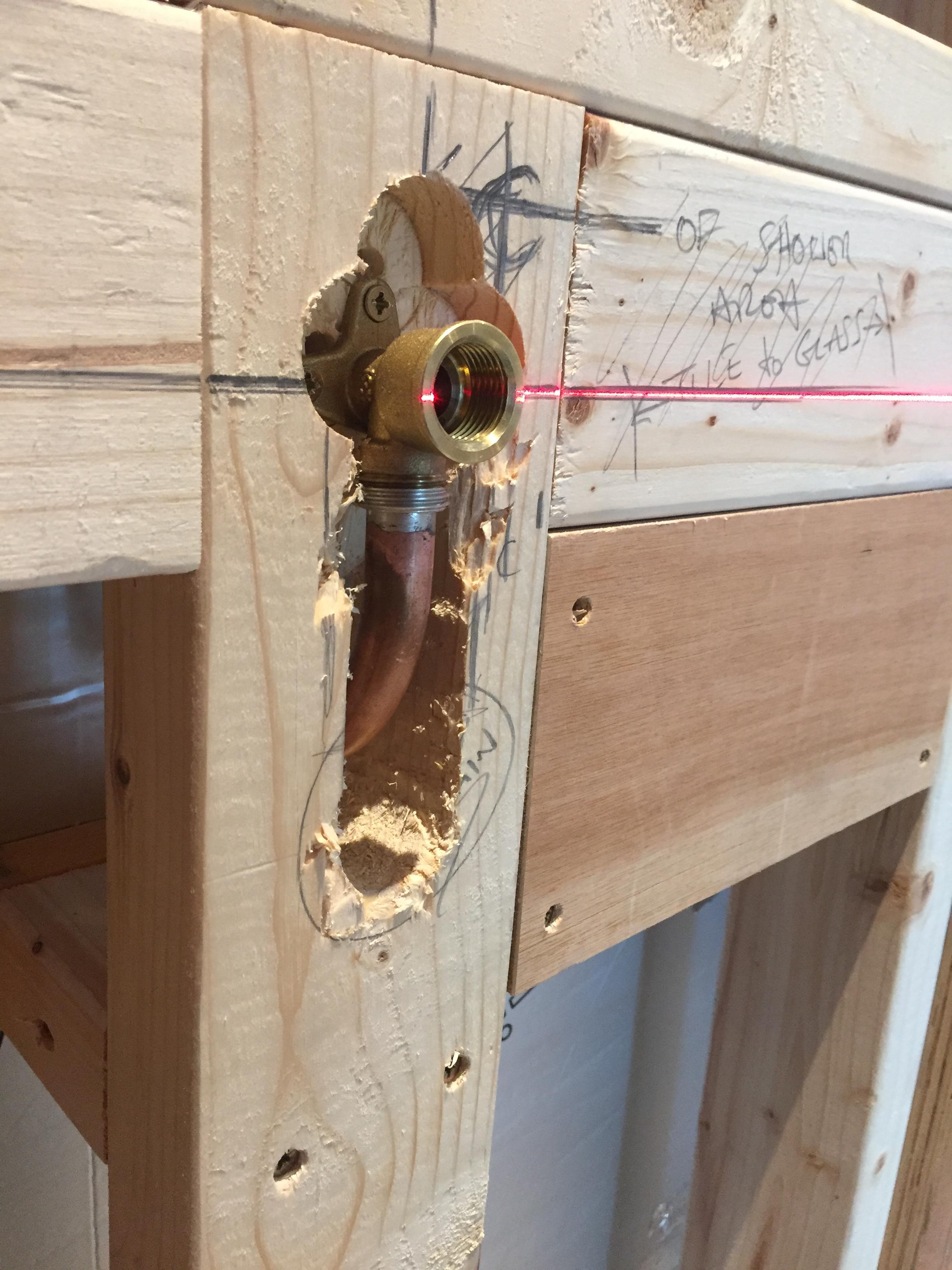

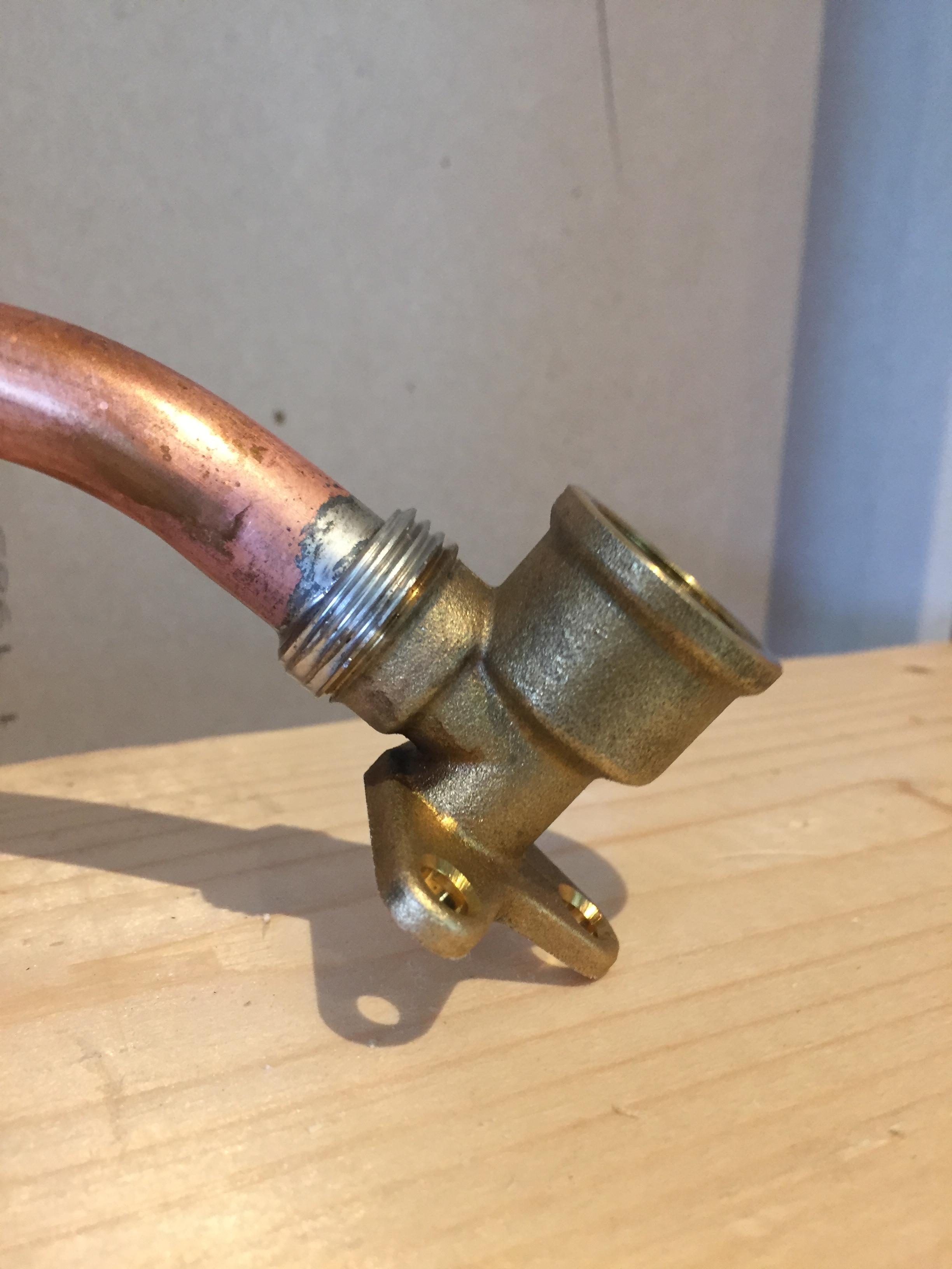

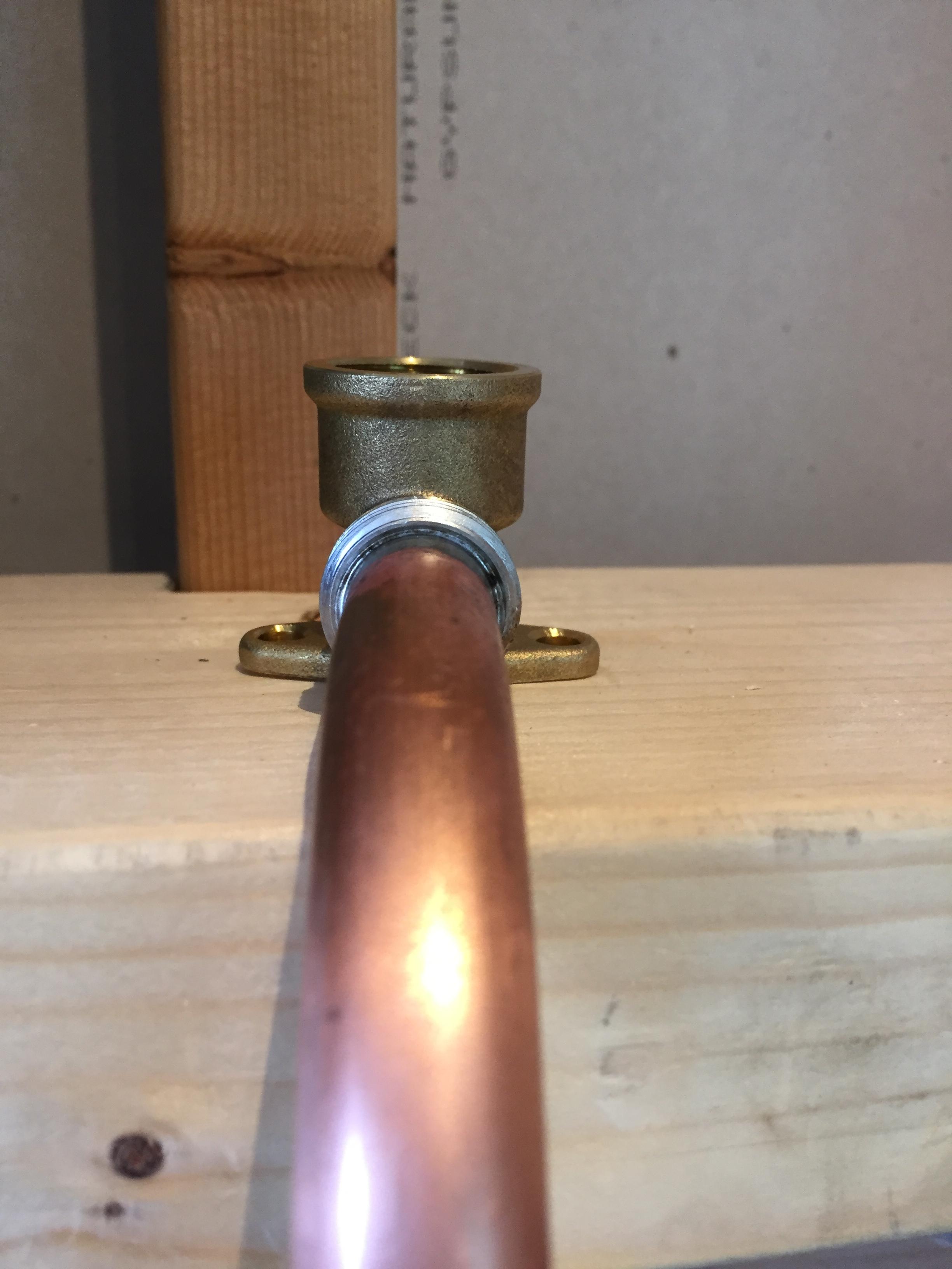

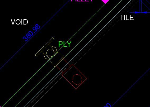

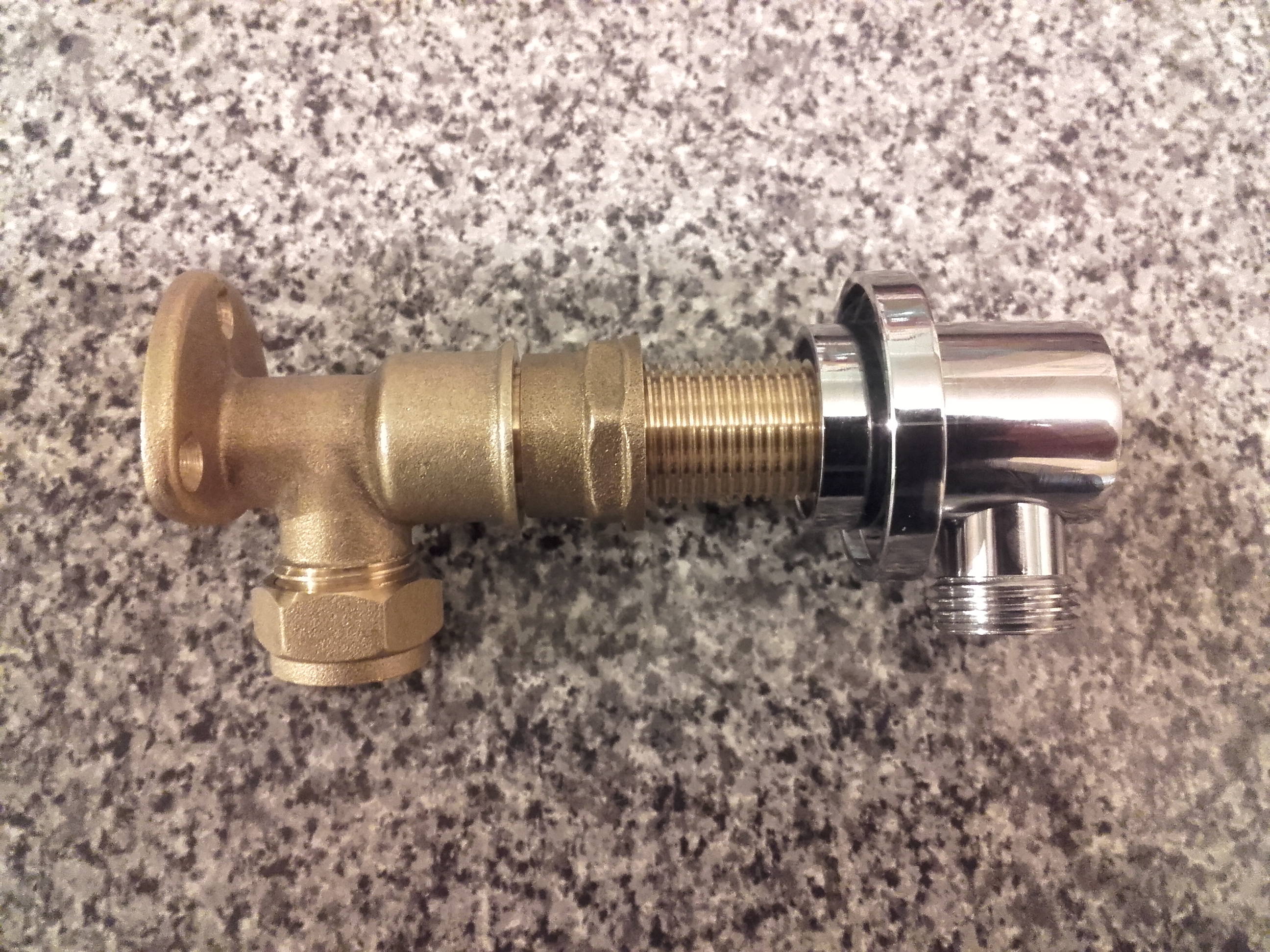

I possibly need to introduce an extension piece between the hose connector and backplate. As the extension / backplate joint is going to be hidden for evermore is liquid PTFE the best option? Did wonder if I could flux and solder it...

Cant you mount the tap fitting closer?  Fewer joints the better.  The good news is that when you arent showering this fitting wont be under pressure, so a wee leak shouldnt be a disaster (not that you would want one anyway).  Mine are just behind the boards and I will have to shorten the piece that goes into the surface thingy.
Because I have 18mm of ply then 12.5mm Aquapanel, nom 4mm of adhesive then 8mm of tile, even without cutting the brass thread down and keeping the shower hose chrome (red) 4mm into the tile, the backplate will be in the ply "zone":
Introducing the extension piece puts the base plate behind the ply:
100% what I would do, and I posted pics of the last one I did where I did exactly that.
Bombproof. You can get one of those backplates that's end feed too, not compression, so bombbombproof.

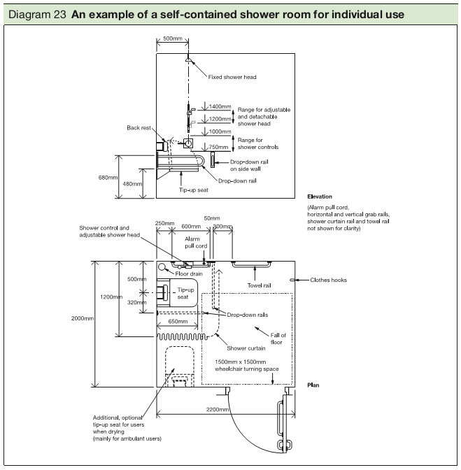

I'm going to look at putting in some strong mounts for a future shower seat. Do they tend to have a Geberit style frame, standard fixing centres etc?
The time it's taking and the state of my knees, back, joints in general etc I might as well fit the seat now! :)
What about these:https://www.screwfix.com/p/hose-union-back-plate/56415
You could mount this on the aquapanel, trim the 15mm pipe to size (this is in the void so no need to be too ott) and the connect up.  Couldnt be much easier or quicker (I realise the latter advantage isnt that important to you ??)
I think I've proposed that exact fitting myself in the past!
However...it would mean a soldered joint deeper in the wall. If I go with @Nickfromwales idea of the soldered joint close to the front then if it does go tits up and leak I've only got to break one tile out and I can get at the fitting easily. I'm aiming for no joints in the wall other than where the pipes connect to the shower valve.
Test it before you seal it up - easy to do to a threaded fitting and a bit of pipe ..
Solder it and do as per my pic ;).
If it leaks, I'll eat my hat, his hat AND your hat.
Crack on boyo :).
Got the mitred corner ply in (temporarily :) ) and each edge fixed where the red clouds are. Pretty secure tbh. Just playing with the shower valve and riser rail positions...
20180410_210519
Thereafter I'll insulate the Hell out of that corner!
don't mount the slide rail too low - I did this once and it is a right pain for anyone of a normal height.  In the new house I've allowed plenty of height - easier to lower the head than move the slide rail later....
Its shaping up now.  When you get the boards up - it will look very different again.
Yep. I'm seriously trying to set it at a height that's both convenient now and makes a nod towards Part M if we ever need to sit. Tbh I'll be under the rainfall head when I'm in there!
