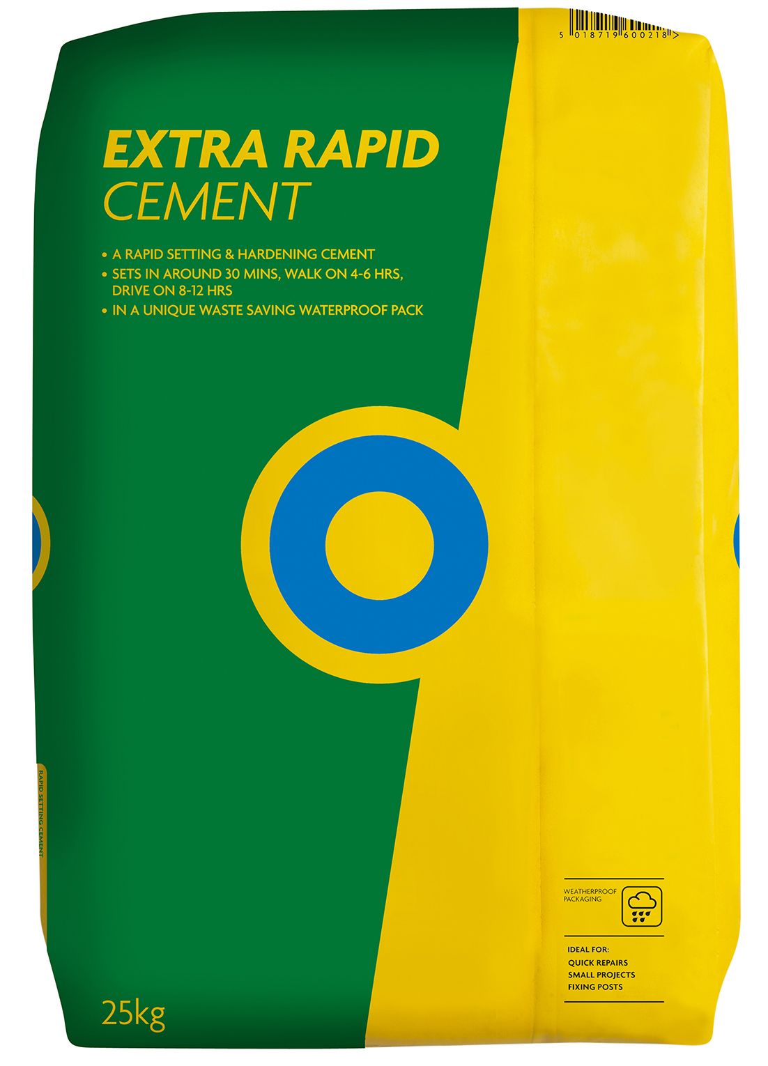

Ardex vs rapid setting cement:
I think with concrete it's generally accepted practice to allow a mm/day for it to cure before tiling or in this case tanking first.
Ardex, is that rapid cure as well as rapid set?
And the extra rapid set stuff like this, sets quick but takes longer to cure?
Not that I'll be using either as half an hour is far too quick for me!

Ardex is rapid cure, ceramic tiles in 4 hours from mixing and laying. Non porous coverings in around 2-4 days if your pushing your luck, but 7 days no probs.
Expensive but crazy good.
For you I'd say ordinary Portland and just wait it out. 2mm a day will be ample if you move the air about with a small desk fan.
