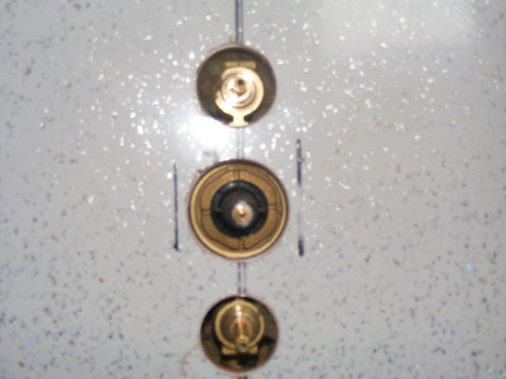

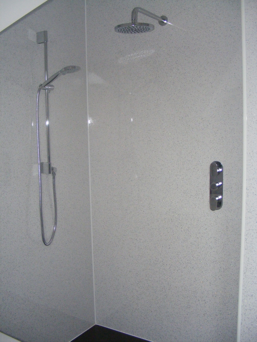

21 hours ago, Onoff said:
Got to decide whether to have the 3-way valve central to one tile or on the centre of two (not that it's going on the mitred bit):
20180413_184035
20180413_184053
As the hose outlet is coming out centre of a tile it might pay I think to go with the second option and line up the centre control with the hose outlet. It'd put the centre control at about 1m from the floor which "feels" alright (along with thinking ahead :( ).
You are missing the whole point of a separate valve.  Put it there and when you turn it on your arm gets drenched in stone cold water before the hot reaches the shower.
You want the controls on a different wall so you can turn it on, dry, and not get wet until it is warm water flowing
Don't forget to drill a BIG hole for the thermostatic mixer, so big the plate only just covers it
And for access to the filters I am going to have to cut between the big hole and the smaller holes with the multi tool
Why is scoring a no no? If you repeatedly score the same line 10 times you effectively cut through it, but other than that an old handsaw is the way forward
Read the first paragraph! :) It's going WAY over to the right near the window. Just showed it there as it's the only place I've a representation of tiles!
