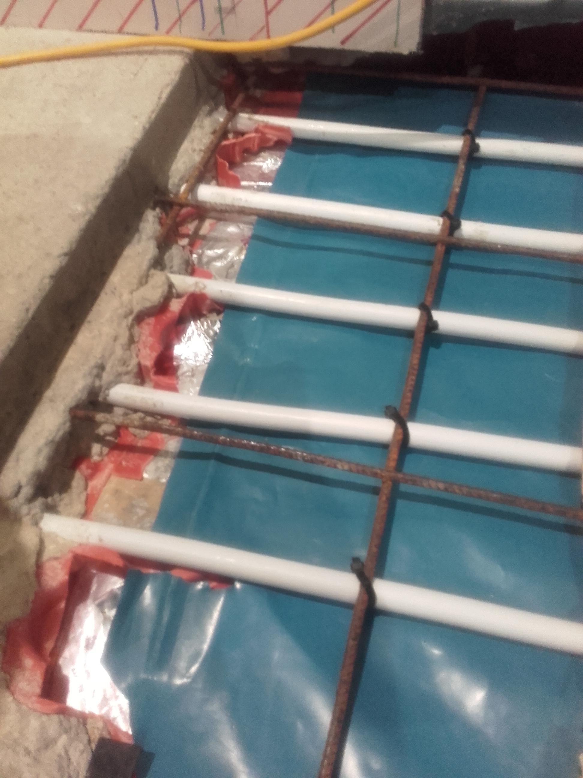

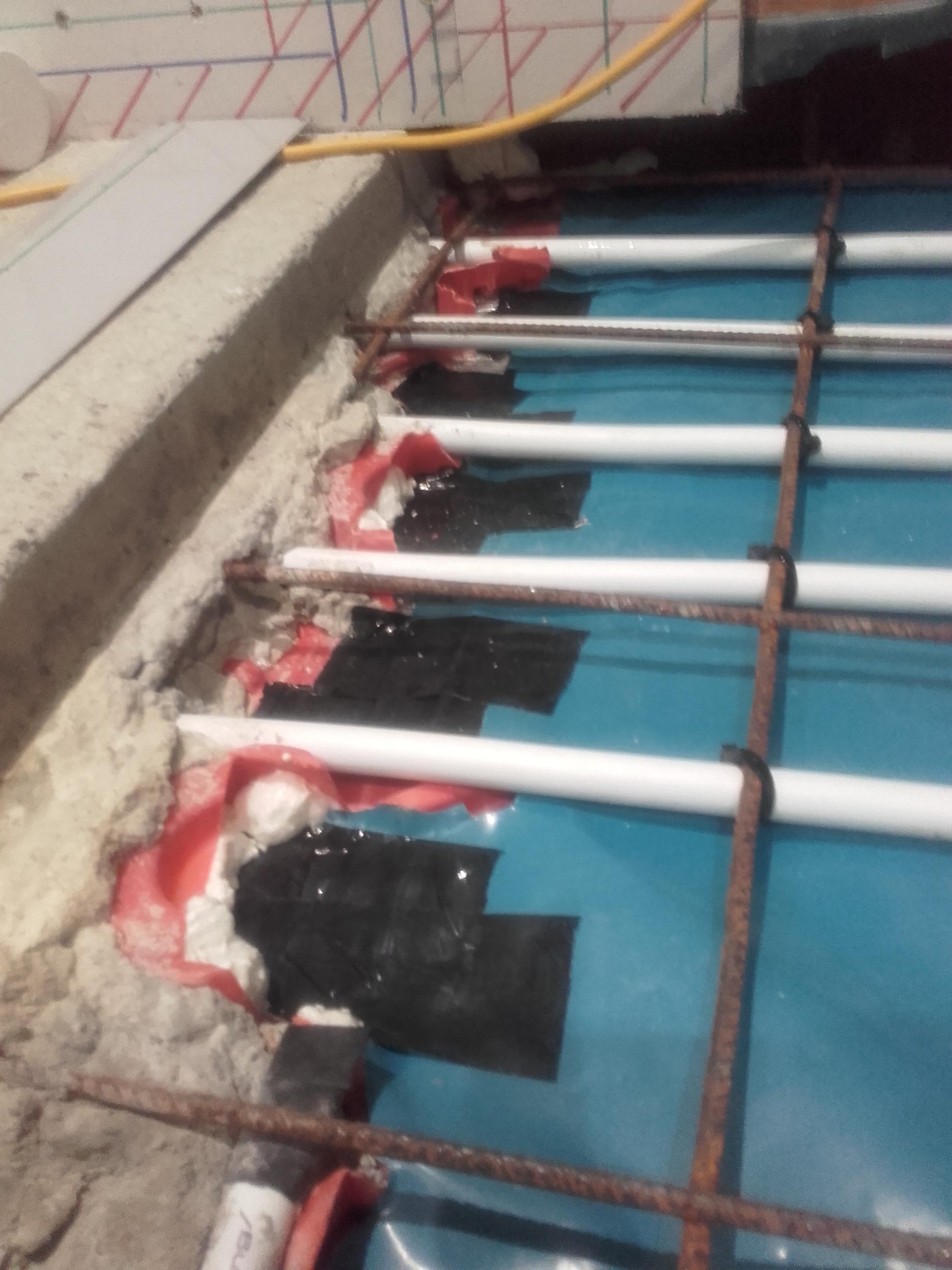

So...planning on concreting the wet room corner over Easter. That's 4 days time!
Where I've removed the red Polypipe tray and I've added the DPM the "interface" is a bit ragged.
Best thing I can think to do to protect the PIR foil from the concrete is duct tape and low expansion foam?
I'm going to be using an SBR heavy mix to make it hopefully resilient.
SBR can apparently be used as a primer. In the past "joining" new concrete to old I'd have primed the old edges with neat PVA and made up the new concrete with 5:1 PVA.
But I'm using SBR & using this mix:

Should I prime the existing concrete edges with neat SBR?
Ta.
Edited by Onoff
Yes if only to stop the concrete drying too quickly along the joint and therefore reduce the possibility of cracking.
Are you sure about that mix though?
Cheers. What's wrong with the mix? I figured strong & "resinous". It's either the 10mm pea shingle or 20mm ballast I have here.
I would normally say yes, but the reinforcement of the steel mesh says "chill, Winston", that is going NOWHERE fast. ;).
Its going to be a Carlsberg bathroom mate. :).
Why are you using SBR in the mix instead of integral waterproofer e.g Sika 1?
SBR in the mix will not be guaranteed to be 100% waterproof, it will be very difficult to trowel unless you add admix too and needs very hard mixing eg paddle mixer (more vigourous than a cement mixer) otherwuse you may get the SBR floating to the top of the concrete.
SBR seems to make the concrete end up more "plasticy" than PVA in my experience with it. Was going to go 3:1as per the mix instructions, water/SBR.  I won't be trowelling it, more barrow/shovel/tamp to falls.
