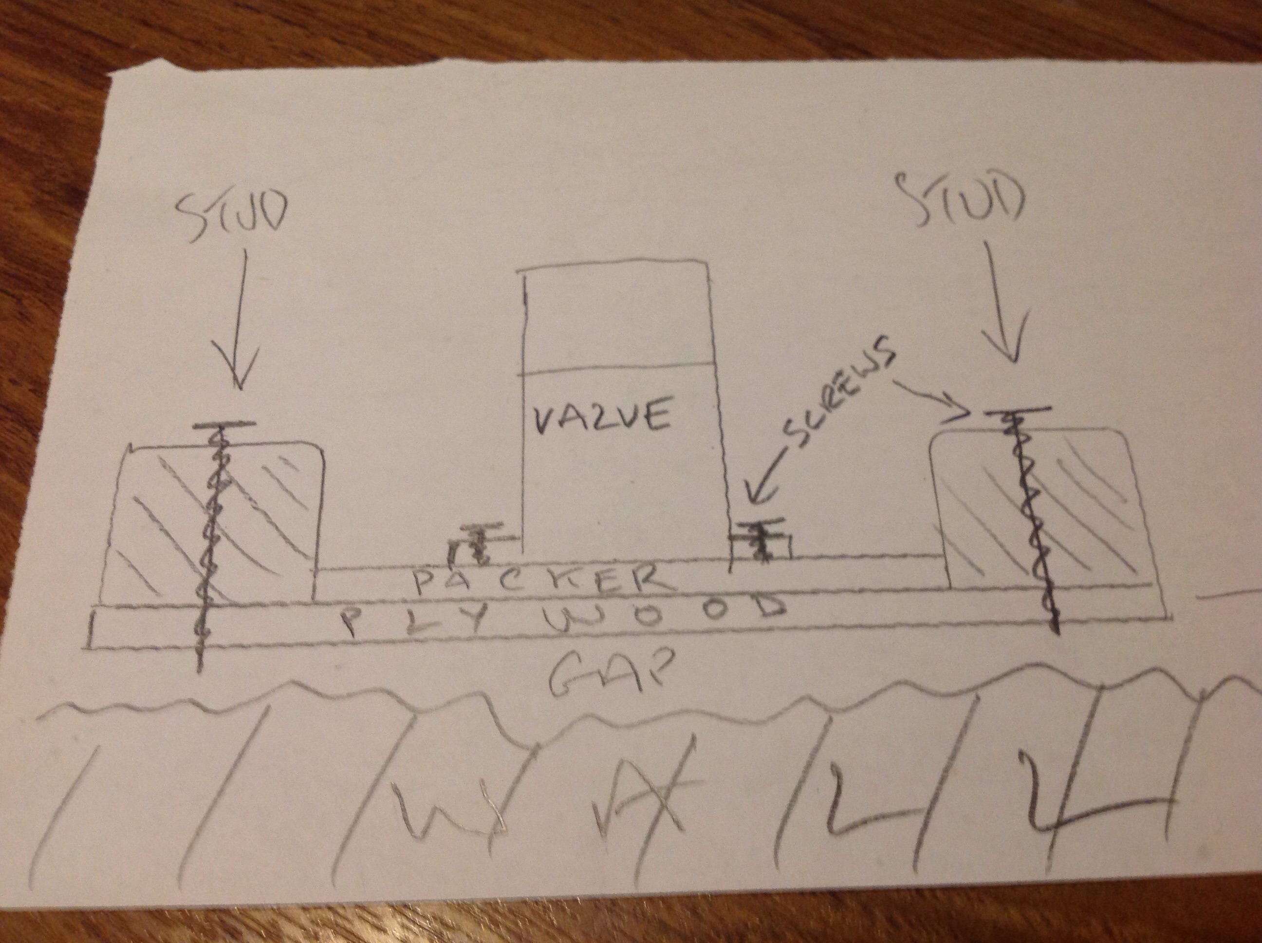

I was/am going to pack this North facing cavity wall where the shower valve is going with PIR. As in to the gills, minimum 50mm up to 130mm - I tapered the studding in relation to the original wall to bring the room square. Might have to be some EPS in there too, tbh whatever'll fit!
However I'm very tight for depth where the valve is going. If I either screw it direct to the white painted render or fit a bit of 18mm ply first but insulate all around it am I likely to have any interstertional (?) condensation around it? There'll be a vcl across the face of the studs before the Aqua Panel goes on:

You will need to use some chunky ones or you will find that the body flexes Q a bit.  The valve could do with some screw holes at the bottom as well as the top.  I mounted ours onto timber which itself is fixed using some slotted brackets - so I could adjust it slightly to make sure its bang on plumb.  Can you use some of this modern reflective membranes for insulation?  I know many are not sure they are as good as claimed but will  be better than nothing.  They are pretty thin.

Just standard plated steel wood screws.
Mine is screwed to a wooden back board. The advantage being if I had drilled my wet wall and got the measurements wrong then after the trial fit I could have moved the valve. As it was, it was spot on.

All you need is a small gap behind it and then you go for a full foam jacket. Foam the lot, with the chrome parts masked with the supplied covers / shrouds and its job done.

Believe it or not I was considering exactly that!
Possibly with packers between the back of the stud and ply to set the valve further back depending on how much it leaves for "foam".
What are you waiting for then? :).

Something like this then! Found some hardwood ply offcuts. Just held in by wedges at the mo. Resigned to foaming behind the board but there'll be sweet FA there!
20180416_205535
20180416_205621
Not much going behind here! I suppose I could have used 12mm instead of 18mm ply.
20180416_205546
It'll project about an inch to the controls:
