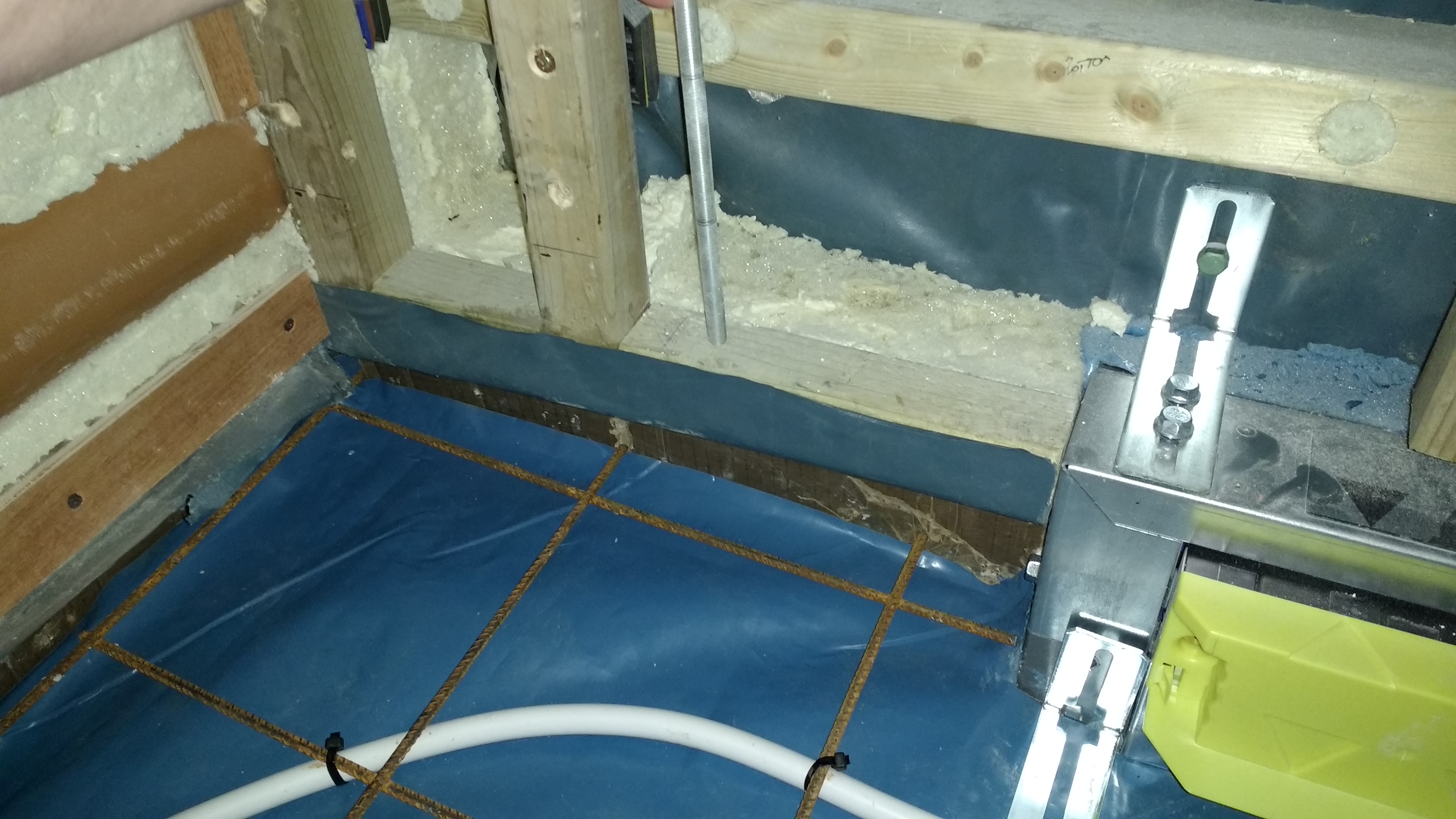

I'm a little worried of the stud wall / wall drain / floor moving independently of each other and splitting the tanking membrane.
I could run a strip of something above the wall drain element, secured by the x4 M8 bolts and screw to the top of the 2"x2" either side:
20180310_224812
That would secure the drain to the wall.

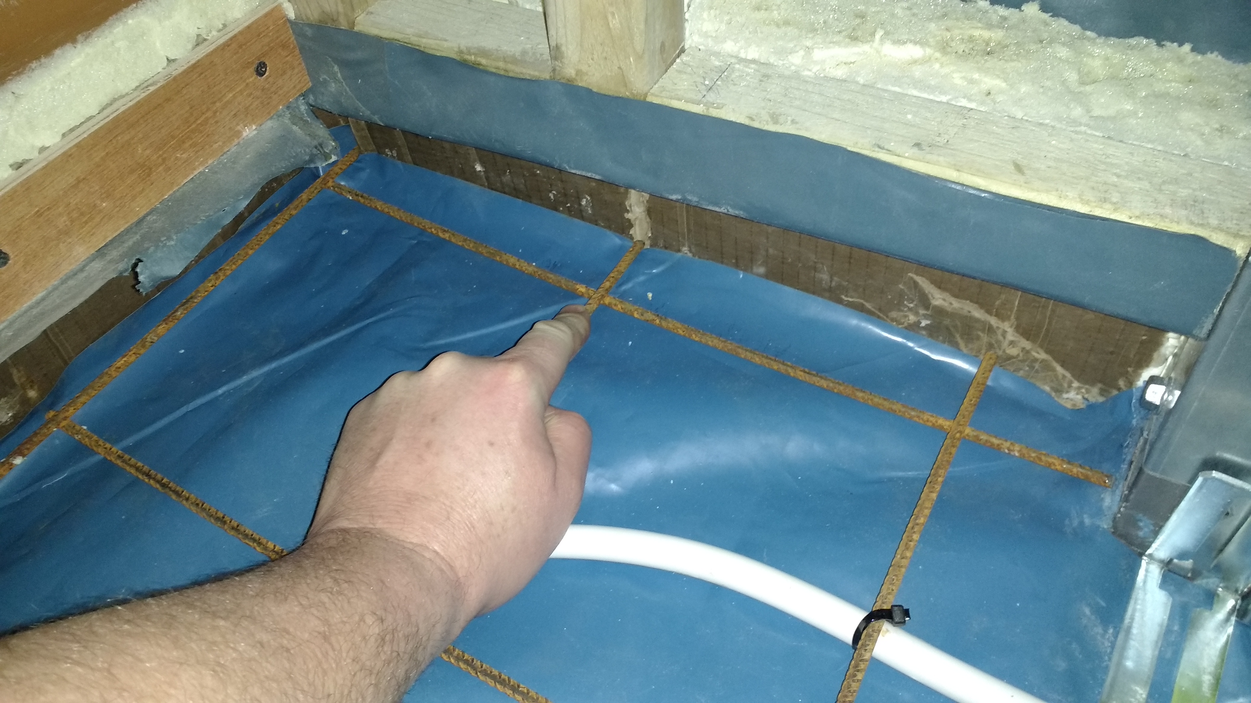

If I kick up the ends of those two "L" brackets coming off the front of the wall drain element then they would key into the slab:
20180310_224831
Not sure if I need a bit more rebar in front of the element?
Then to stop the wall to slab movement I was thinking drill down through the horizontal 2"x2" and fit some studs with big square washers in the end that would get captured by the slab.

i dont understand, what part are you worried about decoupling from what part?
That lot won't budge a mm. ;).
The two brackets laying flat over the membrane, I'd stick a couple of short stainless bolts through them to make pins that the screed will hold and that's that.
I take it you've not looked at tanking properly yet -_-. The areas you fear may split are all junctions. The tanking kit comes with long strips like band-aids which stretch and flex with the wall / floor 'fault lines' so such a problem cannot occur. The tanking solution is like rubber when it's cured rather than brittle like paint, hence why your using it.
Just put a good few layers on, allowing to dry in between, and it'll be bombproof. ;).
Have you opened the tanking kit yet? Or haven't you bought it yet?

OK, I'll try and NOT resort to a drawing:
The timber stud wall are suspended from the ceiling joists. The concrete floor was put in afterwards. I screwed screeding rails to the stud walls so the floor is pretty much bang on level.
The 4 stud walls were made up on the floor then lifted up and screwed (6mmx100s) to the u/side of the ceiling joists.  (The ceiling joists are a bit over spec for the span figuring storage and maybe a bath lift later on :( ).
I have then a nom 50mm gap between the underside of the stud wall and top of finished concrete floor. The timber stud depth varies from 45mm to 145mm allowing for hiding the wc frame, services, feature pockets and to just generally square the room off. I've a minimum of 50mm of PIR in the walls. The timber studs are attached to the walls by either concrete screws or resin anchored M10 studs (high loads like the wc, where the concrete screws have failed to bite). Every single stud is held off the wall by minimum 5mm packers up to I think 100mm. Gun foam is squirted behind every stud and they're all PIR'd between.
The wall drain is affixed to the original wall, so independent of the stud wall. I can mitigate that as I said above by using the M8 L bracket bolts.
Thinking this through my main worry I think is that the wet room corner feels, by treading on it, has a bit of "give". Down to the batch of badly curved PIR sheets from Wickes I think. I'm worried even when the concrete goes in that after it cures, if you tread on that area there'll be a bit of bounce (especially with two people in that area, none of us are getting any lighter ;)).That in effect means the floor moving away from the wall and the tanking splitting potentially.
That was good to think through and get down even it meant boring you lot!:) I'll go with what I said above and the bolts @Nickfromwales said just now.
And yes Nick, I've got the big tanking kit and it's not yet past it's expiry! Did just drag it out of the loft as cold storage apparently drastically reduces it's shelf life :oWon't know until I open it.
If your really that concerned then exactly how much 'bounce' is there? Are you mistaking the layers compressing slightly underfoot for bounce?
As I know you pretty well by now, a solution. Get a 4x2 cut it 300mm short of ceiling height. Drill the end to take some 10mm SS threaded bar. Use that with a couple of nuts andxwashers to create an 'acro prop' and sit the threaded bar on a bit of SS flat bar. Use that, pushing from the ceiling down, gently, to take any slack out during screening and grind the threaded bar off after the screed is dry.

Layers compressing is what it is I reckon, as you say. I reckon if I just keep the ends of the A142 down on the edge it should do it. Studs down thru the 2"x2" into some square washers:
