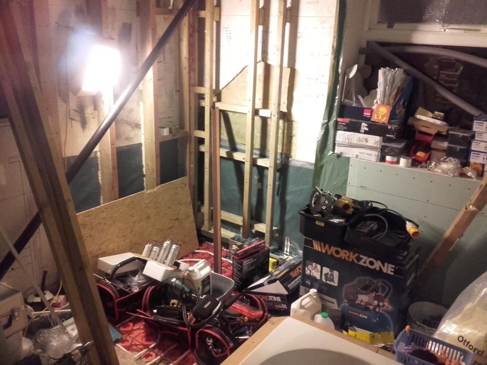

Onoff Posted November 10, 2017 Author Posted November 10, 2017 Somebody needs to get their ar$e in gear... 1
ProDave Posted November 10, 2017 Posted November 10, 2017 12 minutes ago, Onoff said: Somebody needs to get their ar$e in gear... That looks like the typical "help me out, it has to be finished by Christmas" jobs that pour in at this time of year.
