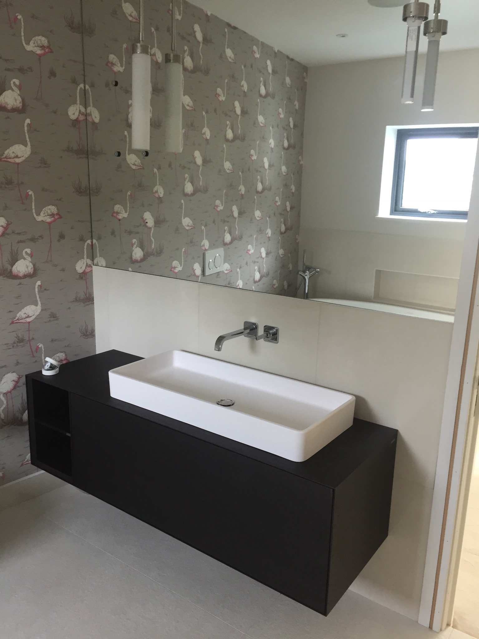

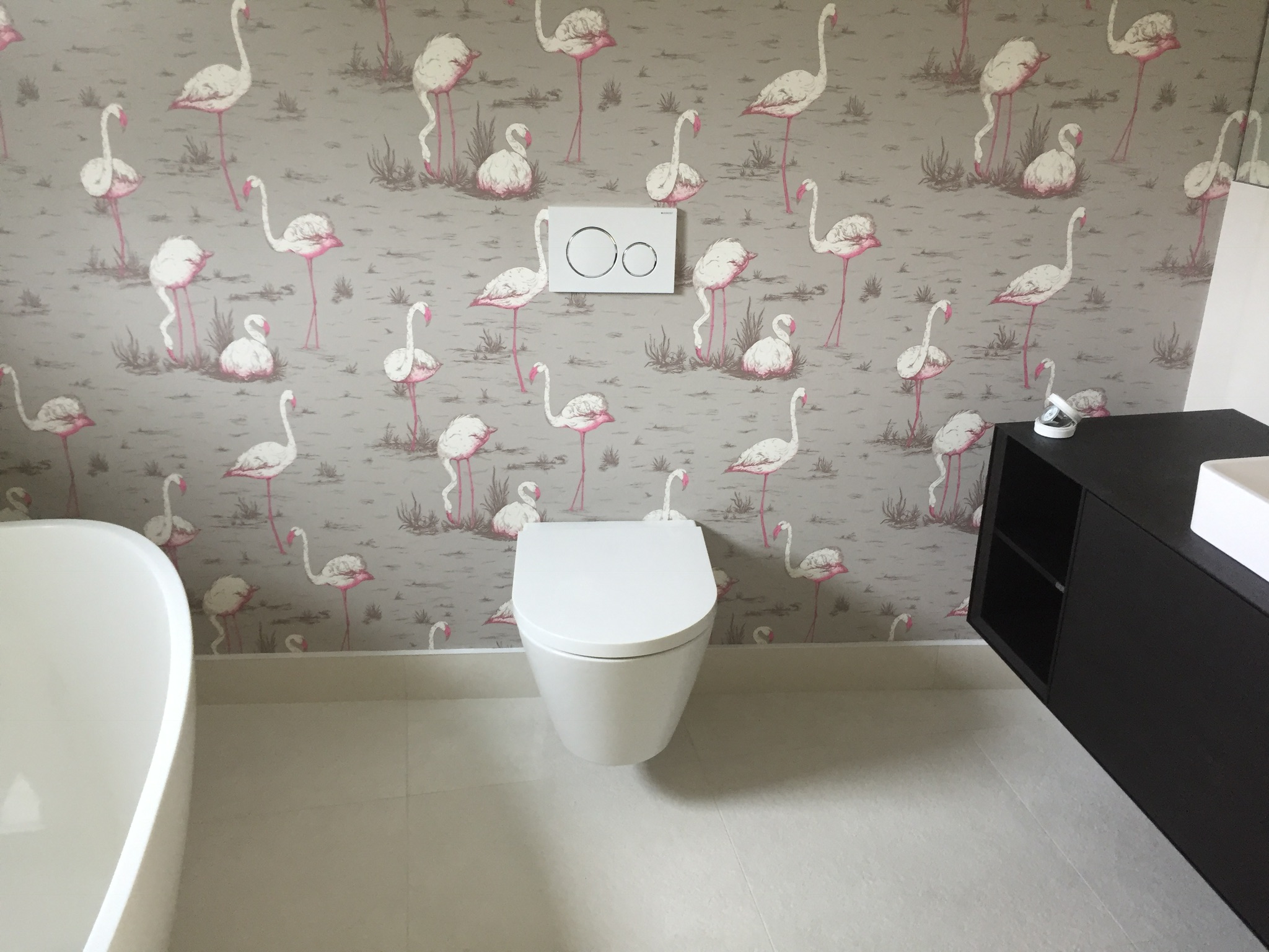

That's an Impey linear 2.
Handset is going into a holster, not a riser rail. I haven't drilled the tile for it yet as the glass screen is still in Bristol being toughened. :(. Customer wants to see the screen in position before deciding the final location of the handset. ;)
I was shitting bricks fitting the 1780x1410mm mirror, with 3 pairs of holes in the left hand side for floating shelves :S
It has two large demister pads on the back too so gluing it, holding it in position, connecting and feeding the cable into the wall as we went was a nerve-wracking event to say the least. My sparky mate and I breathed a sigh of relief when that was up and supported ( by the temporary screws, washers and open 20mm grommets you can see ). Used 5 tubes of mirror goop so it's nearly completely covered behind, less where the demister pads are. In the reflection you can see the Lithe Audio ceiling mounted speaker. Fantastic sound, loads of bass, and change of £170.
Beofre anyone asks, the right hand pendant diffuser sadly didn't make it. RIP.

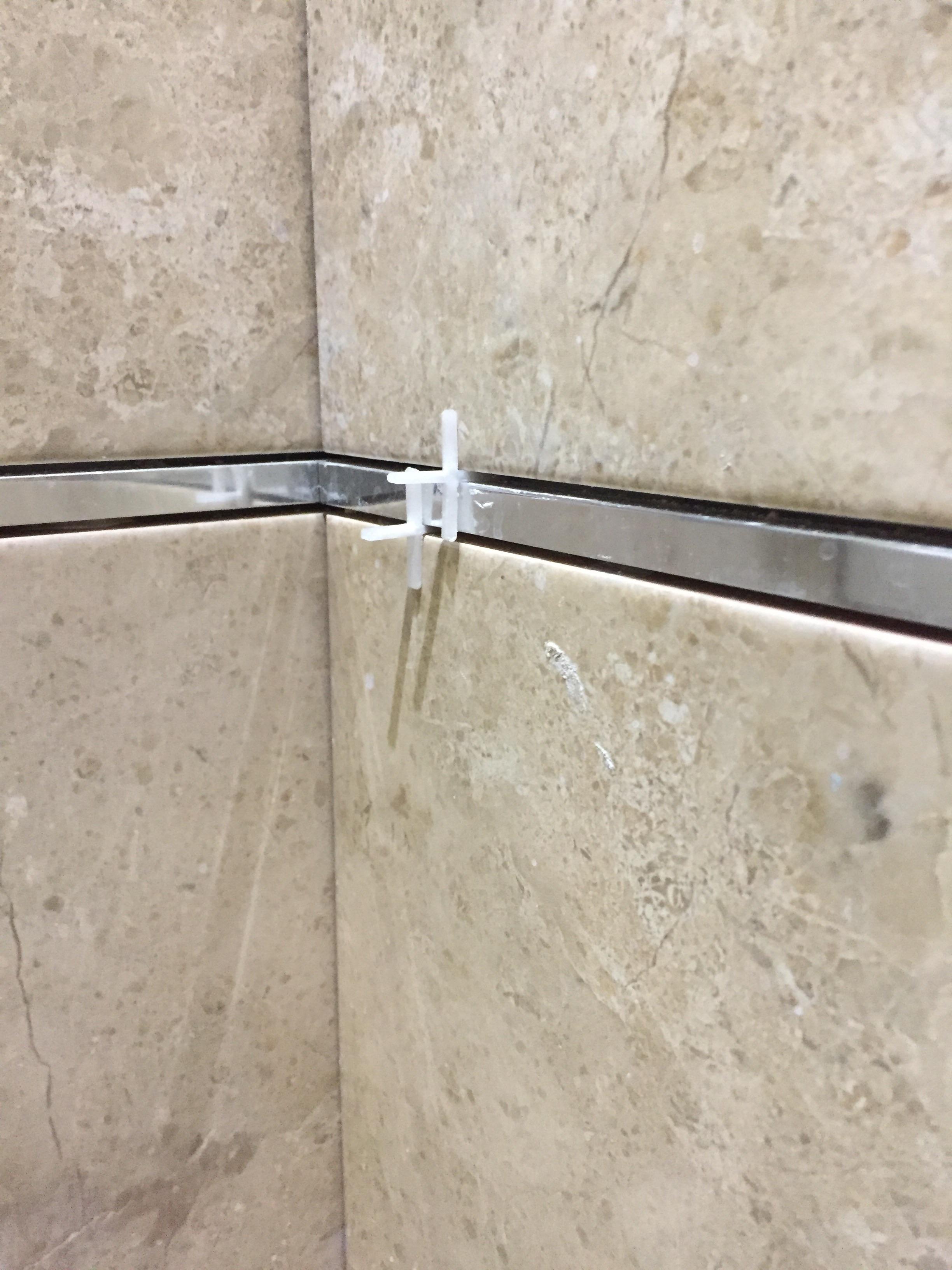

Tile is nom 250 wide. Middle 6 mosaics are 26x26 all day long. I reckon the grout is without doubt, 5mm.
2017-08-14_09-35-24
2017-08-14_09-39-28
Outer edge mosaics are nom 28mm (27.5?) x 26. So we have:
6 x 26 = 156
7 x   5 =  35
2 x 28 =  56
              247
The tiles have a slight taper on all sides.

I'd say that's a 3mm groutline and then the radius opening up.
How about I temporarily butt two together and run a line of decorators caulk up the join to see?

So tile spacers go at the back edge of the tile?
If I use a 3mm spacer and the tiles taper then the finished grout line will be wider than 3mm?
Yes and yes.
4 minutes ago, Barney12 said:
Yes and yes.
Ta. I shall have to get some 3mm tile spacers some time. For testing purposes on these two tiles I've some 3mm thick nylon washers that'll do.
Tile with the spacer legs so the majority of the spacer is on show.
After the adhesive sets, completely remove the spacer so when it comes to grouting the grout is solid in the lines. I hate it when people leave the spacers in and grout over them as that leaves little or no grout penetration at those points. You often see them showing or the grout having crumbled away so don't do that, especially in the wet / splash areas.
You can tell the missus is out, I had to use a bag of rice for the "something heavy"!
2017-08-15_10-50-09
So 3mm spacers, a couple of tiles weighted down flat 'ish and some decorating filler:
20170815_105405
Smoothed off with a wet finger:
20170815_105620
So 3 or 4mm on the spacers? Doesn't look too bad I don't think.
