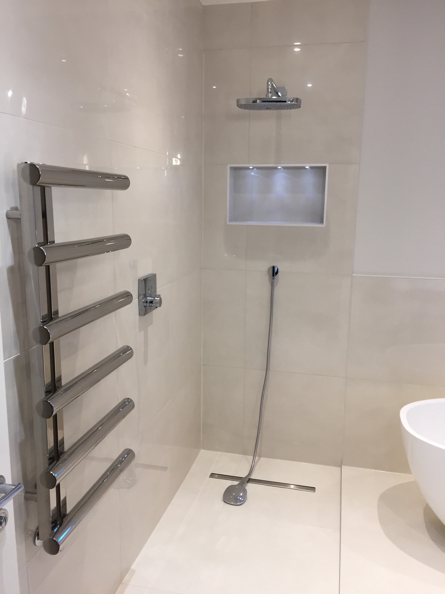

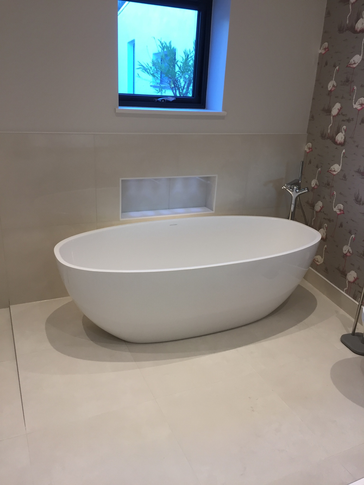

I've just finished this bathroom....
image.thumb.jpeg.3af3646cbbaed500b5075eab9a5105e4.jpegimage.thumb.jpeg.7bec3f5a34d5abf83c9bfacfc9e2715b.jpeg
As its rectified edge porcelain, I used 2mm spacers. Was really peeved when I found every other floor tile had a 1-2mm 'hump' in the middle of each 600mm edge :(. Had to sit tiles alongside each other, dry, to ascertain which 'complimented' each other best prior to sticking them down, numbering them accordingly for reference. What an absolute bastard of a floor to lay.
Grade 5 porcelain and a brand new £68 Rubi blade in my radial wet saw didn't last the job out. Not a single tile in that room would cut on my £360 Rubi scribe and snap cutter. Every cut, wet and slow. ??
