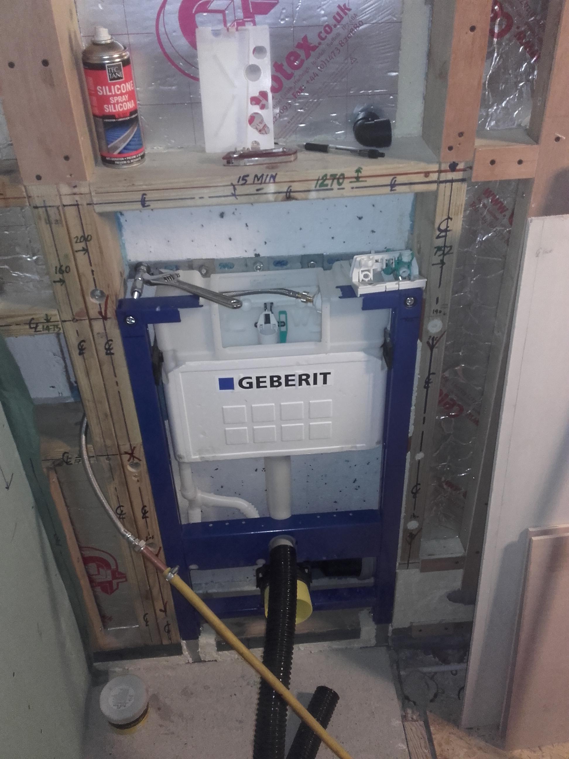

@Nickfromwales.....that went well.....NOT! :o
20170731_141838
OK, the ad hoc plastic bag wasn't ever going to cope with the deluge and I don't think I had the ducting off cut pushed far enough around the soil bend but the fill wouldn't shut off. Do these internals look alright to you? I am btw running it straight off of the un-PRedV'd outside tap.
20170731_141852
20170731_141907
It kept filling the the "over spill" went down the flush pipe. No signs of it stopping. Or did I panic and it would have stopped?
Going to take the spare Geberit frame out into the garden and have a play with it there where I can make a mess!

4 hours ago, Nickfromwales said:
Turn the thumbscrew on the float and lower it all the way, then try again. Don't blow them both up with your 10 bar fire hydrant ?
Me being a wuss I think! :ph34r:
Tried the other frame in the garden, ratchet strapped to a brick pillar and it all worked a treat. Took the float from the installed, suspect one and fitted to the second frame, That worked fine too. SWMBO impressed with the quietness of it all, rapidity of refilling etc. Don't think she'll stomach crapping against a brick pillar in the garden for too long though :)

Filled up the cistern to what I assume is the 9L mark (I dipped the Sharpie in to colour it a bit). If no leaks tomorrow I might start covering it up...might that is...

5 hours ago, Nickfromwales said:
Get it covered up ;). Those things are bombproof :).
What (& where) was the "washer" issue on these I seem to recall in the dim and distant? Something went brittle?
An age old problem with earlier models. Nothing to worry about on these. ;). It was Temp who highlighted that problem as he had issues with his ones, but they were also the 'cistern only' models, not the framed one that you have, and the issue was the outlet of the cistern where the flush pipe connected at the bottom. That was a choice of friction only, over o-rings, or the old plastic nut and black rubber 'olive' washer.
"Stand down red alert" :).

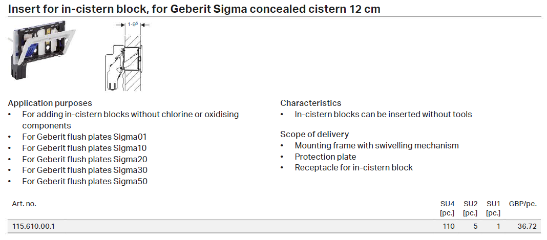

Geberit do an insert for the flush-plate that allows you to put blocks in the cistern:
Stops constant removing of the flush-plate, just tilt and insert the block.
Really like the idea but not sure if it's available for the UP200 cistern with Kappa 20 flush plate?
