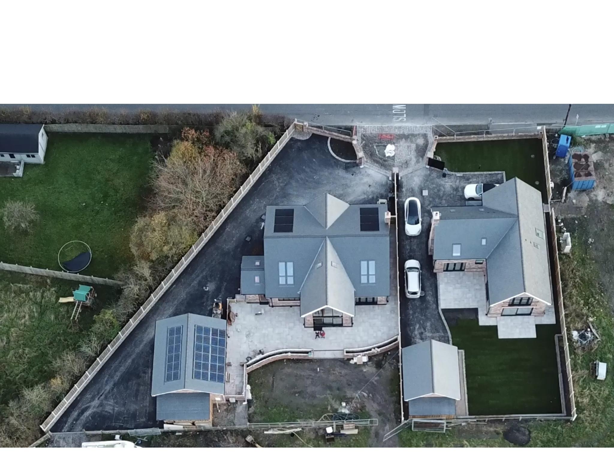

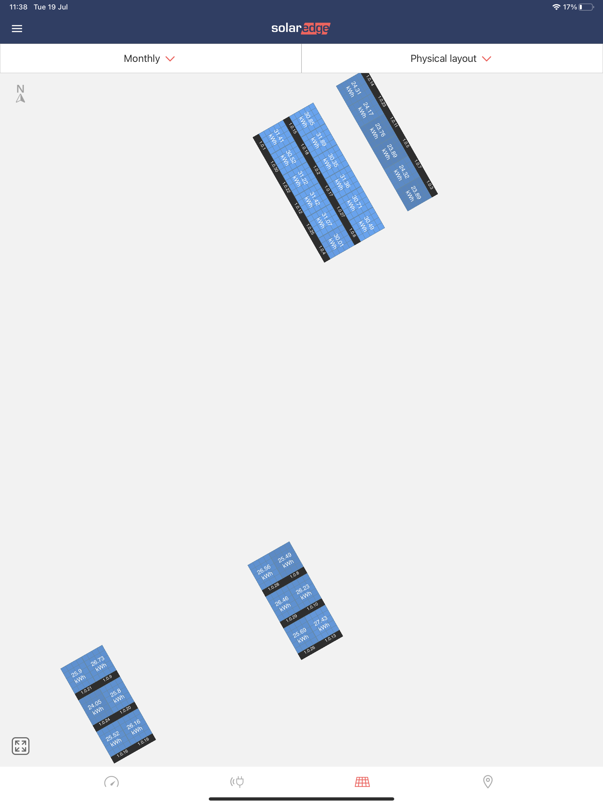

Johnnyt Posted July 19, 2022 Posted July 19, 2022 In terms of orientation of arrays, here’s my set up, the top being my garage roof these panels are 340w roughly east and west split with the lower panels being 325w all fully integrated roughly south facing. I’m happy with the performance and covers most of the day. I’m sorry about the clarity if the image.

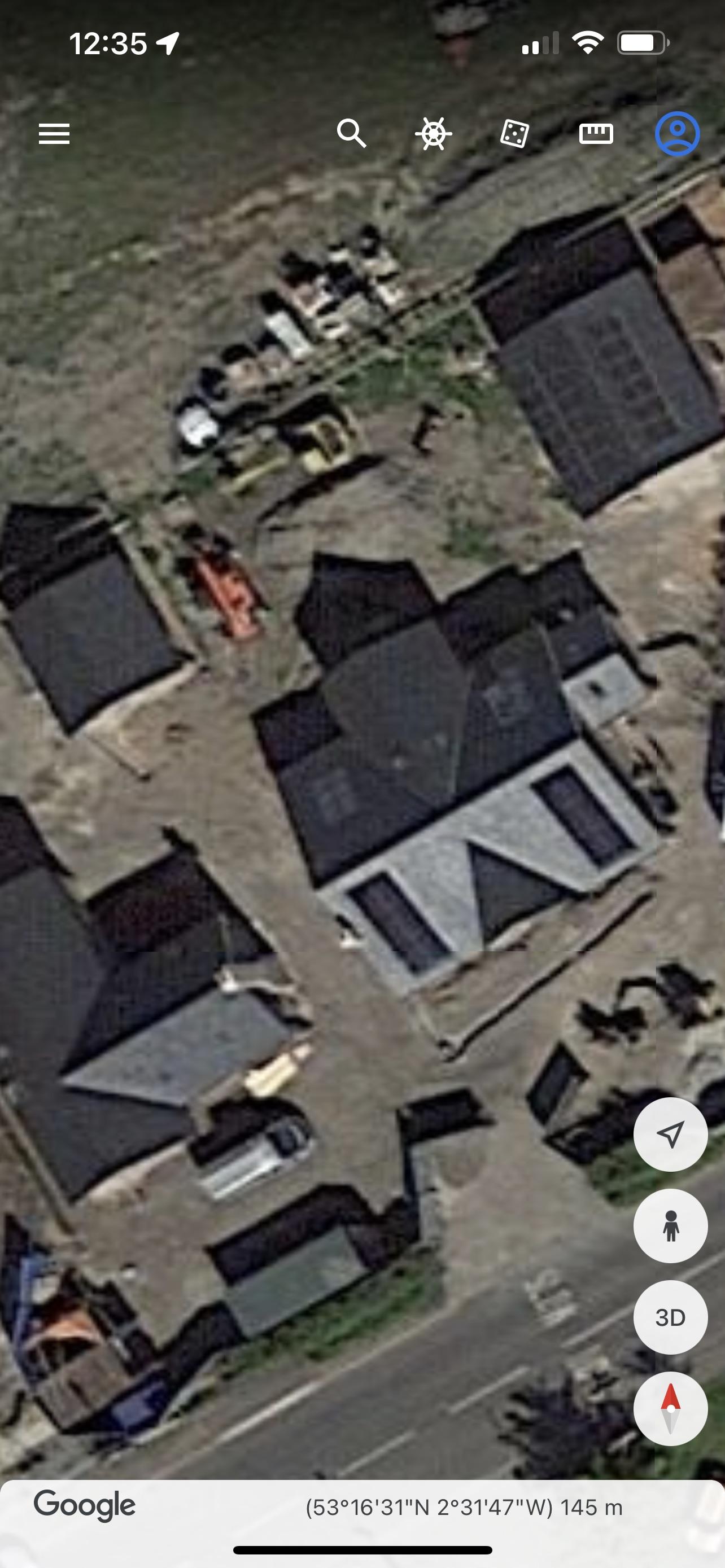

Ferdinand Posted July 19, 2022 Posted July 19, 2022 28 minutes ago, Johnnyt said: In terms of orientation of arrays, here’s my set up, the top being my garage roof these panels are 340w roughly east and west split with the lower panels being 325w all fully integrated roughly south facing. I’m happy with the performance and covers most of the day. I’m sorry about the clarity if the image. Can you do a Google satellite view clip?

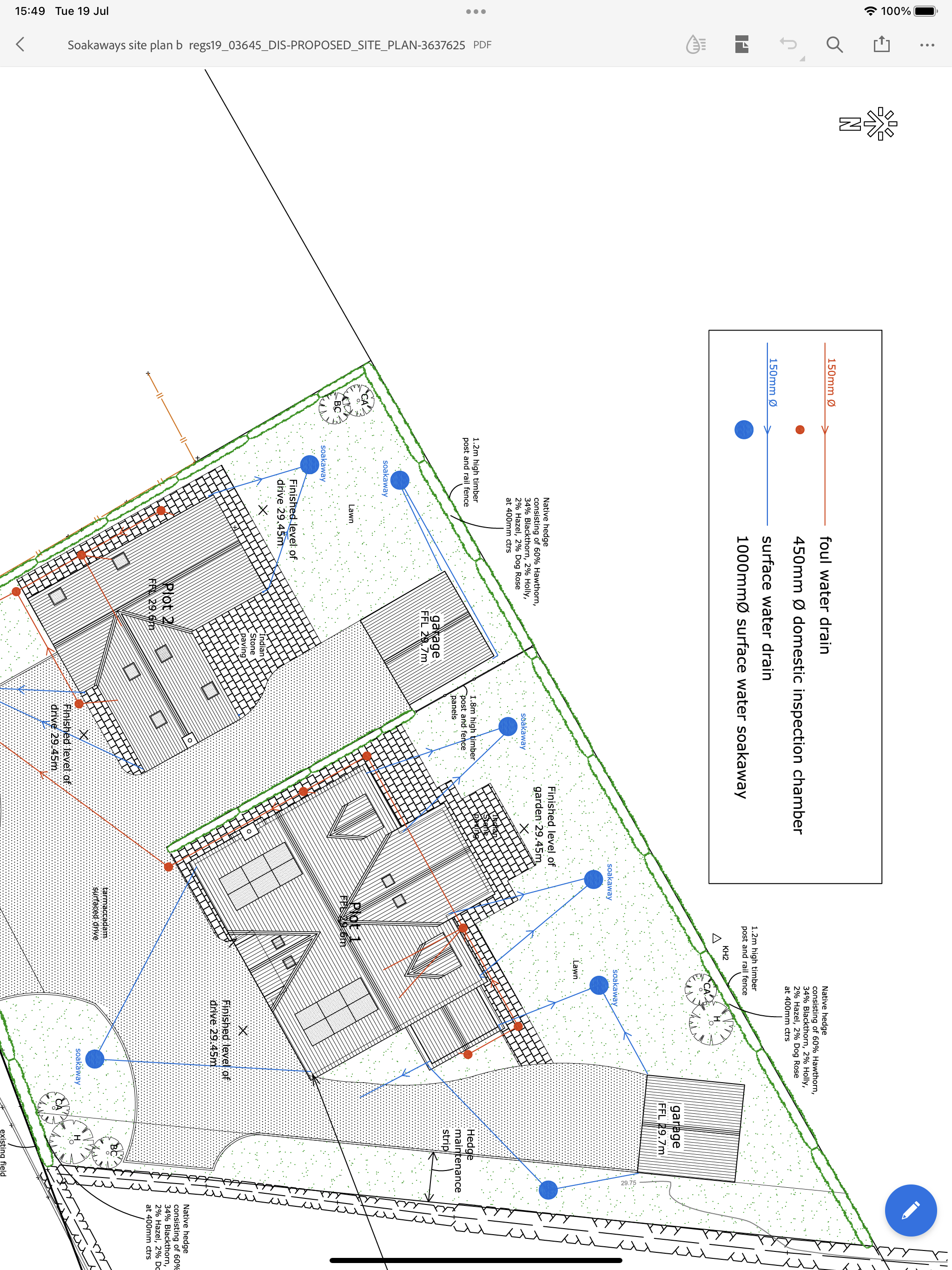

Alan Ambrose Posted July 19, 2022 Author Posted July 19, 2022 @Johnnyt Errr, with the various drone, solar planning and Google earth shots, I can't quite figure out which way is up. Google earth & solar planning - North is up? Drone shot - up is South East? Alan
Johnnyt Posted July 19, 2022 Posted July 19, 2022 (edited) North is as per the Google earth shot, N top image On the drone image the fence on the left hand side runs pretty much north south with the road being the southern end, part of site plan now added Edited July 19, 2022 by Johnnyt
