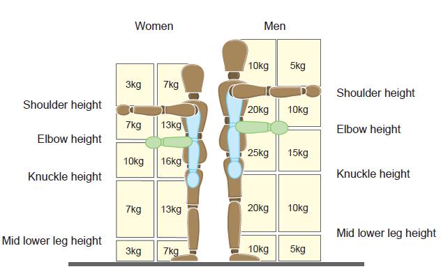

B52s Posted May 30, 2017 Share Posted May 30, 2017 Pushing health and safety legislation firmly to one side... I recently had reason to reference Figure 2 below from 'Getting to grips with manual handing' a short guide by the HSE and thought self-builders might also find the diagram useful, as I feel, everyone tends to lift and move goods, building materials, etc. well beyond the weight limit guidance noted in the diagram. Might be of particular interest to those in their autumn years who suffer occasional back issues like me. Figure 2 Lifting and Lowering Use Figure 2 to make a quick and easy assessment. Each box contains a guideline weight for lifting and lowering in that zone. (As you can see, the guideline weights are reduced if handling is done with arms extended, or at high or low levels, as that is where injuries are most likely to occur.) Observe the work activity you are assessing and compare it to the diagram. First, decide which box or boxes the lifter’s hands pass through when moving the load. Then, assess the maximum weight being handled. If it is less than the figure given in the box, the operation is within the guidelines. If the lifter’s hands enter more than one box during the operation, use the smallest weight. Use an in-between weight if the hands are close to a boundary between boxes. The guideline weights assume that the load is readily grasped with both hands and that the operation takes place in reasonable working conditions, with the lifter in a stable body position. Twisting Reduce the guideline weights if the handler twists to the side during the operation. As a rough guide, reduce them by 10% if the handler twists beyond 45°, and by 20% if the handler twists beyond 90°. Frequent lifting and lowering The guideline weights are for infrequent operations - up to about 30 operations per hour - where the pace of work is not forced, adequate pauses to rest or use different muscles are possible, and the load is not supported by the handler for any length of time. Reduce the weights if the operation is repeated more often. As a rough guide, reduce the weights by 30% if the operation is repeated once or twice per minute, by 50% if the operation is repeated five to eight times a minute, and by 80% where the operation is repeated more than 12 times a minute. 2 Link to comment Share on other sites More sharing options...
ProDave Posted May 30, 2017 Share Posted May 30, 2017 So I cannot (as a man working on my own) pick up anything heavier than 10Kg off the floor. If I stuck to that, my house would never get built, sorry not going to happen. We don't all have a helper on hand to assist. Welcome to the real world. Link to comment Share on other sites More sharing options...

ToughButterCup Posted May 30, 2017 Share Posted May 30, 2017 1 hour ago, B52s said: Pushing health and safety legislation firmly to one side... [...] In the spirit within which the post was intended, I hope, I had a careful look at the document to which your refer. Quite a few of us will, by now, be carrying niggles in various bits of our body. Guidance is always welcome. Reminders, useful. Useful because it points to what it is reasonable to expect. Here, in the context of self-building, it is a pointer to what we might reasonably expect of ourselves. I venture to suggest that our job is so challenging that if we were to worry about ourselves all that much, the job wouldn't even start, let alone get done. @ProDave, I think the issue is how much we lift in relation to where on our body: thus 25kg seems to be the most we are advised to lift: say a bag of cement tucked on our hip..... , well we have two of those and most of us I bet would tuck one under each arm - 50kg. That's a fair bit. Link to comment Share on other sites More sharing options...

Ferdinand Posted May 30, 2017 Share Posted May 30, 2017 (edited) That diagram does not seem to involve bending at the knees (?) F Edited May 30, 2017 by Ferdinand Link to comment Share on other sites More sharing options...

Jeremy Harris Posted May 30, 2017 Share Posted May 30, 2017 Guidance is great, it informs and educates, and with luck may well be followed. Sadly regulation is not so good, as there are just far too many situations where a job would never get done if the regulations were followed to the letter. There's also a massive variation between one person and another in terms of what is safe to lift. One chap I've used a fair bit to do a lot of the landscaping can lift 900 x 600 sandstone slabs all day without breaking sweat - I struggle to move half a dozen before I'm knackered! I worked alone on a lot of stuff, and had no choice but to shift things like a 60kg shower tray, or the 70kg MVHR, and similar mass Sunamp PV, up to the first floor on my own. I did devise ways to do this relatively safely, with a block and tackle for the MVHR, and slings to help shift the other stuff. H&S&W didn't apply, as it was me working on our own house, but it's interesting that the obviously risky stuff, like lifting heavy stuff, hasn't been the cause of any minor injuries. Those have come from seemingly safe looking jobs, where I didn't think through how to tackle them properly beforehand. I ended up with a persistent wrist injury from moving planks of left over larch, for example. None were very heavy, but the twisting motion when shifting the pile from one side of the drive to the other managed to cause an injury to a tendon that took months to heal properly. Link to comment Share on other sites More sharing options...
Barney12 Posted May 30, 2017 Share Posted May 30, 2017 2 hours ago, ProDave said: So I cannot (as a man working on my own) pick up anything heavier than 10Kg off the floor. No. You are misreading the diagram. It means don't lift more than 10kg with your foot Link to comment Share on other sites More sharing options...
ToughButterCup Posted May 30, 2017 Share Posted May 30, 2017 1 hour ago, Barney12 said: [...] It means don't lift more than 10kg with your foot 2 feet, ergo 20Kg.... No? Similarly 15Kg with your head : 10 with your forehead, 5 with your nose Link to comment Share on other sites More sharing options...

daiking Posted May 31, 2017 Share Posted May 31, 2017 I've always understood these as guidance, not maximums but I shouldn't be designing kit or processes that exceed them without very good reason. Something I read recently in a toolbox talk type LFE was that guys in their 50s are 4 times more likely to have an accident than those in their 20s and 30s. The particular chap who was the focus of the TBT was a 50-something American chippie who fell down a lift shaft. Link to comment Share on other sites More sharing options...
