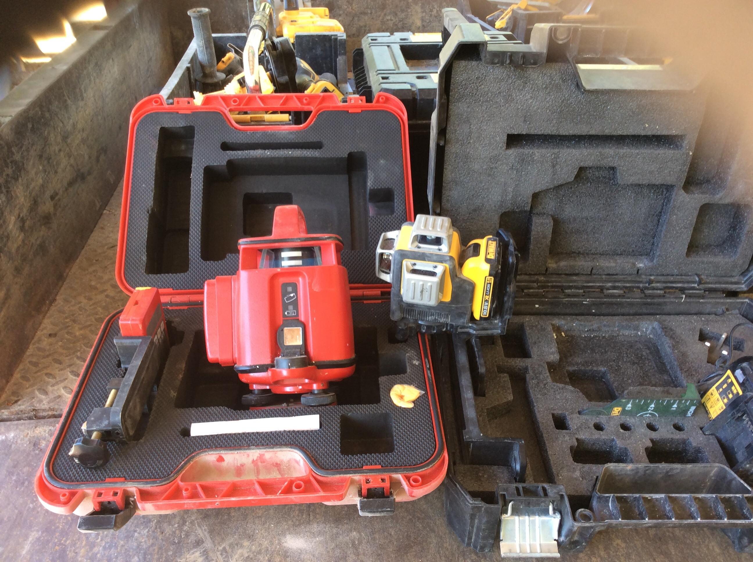

MortarThePoint Posted June 16, 2022 Posted June 16, 2022 I've more lasers than make sense to be honest (no sharks with lasers on their heads though). I bought a cheap rotary laser from China (see red one below, £175 at the time) but I wouldn't recommend it as it had an issue straight out of the box. I was able to fix it and have tested it's accurate. Like with a spirit level, it is important to know how to regularly check this sort of device as you don't want to find out later that there is a problem. When I have done surveying I have repeated the process twice with the rotary laser in two different places and checked that the sets of readings agree. As I am a massive geek, I have also used homebrew RTK-GPS for surveying which works nicely for plan, but not so well for elevation. There are various non-rotary 3D lasers that have a pulsing feature. The pulsing allows you to use it with a detector when light levels and distance are too great to see it by eye. I've never used the glasses which could help under that situation. I have a Huepar one which supports the pulsing. I've never used that feature, but at dusk or in the dark it throws the laser a very long way. I thought this laser was good enough to by a second one when I smashed the first falling off a ladder. I got it from Amazon for £160 but it's now £145 (https://amzn.to/3mSTxaV note that's an affiliate link but doesn't cost you more). 1
dpmiller Posted June 16, 2022 Posted June 16, 2022 ^ I've the green version of the rotary above and it's very good.
