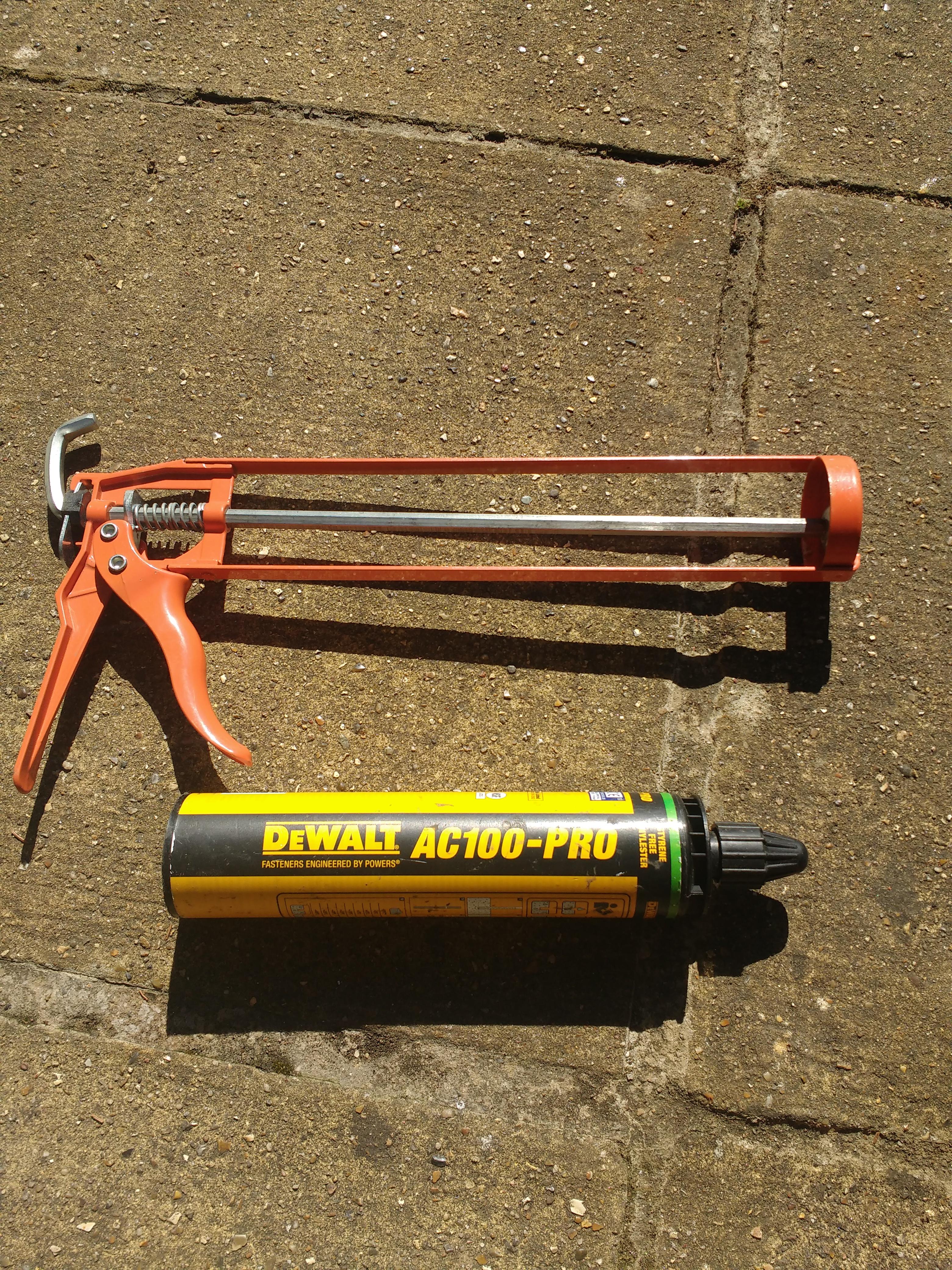

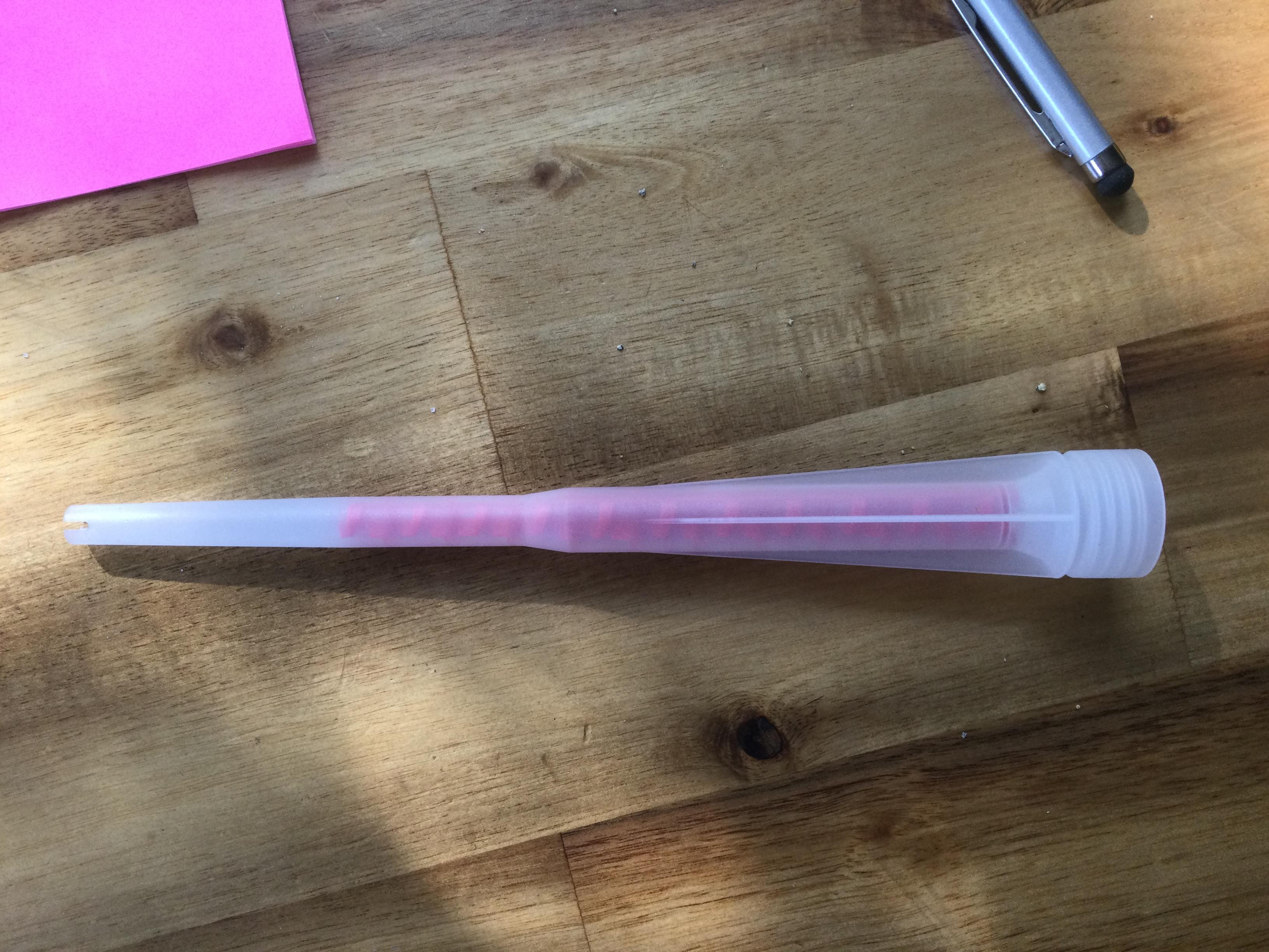

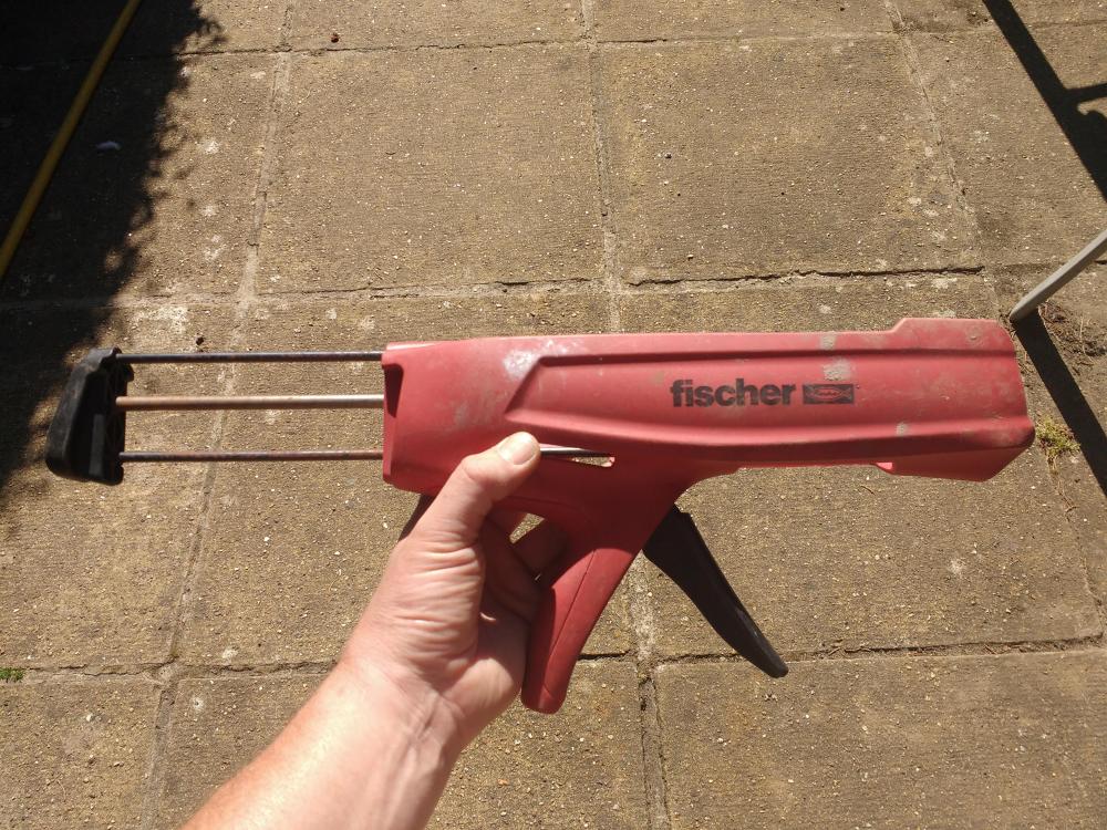

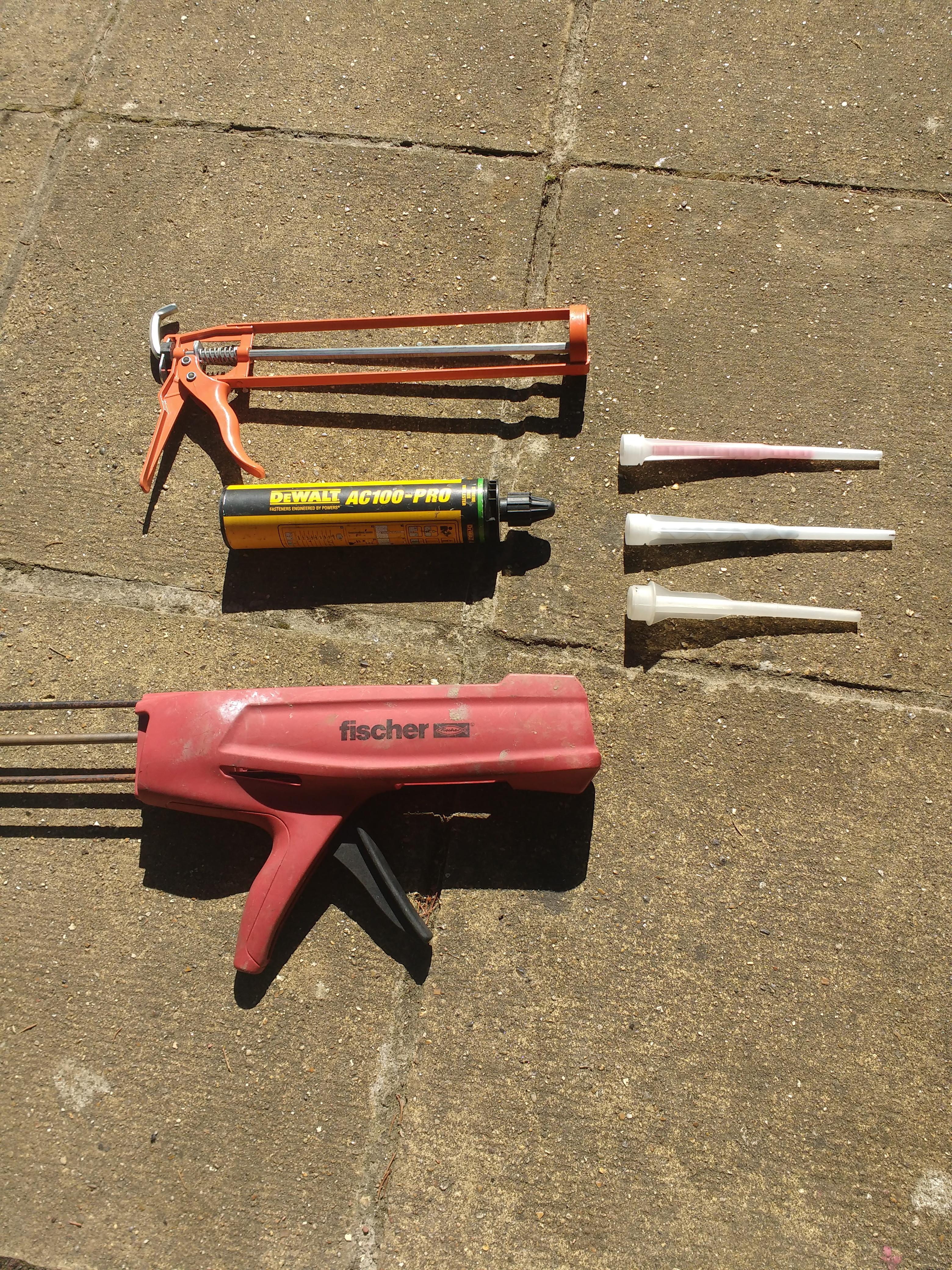

zoothorn Posted August 6, 2022 Author Share Posted August 6, 2022 @Onoff one other question: could you remind me of the fisher resin stuff ? Just looked & many different ones. I used on my cabin pads to anchor in 10mm studs. I'm sure I used my standard gun. And it was one normal size tube of stuff, I don't recall an extra grey smaller tube that 'mixes in' attatched to it. This is a nozzle that came with it.. Link to comment Share on other sites More sharing options...
zoothorn Posted August 6, 2022 Author Share Posted August 6, 2022 I wonder if it was this one.. " fischer P 380 " https://www.toolstation.com/fischer-styrene-free-resin/p21098 Searched my cabin basework/ slope thread, but the screwfix link n/a, & I can't find which reply suggested the stuff.. but I think it was @Onoff ? Thanks, zh Link to comment Share on other sites More sharing options...

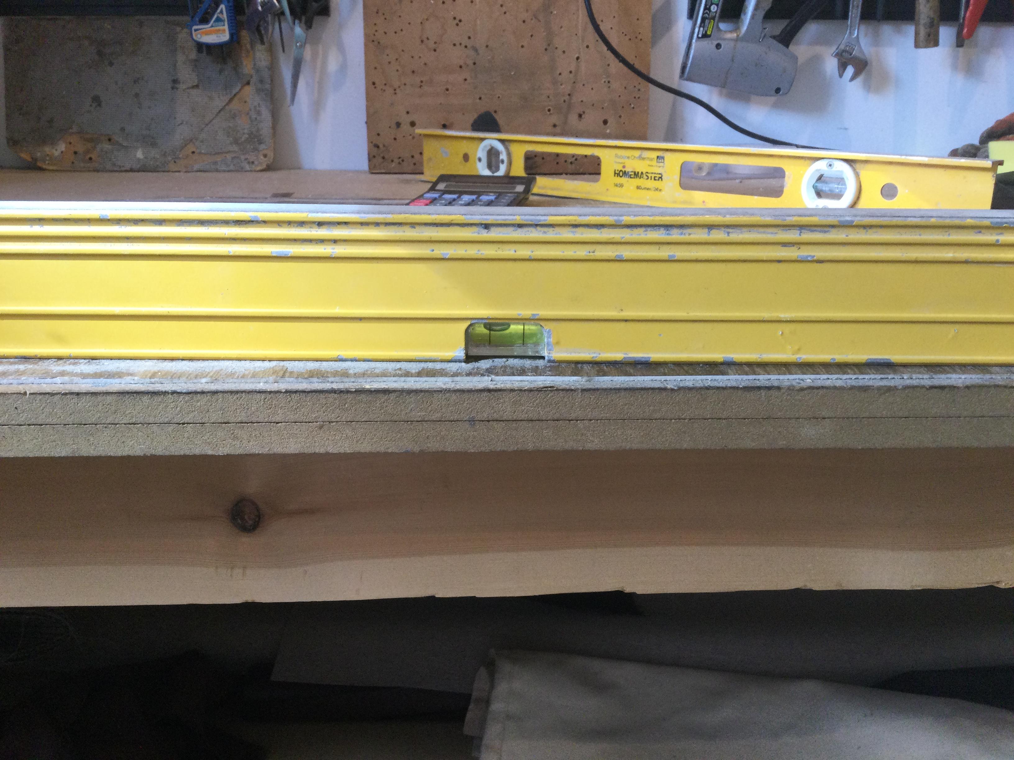

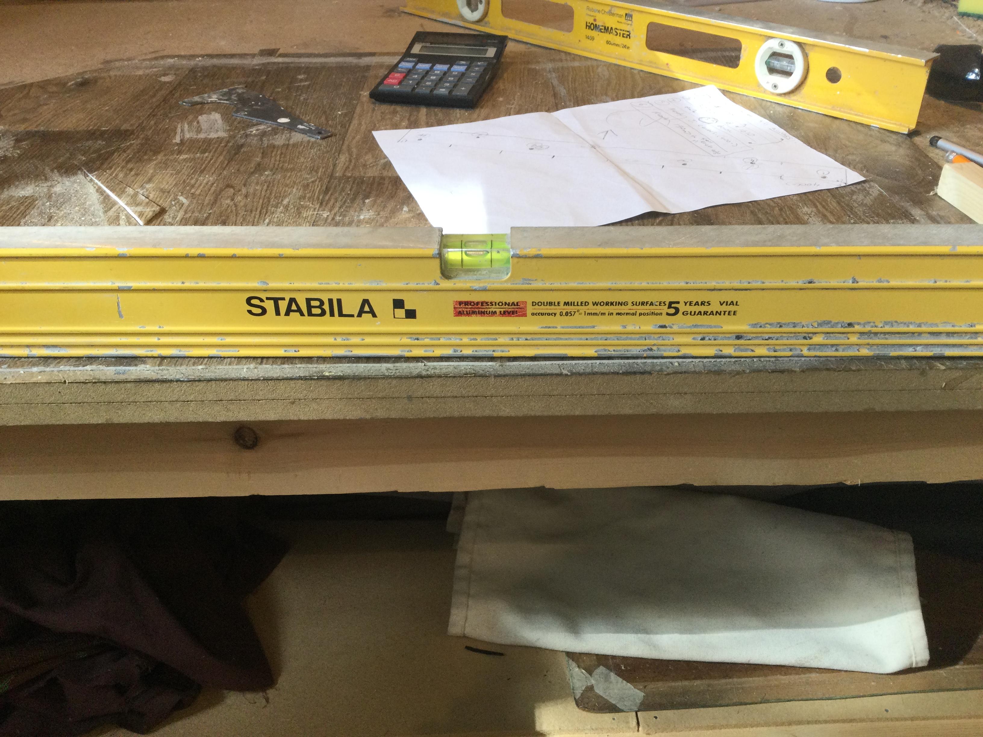

zoothorn Posted August 6, 2022 Author Share Posted August 6, 2022 Someone help me out here, wtf is going on.. My level bubble as expected, centred 1st pic.. then I just turn level upside down, & bubble way off. Both flat edges clean, no spot of mortar the cause. Level in ok general condition. Eh?! Frying my noggin. Link to comment Share on other sites More sharing options...
PeterW Posted August 6, 2022 Share Posted August 6, 2022 1 minute ago, zoothorn said: Someone help me out here, wtf is going on.. My level bubble as expected, centred 1st pic.. then I just turn level upside down, & bubble way off. Both flat edges clean, no spot of mortar the cause. Level in ok general condition. Eh?! Frying my noggin. vial is only parallel to the bottom face. That’s the one you should always use. Link to comment Share on other sites More sharing options...

zoothorn Posted August 6, 2022 Author Share Posted August 6, 2022 19 minutes ago, PeterW said: vial is only parallel to the bottom face. That’s the one you should always use. Hi there Peter. So the first pic correct/ discount the 2nd pic way then.. Thank goodness. Btw whilst you're there: do you recognise this as the stuff suggested & I used on my cabin pads? https://www.toolstation.com/fischer-styrene-free-resin/p21098 Thanks, zh Link to comment Share on other sites More sharing options...

zoothorn Posted August 6, 2022 Author Share Posted August 6, 2022 (edited) I seem to have many similar fischer resin options: 1. https://www.screwfix.com/p/fischer-fis-p-plus-polyester-hybrid-mortar-injection-resin-380ml/552jj 2. https://www.screwfix.com/p/fischer-fis-p-plus-polyester-hybrid-mortar-injection-resin-300ml/898jj 3. https://www.toolstation.com/fischer-styrene-free-resin/p21098 4. https://www.toolstation.com/fischer-fip-300-sf-styrene-free-resin/p10001?store=W8&utm_source=googleshopping&utm_medium=feed&utm_campaign=googleshoppingfeed&mkwid=_dc&pcrid=&pkw=&pmt=&gclid=Cj0KCQjworiXBhDJARIsAMuzAuy4VI4wGgmASXDkPbpSDcUqUtXJPjVItUMwkO4UbZ44Br8xaW_El6QaAusaEALw_wcB&gclsrc=aw.ds And 3 more Fischer options are "vinylester" resins at toolstation too. Im a bit overwhelmed. Thanks zh Edited August 6, 2022 by zoothorn Link to comment Share on other sites More sharing options...

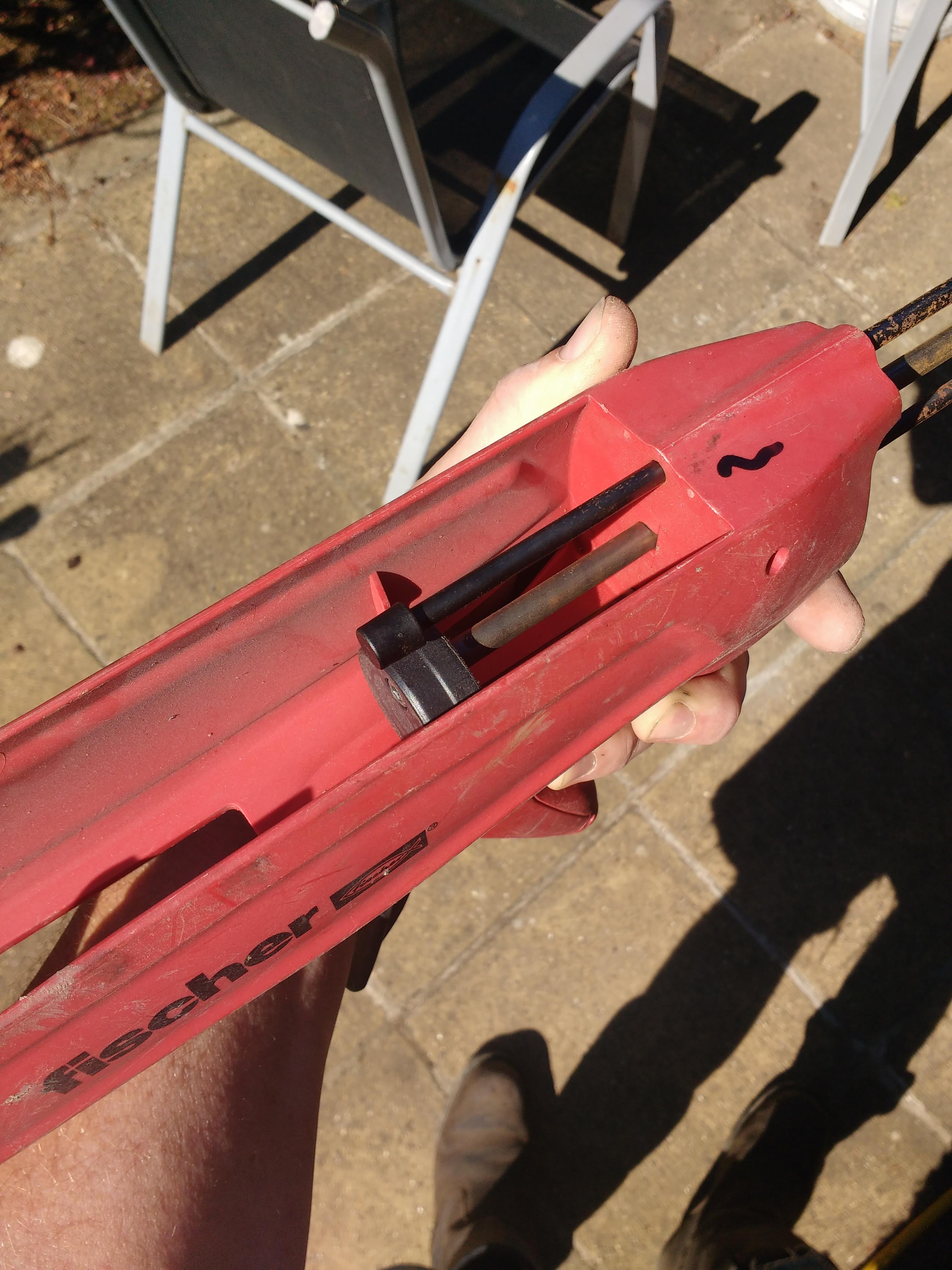

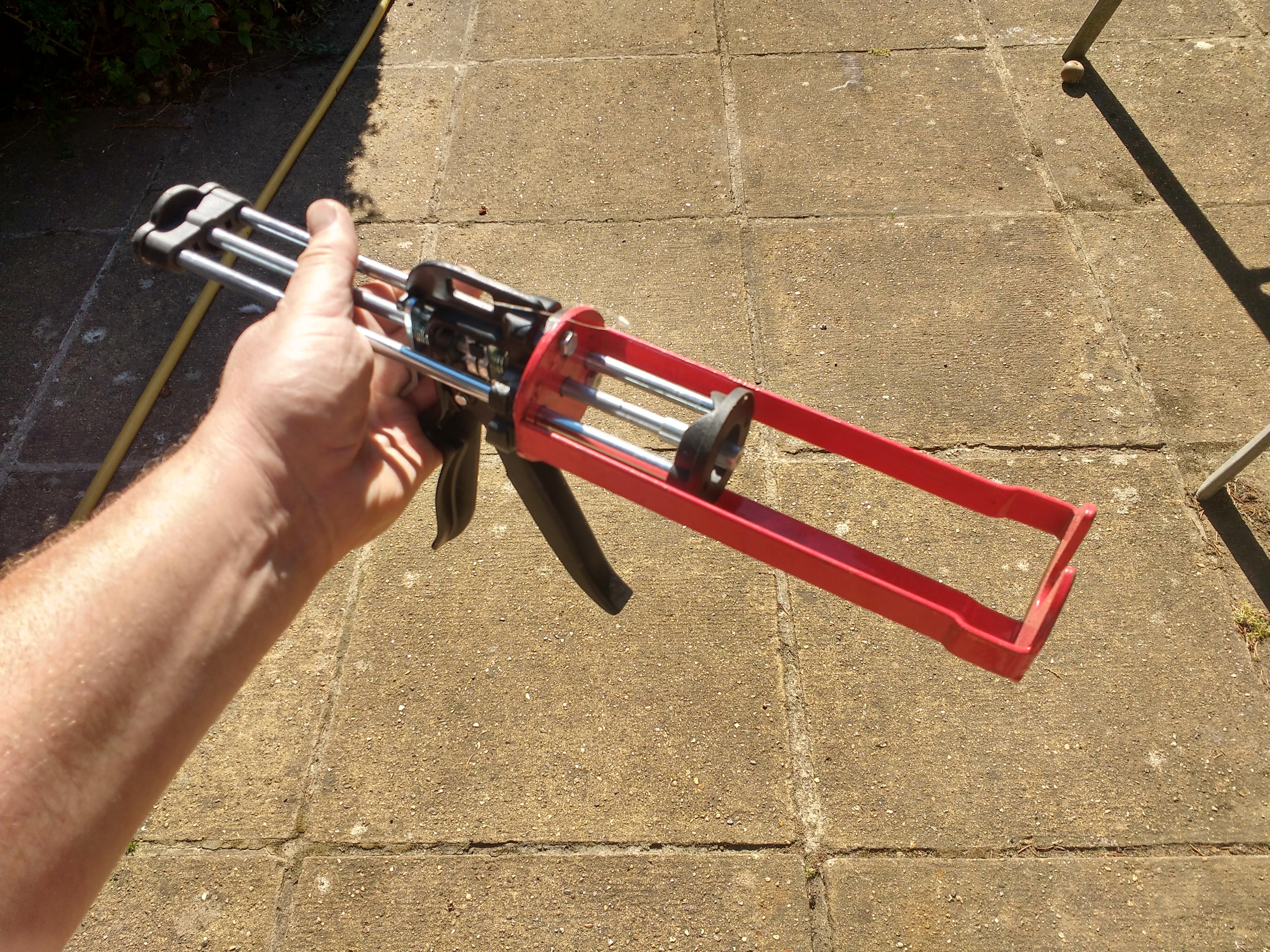

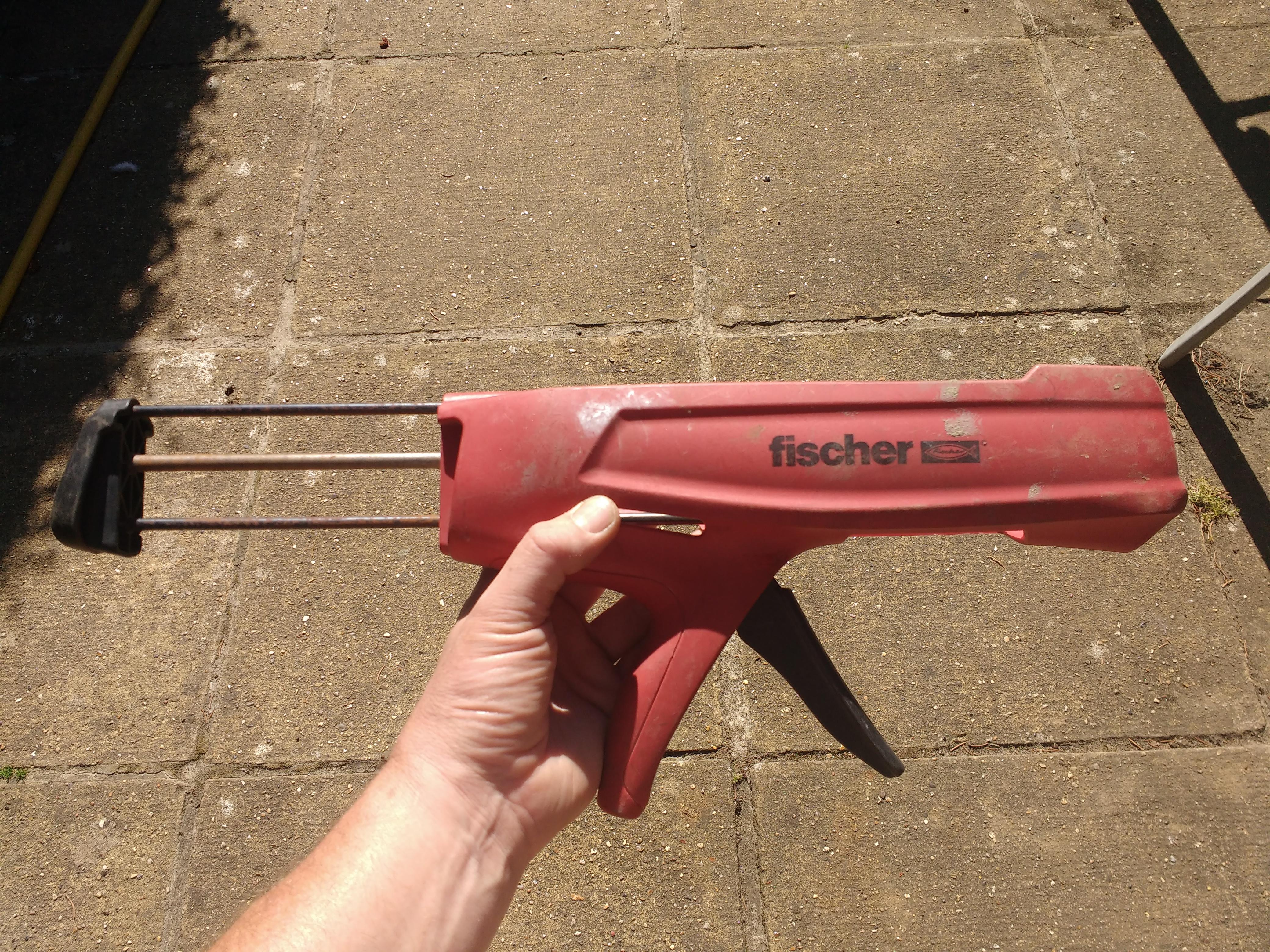

Onoff Posted August 6, 2022 Share Posted August 6, 2022 Resin guns... Traditionally these were the preserve of industry as was resin technology. At one time, even now in some places, the resin came in a glass capsule like a test tube. That contained the resin and hardener, separated until you used it by an internal wall. Then you drilled your hole, blew the dust out and popped in the glass phial. You then drove your stud in on a drill that would break the phial and mix the resin, hardener and broken glass up, which would then set around the stud. Think I last used those around 1987! Then you have resin "guns". Guns like this that take big, chunky, 380ml+ "oversize" cartridges were common. This I think from memory is a Fischer compatible one. All metal, takes a resin cartridge about 3" diameter: I favour my other Fischer one. This is the h.duty plastic bodied gun. You'll note is has two plungers: It's used with a special cartridge. The same diameter as a normal "tube of mastic" but with a piggy back tube on. Not cheap, about £16 a tube from Screwfix: The resin is in the main body, the hardener in the grey tube. As you operate the gun both plungers operate pushing out a controlled amount of each. These enter the nozzle where the plastic screw mixes them. The gun is a pleasure to use. Of course, the DIY sector wanted access to the technology and they wanted it easy. Thus you can get resin in a standard size tube that goes in a standard gun, like this. The tube is divided internally to contain resin and hardener that only come together when pumped out and mixed. Whether my Space Shuttle type piggy back Fischer one, or a standard mastic gun one they all take a bigger nozzle with integral, mixing screw. Three different nozzle makes shown: The DIY ones are OK. A bit harder maybe, to squeeze the gun etc. I'd go for a name tbh, something like this: https://www.screwfix.com/p/fischer-fis-vl-300-t-vinylester-resin-300ml/3613x You might need extra nozzles and a puffer to clean out the holes is an absolute must have. 1 Link to comment Share on other sites More sharing options...

Marvin Posted August 6, 2022 Share Posted August 6, 2022 48 minutes ago, zoothorn said: Someone help me out here, wtf is going on.. My level bubble as expected, centred 1st pic.. then I just turn level upside down, & bubble way off. Both flat edges clean, no spot of mortar the cause. Level in ok general condition. Eh?! Frying my noggin. You can check the bubble works by putting the level up the right way and comparing the bubble position as it is, and turning it around front to back and putting it back it the same place as before and the bubble then. If they're the same then everything's fine. Link to comment Share on other sites More sharing options...

zoothorn Posted August 6, 2022 Author Share Posted August 6, 2022 8 minutes ago, Marvin said: You can check the bubble works by putting the level up the right way and comparing the bubble position as it is, and turning it around front to back and putting it back it the same place as before and the bubble then. If they're the same then everything's fine. Of course!! Christ I'll get me coat.. Thanks Marvin. But still.. why the dickens wouldn't the bubble be centred simoly flipping it upside-down though?! Lord knows. But its doing my head in. Link to comment Share on other sites More sharing options...
dpmiller Posted August 6, 2022 Share Posted August 6, 2022 the glass phial may be curved or tapered, Zoot. Link to comment Share on other sites More sharing options...
