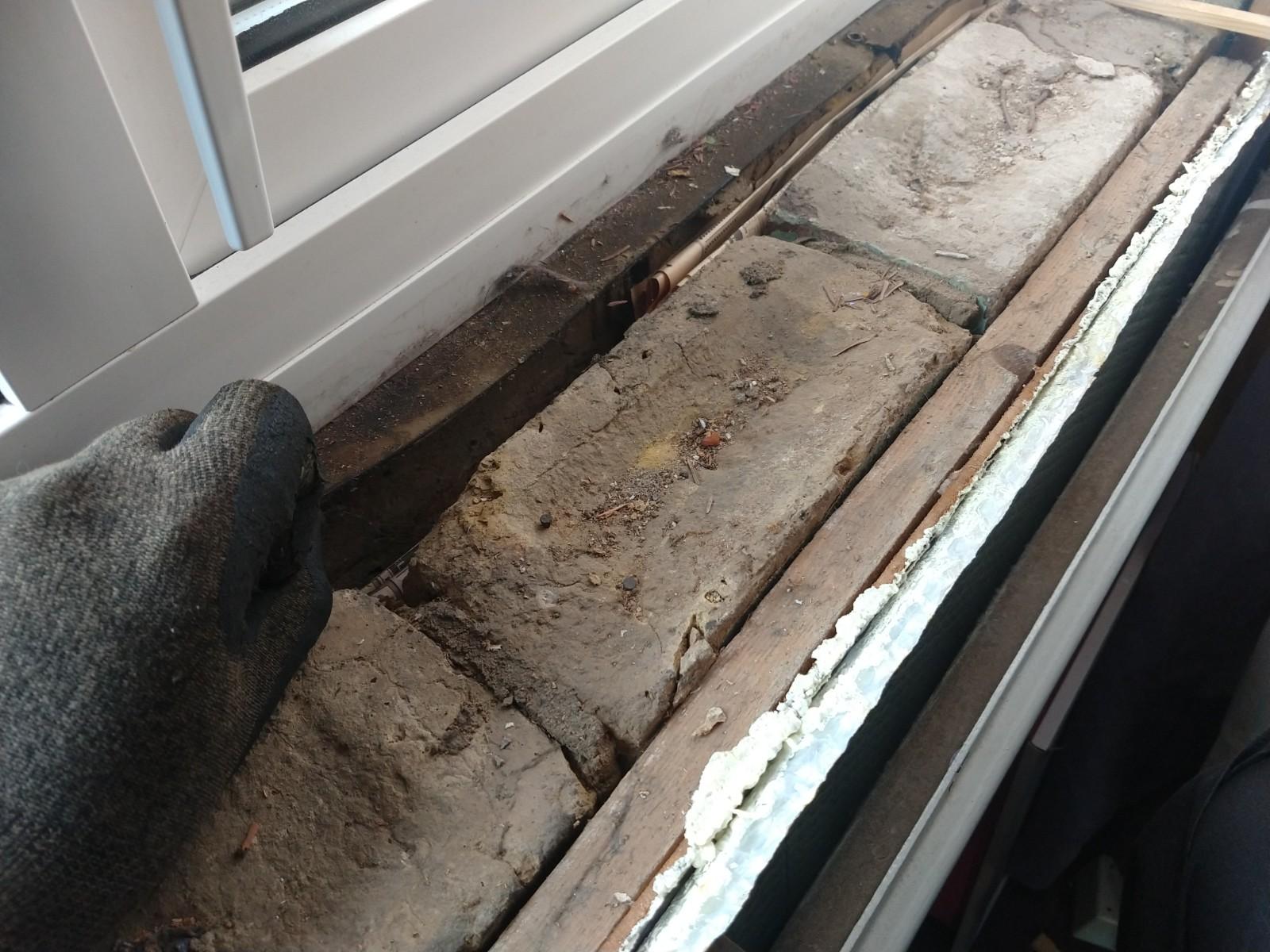

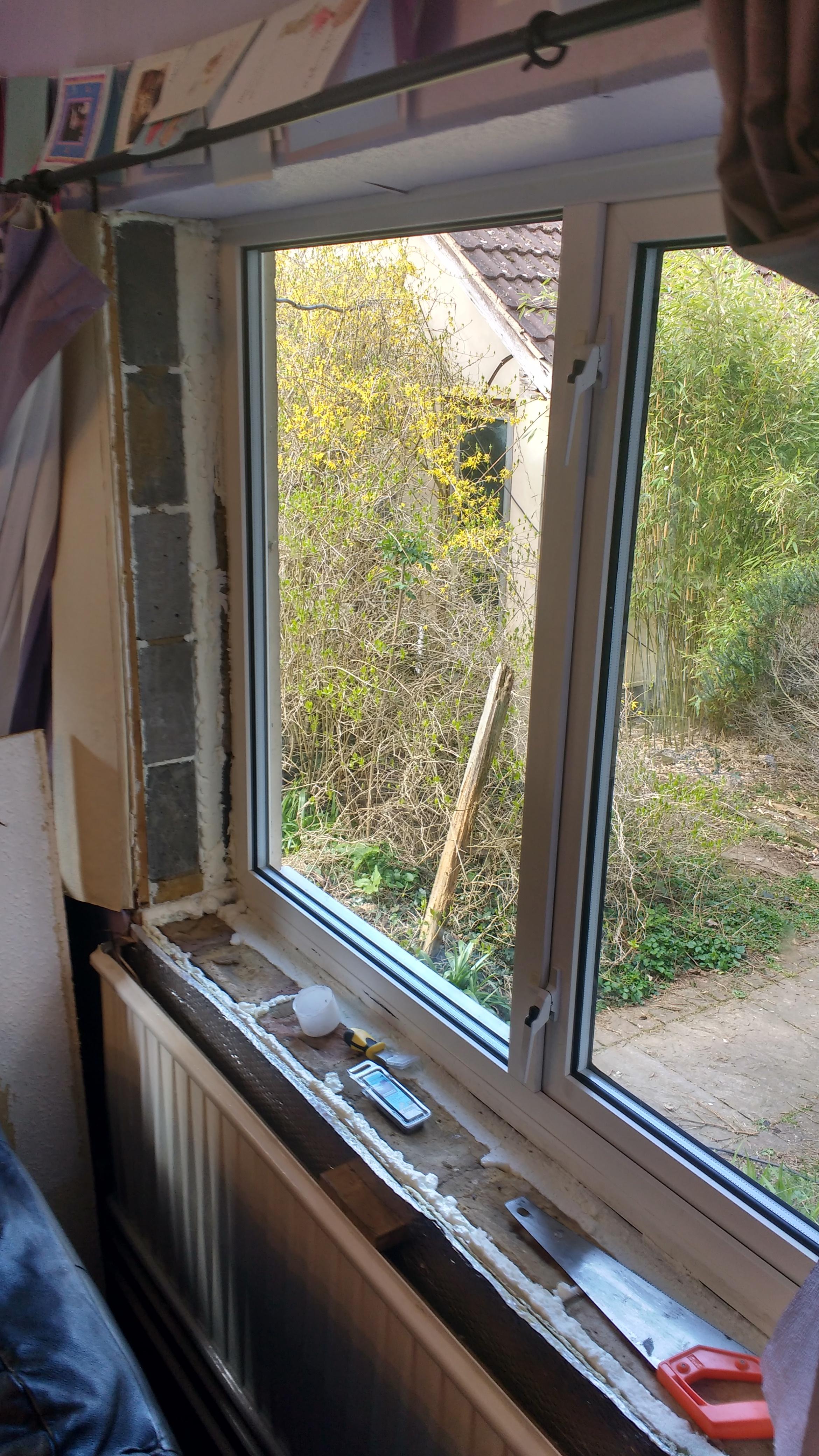

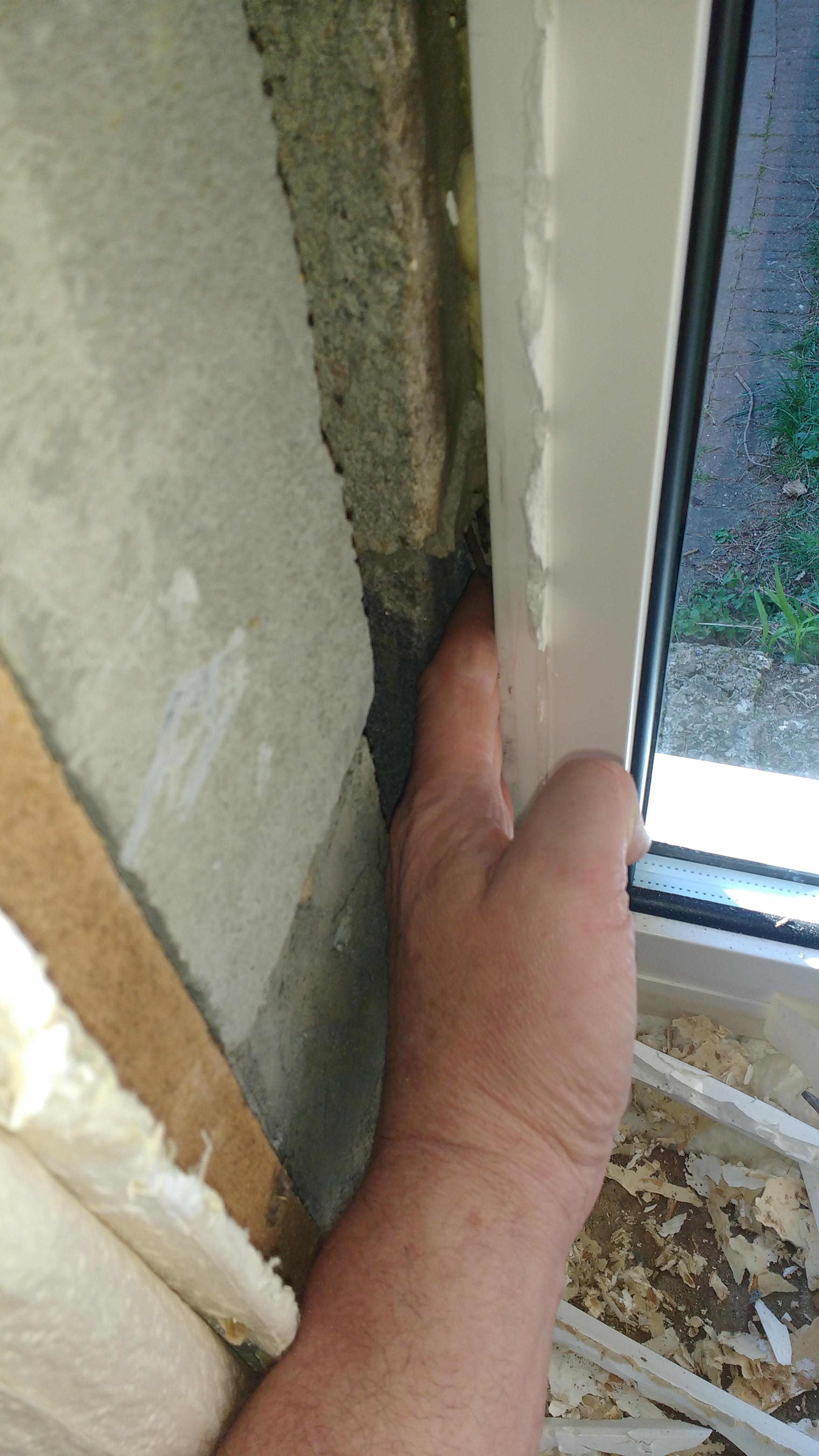

Since VVP invaded we've had the oil central heating off and subsequently been freezing. Running a 2kW fan heater in the lounge, a convector in the study and got a couple of oil filled rads as and where needed.
Let's be honest we've all been spoilt for years with cheap energy but now it's really hit home how badly insulated my house is.

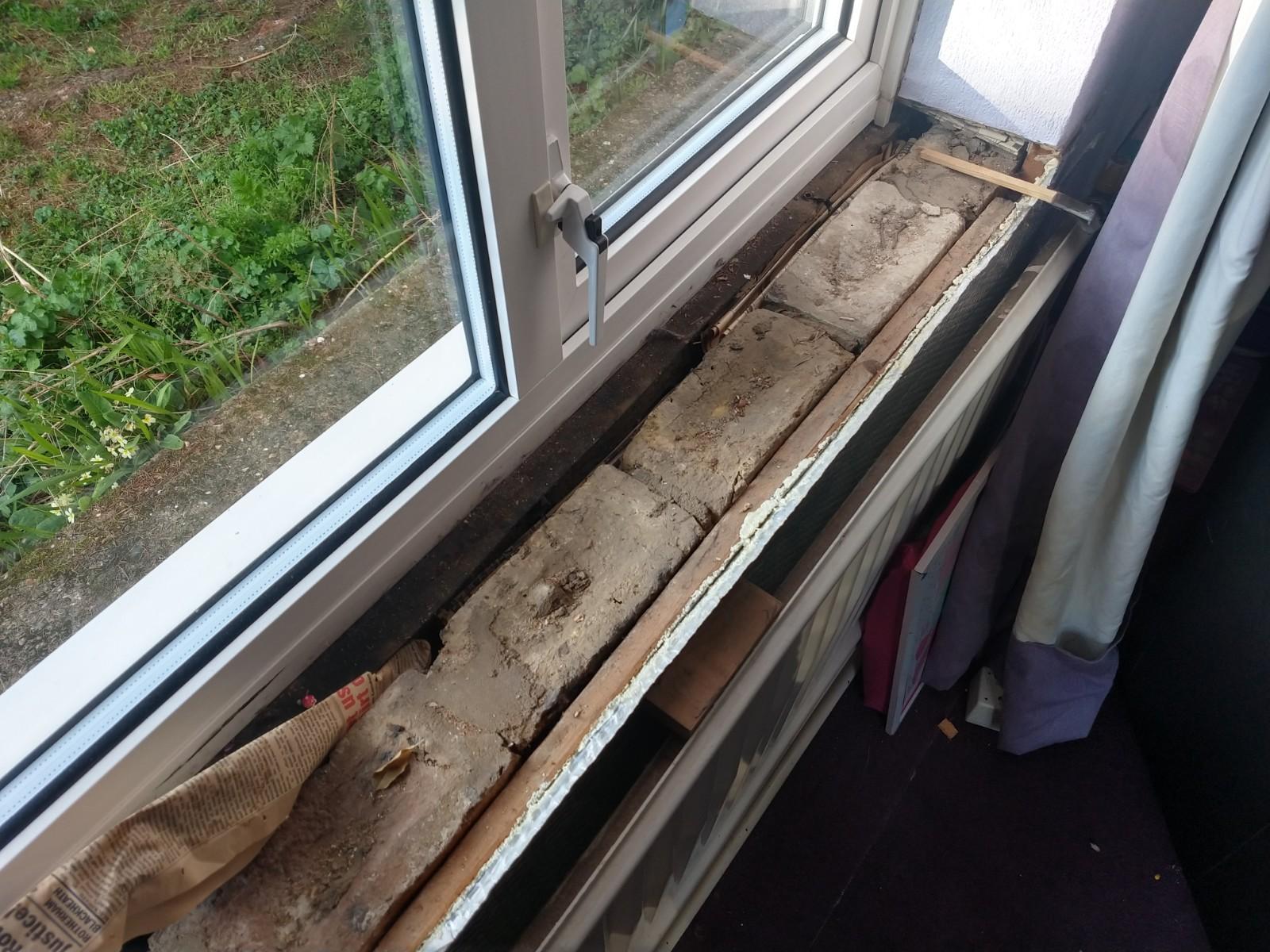

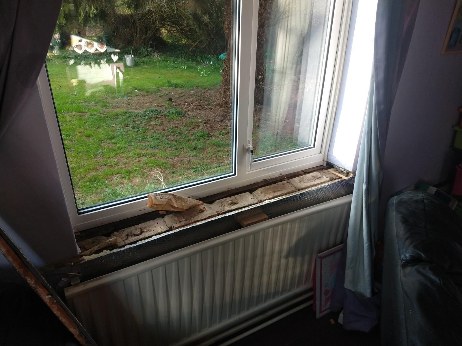

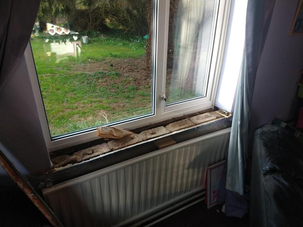

The lounge is proper cold. Because of the house orientation it is often colder inside than out. Convinced I could feel a draught around the window I pulled the lounge sill off and there was a gale coming up the cavity (we've external brick vents). Then I stripped the trims off and the boards lining the reveal which were 5/8" chipboard.
Cavity is only 35mm if that.

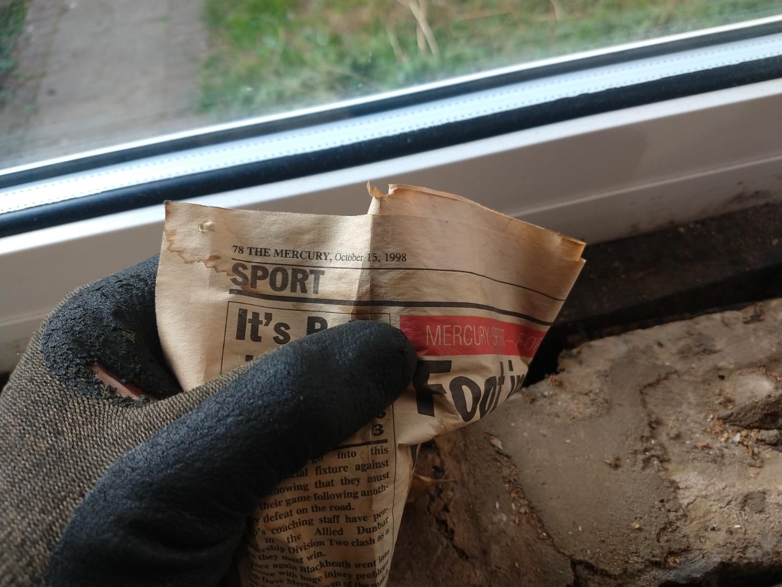

Existing cavity closers consist of The Mercury from October 1998! 😂
Gaps, oh yeah! :(

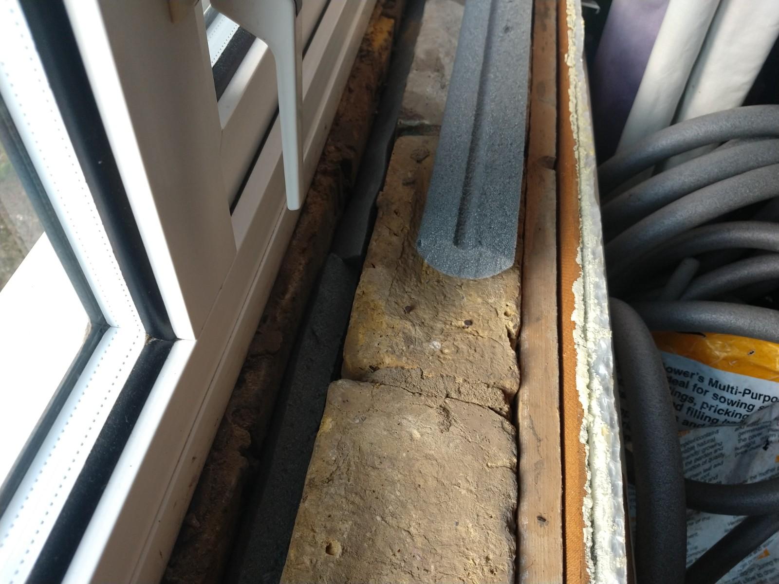

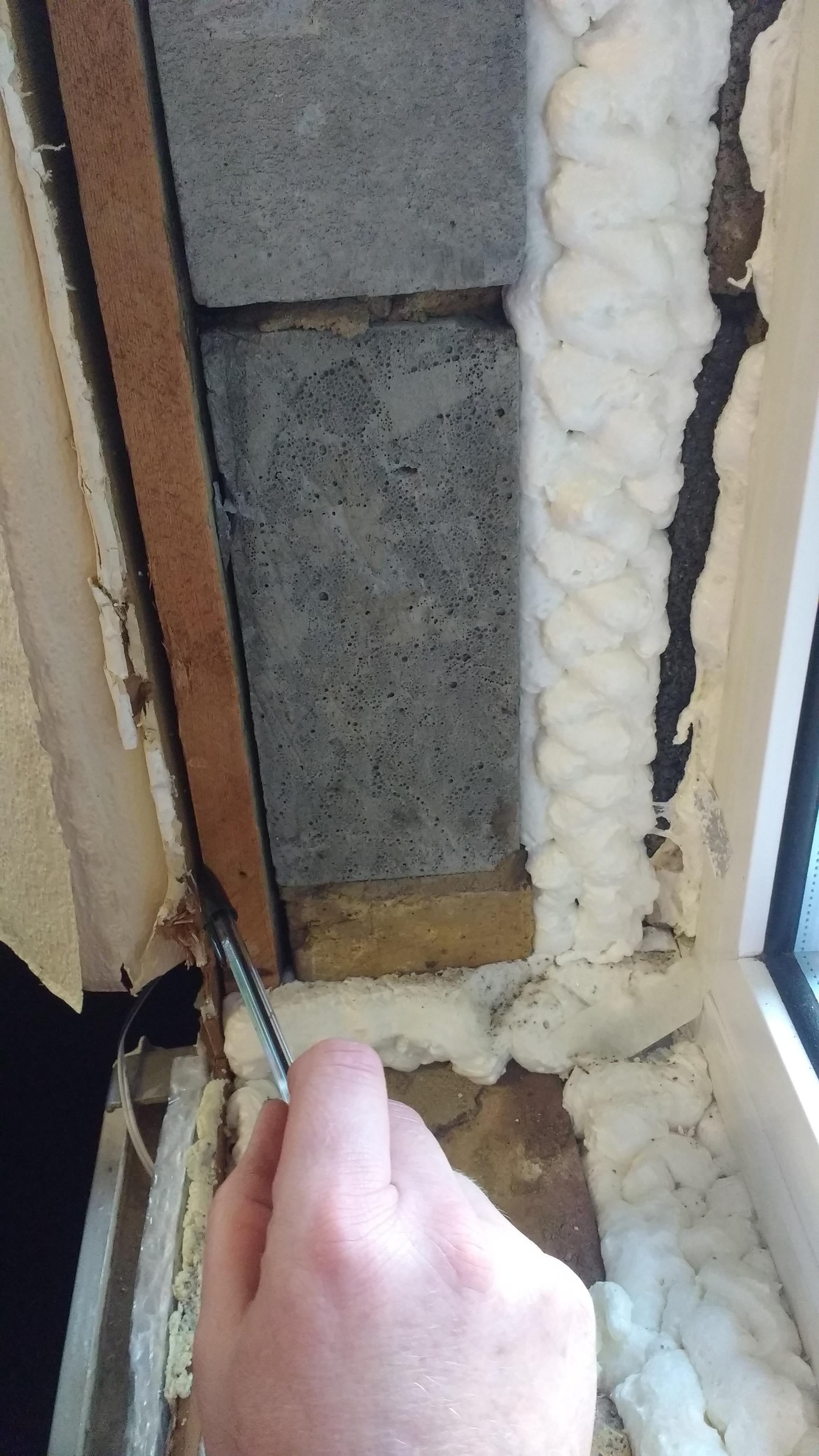

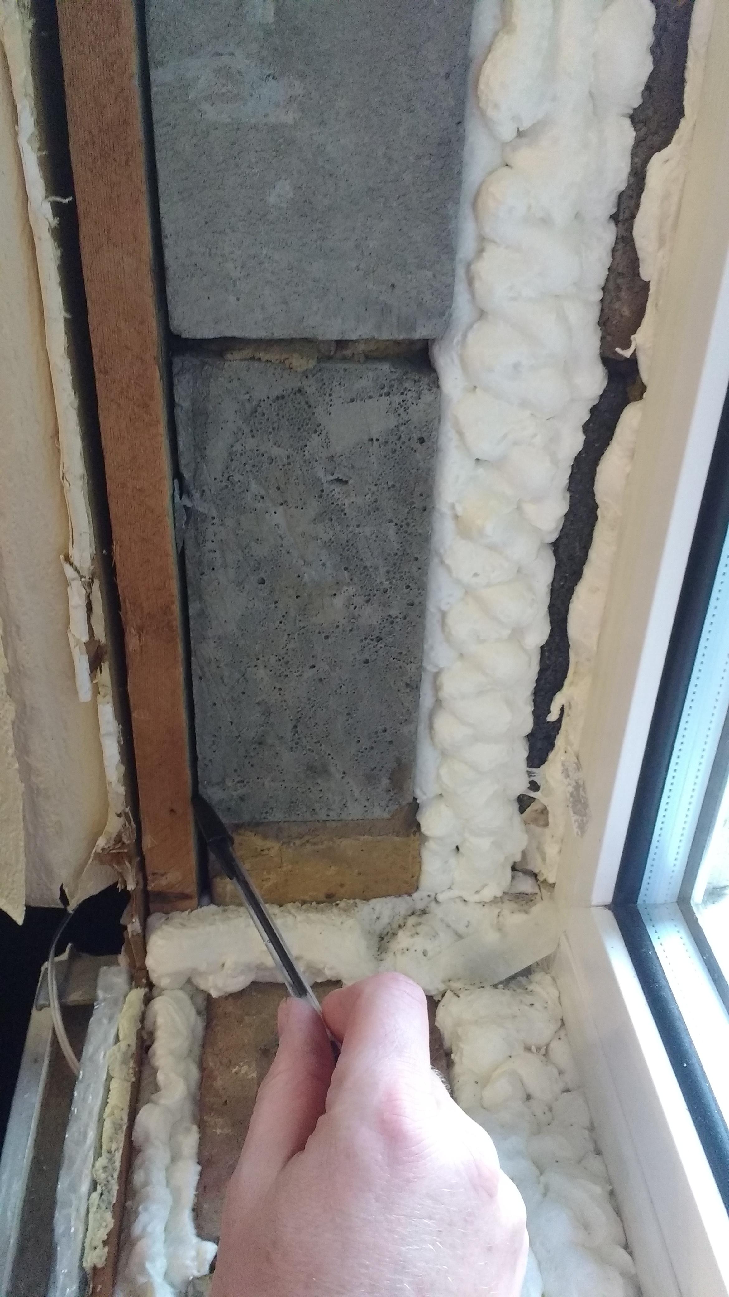

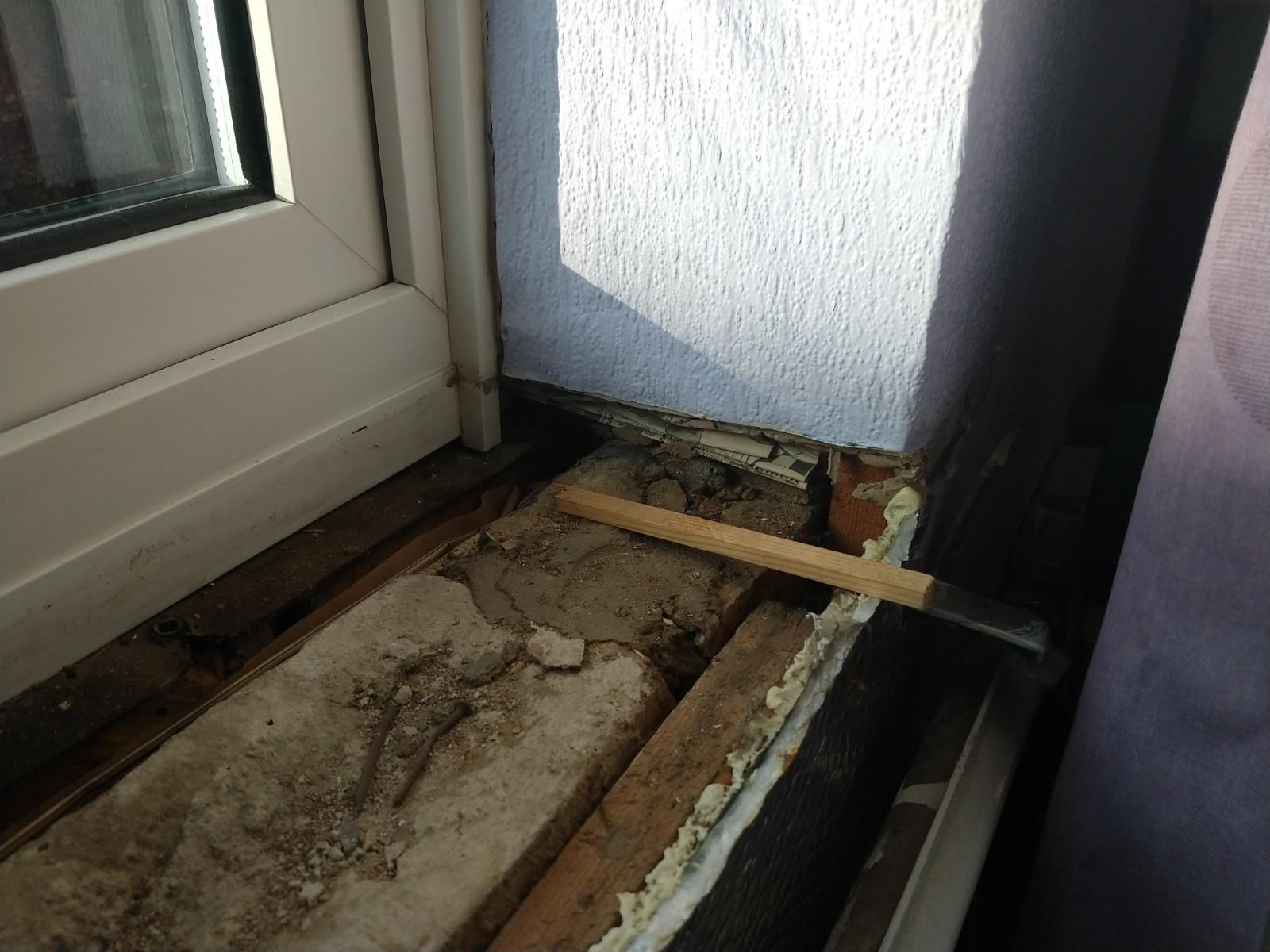

So far I've wedged some cut down pipe insulation in the cavity and foam filled. Going to line with some 25mm Celotex then pb over.
Sticking plaster really as the inner brick/block skin is 1" batten, hardboard then woodchip paper. Draughts are still coming through where I'm pointing the pen at.
I'd take the window out and move it inboard but where window sills are concerned SWMBO likes it deep!
Onward with this pointless journey!
The good old history of the building. I found a mixture of newspaper from 1927, the 1960s and the 1980s when pulling our place down. I wondered whether the builders had found the earlier stuff and thought that's how it's done and just copied it down the line.

Seriously though, turning the oil heating off and using electric resistance heating WILL be more expensive.  Unless your oil tank is running on vapour and you are baulking at paying current prices to refill it?
I agree.
4 minutes ago, ProDave said:
Knock down and rebuild
I also agree but not always possible within budget. Every little extra insulation/airtightness counts. The first inch of insulation does the most good then it’s diminishing returns so do what you can 👍

SWMBO just said "Can't we pay someone to do EWI?"
Wouldn't that bring its own set of issues doing it as the house is? It could only go up to the eaves (bungalow).
The paths, ground need lowering all round as in removing. The patio doors need replacing as does the front door. Then there's the mixed floors details, the noggin-less ceiling joists, the cracks. It just goes on and on.
SWMBO wouldn't go for the knock down / re-bulid I know.
Best I can aim for is the room at a time approach I've taken with two rooms so far. The study that was the old boot room is the warmest room in the house. That was just the single skin boot room I re-lined. It warms up and stays warm. Even there there's room for improvement.
I'm hopeful once there's some heat in the bathroom my attention to air tightness and insulation efforts pay off. The temperature is a constant all year round in there at the mo even at the height of Summer...bloody freezing!
