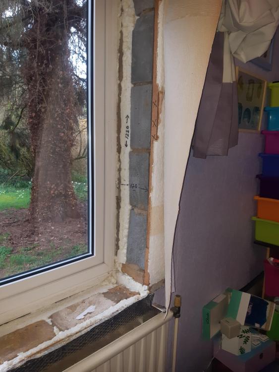

The original bungalow has 4x2 celing joists. The dormer is built on top. The bottom of the dormer floor joist sit way above the top of the original ceiling joists. The dormer is basically a frame that sits on padstones on the walls.
This is from when I gutted the downstairs bathroom (in Oct 2012 apparently). The downstairs wall plate / ceiling joists are just above the red bricks.
The dormer consists of a circas 9x6 frame sat on pad stones at the corners and in the middle. Padstone on the left, 9x6 running left to right (with the junction boxes tacked on). There's the centre pad stone just above that bit of corner mesh leaning against the wall.
There is mind an RSJ further in running left / right sort of mid dormer too.
I reckon then I could run MVHR ducts in the gap.

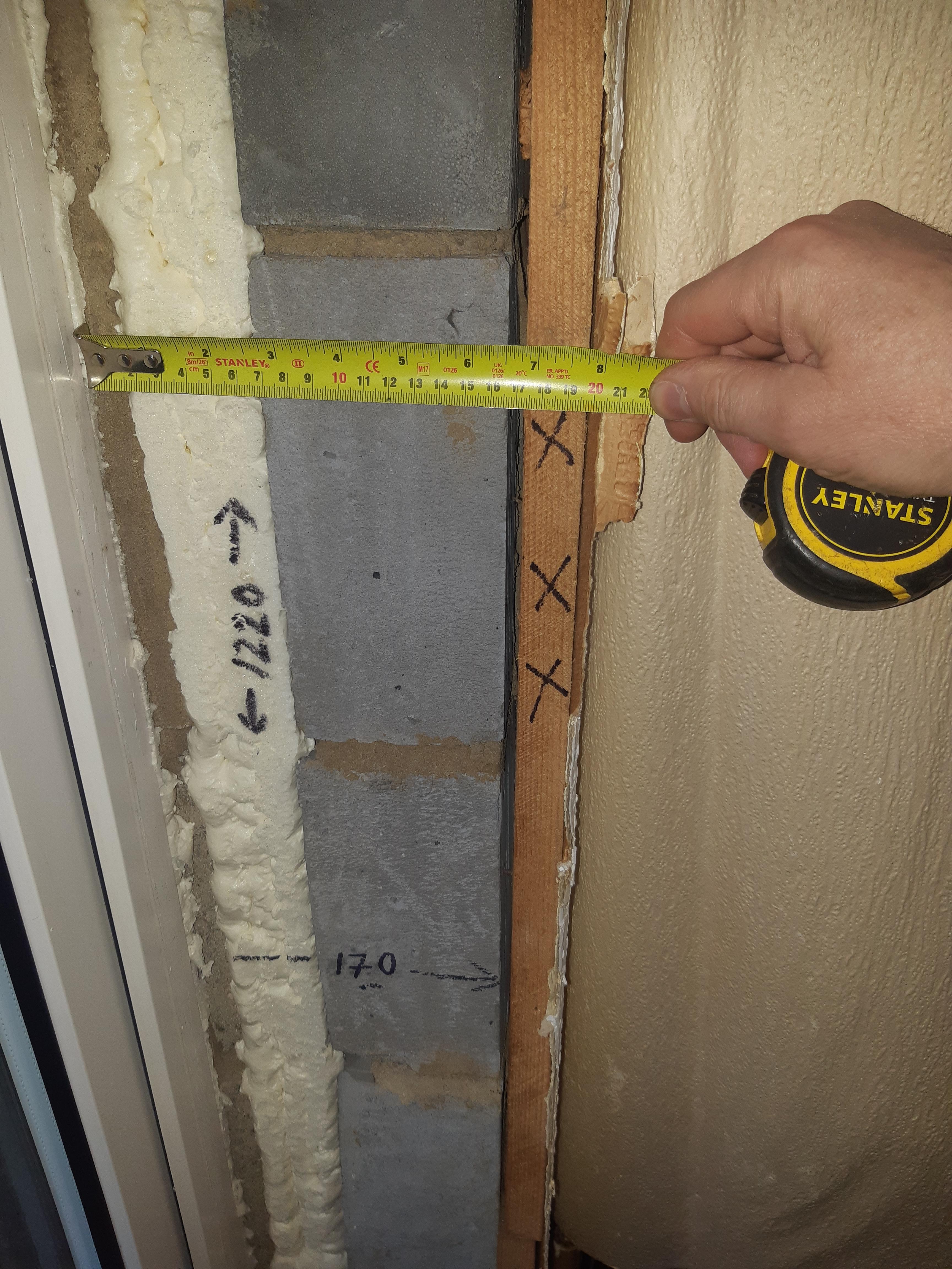

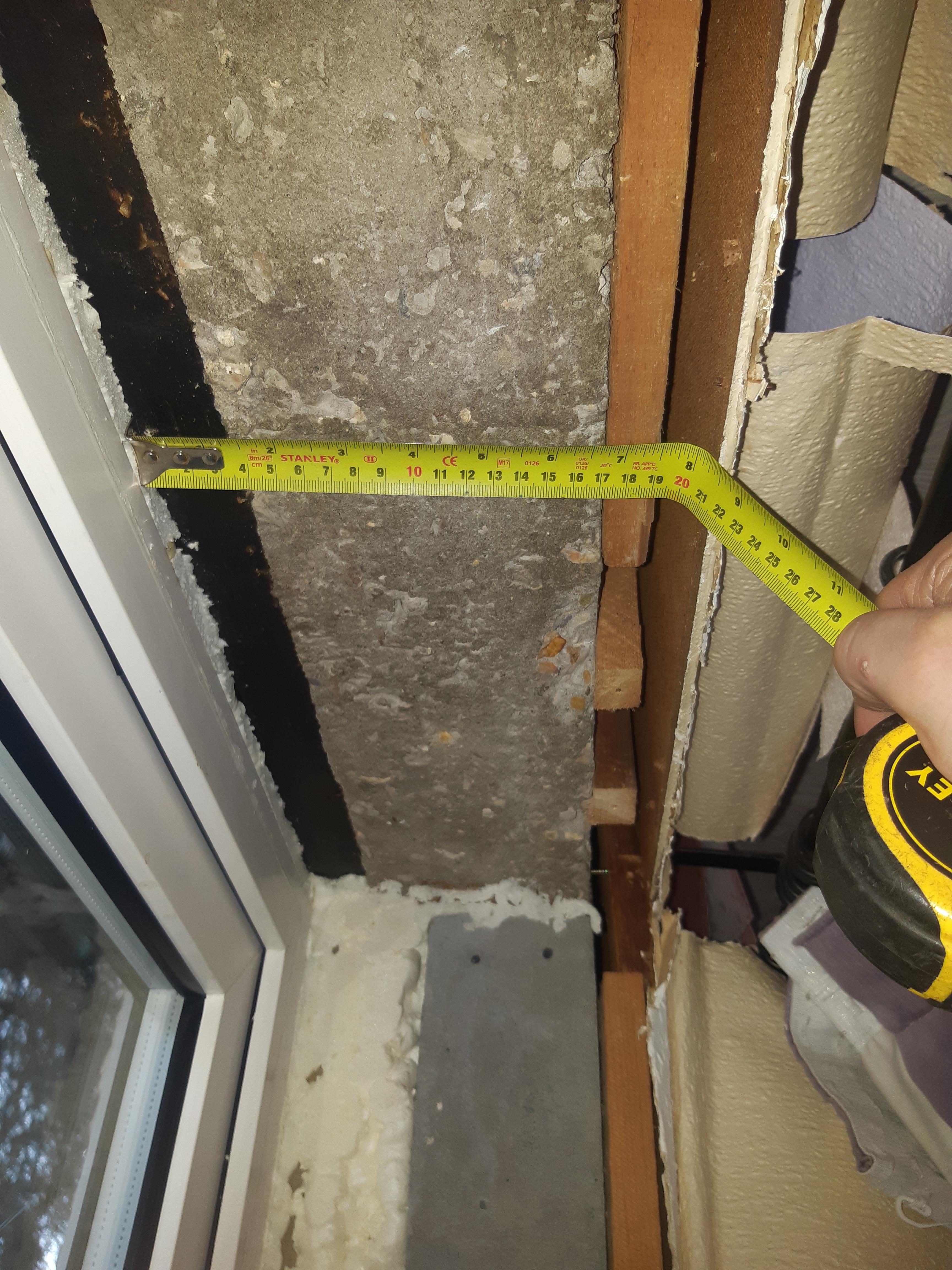

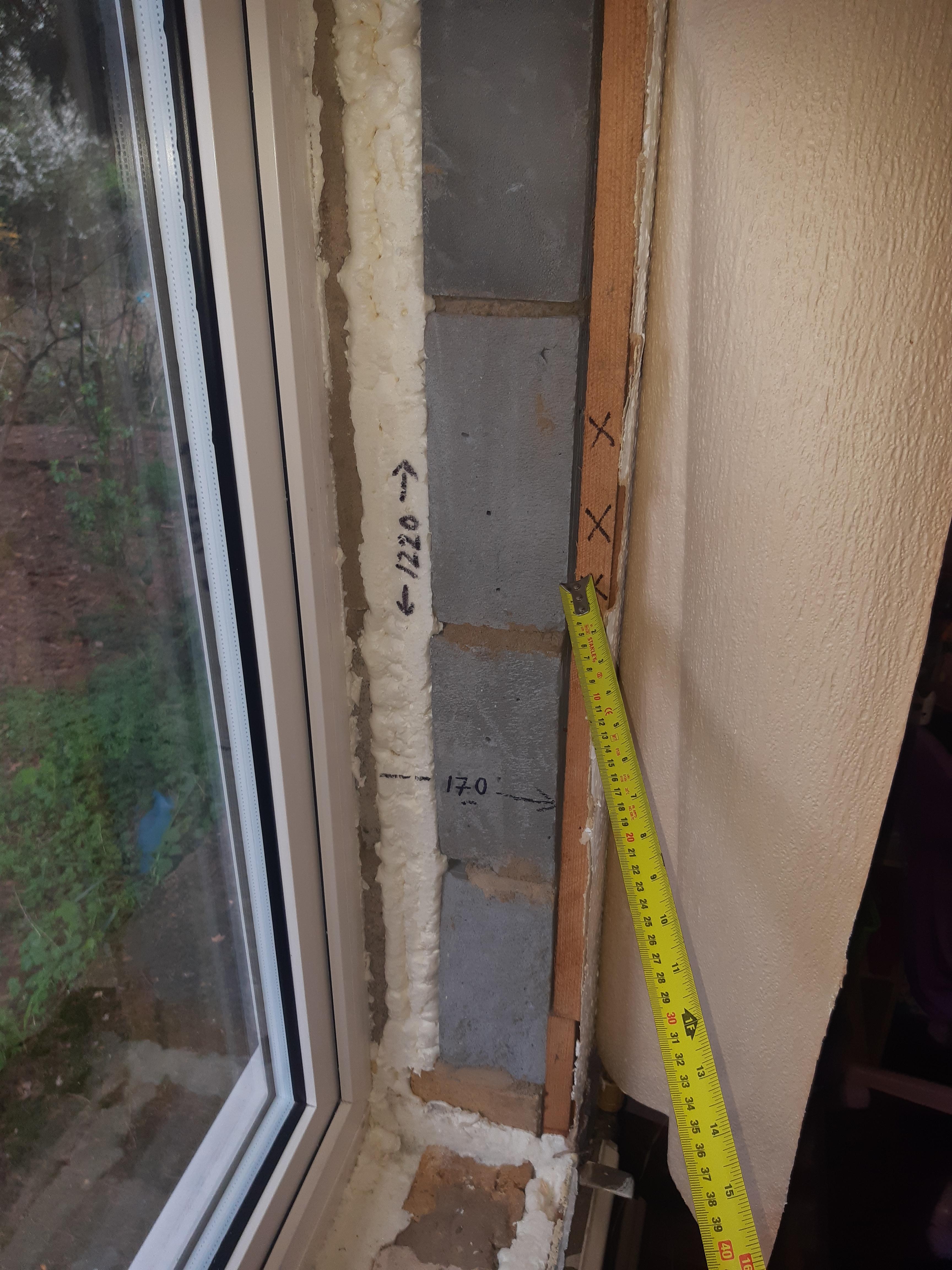

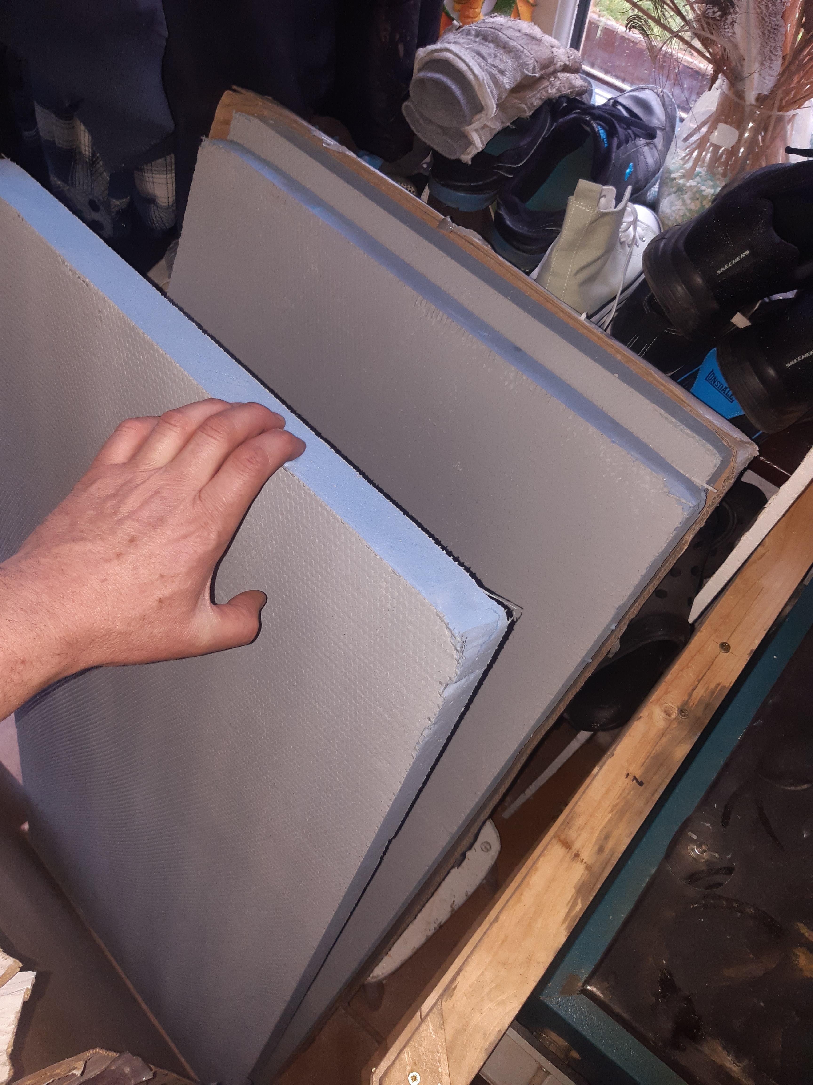

40mm Marmox boards turned up:

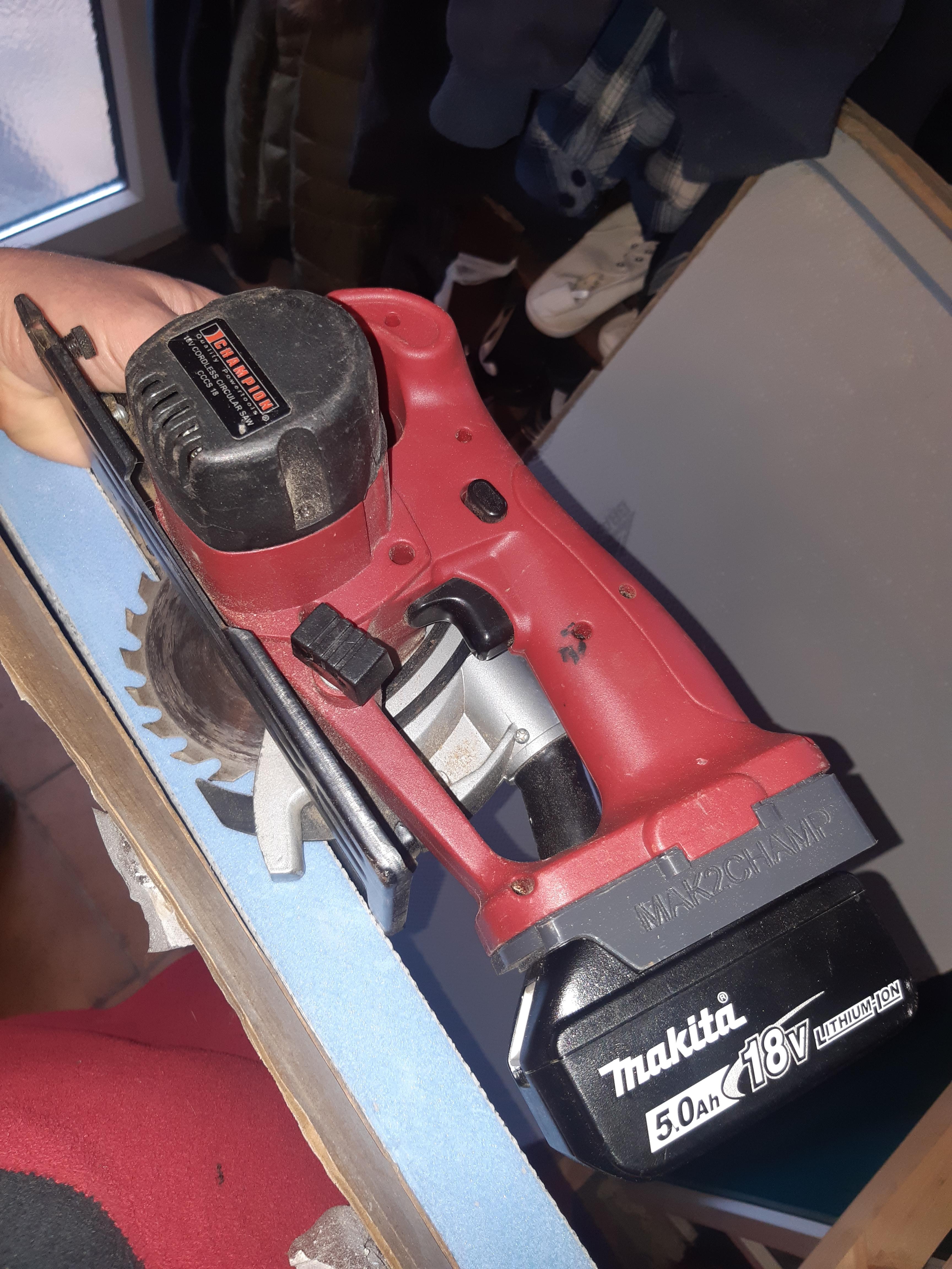

Had hoped I could use "MAK2CHAMP" hybrid! Not enough depth so it'll have to be the cheapo Nu-Tool mains saw...when it stops raining:

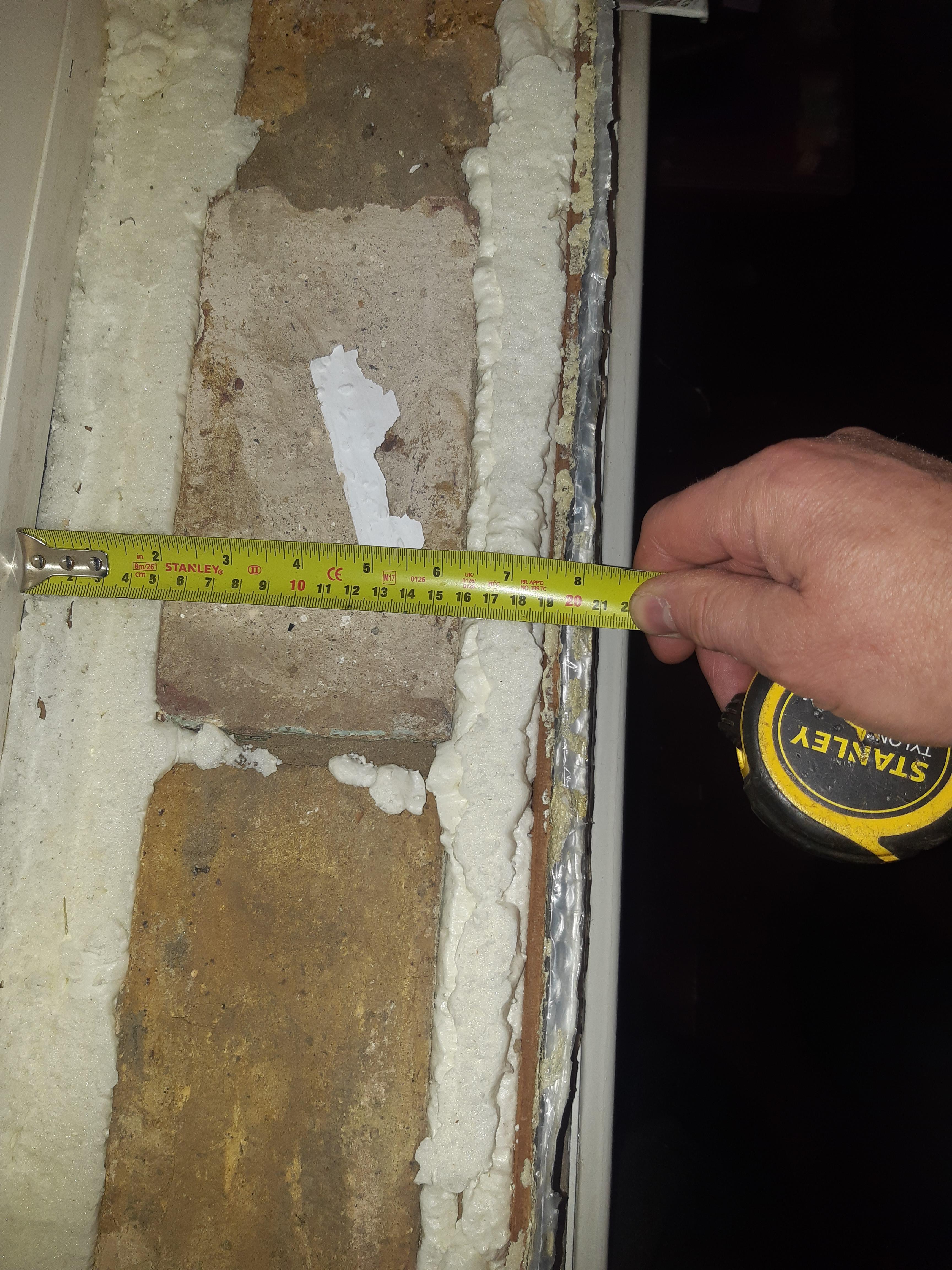

Really not sure on how wide to cut them.  Tempted to just go 170mm all round "for now". Later, (my later😂), when the battening marked X comes off, the iwi can oversail these reveal bits. As I don't yet know exactly what I'm going to do with regards to iwi then probably best I think to stick to 170mm all round.
Up top its again just 170mm to the edge of the lintel:
Edited by Onoff
 But that 'later' could be decades away! Why not bring it out all the way out and then, when you get around to IWI, trim it back flush when the battens are removed. That stuff is just so easy to cut.
I'll raise you 200mm then?

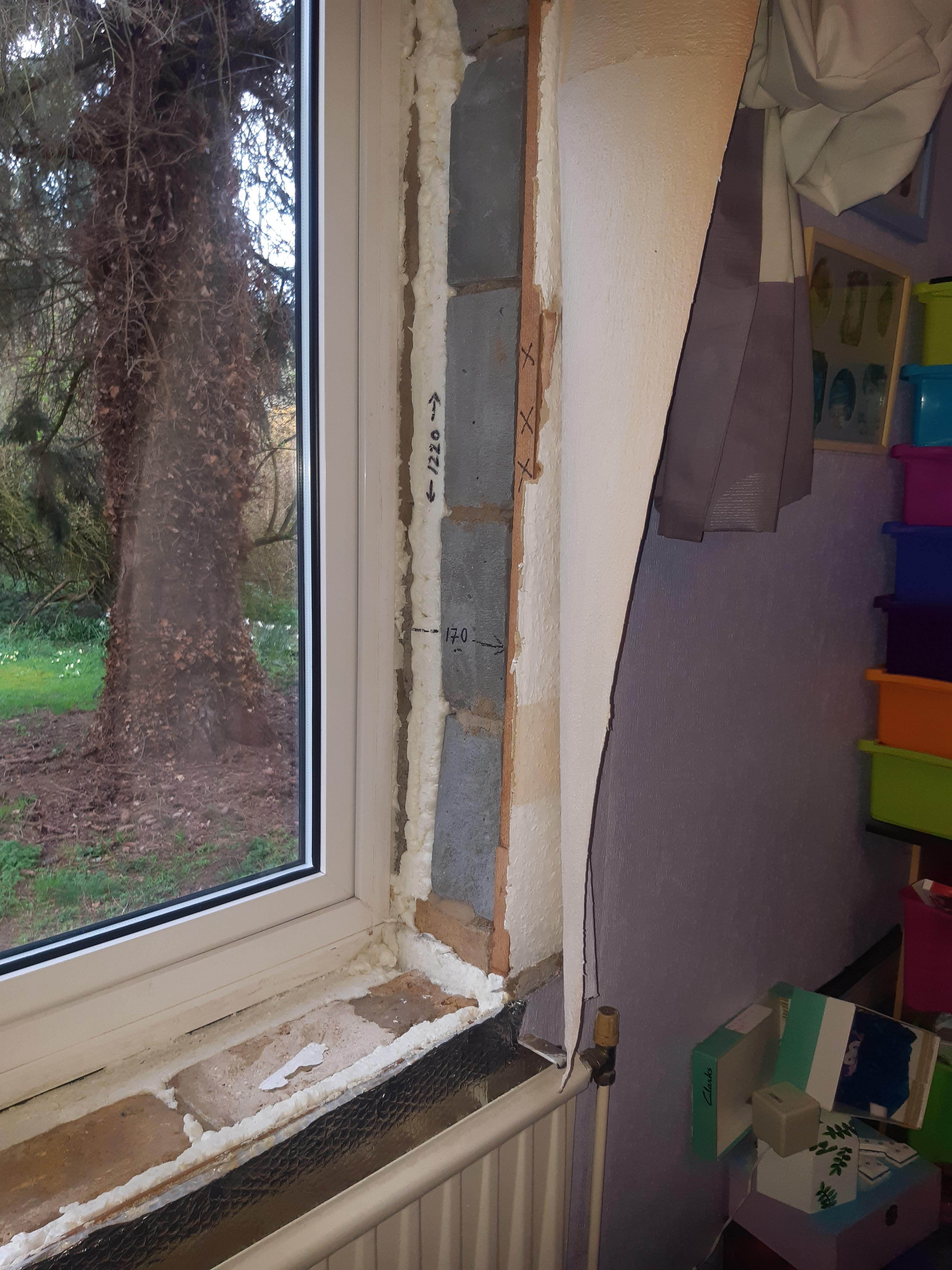

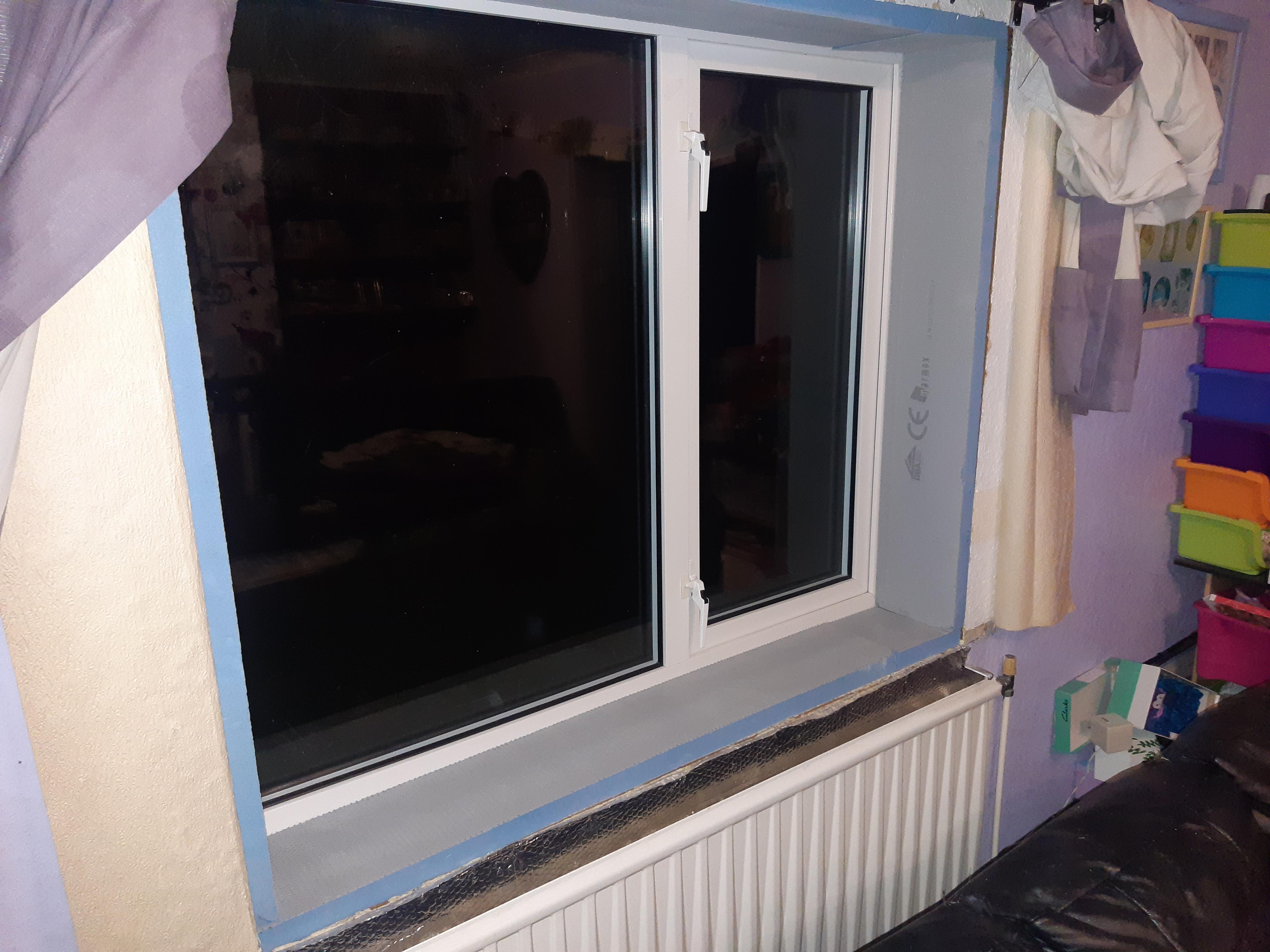

I don't understand what I'm seeing in the first photo - the embossed wallpaper looks to  run straight into the window reveal. Like the window is hard against a perpendicular wall? I thought you just took the lining out of a reveal and were going to replace it. If that was the case I expected it to be cut flush with the wall and the edges trimmed with something decorative or maybe filled and painted.
Does this help? The reveals were lined with 5/8" chipboard. The inner block leaf has 1" tile battens overboarded with hardboard then wood chip paper. Then that's papered over with the purple.
Edited by Onoff
Oh right! That was the back of the paper. So what do you plan to do with the decorating now? Presumably a short-term patch-up?

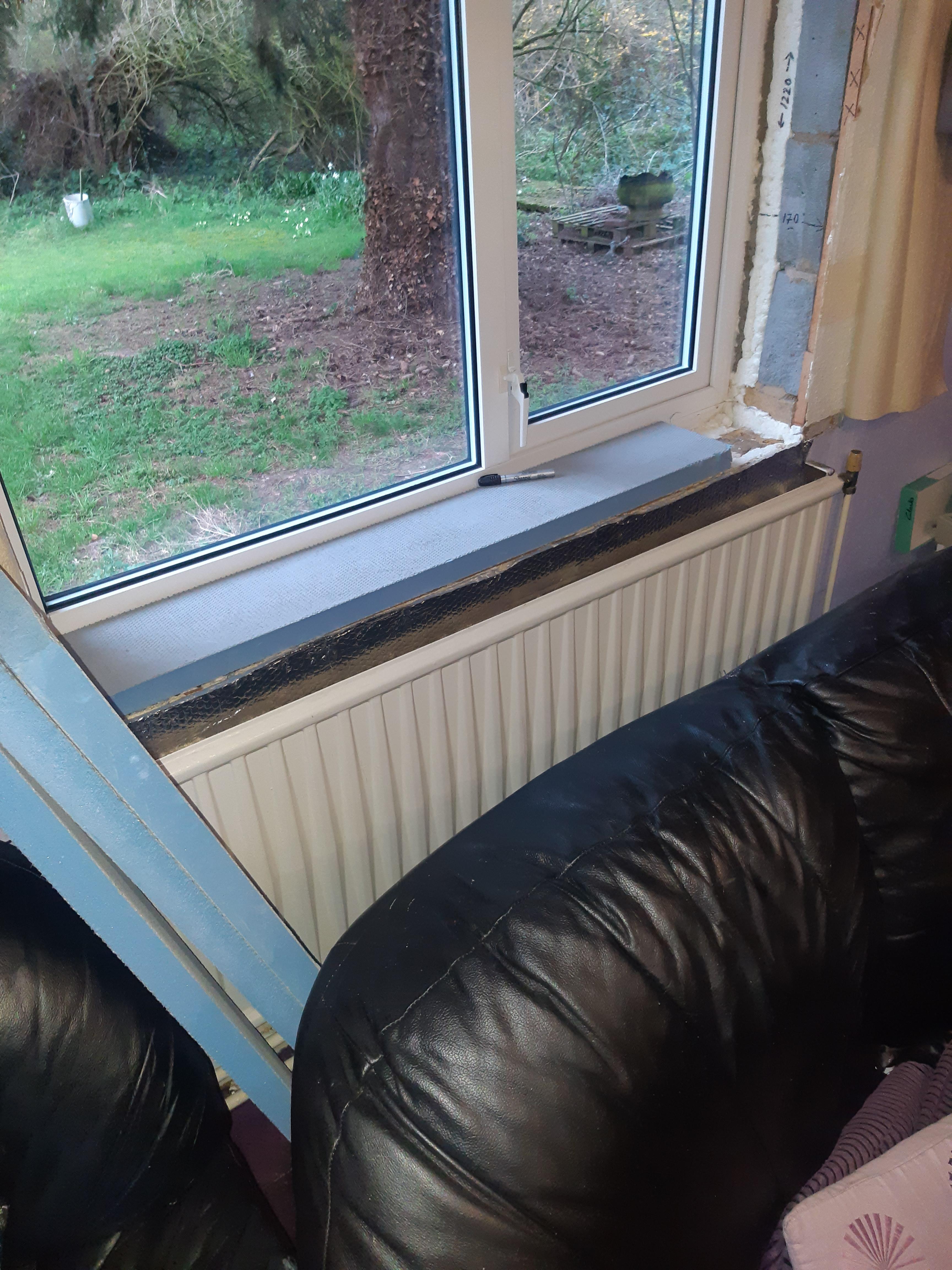

Yep. My short term! 😂 Tbh I would happily live with walls stripped bare for a bit. Having a blank canvas is so much easier. Anyway, in between showers:
Soffit is well on the pi$$:
Laser level time to see what's "out" I suppose!
Soffit wasn't pi$$ed. The Marmox was catching a nail on the hardboard! 😂

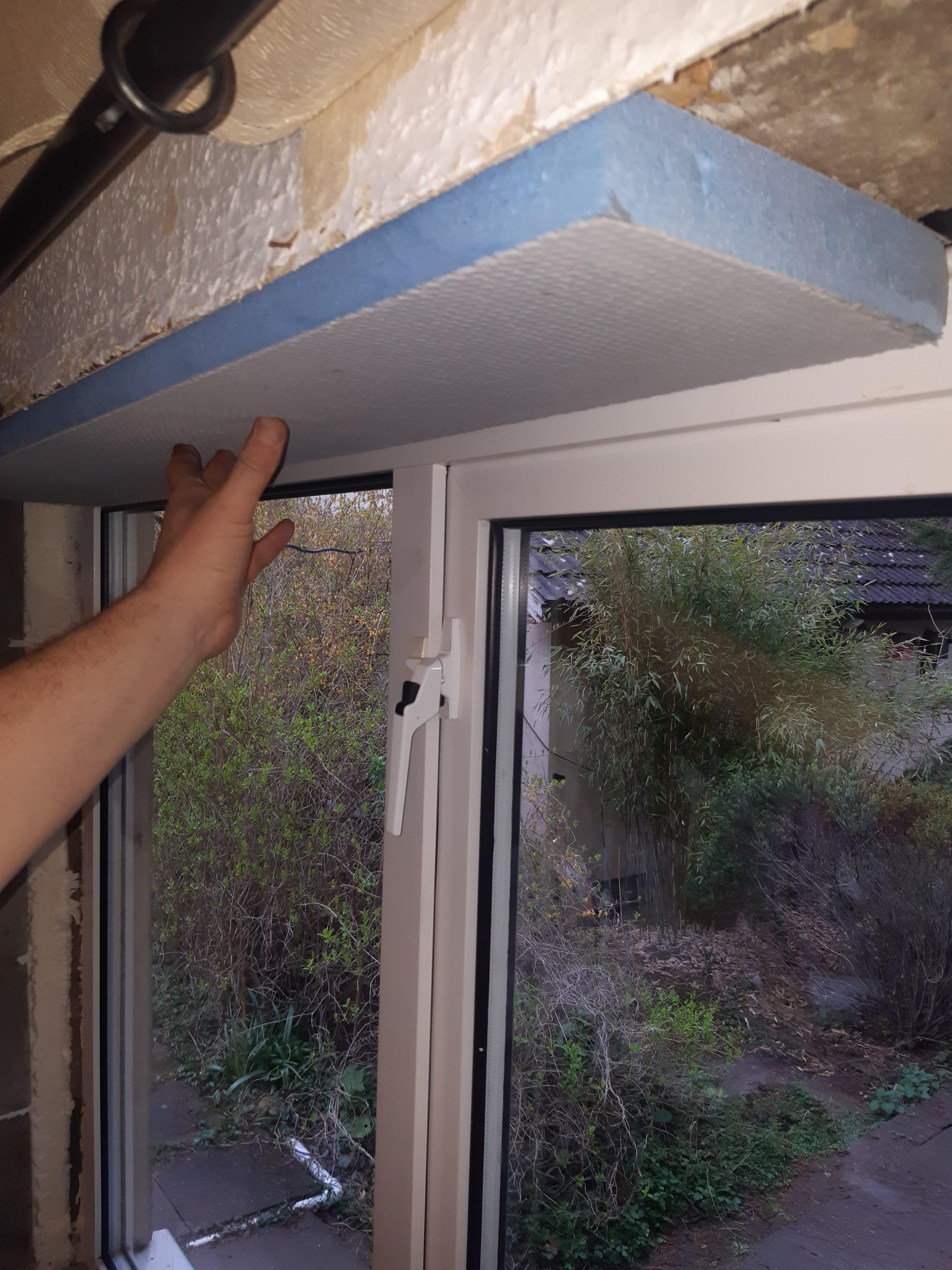

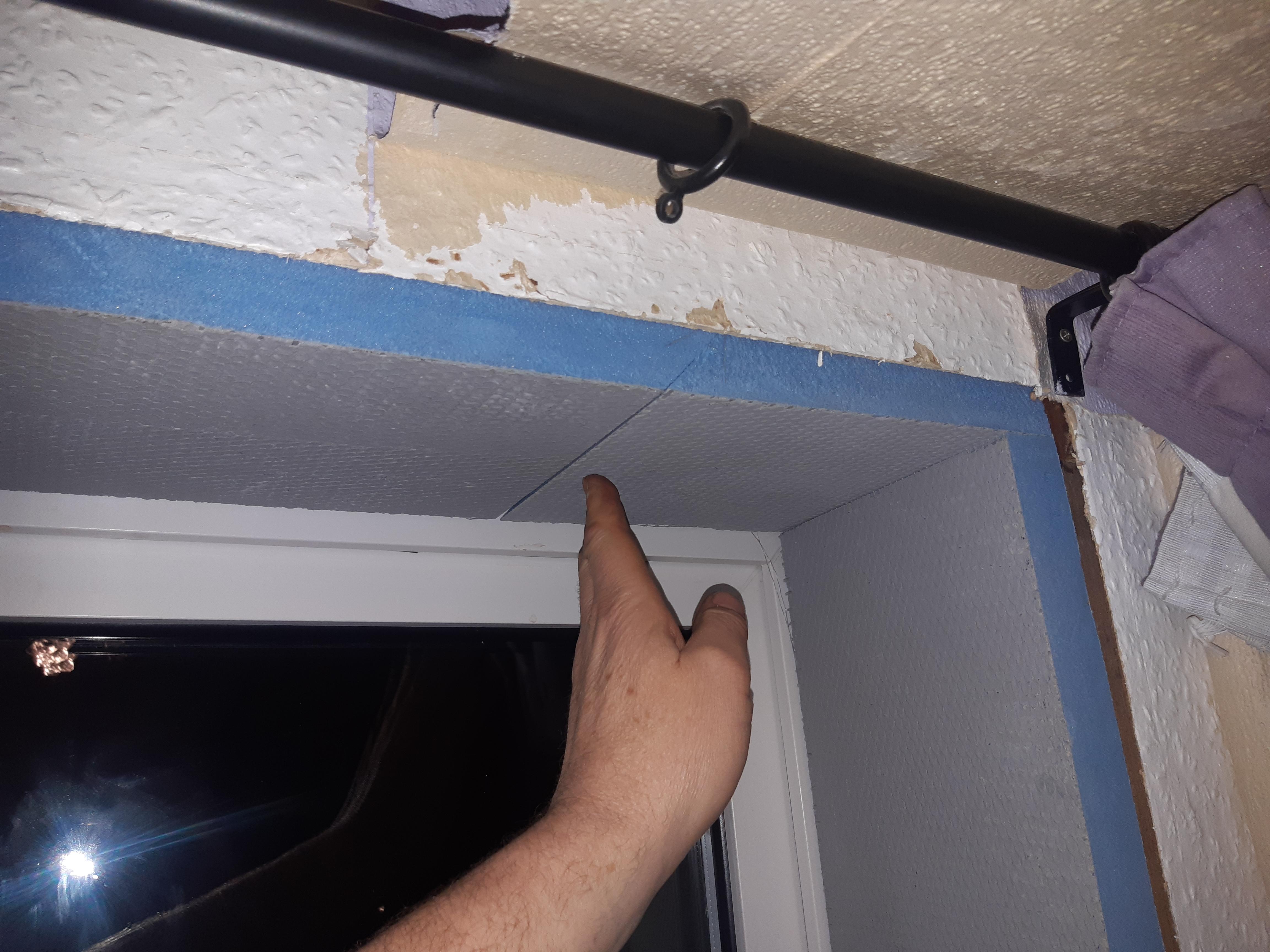

All the bits cut. Yet to stick when I decide a) what to use, i.e Soudafoam Low Expansion or something else and b) whether to dig out the existing cheapo foam. Need to tweak the little infill bit on the sill at the end by the window.
Mitred the soffit section:
Nicely done. In fact all your cuts look good and clean. Brilliant stuff to work with IMO. Did a king-sized shower cubicle with it in our rental.
I cut into 200mm strips with the same old circular saw I used for 12.5mm Aqua Panel. Just clamped a board on it. Then chopped to length on the Evolution Rage 255mm chop saw. Couldn't be bothered changing to the diamond blade.
Only thing is with the 40mm Marmox, once plastered there'll only be about 10mm of frame showing at the sides. About 15mm at the top and maybe 20mm at the sill assuming I get a black ash effect uPVC sill later.
For some reason I thought it would be cement board on one side only of the insulation on the Marmox boards. Quite pleased it's both sides.
I reckon the Soufafoam Low Expansion would stick to it.
