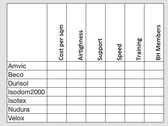

Adrian Walker Posted December 24, 2021 Share Posted December 24, 2021 18 hours ago, IanMcP said: Hey Cost - so cost is always a concern. Quality - obv I want quality. Time - I’ve quit work , I’m living on site and have lots of time (until the wife has had enough of the static!) I want do as much as possible You have already decided that you want to build using ICF, so use the same approach to evaluate the best ICF system for your build. Ask BH members for scores on a number of factors. To start you off Durisol is challenging to get a good air tightness as it doesn't have a continuous concrete lay, so a zero IMHO Link to comment Share on other sites More sharing options...

Adrian Walker Posted December 31, 2021 Share Posted December 31, 2021 5 minutes ago, Russell griffiths said: To much to list here, do a bit of research and see what you think. I have done research and hence my question. I'm assuming that you did a fabric first approach, with Airtightness first followed by Insulation? Thermal Bridging, Triple Glazing and MVHR would be similar for all the ICF systems. Link to comment Share on other sites More sharing options...
