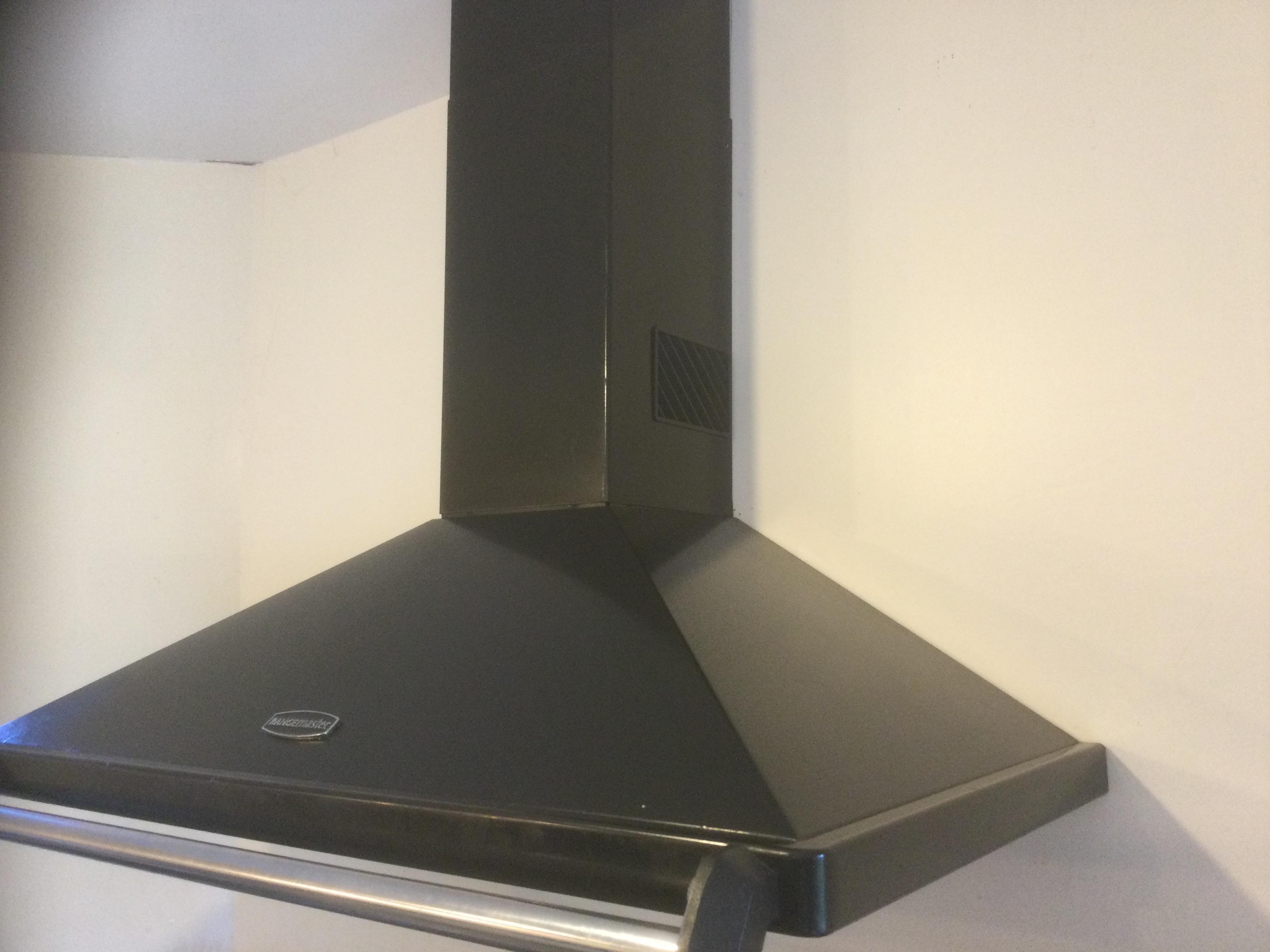

joe90 Posted February 2, 2022 Share Posted February 2, 2022 Usually the recirculating hoods exit the air from vents either side of the vertical tube! Do you have a pic of your hood? Link to comment Share on other sites More sharing options...

Adsibob Posted February 2, 2022 Share Posted February 2, 2022 1 hour ago, joe90 said: Usually the recirculating hoods exit the air from vents either side of the vertical tube! Do you have a pic of your hood? My hood is concealed within the wall units above the hob. It is a 90cm wide x 30cm deep unit designed to be concealed within such cabinets, as long as they are at least 92cm wide by 31cm deep. Link to comment Share on other sites More sharing options...
