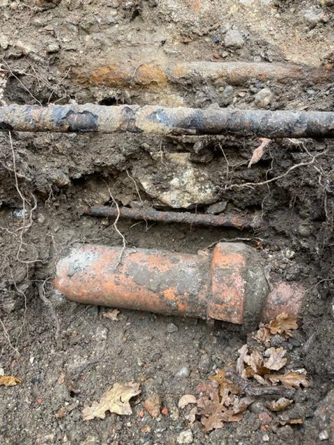

Hilldes Posted November 8, 2021 Posted November 8, 2021 (edited) I need to cut into this pipe - basically need to add a coupler from clay to 110m plastic then a 45 bend as it will follow a different route. As you can see from the pic the clay soil pipe is in close proximity to other services so no room to swing a Stihl saw around its perimeter. Any ideas please? Edited November 8, 2021 by Hilldes Pressed enter too early

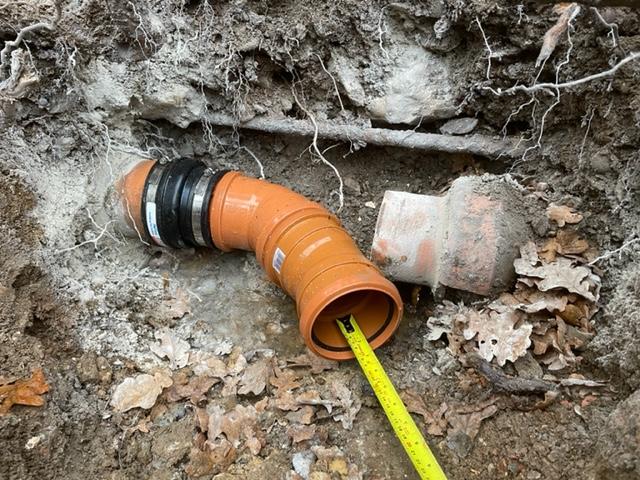

Hilldes Posted November 9, 2021 Author Posted November 9, 2021 (edited) Just to check this is the right coupler from clay to 110mm plastic.... https://www.screwfix.com/p/floplast-underground-flexible-adaptor-120-136mm/19914 Edited November 9, 2021 by Hilldes typo in title

Gone West Posted November 9, 2021 Posted November 9, 2021 4 hours ago, Hilldes said: Just to check this is the right coupler from clay to 110mm plastic.... https://www.screwfix.com/p/floplast-underground-flexible-adaptor-120-136mm/19914 Yes that was what I used on a previous house. I cut the clay pipe with a chain cutter I hired.
Carrerahill Posted November 9, 2021 Posted November 9, 2021 On 08/11/2021 at 13:25, Hilldes said: I need to cut into this pipe - basically need to add a coupler from clay to 110m plastic then a 45 bend as it will follow a different route. As you can see from the pic the clay soil pipe is in close proximity to other services so no room to swing a Stihl saw around its perimeter. Any ideas please? 4-1/2" grinder, cut the top, break out the section that will be going, then grinder body will go into pipe and you can cut base and remainder of the sides. 4 minute job.

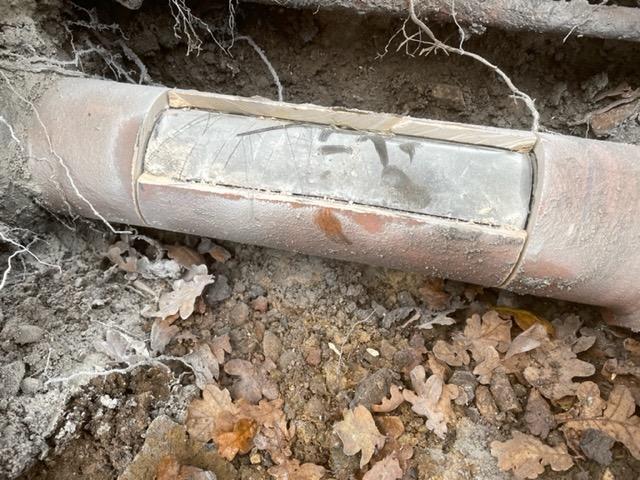

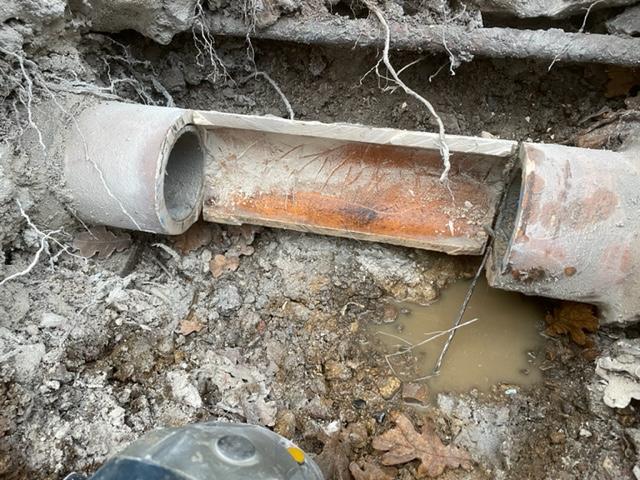

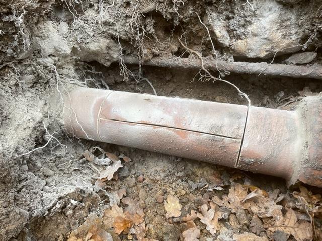

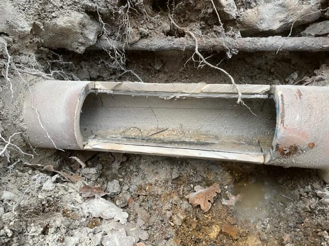

Hilldes Posted November 14, 2021 Author Posted November 14, 2021 On 09/11/2021 at 16:47, Carrerahill said: 4 minute job. That was the longest 4 minutes of my life ?. Job done though, new house now connected to existing clay soil pipe going into road. Used 9" grinder with a diamond blade (but one with gaps in not continuous), cutted fine, needed to make a number of letterbox cuts in order to get the grinder right through the pipe. Used a cold chisel to break out to corners of the letter box cut. There was a plastic pipe inside the clay - used a multitool to complete the cuts into the corners of that. 1
Mr Punter Posted November 14, 2021 Posted November 14, 2021 Is that a fibreglass liner inside the clay pipe? Maybe a repair?
Hilldes Posted November 14, 2021 Author Posted November 14, 2021 2 minutes ago, Mr Punter said: Is that a fibreglass liner inside the clay pipe? Maybe a repair? I felt like 110mm plastic pipe - as in that thickness. Not sure why there would have been a repair to the clay pipe - looked sound. Will take a look at the offcuts tomorrow.
ProDave Posted November 14, 2021 Posted November 14, 2021 Well done. I would want an inspection chamber or at least a rodding point very close to that junction.
Onoff Posted November 14, 2021 Posted November 14, 2021 1 hour ago, Mr Punter said: Is that a fibreglass liner inside the clay pipe? Maybe a repair? I would say that's a clay pipe that's been relined in the past with one of those inflatable linings that sets in place.

Carrerahill Posted November 15, 2021 Posted November 15, 2021 14 hours ago, Mr Punter said: Is that a fibreglass liner inside the clay pipe? Maybe a repair? It has been internally sleeved at some point. Possibly quite good news for OP as it means his soil pipe is probably in pretty good working condition and will be for some time.
