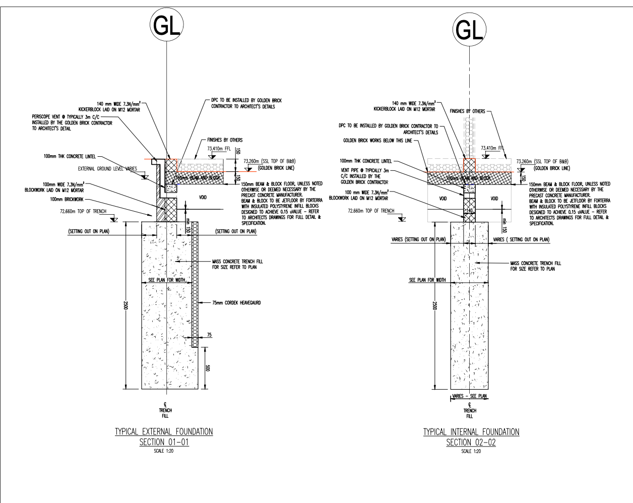

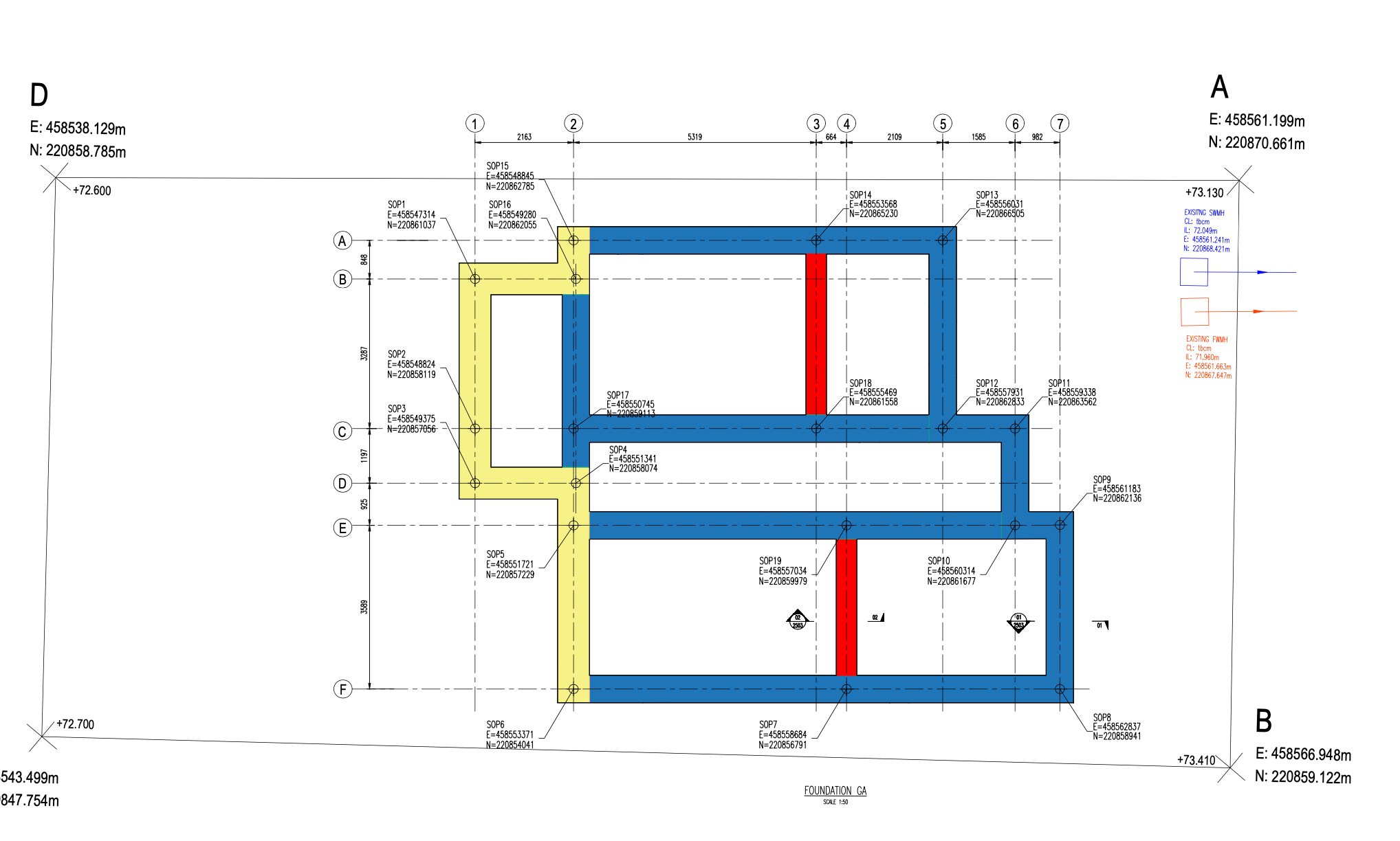

BartW Posted November 4, 2021 Share Posted November 4, 2021 Hi everyone, I received a foundation design for our self build, and that stipulates 3m deep trenches with 2.5m concrete fill. The amount of trenching is (in my opinion) very extensive. I tried to reason with the party responsible for the design of the above, but they are not willing to change this. I could have a separate dig at why it has been designed to be so deep and over the top, but it will not change anything. So here is my asking, how one would protect the trenches from cave-ins, and work the process of foundation pouring in view of the below: Link to comment Share on other sites More sharing options...
Conor Posted November 4, 2021 Share Posted November 4, 2021 (edited) You'll need to use trench boxes. But they are difficult to setup in narrow trenches, and you need people that know what they are doing. There are many practical challenges to digging that deep in a confined footprint. You'd likely need to dig, shutter, pour, temp backfill a section at a time. A huge factor is the soil conditions and specific modulus. Your engineer/designer should be designing something that is safe and practical to construct - fundamental part of CDM. How are they proposing it should be constructed safely? I would absolutely not be digging trenches that deep and narrow for purely practical and safety reasons. I would be pushing for a different foundation design - eg a ground bearing raft with micro piles, if needed. This may mean a different designer/engineer. Edited November 4, 2021 by Conor Link to comment Share on other sites More sharing options...

BartW Posted November 4, 2021 Author Share Posted November 4, 2021 Hi, Yes it is at GH, and it will be my problem, as I managed to get them to agree to use my own contractor for the golden brick. I have an alternative, which would be mini piles, but they want £3k + VAT at this stage to redesign the foundation system altogether. So I am in a slight pickle. 3m trenches are simply not what I expected to be dealing with... Link to comment Share on other sites More sharing options...

BartW Posted November 4, 2021 Author Share Posted November 4, 2021 33 minutes ago, ProDave said: If this is at Graven Hill, it is not your problem to make it work. But I would have thought piles might make more sense, it is obviously poor or made up ground. This is what I am proposing now. Plus, we are sitting in-between two plots so the space is quite narrow with no ability to remove / temporarily store spoil on the adjacent land. I am curious to understand how the other contractor (their preferred subbie, i.e. RM) would do it. It almost feels that whatever Waterman have designed makes no sense from a practical standpoint. I have got a competitive price for 27no 8m piles (just under £11k), but not only would I be paying £1k to the piling contractor for the design, but would also need to pay £3k to Waterman for them to do the same (on their paper)... Link to comment Share on other sites More sharing options...

Gordo Posted November 5, 2021 Share Posted November 5, 2021 (edited) Looking at the design with heave protection to inner face. I suspect there are or were trees in close proximity for this? Installing this heave protection is not a safe operation. I would refuse to install this heave protection and observe others do same. Unless heave is very likely Deep trenchfill foundation are quite common. I have seen some even deeper but I understand around 4m is point where piles become economical. Just dig and pour dry lean mix concrete as you go. Pack down lean mix with digger and it will shore up excavation. Cast a reinforced concrete foundation on top. Be sure to excavate plumb and best widen trench out to at least 900mm to allow for inaccuracies. NO ONE IS EXPECTED TO ENTER TRENCH WITH THIS TECHNIQUE FOR FEAR OF COLLAPSE. Engineers assume a level knowledge and competence in design. As this is a well established practice they obviously didn’t feel the need to provide a risk assessment. no not do it like this lolol use LEAN MIX DIG AND POUR Edited November 5, 2021 by Gordo 1 Link to comment Share on other sites More sharing options...
Moonshine Posted November 5, 2021 Share Posted November 5, 2021 20 minutes ago, Gordo said: Looking at the design with heave protection to inner face. I suspect there are or were trees in close proximity for this? Installing this heave protection is not a safe operation. I would refuse to install this and observe others do same. Unless heave is very likely NO ONE IS EXPECTED TO ENTER TRENCH WITH THIS TECHNIQUE FOR FEAR OF COLLAPSE. Engineers assume a level knowledge and competence in design. As this is a well established practice they obviously didn’t feel the need to provide a risk assessment That is a very good point, @BartW i think that you should refuse this design as under CDM regs the design is not designing out risks, how do they expect heave protection to be suitably installed without getting into the trench. See this thread with some dicey imagery of a guy in a deep trench and heave protection. Link to comment Share on other sites More sharing options...
