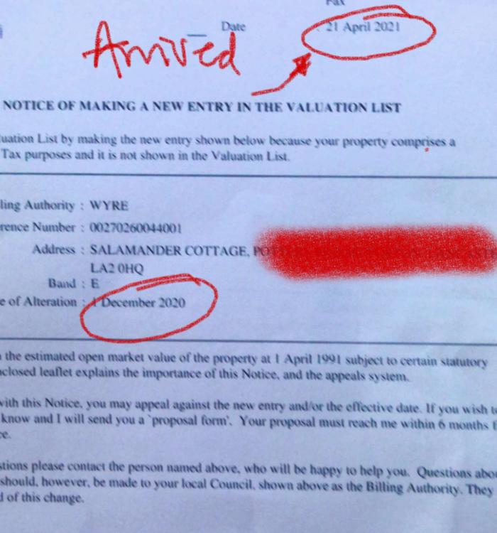

Pocster Posted October 23, 2021 Share Posted October 23, 2021 23 minutes ago, ToughButterCup said: And thats a bull's eye son. Go to the top of the class. This is what happened to me: Lovely lady from Council visits and calls it habitable (occupancy). She tells the VAT Monster. After an absence of 18months (refuse to come round) BCO pops round " - *kin' *ell Ian, you need this this and that, get it done pronto " Ian: so it's not habitable then? No, not in this state. Get this that and the other done. (Two suicide doors and other bits - fire OK) But until I get my VAT refund back I can't afford it .... VAT monster asks - DESPITE THE ASKED FOR RELEVANT, ACCURATE EVIDENCE ALREADY SUBMITTED - what did you do between occupancy and the VAT refund application? Every single dated invoice is there for the Monster to read. In other words lining themselves up to deny the VAT reclaimed between occupancy and VAT refund application Put a Notice on your property denying access to one and all without written permission from you. Put time lapse cameras up and make sure you maintain them.( @Jeremy Harris has a blog post / cautionary tale / normal post about it somewhere. And follow @ProDave's advice. I’m not just a pretty face and body you know !! Link to comment Share on other sites More sharing options...

ToughButterCup Posted October 23, 2021 Author Share Posted October 23, 2021 28 minutes ago, ProDave said: ... I remember in Jeremy's case the valuation officer viewed the house and although not finished declared it should only take 3 months to finish if from that stage so that is when they will be billing him from. Dave, can you find that post? I've tried fror 30 minutes and can't. If you do, could you link to it here. It's relevant to our discussion. Maybe anyone else like to give us a hand.? Its the one where J takes the Council to task for inappropriate peeping-tommery (tamsinery). Link to comment Share on other sites More sharing options...

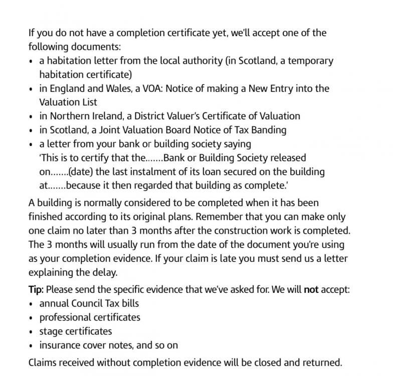

Temp Posted October 23, 2021 Share Posted October 23, 2021 (edited) 13 hours ago, ToughButterCup said: Week after April 21st 2021, nice lady writes to me with a copy of the Entry into Valuation List. Snip July 2021 I submit my VAT claim Was the claim filed within 3 months of you receiving the valuation in April? If so that could help.. The claim form says your claim must be filed within 3 months or you must explain why it wasn't in a covering letter. I think I would take a two prong approach in the letter.. 1) Provide evidence to support your view of when it was completed and make meet the 3 month rule. 2) Point out would wern't aware the "back dated" valuation had been issued until date in April and even though this was before you were complete you managed to file the claim within 3 month of you receiving it. Presumably the valuation officer doesn't have evidence to the contrary? Edited October 23, 2021 by Temp 1 Link to comment Share on other sites More sharing options...
ToughButterCup Posted October 24, 2021 Author Share Posted October 24, 2021 8 hours ago, Temp said: Was the claim filed within 3 months of you receiving the valuation in April? If so that could help.. Yes. There are two levels of Valuation Officers. The one in the VOA , and the other at local Council level. I talked to both. The VOA said they automatically send their letter of notification to both the the local council and the self builder. I never got a letter from the VOA . But the local council copied it to me. Both letters of notification are generated and sent by the VOA at the same time. Both letters are dated 21st April 2021. That's the date which counts as far as HMRC is concerned ( see earlier post) I talked to the local council Valuation Officer. She has more detailed evidence - like when she sent her assessment of occupation to the VOA. She backs up my story. Both of us were informed of HMRCs decision on or immediately after 26th April. To me , applying by 7th July is within the guidance given by HMRC. 9 hours ago, LA3222 said: .... I hope 'occupancy' does not become a recognised trigger. I'm sorry to have to tell you that it already is and has been for some time. @newhome, bless her , has set me off on a reading whirlwind on the matter. I'm going to try and summarise as much relevant information as I can and post it here. It's the least I can do to repay all the help I have had from BH members. Citizens ! Come the revolution , we will overcome. Give us Liberty to Occupy before Completion or Give us death ! (Apologies to Patrick Henry) Link to comment Share on other sites More sharing options...

ProDave Posted November 30, 2021 Share Posted November 30, 2021 In Scotland BC will issue a certificate of temporary habitation. I assume something similar exists in other places? VAT refund can wait until completion if you want, or you can do it with a certificate of temporary habitation. Link to comment Share on other sites More sharing options...
ToughButterCup Posted November 30, 2021 Author Share Posted November 30, 2021 2 hours ago, Blooda said: ... So my question is who supplies a habittal certificate - BCO or Council Tax People ? ... BCO. I symapthise with your other half. The question of moving and legality is slightly 'wrong' Wrong's not the word I want but its close enough 2 hours ago, Blooda said: ... Mrs won't let us put our existing house [mostly owned by the Bank) which we are living in on the market until it is legal to "move into the new house". ... If you have PP, there is nothing - except practicality - to stop you moving in. Our next door neighbour has been living in his Dwelling House (block built structure that the Inspector called '... on the balance of probability a dwelling house...' and it counts for Council Tax as a house even though it's built INSIDE a perfectly good caravan. I kid you not) . He has been paying Council Tax for years (4) But very few men and even fewer of the other persuasion would call it a house. He has water, electricity and an illegally sited open cess pit (within honking distance) as foul drainage. All mod cons then..... So you can tell her, on your evidence as presented above, its perfectly legal to live in it today. If you look at the VAT form, there are a series of other 'markers' which have the equivalent status to BCO sign off - as far as HMRC are concerned My suggestion is that you consider the issue in the round, rather than focus on just the VAT refund or just the Council Tax bill or just moving in. We started paying our Council tax bill in advance (3 or four months) because of the time gap between formal notification from the (local Council) Valuation Office and our notification that the property had be listed by the VOA (Valuation Office Agency) (5 months as detailed in an earlier post). Long may your dropped kerb remain on the back of a lorry, and your water locked in a pipe. Link to comment Share on other sites More sharing options...

ToughButterCup Posted December 1, 2021 Author Share Posted December 1, 2021 (edited) Just checking -- detail matters here : Quote as soon as she sends the notification You mean (she) sends you a copy of the VOA letter ('notification' above) telling you about the Notice of making a New Entry to the Valuation List don't you? She will take no notice of the date you say you are going to inhabit the house. It makes no difference to her. She will have achieved her aim (if her role extends only the the Council valuation office) ; namely to have added your property to the number of chargeable properties in her area. How much to charge is nothing to do with her office. Its not her role to ask about who is living in the house. Her focus is: is it habitable? We started paying up-front before the valuation was known to avoid a thump of a bill this July. No reason you can't pay a little now..... Tell your son to start saving.? Edited December 1, 2021 by ToughButterCup Link to comment Share on other sites More sharing options...
