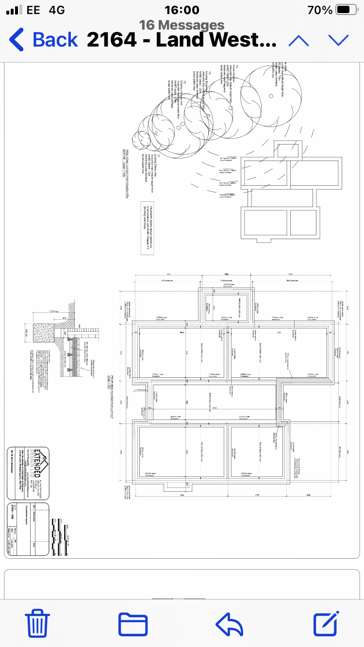

Perfect Well nearly Four small trees nearby
SE has to assume that these will become big trees So rather than a cheap Ground baring slab I will have to have BB and the footings a little deeper at that side
Still pretty good because the rest are very shallow

Worked on a job a few years back. Top soil about 250/ 350mm thick from memory, great top soil all saved for the garden. A sub soil, clay / sand firm but easily dug and this was used to regrade the landscape. Then about three feet down (900mm) fractured weathered rock. This rock had not seem the light of day since the last mini ice age. Although fractured was great to support a house found. The site was slightly sloping and the rock was sufficiently fractured that we got good soakaway results for the septic tank and rain water run off. We excavated out the big hole for the septic tank with a JCB 3CX. We just carried on digging out the fractured rock here an there and used this as sub base for all the drive / hard standings.. saved a fortune. That was nearly perfect!
