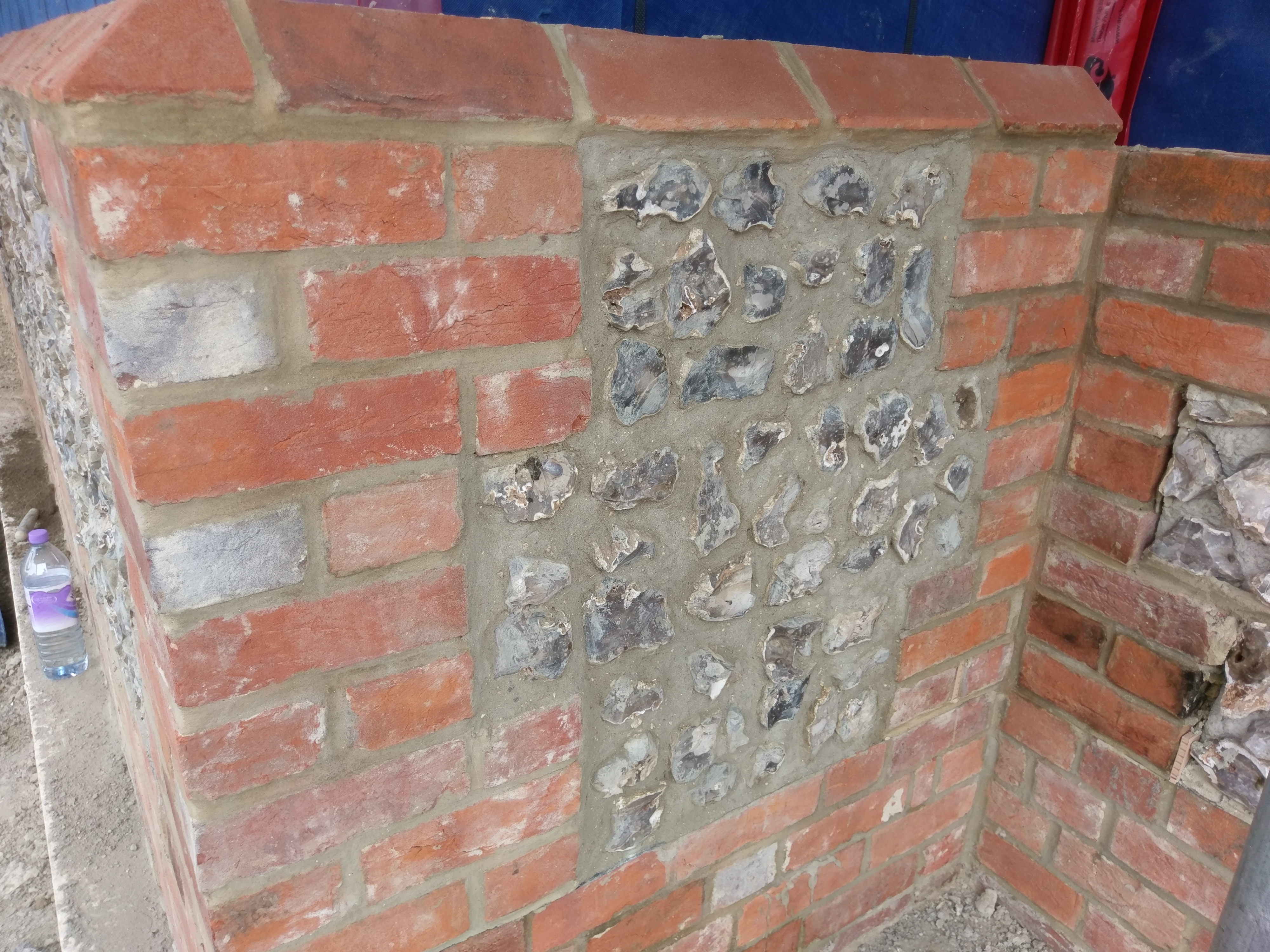

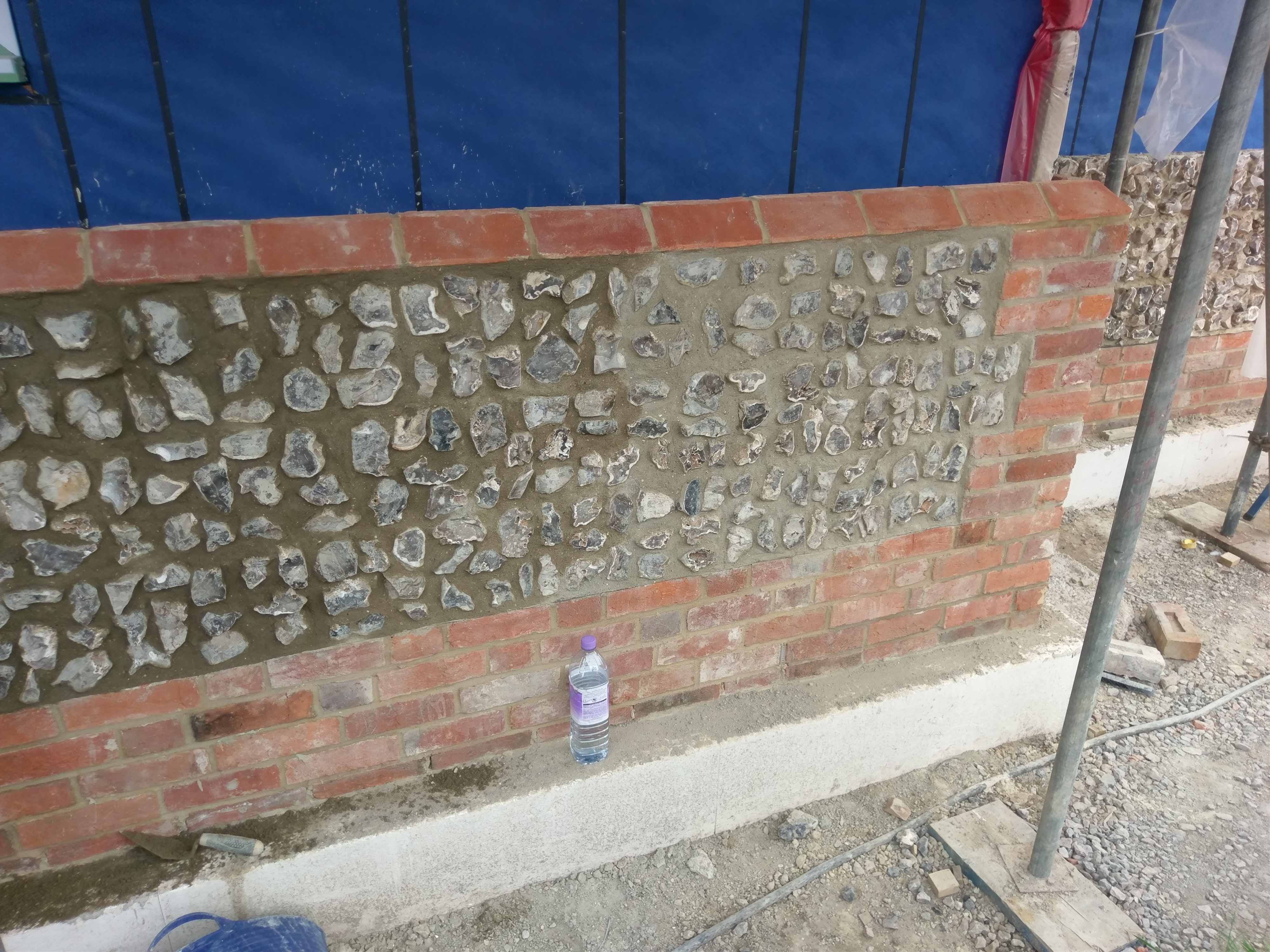

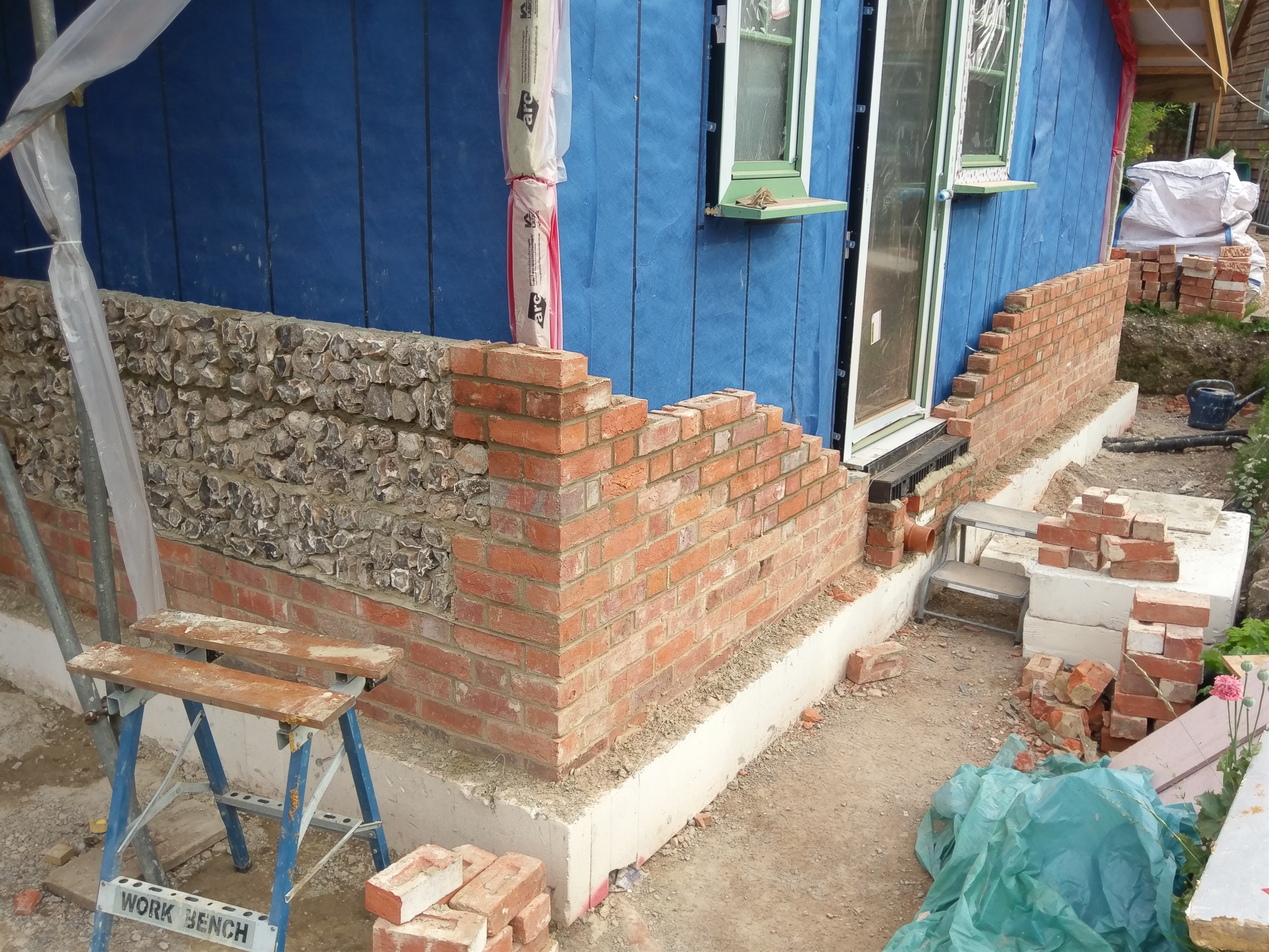

Ok, so a month later and the windows are still not sorted. Will update when they do get sorted but to be honest its been one of the most frustrating and unbelievable periods of the build.
We have no glass in the 3 sliders which should be with us Friday, if not its another three weeks due to factory shut down.
MBC have been absolute stars about it all, and have agreed that we can start the brickwork on the single storey utility room before the air test and insulation.
Due to the cost of the window delay (all ready at over £6000 for rental costs etc for the 8 week delay ) i have had to make some cutbacks. one is doing thhe brickwork myself.
Considering the bricks are over 200 years old i think it looks good for a complete novice.
We had to compromise on the flint blocks but they look sort of okay.
I cannot brick up tp the door yet as it has been put in wrong.

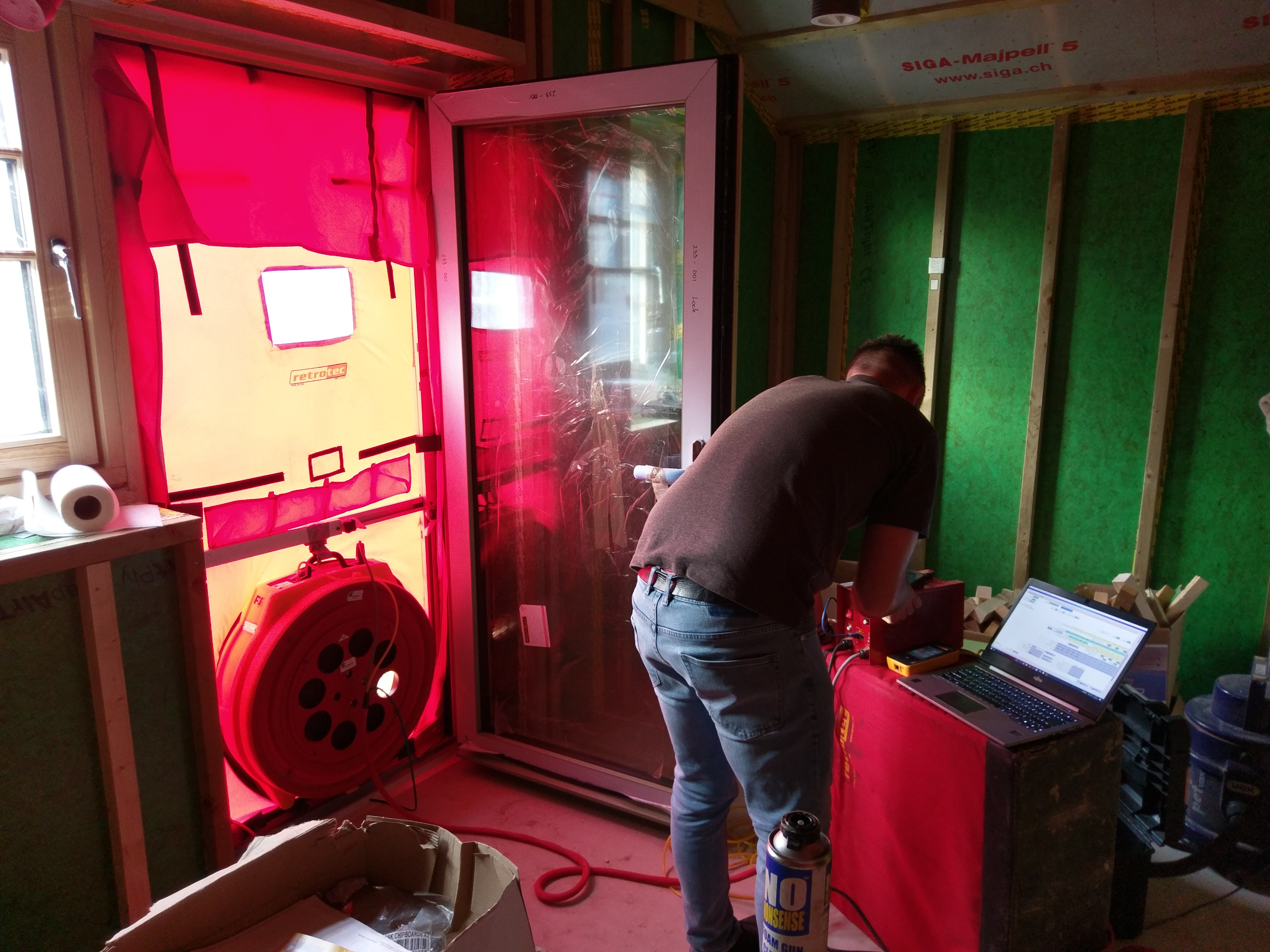

So things are moving again this week.
MBC are back on site after every window was replaced. The windows are still not finished as they broke one whilst fitting and scratched the front doors with a window frame so they need replacing.
However the house is now fully sealed and this evening at 7.30pm the house achieved an air test of 0.57. I am pleased as the roof and a couple of wall abutments are quite complex.
The main areas where i have leaks are the three sliding doors. Not the worst they have seen for sliders but would account for quite a lot of the air.
Still it achieved MBC 0.6
Friday they start the pumped insulation which should take a couple of days and the window company is back on Monday to repair and replace everything damaged.
