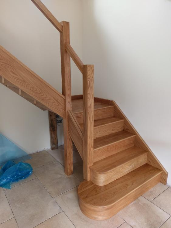

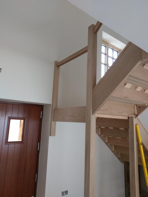

  • Staircase has arrived and I have now fitted it.   We used TKstairs  and have been very pleased with the outcome We opted for oak with embedded glass and had it part assembled

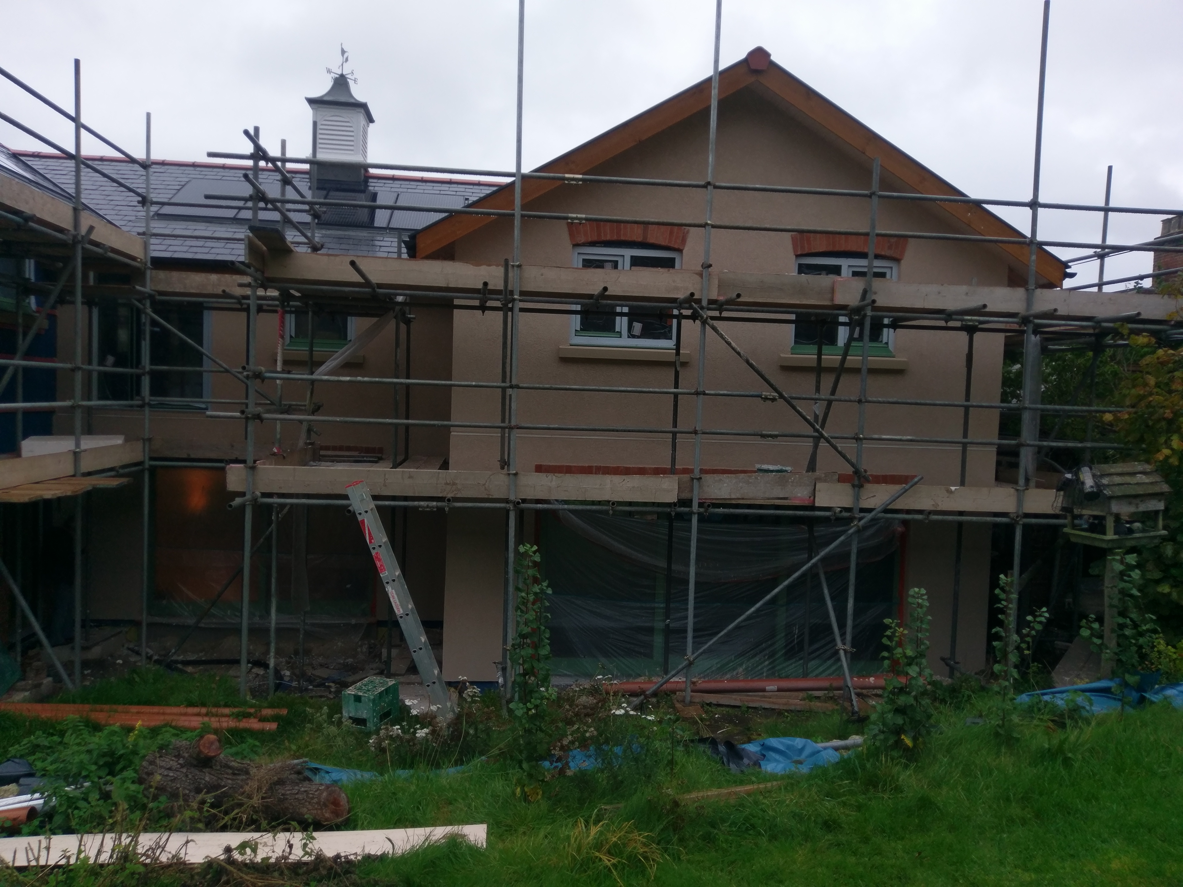

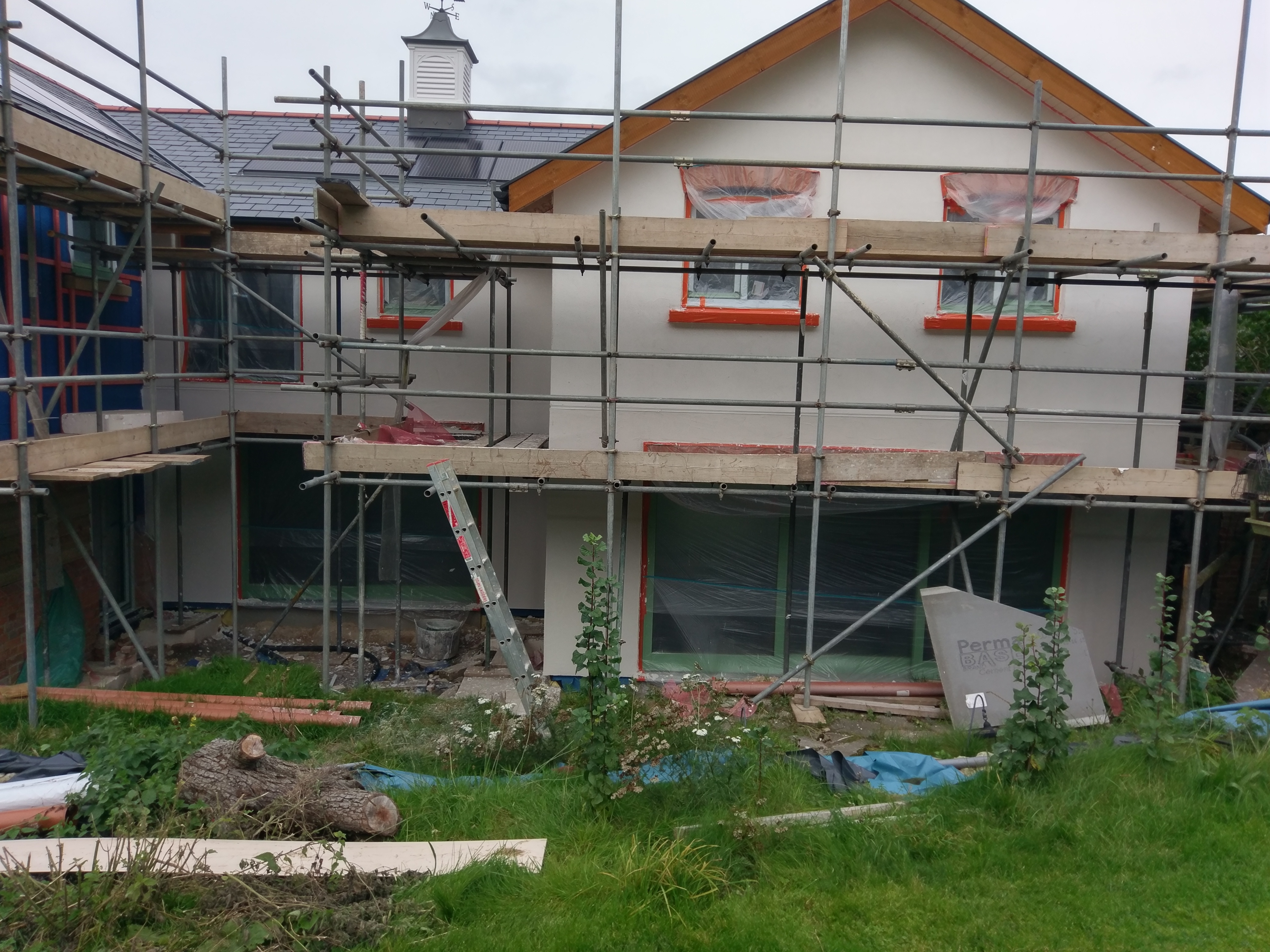

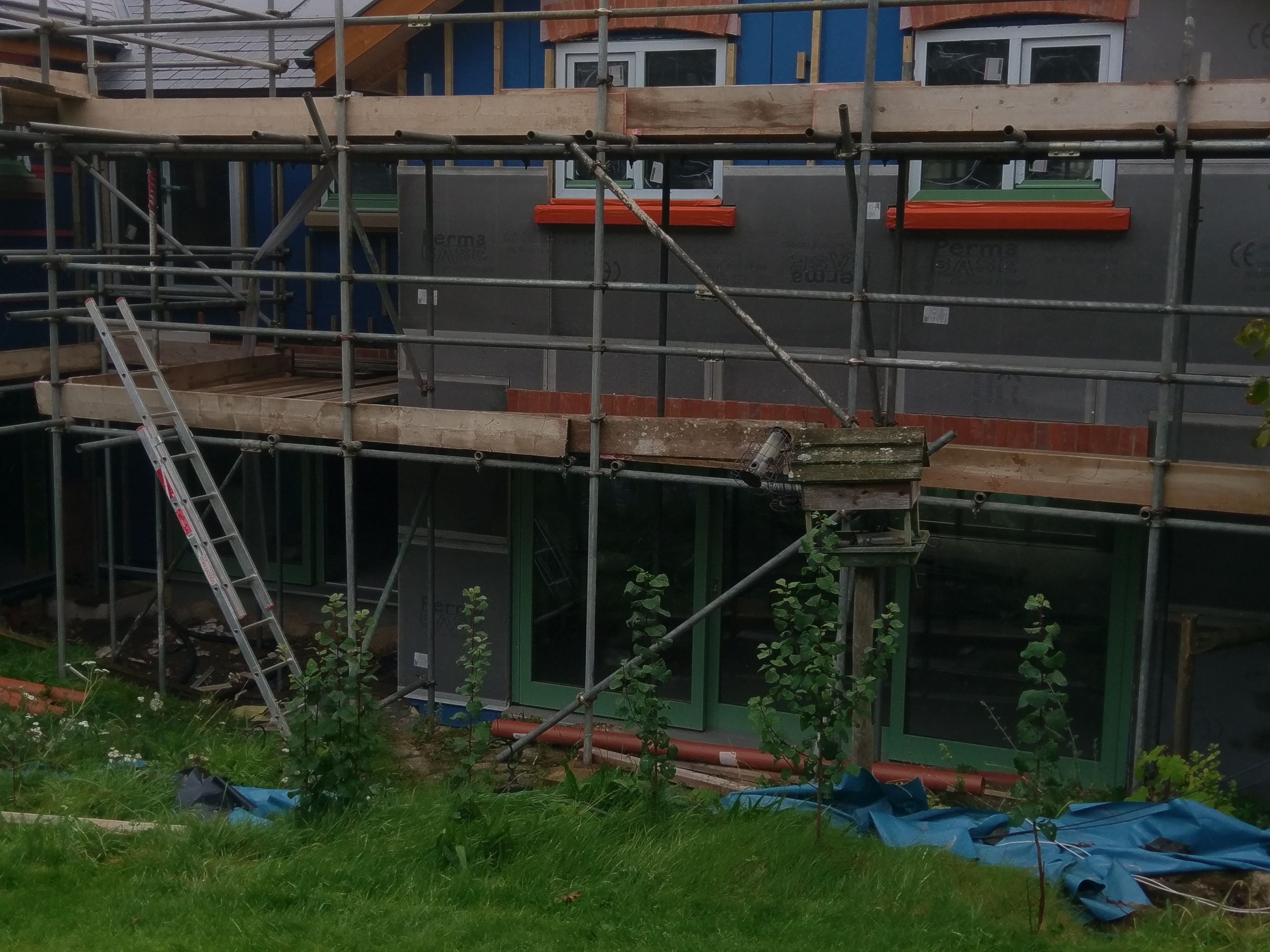

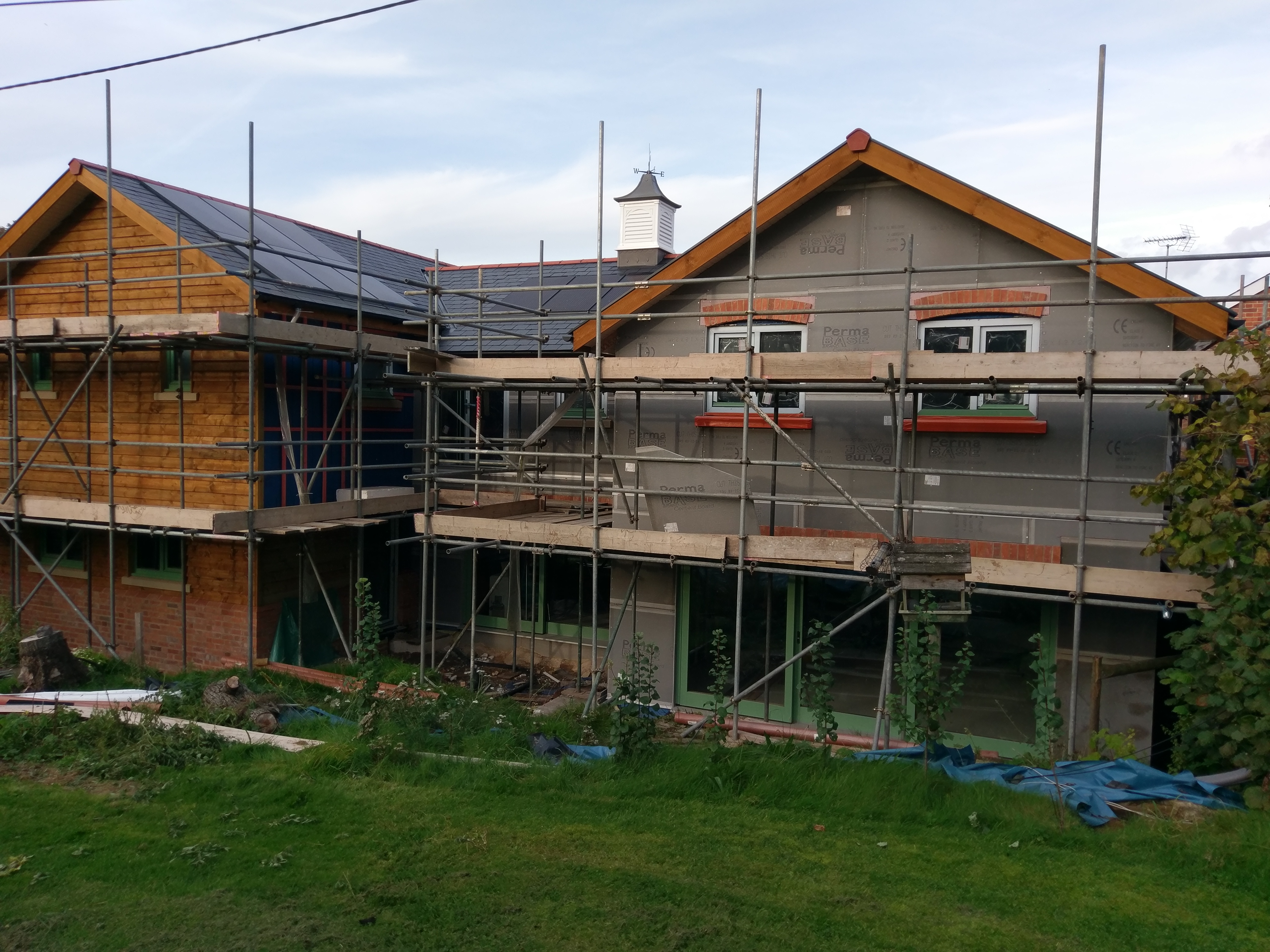

The render is finished:D
Took a lot longer than they quoted but it has come out better than expected.

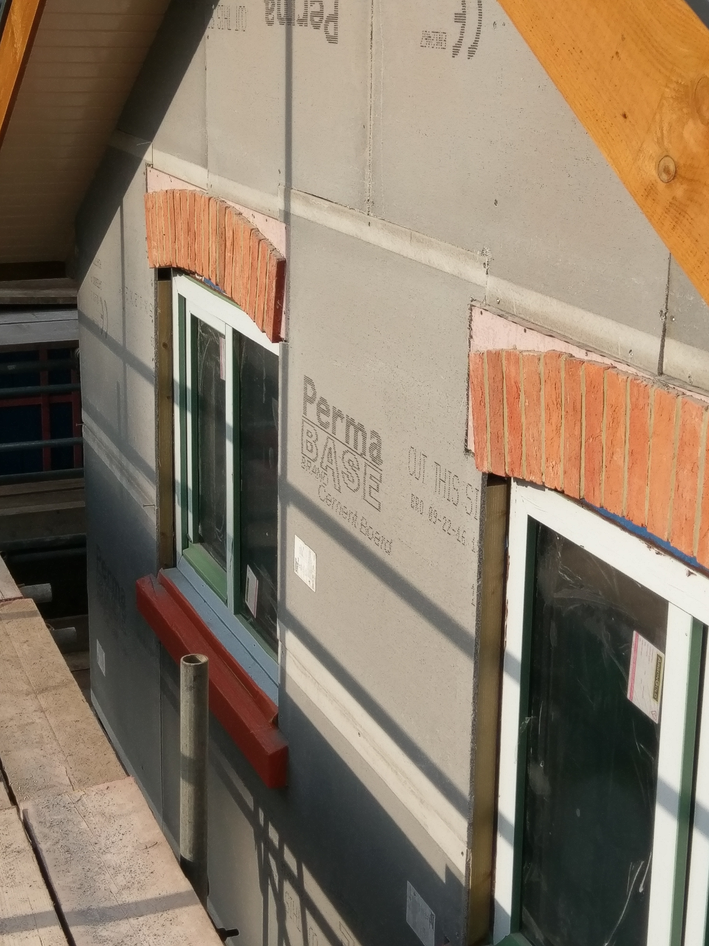

The fake arch heads
ready for render

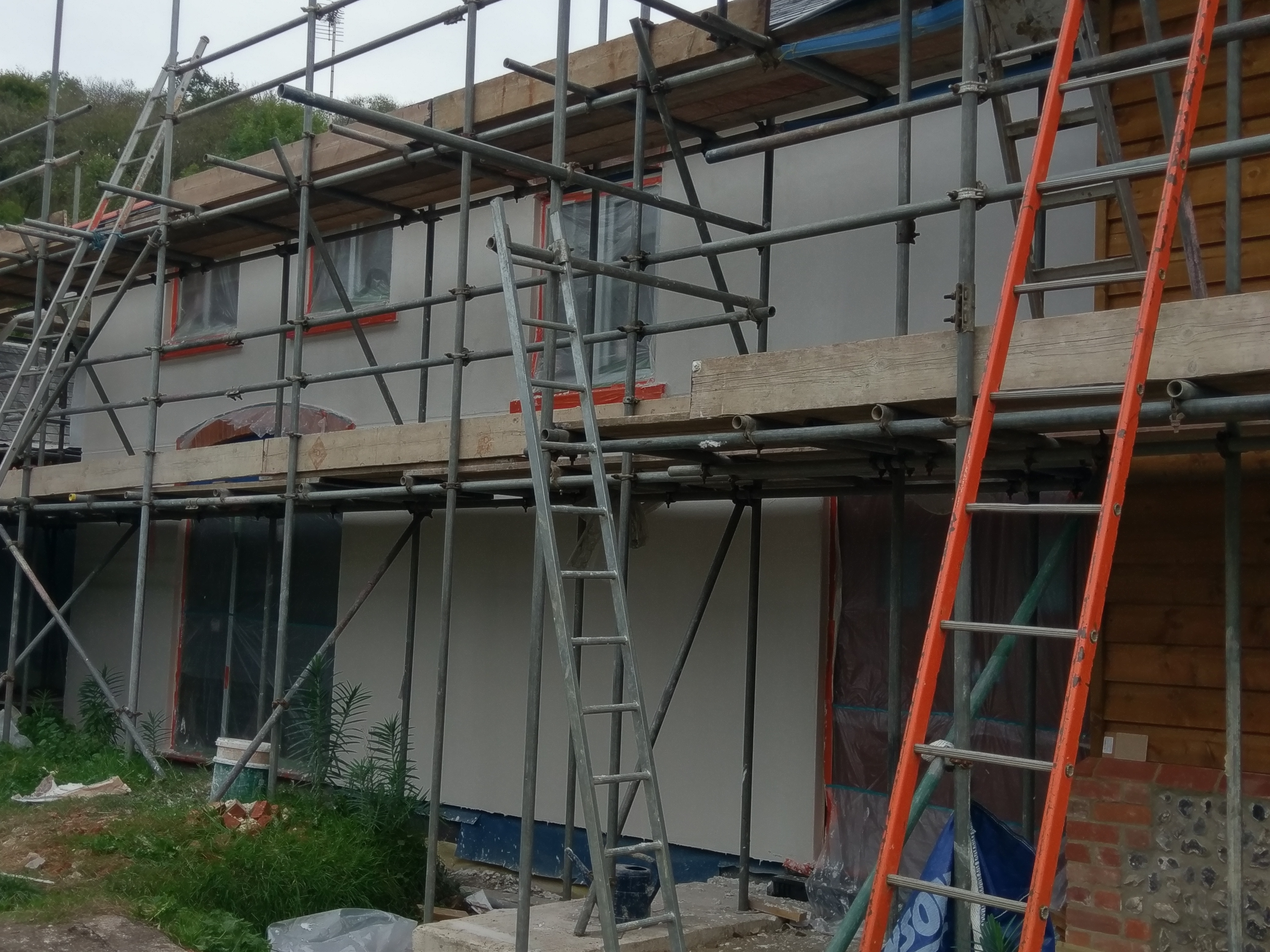

Base coat
Finished just need to tidy up

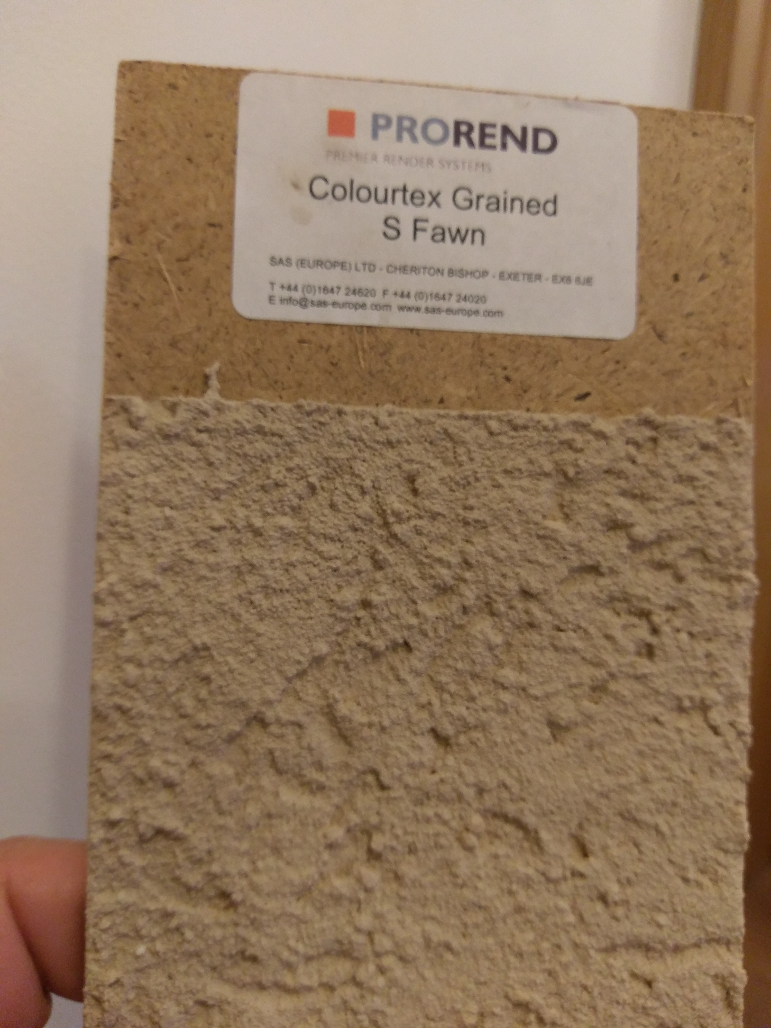

The colour will lighten to a fawn and it was getting dark so it is not that pink
