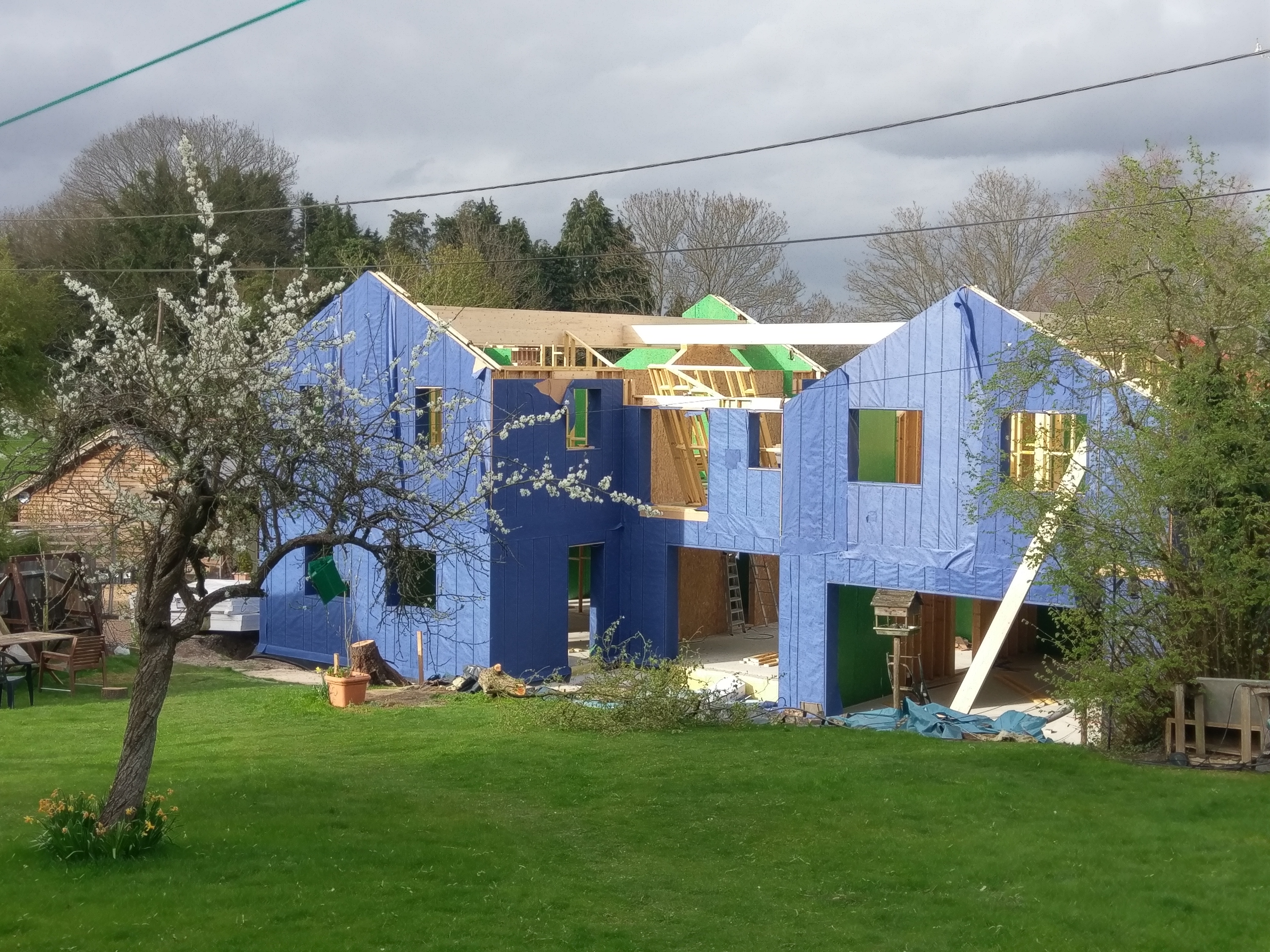

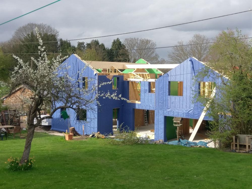

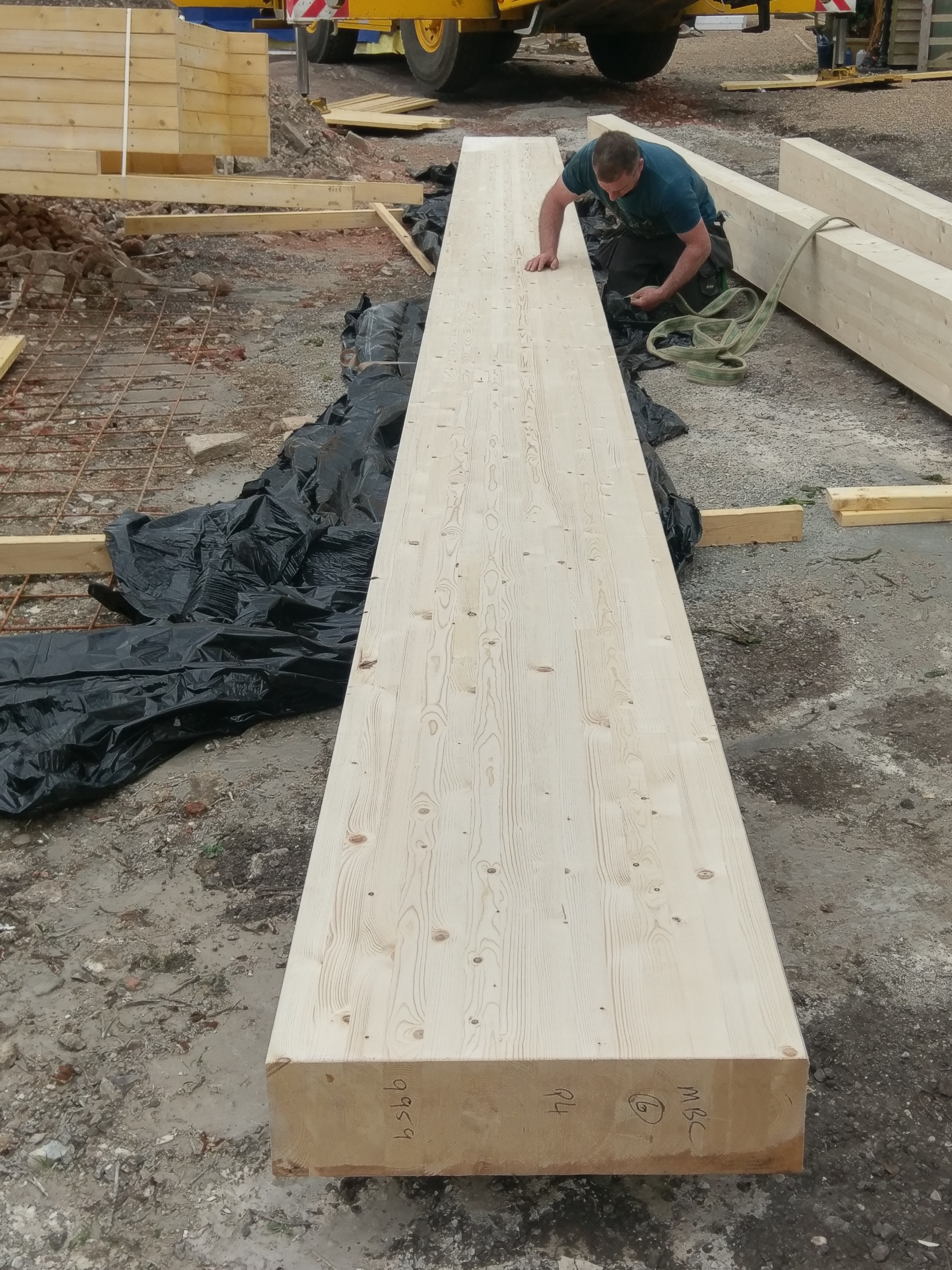

dogman Posted March 31, 2017 Author Posted March 31, 2017 Just had my mid build BC inspection. I do not need to box in the Beautiful 10m Glulam beams as only holding up roof saved me a bit of work 1
dogman Posted March 31, 2017 Author Posted March 31, 2017 Apparently i have the biggest one he has seen 1
ProDave Posted March 31, 2017 Posted March 31, 2017 I think I said this in another thread recently. Boy that's a big un. Our present house has 2 glulam beams hidden in the roof. I think if I had known just ho nice they can look, I woudl have asked for the design to be such that part of them was on show. My new house uses Kurto beams, aparently Glulams would have been far too big to get the strength.

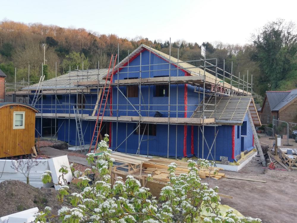

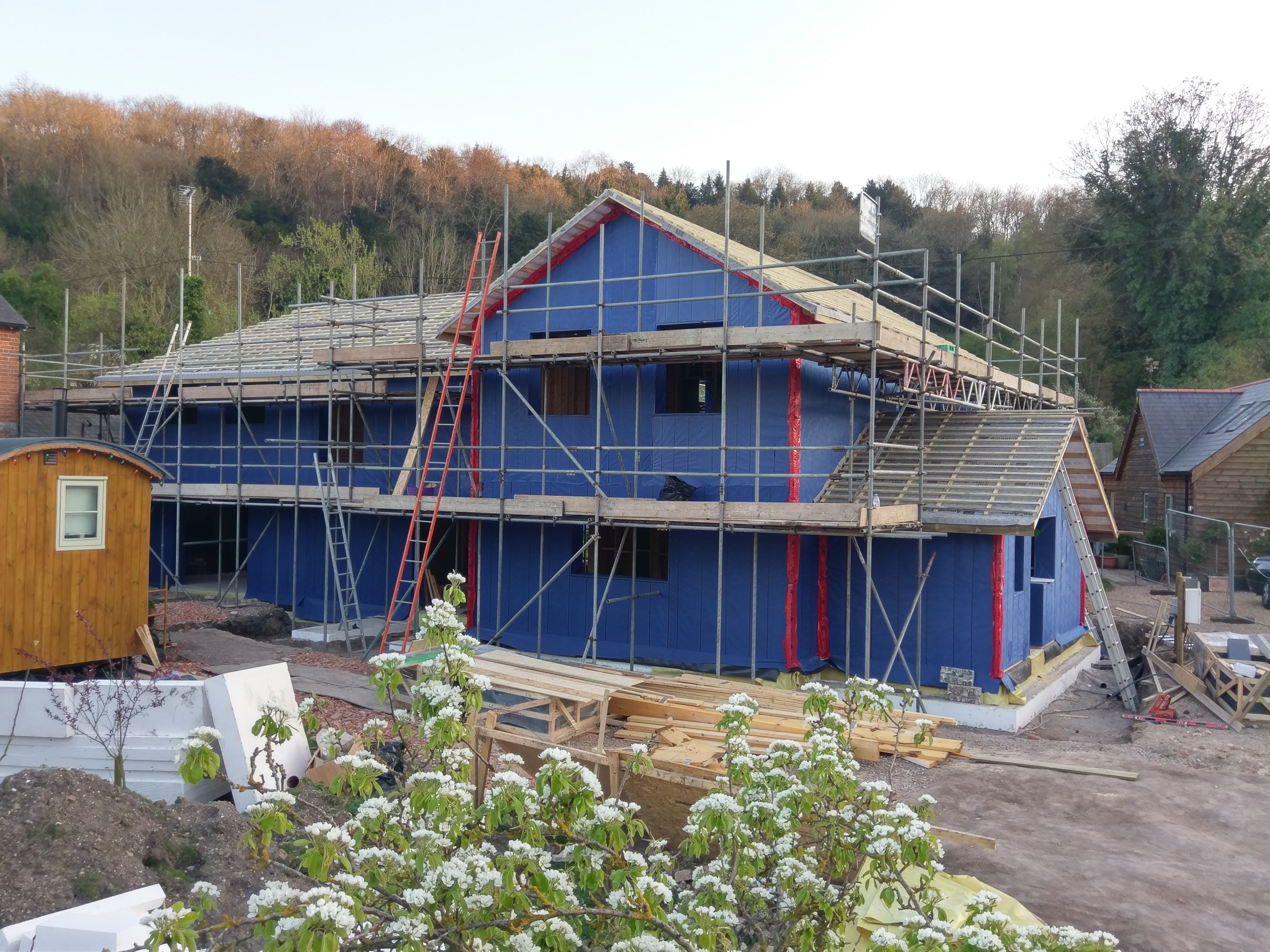

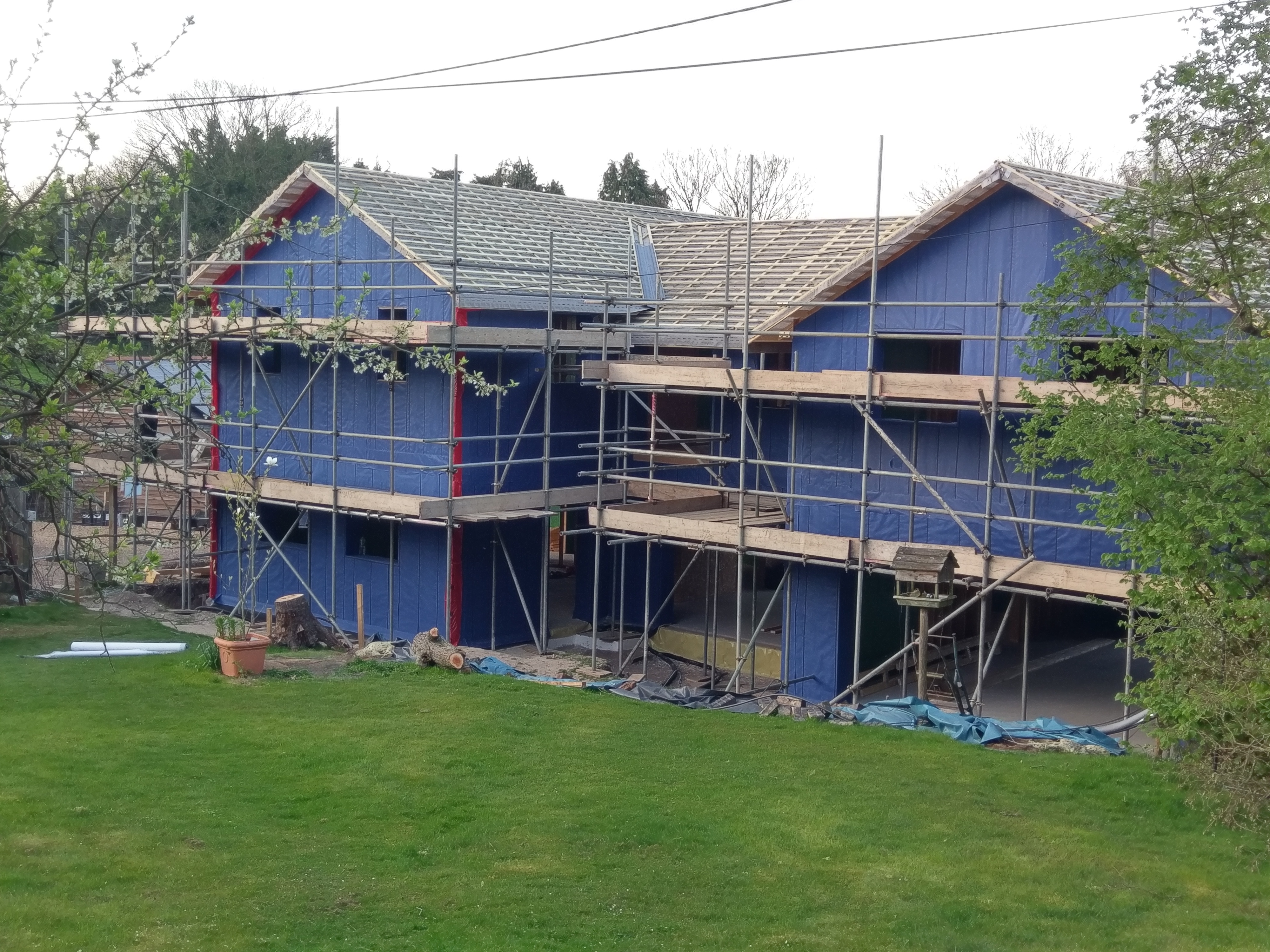

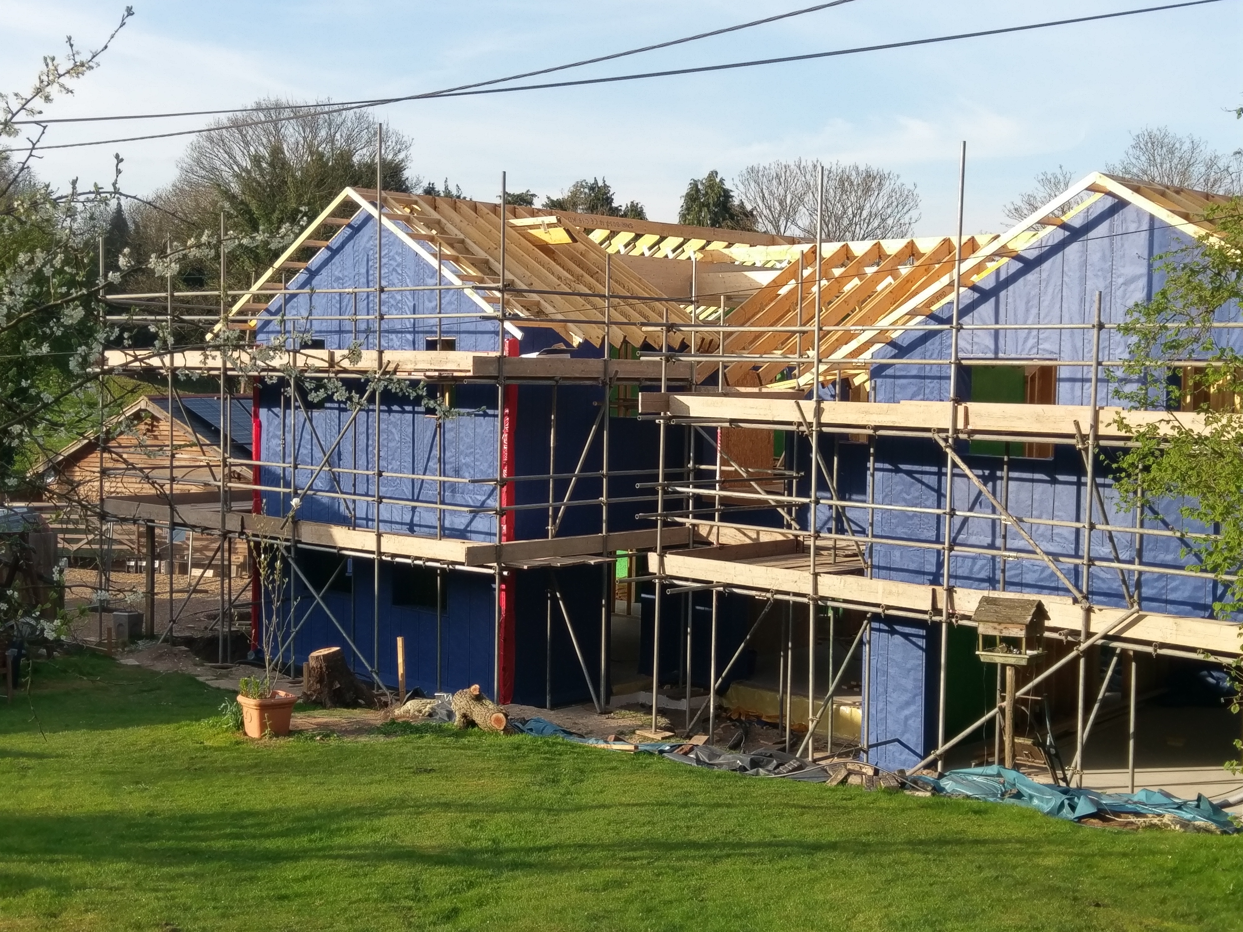

dogman Posted April 5, 2017 Author Posted April 5, 2017 Been a bit less hectic this week. One team working on the roof. Scaffold went up Monday Hopefully will be felted and battened tomorrow 2
dogman Posted April 8, 2017 Author Posted April 8, 2017 No not by a long way. I now have to slate the roof and get the windows and doors in and some of the MHVR pipes upstairs. They then come back, seal the structure, insulate and batten the inside for the plasterboard. Plus a couple of ceilings upstairs that can only be done after sealing.

dogman Posted April 8, 2017 Author Posted April 8, 2017 I have to say that the last 4 weeks have been amazing. This is the third self build we have built and i have found the MBC teams to be some of the hardest working and skilled carpenters i have ever seen. The attention to detail and the standard of their workmanship is second to none. I just went onto the roof to start setting out for the slates. Ran a laser square across the roofs and there was only a couple of millimetres difference.
Simplysimon Posted April 8, 2017 Posted April 8, 2017 are you slating onto counterbatten? as this is one point i've yet to work out, normally slate onto sarking but going with egger board for air tight

dogman Posted April 9, 2017 Author Posted April 9, 2017 @Rossek9 I would always shop around and listen to others as there are some timber frame companies who get good reviews on here. I would suggest you try and have a look at a couple during construction as this gives a true idea of the quality. MBC will send you details of local builds that welcome visitors and if you were a bit closer you would be welcome to look at mine. I looked at SIPS, ICF and timberframe companies when i was planning this, and i was favouring SIPS until i saw my first MBC home as it was just so much better. A lot of my experiences were with Sips and the compromises you need to make with foundation design to avoid issues with the sole plates. Another point i liked was that with SIPS and other builds you very much need to ensure the frame is sealed as it is built. (SIPS are effectively glued together) As with any timberframe there will be some slight( i am talking 1-2mm) between panels as wood does move. The MBC twin stud system solves this by using pumped insulation that fills the whole of the wall meaning there can never be a gap between two panels. @Simplysimon yes we are slating on counter battens. This helps with ventilation between the insulating layer and the slates on a warm roof.( required I think by building regulations)
