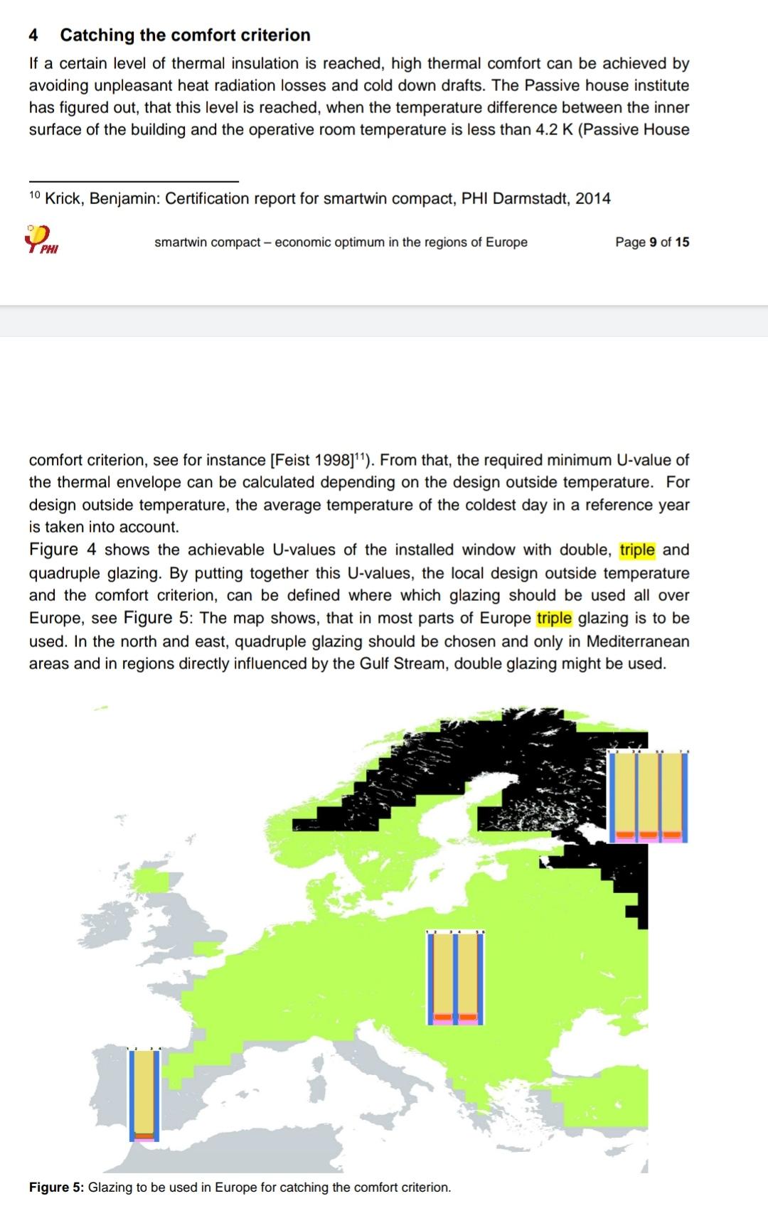

Iceverge Posted April 17, 2021 Posted April 17, 2021 An important part of glazing is thermal comfort. Someone in the passive house movement (cult!?) figured 4 deg was the maximum difference between adjoining surfaces in a house for maintaining a scientifically calculated level of comfort. The attached image I found in a Smartwin doc suggests that for almost all of the UK double glazing is sufficient to achieve this. However, I challenge you to source a suitably high quality double glazing supplier that the price uplift to triple glazing isn't marginal. 2
Oz07 Posted April 18, 2021 Posted April 18, 2021 I'd be more interested in what the frame is built from and the longevity of this if it was a forever home. Do the high quality window suppliers just use the same size rebate with deeper beading for 2g as opposed to 3g? My nans been in her place over 30 years now. Got the rosewood upvc they put in when renovated before moving in. Changed a few units but the frames still serviceable now. How long are the "good quality" 2g Windows expected to last above the standard upvc product? Got the standard upvc in mine and got a good air test result. I think when it comes to Windows be careful not to overspend and don't believe all the hype.
dpmiller Posted April 18, 2021 Posted April 18, 2021 upvc works fine for me too. Isn't it tru tho that a poorly- designed 3g unit can be bettered by the best of the 2g options? Without going to "fancy" frame options (aluclad etc) there's only so much depth to work in and filling the 2g's airgap with another sheet of glass doesn't leave much space... Other than the asthetic of the more expensive frame options, are we not into the realm of diminishing returns as with other insulation thicknesses?
tonyshouse Posted April 18, 2021 Posted April 18, 2021 It is fake news that 3g can be bettered by any 2g and nonsense Our uk plastic windows are poor quality and short lived, proper windows should last many decades 1
