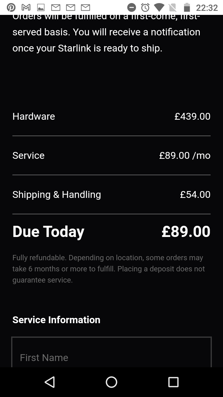

Dave Jones Posted February 9, 2021 Share Posted February 9, 2021 https://www.starlink.com/ Very very good according to people who are trying it in Cornwall. 1 Link to comment Share on other sites More sharing options...

Onoff Posted February 9, 2021 Share Posted February 9, 2021 14 hours ago, Dave Jones said: https://www.starlink.com/ Very very good according to people who are trying it in Cornwall. I thought I'd sign up...not at those prices! What does "fully refundable" mean? 1 Link to comment Share on other sites More sharing options...
