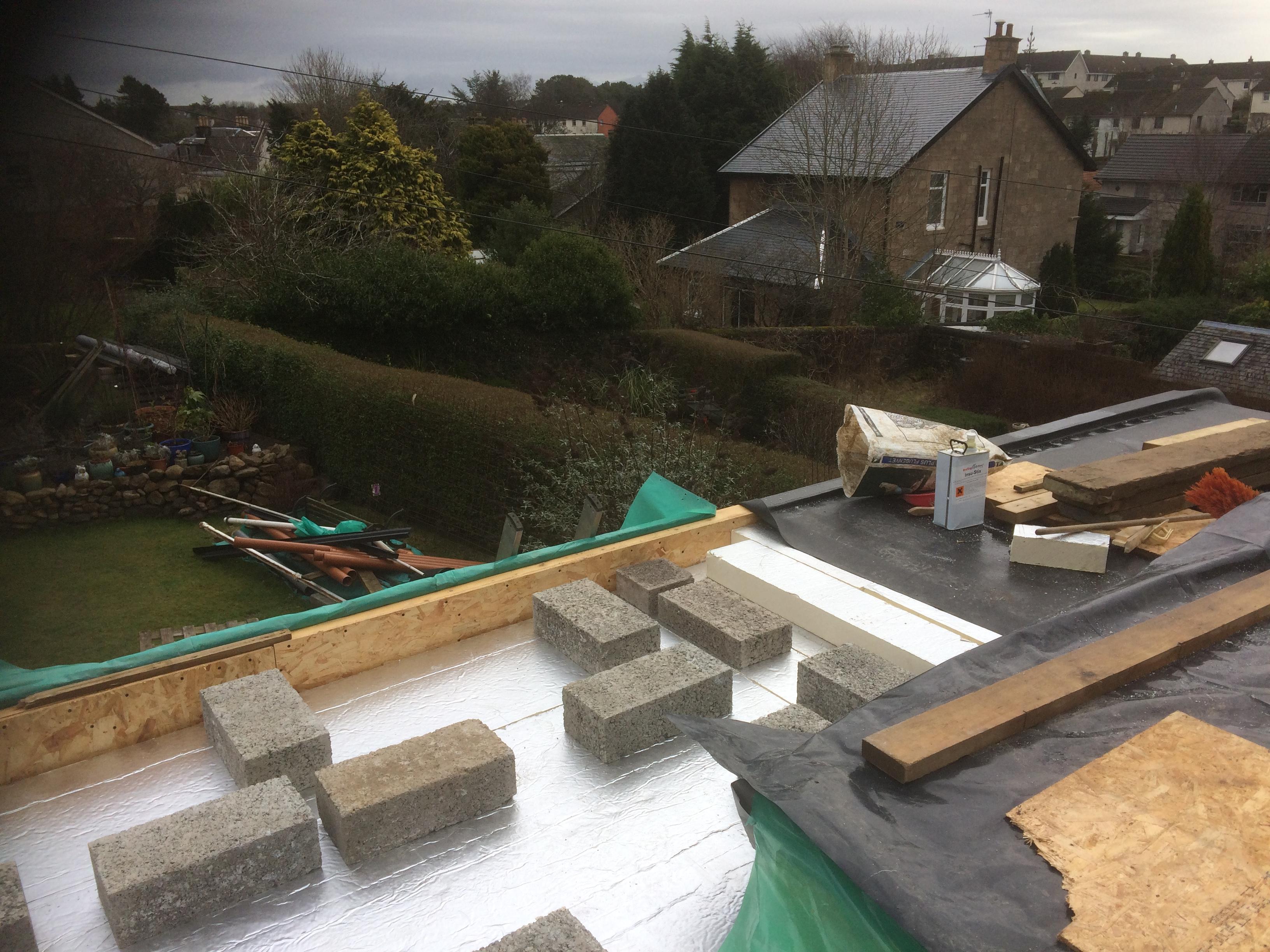

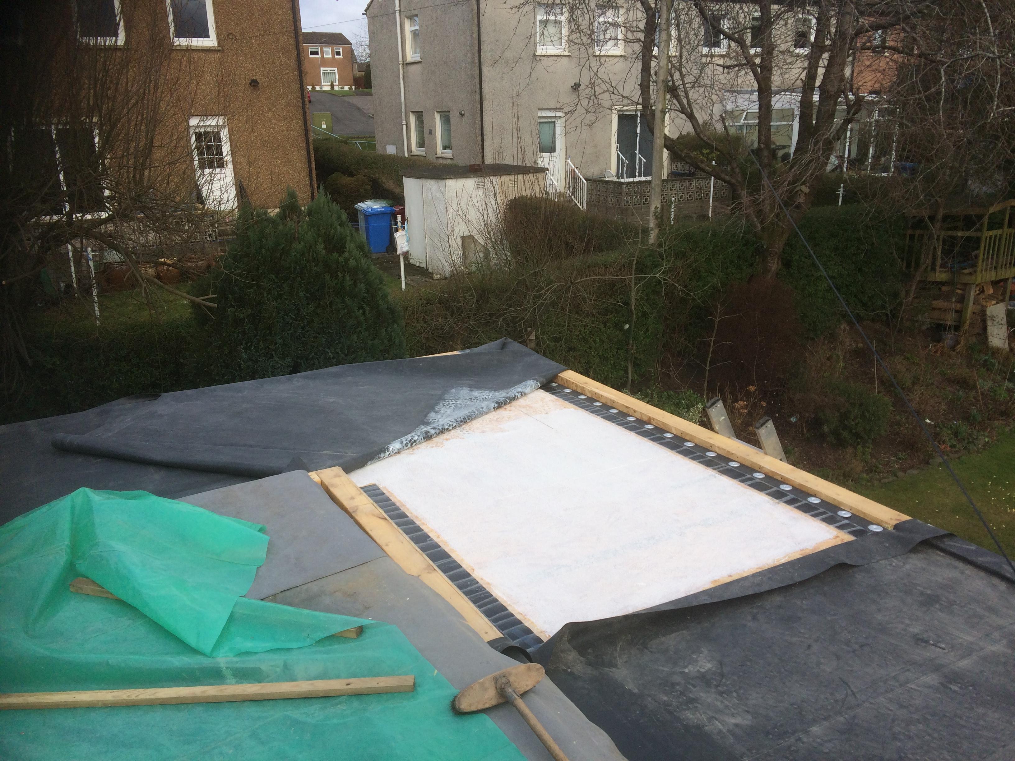

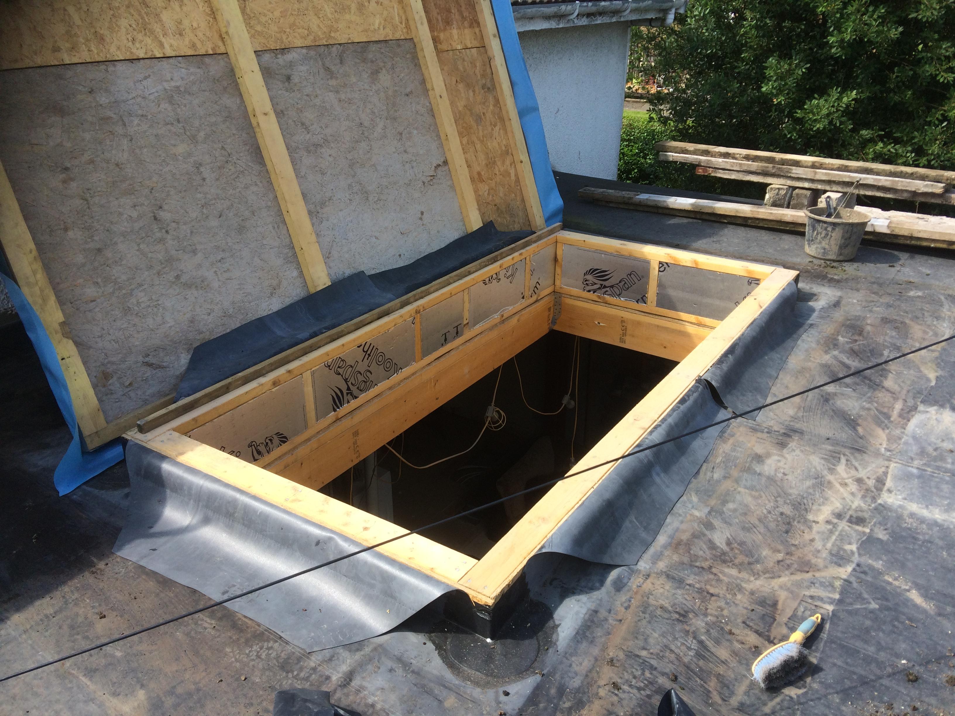

Gus Potter Posted March 24, 2021 Posted March 24, 2021 Hello JTB. Yes I had the same issue. My flat roof make up is: EPDM rubber glued to 18mm thk OSB3 glued onto the top of two staggered layers of 100mm PIR (thus 200mm thick) on vapour membrane. Vapour membrane is on 18mm thick OSB3 resting on 195 x 45mm joists with 12.5mm plasterboard on inside. I plumped for this as I was doing it single handed. The glue for the insulation / OSB3 interface is a poly urathane (PU adhesive), I used Insu stix, the can is in the photos. Very effective. I did the membrane in two halves as it was too heavy and bulky to handle on my own. The blocks are to weight down the insulation while the glue cures. And yes the pipes in the garden etc can do with a tidy up. Roof lantern in progress. I also opted for this solution as the weather is a bit unpredictable here. As there are no fixings then no potential thermal bridges, problems installing a fixing through 200mm plus insulation and hitting a joist etc. Hope this helps flesh out your ideas. Only issue is you have a pretty thick roof so I'll maybe use some careful shaddow gaps etc to try and reduce the tunnel effect at the lantern. It looks promising at this point.. nearly ready to start messing with the plastering here. 3
Big Jimbo Posted March 24, 2021 Posted March 24, 2021 On 24/03/2021 at 17:11, Gus Potter said: Hello JTB. Yes I had the same issue. My flat roof make up is: EPDM rubber glued to 18mm thk OSB3 glued onto the top of two staggered layers of 100mm PIR (thus 200mm thick) on vapour membrane. Vapour membrane is on 18mm thick OSB3 resting on 195 x 45mm joists with 12.5mm plasterboard on inside. I plumped for this as I was doing it single handed. The glue for the insulation / OSB3 interface is a poly urathane (PU adhesive), I used Insu stix, the can is in the photos. Very effective. I did the membrane in two halves as it was too heavy and bulky to handle on my own. The blocks are to weight down the insulation while the glue cures. And yes the pipes in the garden etc can do with a tidy up. Roof lantern in progress. I also opted for this solution as the weather is a bit unpredictable here. As there are no fixings then no potential thermal bridges, problems installing a fixing through 200mm plus insulation and hitting a joist etc. Hope this helps flesh out your ideas. Only issue is you have a pretty thick roof so I'll maybe use some careful shaddow gaps etc to try and reduce the tunnel effect at the lantern. It looks promising at this point.. nearly ready to start messing with the plastering here. Expand Osb, insulation, insulation, osb, and epdm. My kinda flat roof. Looks great. 1
Gus Potter Posted March 24, 2021 Posted March 24, 2021 (edited) Thank you @ianfish and conor for the compliment, it's really appreciated. I have made a few practical mistakes.. maybe some technical ones too! For example. I laid out the membrane for a while after it came in a back off the lorry (it was much heavier than I thought being on my own) to let the creases settle out. It thought I had got them all but I failed so a bit of the roof still has a crease in it. It's still water tight and I may come back to it at some point. But at the moment I need to finish the rest of the job! Every day is a school day! Thanks again for the compliment. Edited March 24, 2021 by Gus Potter

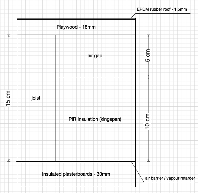

MP1 Posted April 21, 2021 Posted April 21, 2021 Hi @Gus Potter On 24/03/2021 at 17:11, Gus Potter said: My flat roof make up is: EPDM rubber glued to 18mm thk OSB3 glued onto the top of two staggered layers of 100mm PIR (thus 200mm thick) on vapour membrane. Vapour membrane is on 18mm thick OSB3 resting on 195 x 45mm joists with 12.5mm plasterboard on inside. Expand What thickness is your EPDM and what brand did you get? I am thinking about EPDM but I have never done it before. My flat roof stack for a small, 30sqm outbuilding (office, gym, bathroom with steam shoer) is going to as below:
