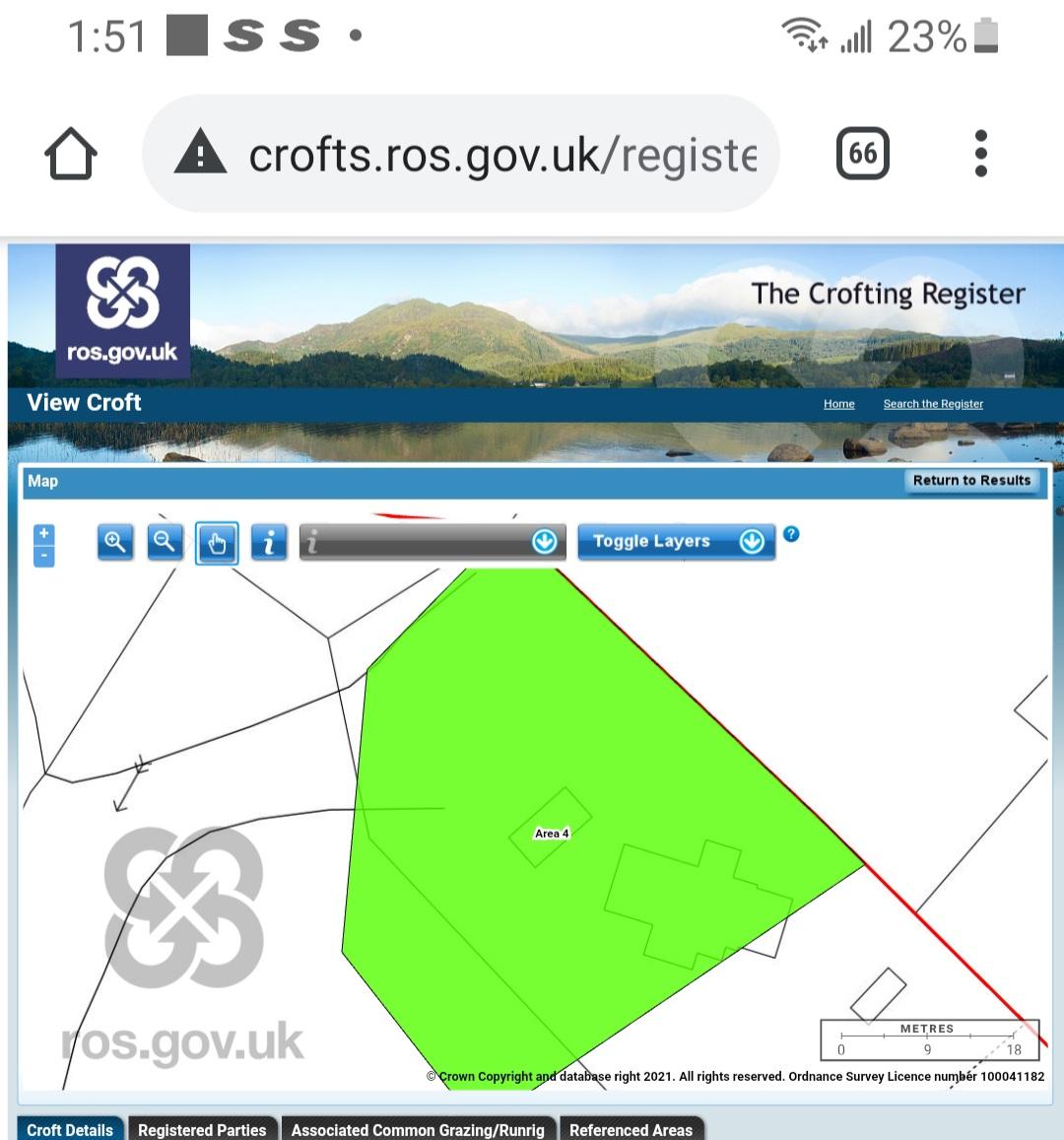

Highland girl Posted February 3, 2021 Author Posted February 3, 2021 He wasn't aware until he saw it on the Crofting Registry of Scotland.The site was not square and I have put house at an angle so on the ground it is difficult to see encroachment.

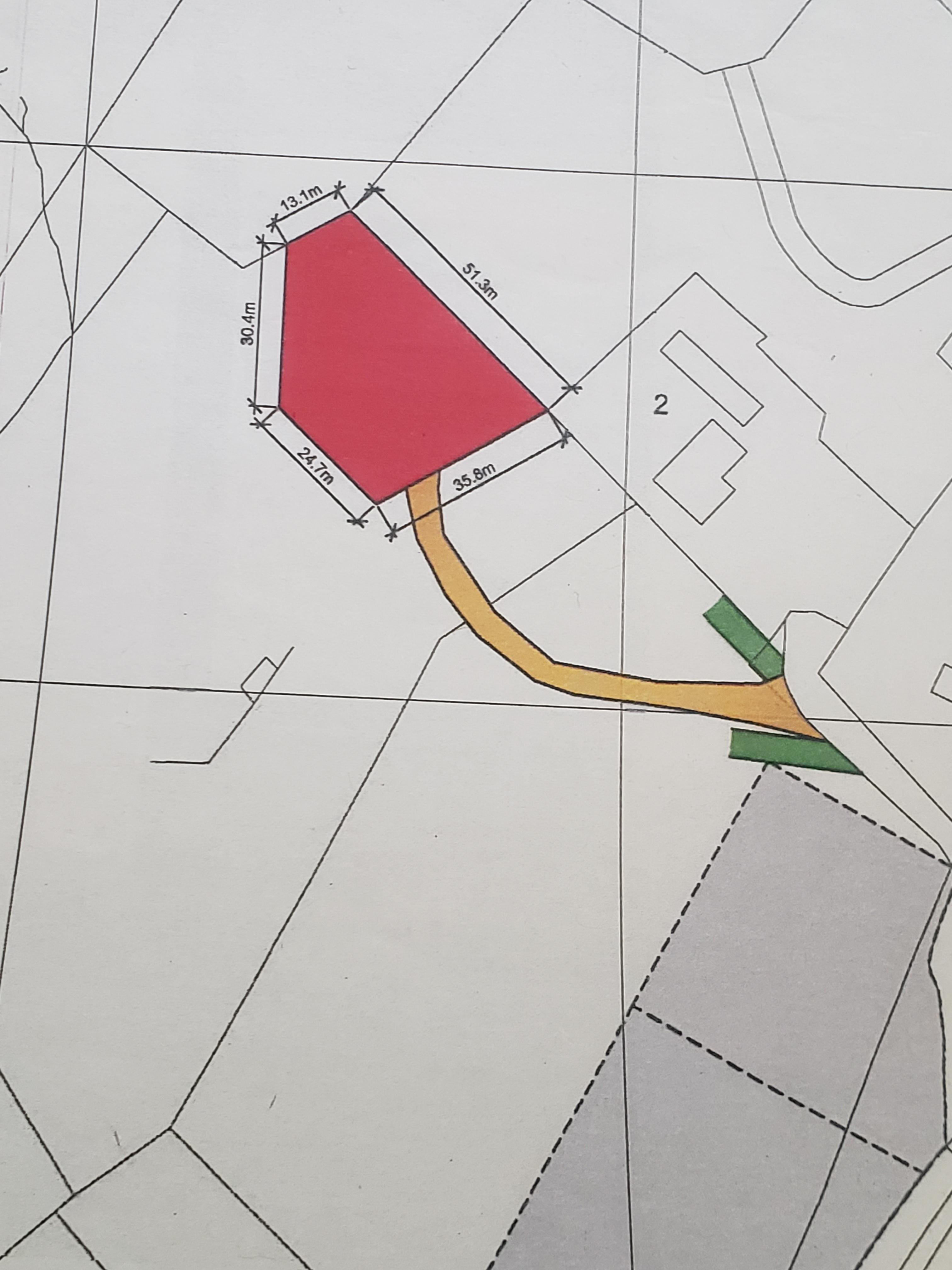

AliMcLeod Posted February 3, 2021 Posted February 3, 2021 (edited) It's not clear (a site map showing approved and actual would be useful) but it sounds like the house is actually more than 4 meters away from where it was meant to be (as per approved plan), but has encroached 4m outside of the owned plot. It sounds like that 4m area might be farmland, so potentially not marked as residential. Highland Girl, have you spoken to the architect? Have you actually moved into the house (I note you say it has no completion certificate yet). Have you submitted your VAT reclaim (ie. is this waiting on the completion certificate)? Edited February 3, 2021 by AliMcLeod

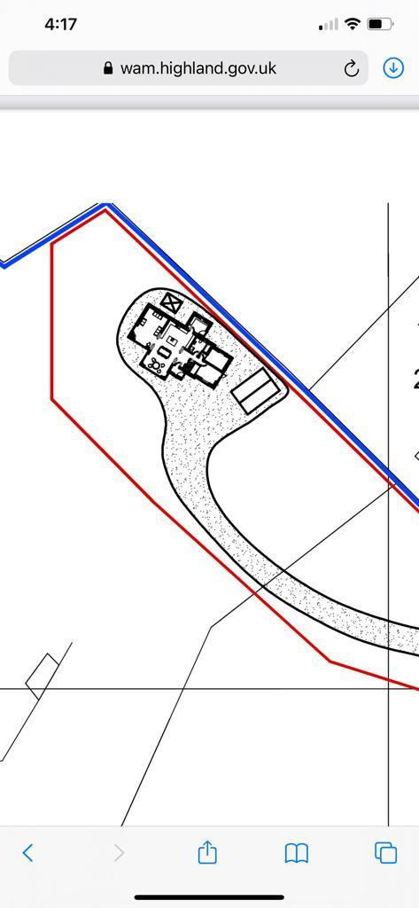

Stones Posted February 3, 2021 Posted February 3, 2021 @Highland girl So you have a number of issues here. First the position of the house, if you have built it in the wrong place (and you have said you and the architect pegged it out), then you have built your house otherwise than in accordance with your approved plans. How your local planning authority views this will depend on a number of factors - there is always a little give and take, but 4 metres is a material rather than non material change, and I would suggest you would be asked to reapply for planning permission to regularise the development. That may come with additional restrictions. In order to remove the development, enforcement action would have to be taken, which has appeal provision in place. The first objective will be to regularise I suspect, if the house is otherwise built in accordance with the approved plans. You could be proactive and go to the planning authority and ask how to regularise now you realise the situation, or wait for enforcement action to be initiated. I would suggest if you are intending to sell, you need to get this resolved. As to you building on land which you do not own, the position with your ex and him 'having' to sign over title, splitting sale proceeds and who gets what etc, you NEED to get professional legal advice, not rely on an online forum of non legal experts. All you are getting here are thoughts and opinions. If you have encroached onto crofting land, then you would need to get a decrofting direction for the relevant area (assuming the actual original house plot has already been decrofted). 3
Highland girl Posted February 3, 2021 Author Posted February 3, 2021 On 03/02/2021 at 12:01, AliMcLeod said: It's not clear (a site map showing approved and actual would be useful) but it sounds like the house is actually more than 4 meters away from where it was meant to be (as per approved plan), but has encroached 4m outside of the owned plot. It sounds like that 4m area might be farmland, so potentially not marked as residential. Highland Girl, have you spoken to the architect? Have you actually moved into the house (I note you say it has no completion certificate yet). Have you submitted your VAT reclaim (ie. is this waiting on the completion certificate)? Expand Yes it has moved more than 4 meters and it is also 4 meters onto farmland. Yes submitted VAT reclaim and waiting for completion certificate.

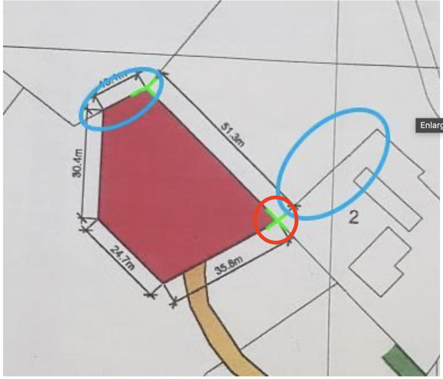

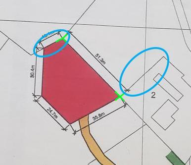

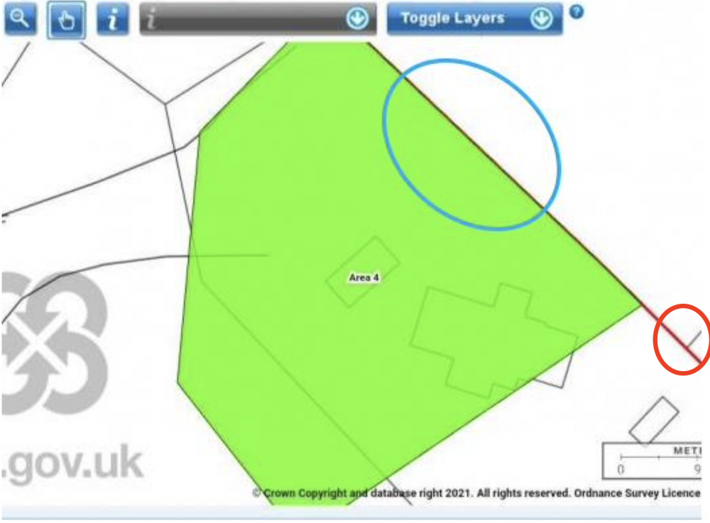

PeterW Posted February 3, 2021 Posted February 3, 2021 Those two areas are different shapes ..!! Assuming the other house is in the correct place on the map, you haven’t really got the right layout on either of those systems. GIS maps are notorious for being out of alignment - if you can overlay the existing satellite over the Croft map you may see that the current house to the right is also in the wrong place.
ToughButterCup Posted February 3, 2021 Posted February 3, 2021 On 03/02/2021 at 13:22, Stones said: .... First the position of the house, if you have built it in the wrong place (and you have said you and the architect pegged it out), then you have built your house otherwise than in accordance with your approved plans. ... Expand Could I just ask: how do you know that Quote ... the house is 4 metres onto farmland that I don't own. ... Expand I ask because ( and I had forgotten ) @PeterW's point On 03/02/2021 at 15:59, PeterW said: ... GIS maps are notorious for being out of alignment - if you can overlay the existing satellite over the Croft map you may see that the current house to the right is also in the wrong place. Expand How do you know for sure that your house is in the wrong position; and on what (or with what) authority was that statement made to you? In other words, what's the evidence base for the claim that your house is in the wrong place?
the_r_sole Posted February 3, 2021 Posted February 3, 2021 On 03/02/2021 at 16:54, ToughButterCup said: Could I just ask: how do you know that I ask because ( and I had forgotten ) @PeterW's point How do you know for sure that your house is in the wrong position; and on what (or with what) authority was that statement made to you? In other words, what's the evidence base for the claim that your house is in the wrong place? Expand exactly - it goes back to how it was set out and what information was used for that, I've had numerous arguments with solicitors in the past about them wanting OS drawings which aren't actually correct to be used as deed plans... 1
pdf27 Posted February 3, 2021 Posted February 3, 2021 On 03/02/2021 at 13:57, Highland girl said: Yes it has moved more than 4 meters and it is also 4 meters onto farmland. Yes submitted VAT reclaim and waiting for completion certificate. Expand Just to confirm - is the image above the one showing what you own, i.e. the one with the land registry? The maps are all inconsistent with each other. IF this is the correct map, then we have a good datum on the ground for where your land starts - the corner of the boundary with the other house marked (2). Note that the green area marked on the croft map is inconsistent with this because the corner does not match the boundary shown - the discrepancy is something like 10m scaling off the 51.3m length marked.
