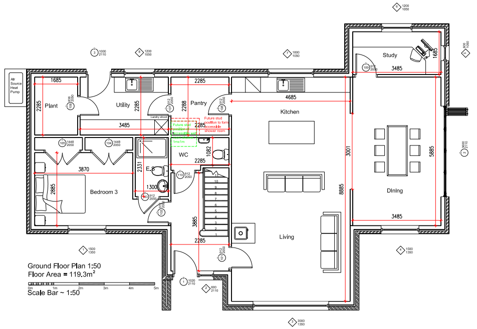

the_r_sole Posted January 24, 2021 Share Posted January 24, 2021 Would be helpful if you could post the plan to help the discussion but is your entrance recessed? If you look at the examples you've posted, the eaves height of the protruding gables is either matching the main house or slightly above it, never below it - that's making your elevation look wrong. Then the width of it is too much of the length of that elevation, and the openings on all the others are for the most part symmetrical whereas yours has a completely random placement if openings, it may be that the plan is generating the elevations but I think more care could be taking in making it look right. Have you not got a designer on board to look at the aesthetics? Link to comment Share on other sites More sharing options...

Omi Posted January 24, 2021 Author Share Posted January 24, 2021 (edited) Hi everyone, Thank you for the feedback thus far. I can see that the design is quite polarising! The only real feedback has been that the gable is too wide so I assume the LPA is looking for us to make it narrower somehow. Trouble is that the elevations are dictated by the internal layout/flow which in turn is driven by the features of the site. There's farmland to the right of the plot and row of stone cottages to the left. It's also farmland across the road. The house to the rear is finished in off-white render. We don't believe it's going to go to committee at this time. The plot is not in a sensitive/conservation area. We're working with the timber frame supplier on the design and they are also the ones dealing with the planning office. They have had a good relationship with the officer for the region but he retired/moved on some time ago and now we have a junior, "assistant planning officer" looking at the applications. So we're likely dealing with someone with little experience here. Here are the internal plans if it helps: Thanks! Edited January 24, 2021 by Omi Link to comment Share on other sites More sharing options...

Ferdinand Posted January 24, 2021 Share Posted January 24, 2021 Hi Where's North? And the best views? And the main part of your garden? Cheers F Link to comment Share on other sites More sharing options...
Omi Posted January 24, 2021 Author Share Posted January 24, 2021 Hi, Reducing the gable to the living room section is our line of thinking for the fallback position but it would likely mean losing the arched entrance which we feel adds quite a bit of character to the build (reflects a common local feature). Will be discussing this option with the designer to see what we can come up with. As for the compass points, North is up, East is to the right. Main bit of open grounds is to the East (also the best views). Hence the big gable windows on the master bedroom and doors out from the dining room on the ground floor. Thanks. Link to comment Share on other sites More sharing options...

PeterW Posted January 24, 2021 Share Posted January 24, 2021 3 hours ago, Omi said: Hi everyone, Thank you for the feedback thus far. I can see that the design is quite polarising! The only real feedback has been that the gable is too wide so I assume the LPA is looking for us to make it narrower somehow. Trouble is that the elevations are dictated by the internal layout/flow which in turn is driven by the features of the site. There's farmland to the right of the plot and row of stone cottages to the left. It's also farmland across the road. The house to the rear is finished in off-white render. We don't believe it's going to go to committee at this time. The plot is not in a sensitive/conservation area. We're working with the timber frame supplier on the design and they are also the ones dealing with the planning office. They have had a good relationship with the officer for the region but he retired/moved on some time ago and now we have a junior, "assistant planning officer" looking at the applications. So we're likely dealing with someone with little experience here. Here are the internal plans if it helps: Thanks! not sure what is driving some of your decisions but either your designer has shares in a door company, or they like lots of little compartments ..!! Quick comments : - is Bed 3 a guest bed ..? Or is it a permanent room..? You don’t need accessible shower provision if you start by making that one accessible from the outset. - utility through pantry means it is at room temperature or worse, may be heated if you are having uFH. Plant is huge - what do you think you are having in there...? - Study is tiny, nearly looks an afterthought. Draw it out on the floor and then take off 650mm all round for the desk etc and it will feel like a cell. You won’t be able to turn a decent chair round, never mind move it back. Steal 600mm from the dining room and you’ll get much better proportions. - Stove - just inside a door..? And where will the TV go..? Why not make it freestanding on the end of the dining / lounge divider wall. Also loses it out of Bed2 where it looks an afterthought. Bed 4 has no wardrobes and nowhere to put them easily. Steal the ends off the linen and store, use it for built in wardrobes. Main bathroom shower is tiny - layout is odd in there, move the door to the right and put the loo in the alcove and you have loads of room then for a decent shower plus bath. if Bed1 has the view to the east, why is the bed facing the wall ..?? Put a semi height stud 1m from the door and then face the bed to the windows - if you’ve got a view you may as well be able to see it ..! 1 Link to comment Share on other sites More sharing options...

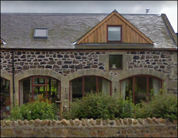

Omi Posted January 24, 2021 Author Share Posted January 24, 2021 @the_r_sole - the houses shown earlier were to establish a point about the gable. There are others in the area (same postcode in fact) with the arch feature (though no protruding gable): @PeterW - thanks for the very helpful comments, gives us lots to think about! Link to comment Share on other sites More sharing options...
Redoctober Posted January 24, 2021 Share Posted January 24, 2021 @the_r_sole - @Omi Here is another "local" house - with alcove gable type frontage. Good luck with resolving the issues raised. Link to comment Share on other sites More sharing options...
PeterW Posted January 24, 2021 Share Posted January 24, 2021 @Omi I think the pantry area is a good idea but would think how you would use it. If you lost the wall on the north side you could have a decent run of cabinets with some real variation and end it with full height fridge and freezer or American FF. Opposite side against the WC wall could have your dishwasher and a small rinse sink - ideal for when you're having a nice meal and don't want all the stuff on display when you've been cooking. If you do put the fridge etc there, put a small under counter one in your island too for the things you need when cooking such as milk, butter, wine, beer, tonic, etc... Link to comment Share on other sites More sharing options...
the_r_sole Posted January 24, 2021 Share Posted January 24, 2021 see, you've answered your own question, just because there's houses with a gable feature and some other ones with arches, they're very different styles of house, just jamming features in makes your elevation look clumsy. You could happily lose the arch and make your design more compatible with the local area - you really need someone with a design eye to look at the elevation, using the kit manufacturer to design is resulting in an efficient timber kit at the compromise of lots or areas imo 1 Link to comment Share on other sites More sharing options...
