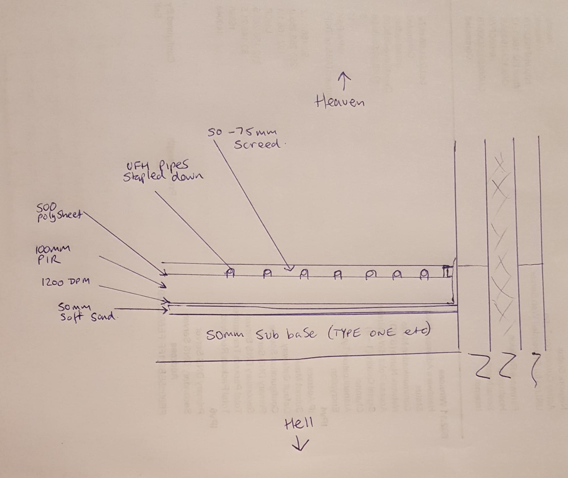

Hi Folks,
I have had a look at some plans for a house + land that has PP and founds in place.
The Construction of the sub floor is 100m concrete then goes the DPM then Insulation 100mm poly but the cut away shows a further 100mm screed
But say I wanted to put UFH in does this add further to the 100mm screed or do I skip this and put in a lower 60+mm screed.
The second wee question is there a difference between Liquid Screed (That seems to be laid over UFH) vs Sand and Cement mix?
Cheers

The additional screed described is the one in which your pipework will be installed. If they have it down as a 100mm they probably have done so referencing a standard sand and cement screed, they are usually thicker to allow for strenght and to avoid shrinkage cracking. Liquid screed will do the same job and better at alot thinner circa 50-60mm and fill around the UFH pipework better allowing them to be more efficient.  Also the thinner floor screed will dry faster helping your programme.

You will need to up that insulation level as 100mm is a very low spec and in keeping with the time your foundation was put in, you need to allow at least 150mm plus 50-80mm of screed depending on type of screed, then finish floor.
So that means your finished floor will be 250mm higher than the concrete you have in your pics.

UFH is very much in the realms of DIY, many of us have done it ourselves.   Use at least 150mm of PIR / PUR type insulation and a thinner screed.
But would it even matter if you fitted more insulation and ended up with a slightly higher finished floor level?  Unless there is a very srict planning condition on floor or building height, nobody is going to notice another 50 oe 100mm.

Knocked out 57m2 of the old concrete, excavated the sub floor then sand, dpm, 100mm of PIR and more dpm. Then approx 400m of UFH pipe. 25mm of PIR upstand along with expansion strip foam and 75mm of free flow screed (laid by contractor)....... kept me fit over the summer doing the project and is now keeping us toasty warm over Christmas..... probably the most enjoyed end product ive ever done!! i echo the above comment in that it is easier to install than radiators etc. one thing to remember- keep the pipes under pressure when you have the screed laid. You dont need to hire or buy an expensive pressure tester, i bought one from ebay for £11 and it works fine.
can I be a nuisance and ask you to roughly draw this in a diagram With dimensions on? I’ve seen so many different methods and am looking for a definite method to copy. As soon as I get the keys I want to get digging and don’t want to get it wrong
Ill try my best Gareth- what dimensions is it you want, the section of the UFH and insulation etc or the plan of the room ?
If its the former its very similar to Wozzas diagram above. If its the latter i downloaded the trial version of loopcad and uploaded my cad drawings to it and spent a weekend drawing pretty shapes to design the pipe layout. I ended up with 115mm approx centres on the pipes with 4 circuits in the room.
Ill get scribblin.......

1 hour ago, johnbarleycorn01 said:
Thank you very much John, this is exactly what I was after. I’m guess img that’s liquid screed? Did you so that yourself or use a company to do it for you?
