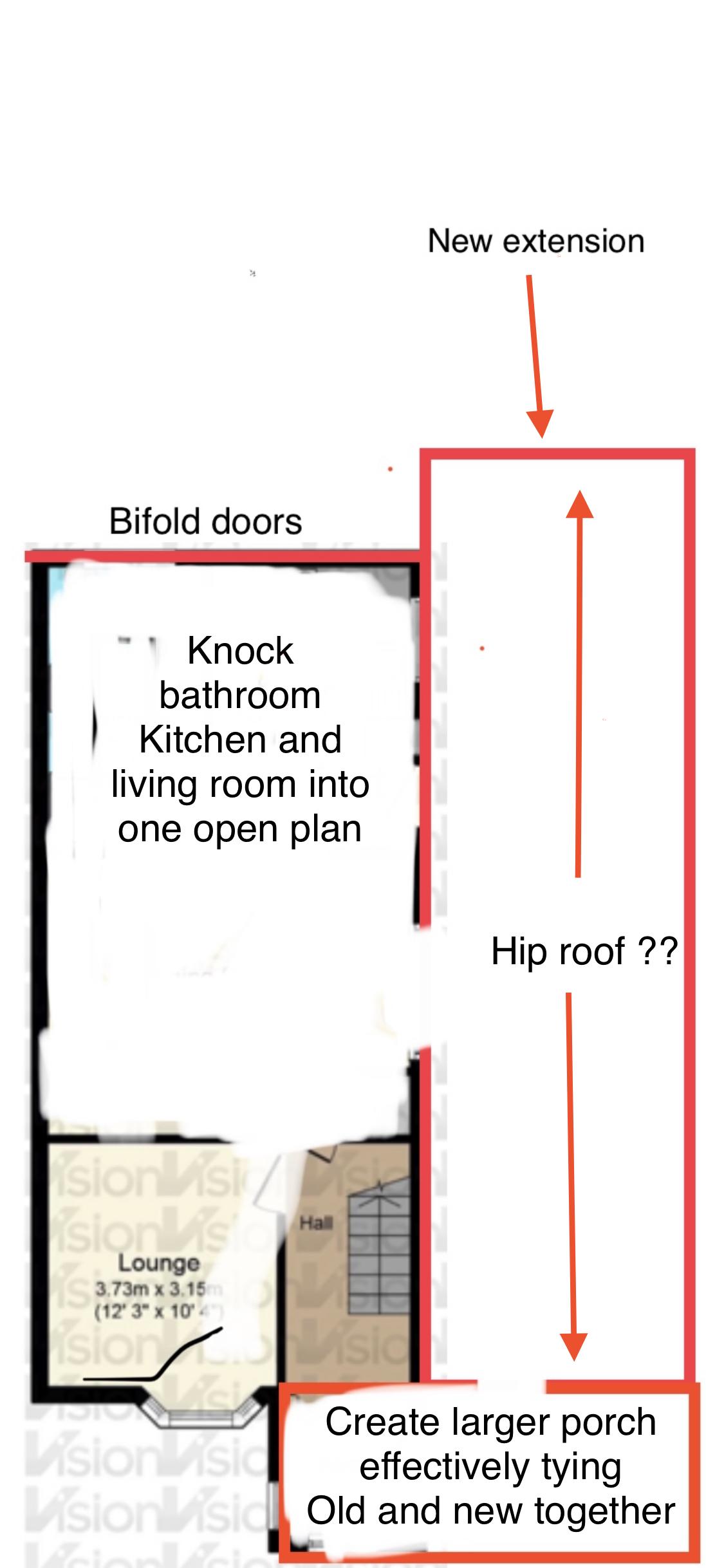

  7. Yes, excellent @OnoffThis is basically what I envisage, double right up the side, until level with the existing extension- from what I’ve learnt so far planning requires it to be stepped back so not to give it a ‘terraced street’ appearance. if I extend the hip roof as per drawing,how will the ‘roof overhang’on the back end Tie in?

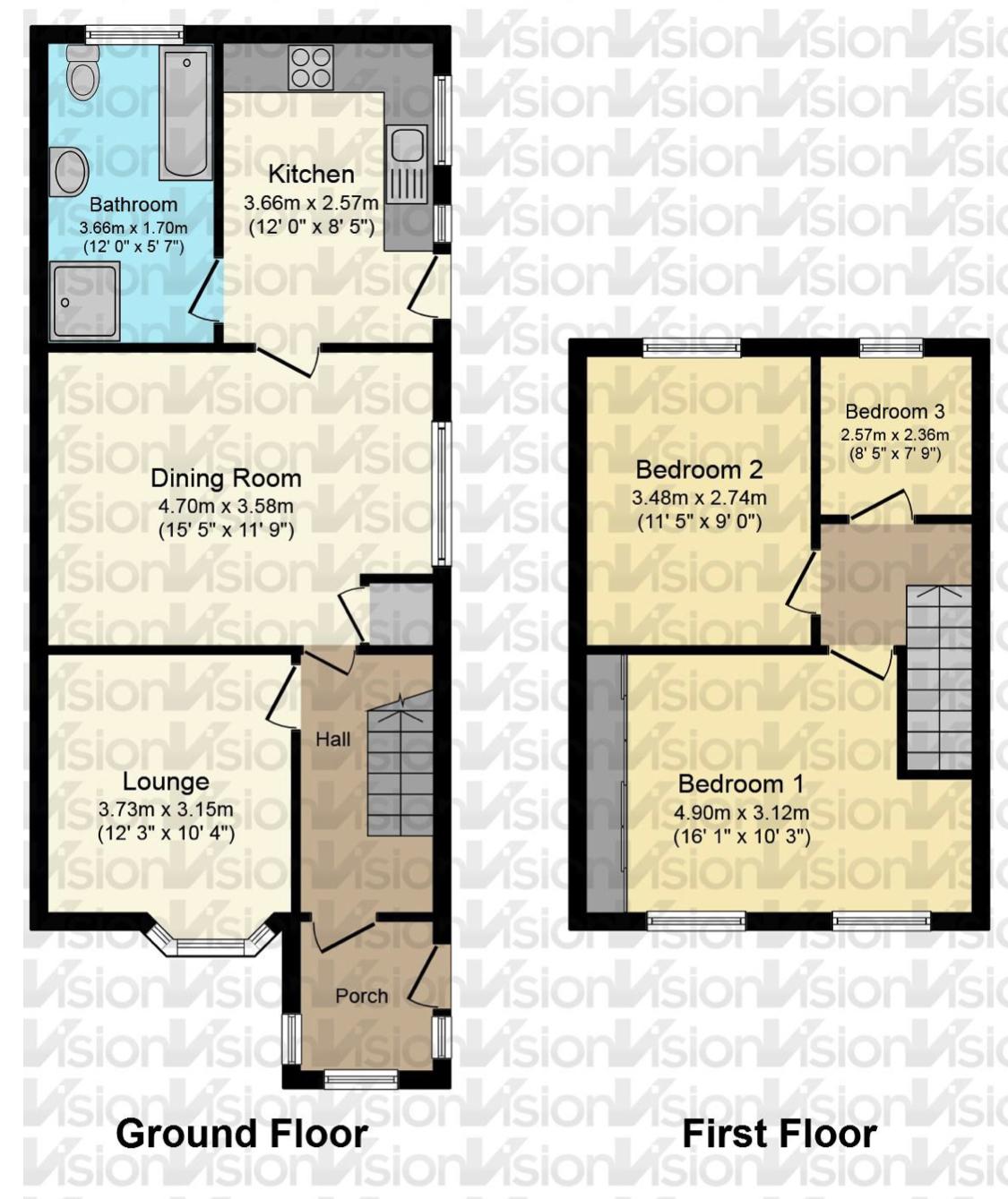

  8. This is the thing, I want my extension running front to back effectively, so that it allows enough room for access and a drive/carport/garage in the future-I’ll add existing and floor plans below as a rough guide for you lot to see if I’m heading somewhere that’s possible, or just into a big pit of shit

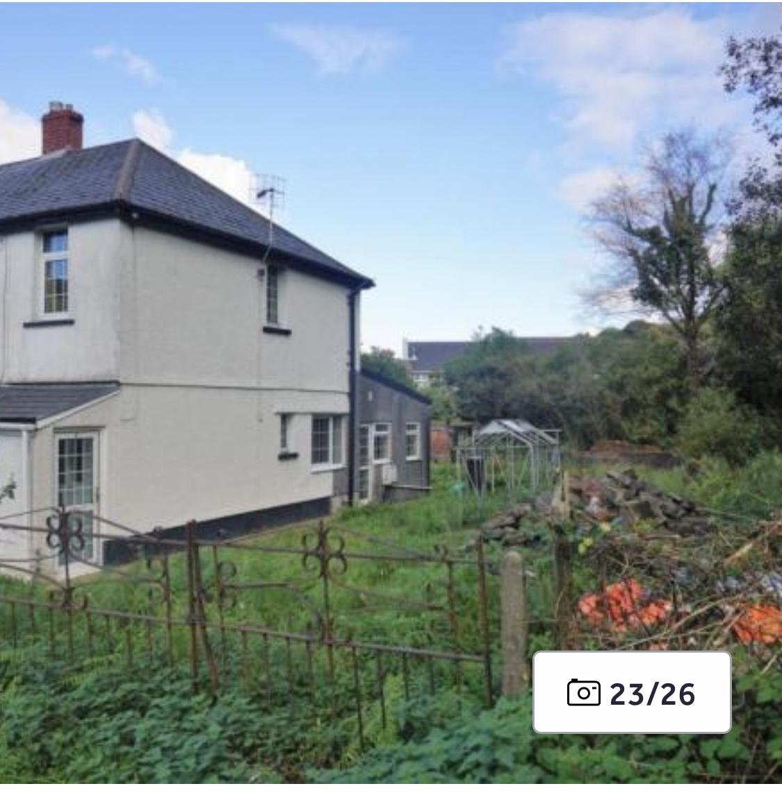

  9. Filmed on a iPhone and uploaded from photo album, I agree there’s potential for another house, but that doesn’t suit our needs. A decent sized 3/4 bedroom with large driveway, 3 car drive, carport, garage and garden is the Long term plan and given I paid less than 150 for it regardless of standard I’ll never lose out.....maybe a stupid question, but how would a builder join a extension on the side of that house? I envisage a valley of sorts between roofs, rather than tie into existing roof? Or am I way off?
  10. It’s definitely big enough Rusell, roughly 1/3 of an acre but there’s a stream on the perimeter which may impact a further plot, but to be honest it’s our ideal location so would rather turn it into our ideal home. popped in later and took this video to show size of garden. Looking forward to getting a machine stuck into it IMG_6266.MOV
