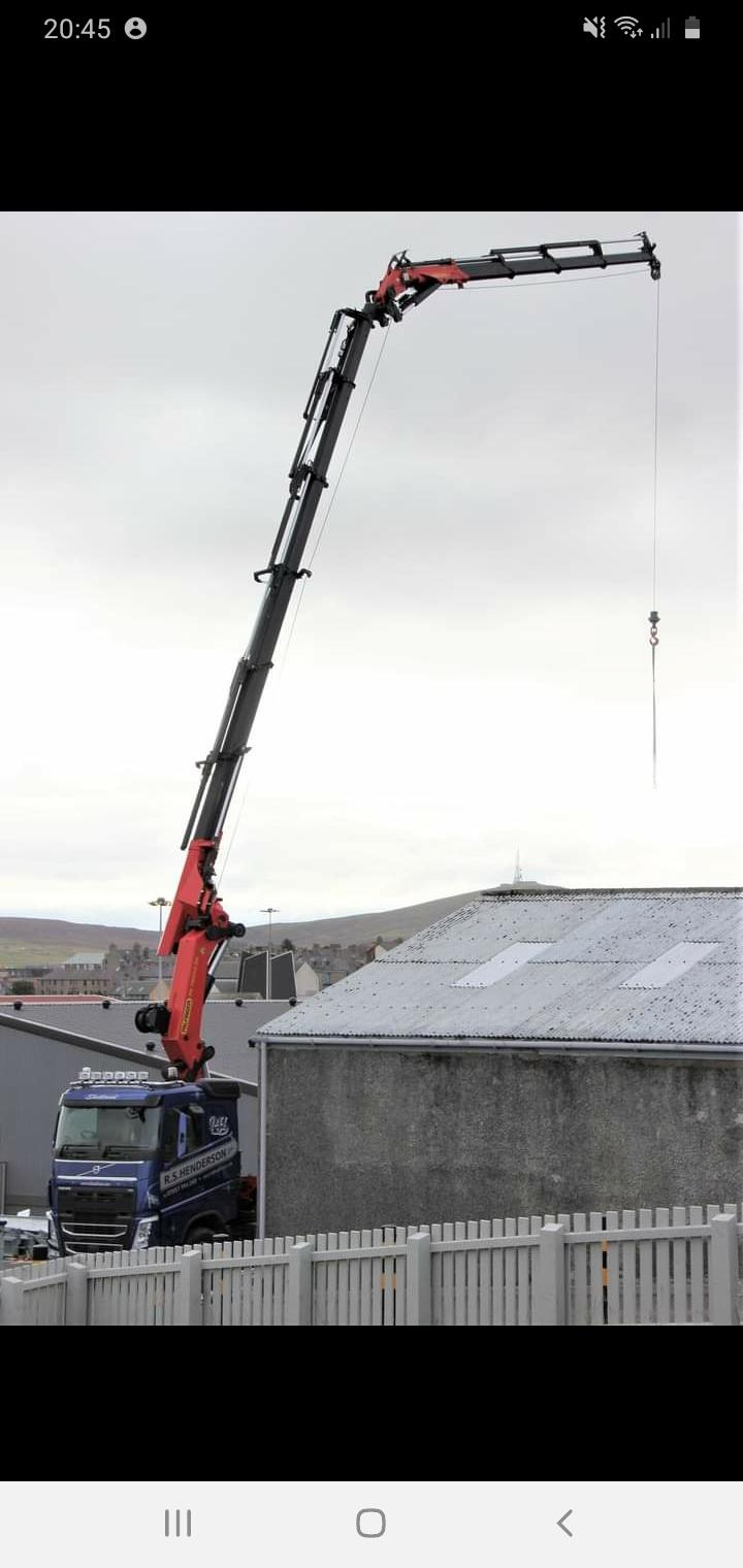

epsilonGreedy Posted September 18, 2020 Share Posted September 18, 2020 I ask because my roof truss carpenter has now decided the 54kg attic trusses are too heavy to lift up to wall plate height. He recommended a local crane hire outfit but their crane sounds like a monster that requires a 6m x 6m hardcore platform and the outriggers create 35 tons of ground pressure which sounds doubtful to me to swing a 54kg load. Link to comment Share on other sites More sharing options...

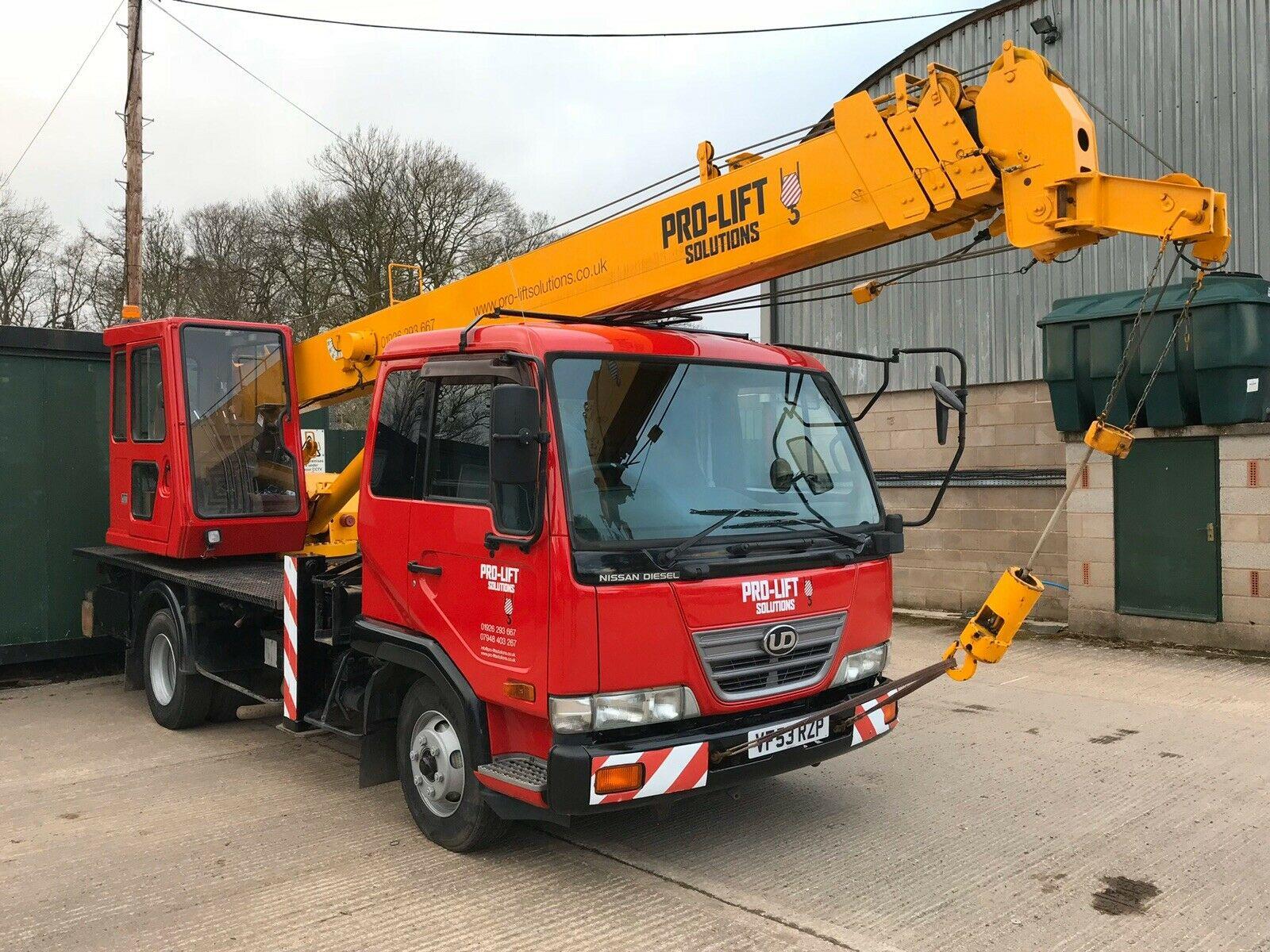

epsilonGreedy Posted September 18, 2020 Author Share Posted September 18, 2020 Maybe something like this? Link to comment Share on other sites More sharing options...

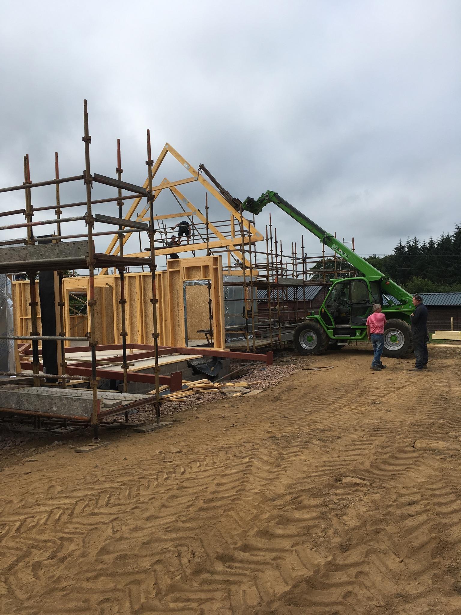

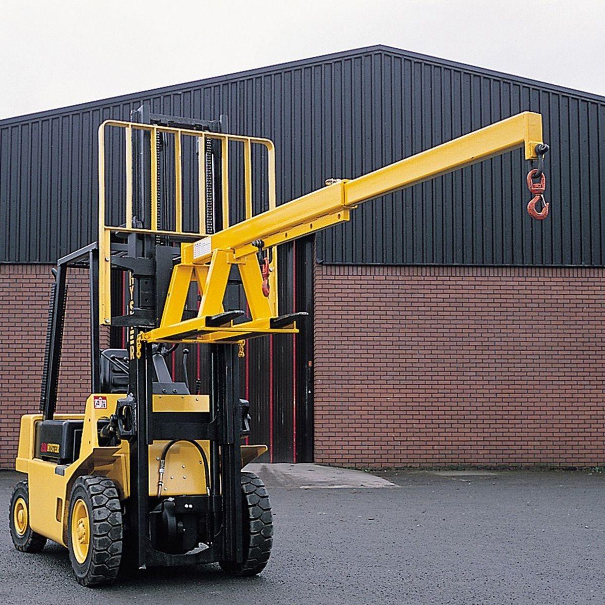

epsilonGreedy Posted September 18, 2020 Author Share Posted September 18, 2020 (edited) Or this? The trusses are 6.5m wide and 1.9m high. Ground to top rail of the scaffolding is 6m. Edited September 18, 2020 by epsilonGreedy Link to comment Share on other sites More sharing options...

Pm1987 Posted September 18, 2020 Share Posted September 18, 2020 Could be a hi-ab but all seems a bit excessive for 54kg. Link to comment Share on other sites More sharing options...
Ferdinand Posted September 18, 2020 Share Posted September 18, 2020 Telehandler or Digger with lifting arm? Link to comment Share on other sites More sharing options...
ProDave Posted September 18, 2020 Share Posted September 18, 2020 We used a digger with a lifting boom attachment Link to comment Share on other sites More sharing options...

nod Posted September 18, 2020 Share Posted September 18, 2020 31 minutes ago, epsilonGreedy said: I ask because my roof truss carpenter has now decided the 54kg attic trusses are too heavy to lift up to wall plate height. He recommended a local crane hire outfit but their crane sounds like a monster that requires a 6m x 6m hardcore platform and the outriggers create 35 tons of ground pressure which sounds doubtful to me to swing a 54kg load. While it’s part of regs on uk building sites You can handball most trusses Ours where over 12 mtre span 5 of us lifted them onto the wallplate and three of us put them together the following day without to much trouble A crane with outriggers will require four plates supplied by you You can get a flat bed with a crane attached that will work out cheaper Paying for an extra pair of hands for a couple of hours may be the better option Link to comment Share on other sites More sharing options...

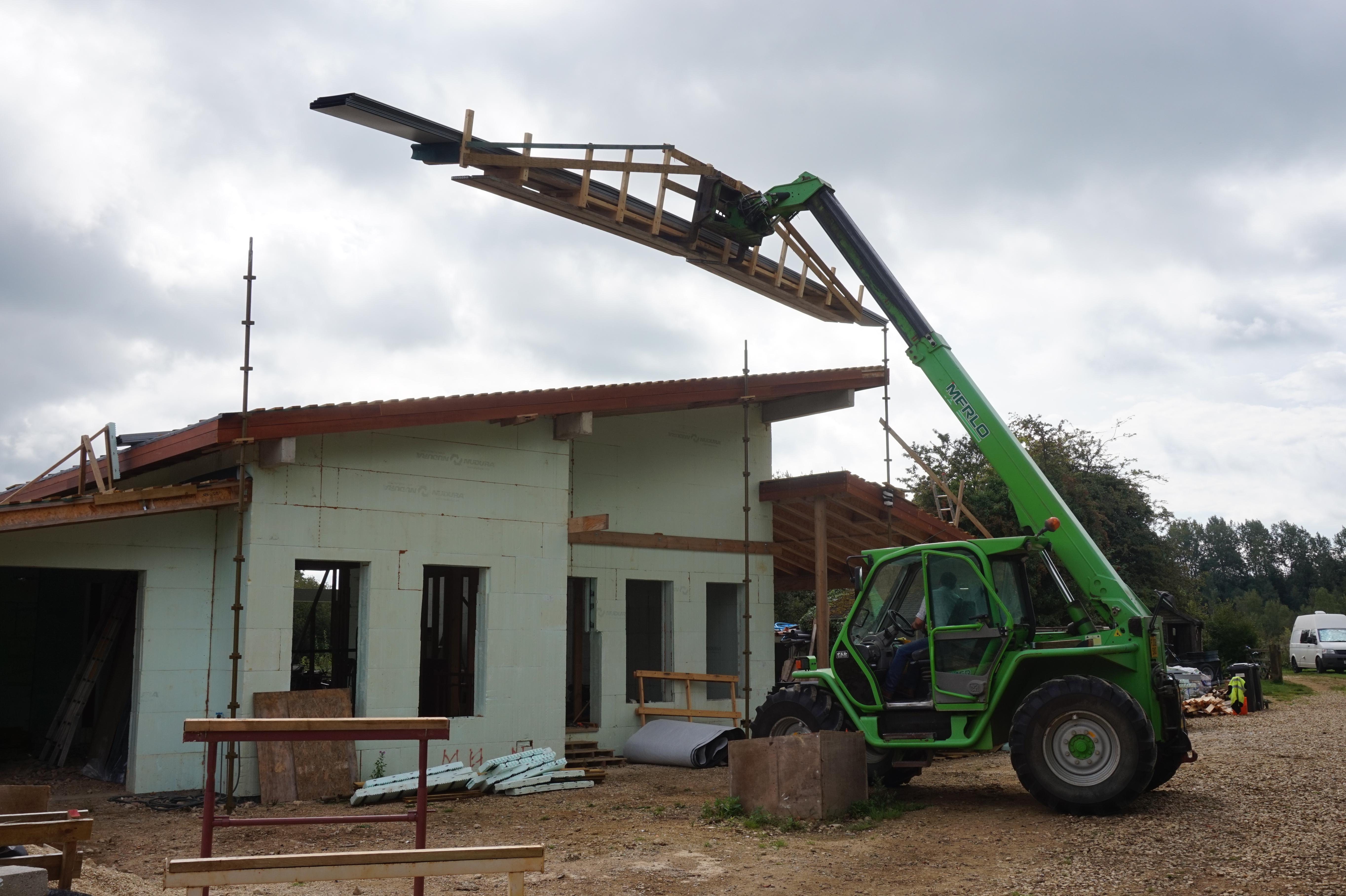

Russell griffiths Posted September 18, 2020 Share Posted September 18, 2020 Tele handler and a friendly farmer £150 should see them all up there. Link to comment Share on other sites More sharing options...

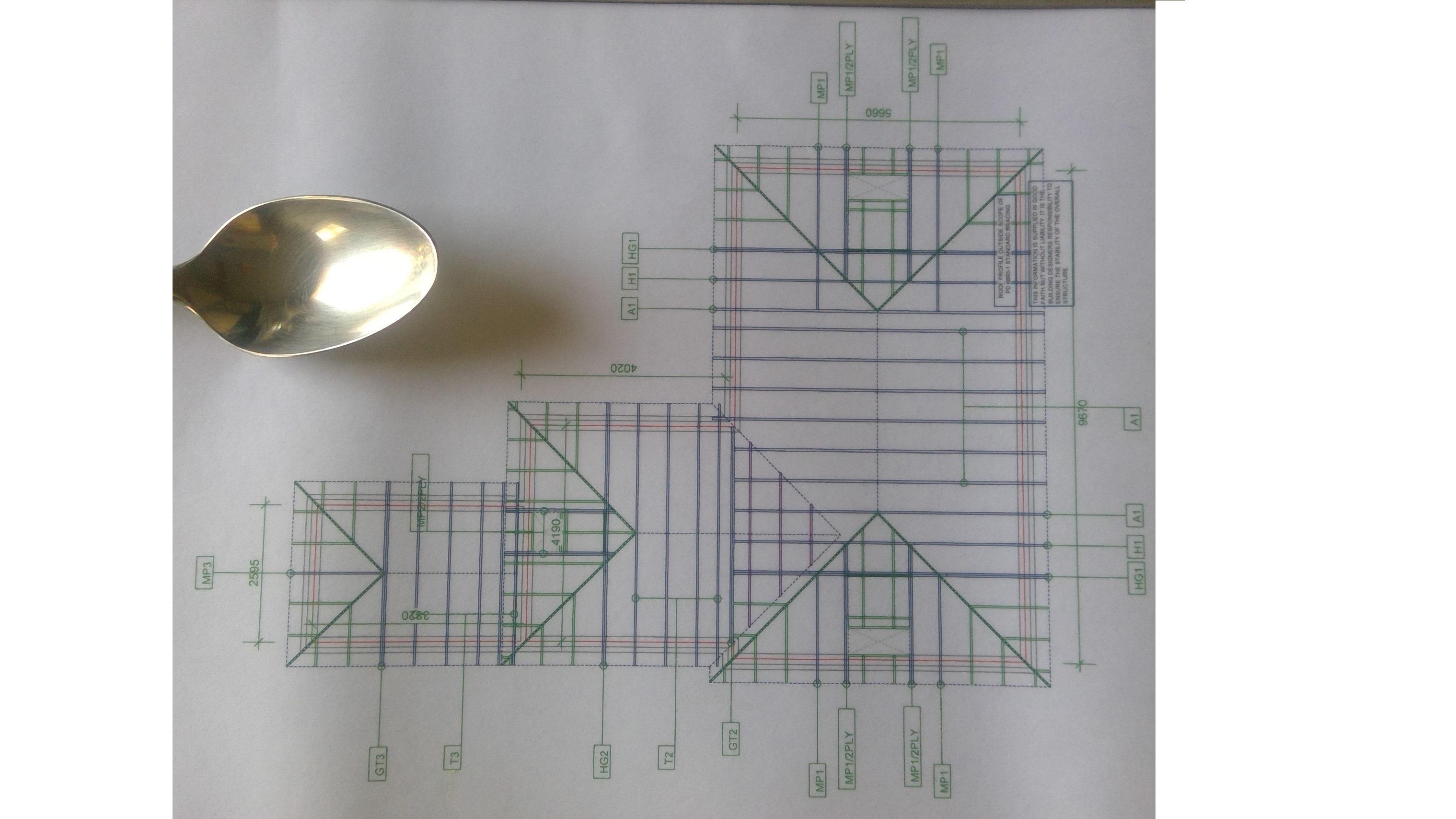

Oz07 Posted September 18, 2020 Share Posted September 18, 2020 @epsilonGreedy I've handballed them up loads before but when they're attic trusses and top heavy sometimes its more aggro than its worth. If you paying your guy/s on a day rate then sometimes its penny wise pound foolish. Do you have a photo or plan of the top floor layout? Do you have anywhere you could shoot a young man over the plates with a middle wall or tower scaff? Link to comment Share on other sites More sharing options...

epsilonGreedy Posted September 18, 2020 Author Share Posted September 18, 2020 25 minutes ago, Oz07 said: @epsilonGreedy I've handballed them up loads before but when they're attic trusses and top heavy sometimes its more aggro than its worth. If you paying your guy/s on a day rate then sometimes its penny wise pound foolish. The carpenter persuaded me with this logic yesterday and I agreed to the crane hire. His estimate of £250 for a half day hire from an outfit based 30 minutes away was actually £350 plus VAT, then as the crane hire company discussed site access from a country lane and the requirement for a solid base formed from 6m x 6m of hardcore I concluded I was being offered a monster crane capable of swinging a 1 ton load right over my house. I need something smaller that can lift a 0.056 ton truss just over the 3rd lift scaffolding. 25 minutes ago, Oz07 said: Do you have a photo or plan of the top floor layout? Do you have anywhere you could shoot a young man over the plates with a middle wall or tower scaff? There are no internal walls at the moment. In the diagram below the smallest rectangle is the single story utility wing and the heavy attic trusses are just 8 in total labelled A1 supporting the main 5m ridge. Most of the other full span trusses weigh between 23kg and 35kg. Link to comment Share on other sites More sharing options...

epsilonGreedy Posted September 18, 2020 Author Share Posted September 18, 2020 (edited) 41 minutes ago, Declan52 said: Is it a single storey or two storey house?? ... Two storey a bit more difficult and you would need at least another pair of hands plus scaffold. A two story house and the ground is low at the best position for a manual lift hence a 6.2m lift to clear the top guard rail of the scaffolding. Edited September 18, 2020 by epsilonGreedy Link to comment Share on other sites More sharing options...
epsilonGreedy Posted September 18, 2020 Author Share Posted September 18, 2020 2 hours ago, Russell griffiths said: Tele handler and a friendly farmer £150 should see them all up there. Thanks I will investigate this option. A farmer was happy to visit and lift 1.3 ton brick packs upto 2nd lift, just not sure how much further the telehandler jib can go. Link to comment Share on other sites More sharing options...
Oz07 Posted September 18, 2020 Share Posted September 18, 2020 Ring round your hire shops and see what the longest youngman you can rustle up is then if you can get the trusses up placing them will be easy. Looks at be around 5600 overall on your placn so 5400 young man should span plates. Link to comment Share on other sites More sharing options...
Oz07 Posted September 18, 2020 Share Posted September 18, 2020 Also when are they being delivered? a good drink in the drivers pocket could get the heavier ones up on the scaff Link to comment Share on other sites More sharing options...
Oz07 Posted September 18, 2020 Share Posted September 18, 2020 Those 2 doubles either side of the hip wont be light either, they will already be fixed together Link to comment Share on other sites More sharing options...

Hobbiniho Posted September 18, 2020 Share Posted September 18, 2020 You should be able to lift 6m high with a "hiab" crane truck, you would be amazed at the height that some of them can lift to, theres a company local to me that have just got a new truck ? Link to comment Share on other sites More sharing options...
PeterW Posted September 18, 2020 Share Posted September 18, 2020 Telehandler will do that easily. A 10m will be fine as it will get over the scaffold. A 7m will struggle. If he really insists on a crane then an iron fairy will do that without a problem - that’s a truck mount crane with a 10m boom. Link to comment Share on other sites More sharing options...
