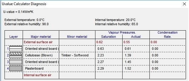

How does the warmcell work? Is it a Timberframe structure with OSB or similar holding it in place?
i have been in few timberframe houses and you could hear cars driving outside. I have asked below, how do you deal
With overheating in well insulated TF properties?

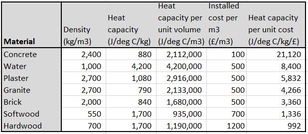

Overheating in a PH is usually due to solar gain (sun heating the house) this is either through  the windows. Whereby you would add overhangs and a brise soleil. Or decrement delay (the time is takes heat to pass through your walls) not being sufficient. Which can both be bad if you have a house thats full of insulation. It's about getting the balance right.
For thermal mass..its about how long you can retain heat in material.
