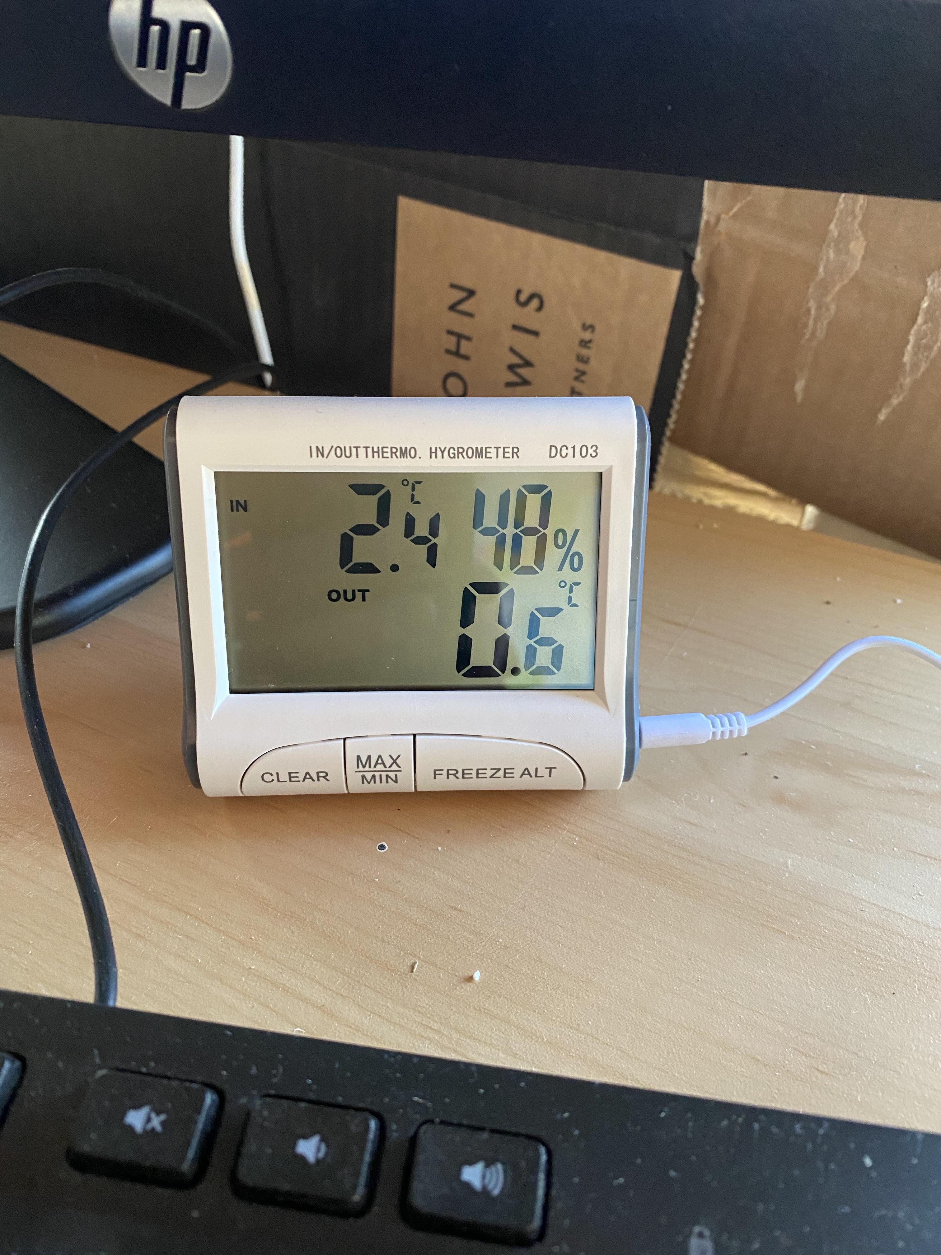

ToughButterCup Posted January 23, 2021 Posted January 23, 2021 Come on @zoothorn, we're all desperate for the next post. @pocster' s sober, @Declan52 has finished his breakfast of gravel and eggs, @wozza has finished gawping at nubiles , @joe90 has undone his zipper, and @Onoff is doing a war dance. How cold is it... really really cold, or just cool? 4
Gav_P Posted January 23, 2021 Posted January 23, 2021 19 minutes ago, ToughButterCup said: How cold is it... really really cold, or just cool? This my office this morning. Anything more than this is hot! 1
zoothorn Posted January 23, 2021 Author Posted January 23, 2021 11 hours ago, PeterW said: OK so that’s improving. Did you finish the insulation in the attic ..?? It takes a while to heat the fabric of a building through so it may be getting better. No waiting to buy flowerpots! Daftly small clay pots holding up putting in 3 x more rolls. Shops closed etc. Should get new room door on today tho! see if this helps contain better heat. I can get it to 18* max by 4 pm in new top bedroom.. just warm enough, comfortable even. most of day its around 16.5*. What Ive thought but not asked, is if its been on during day, desired 18.5 & its got thermostat room up to temp (about 11am earliest) then all ok like so for a few hrs.. if I then put in desired 22*, next day same time I put in 30*: would it put in a different flow temp to try getting these different figs, or no, same flow temp.. but increaces the duration on for: less time for 22* alot longer for 30*? You see Im confused by the Rhs udder pipe temps ( just touched LHS pair/ dhw/ cold tho) i got 44* or so y'day, mostly tho i got 35* or so reading these 4 x y'day.. today now ( expect it chugging along well trying 1st thing, get my new top room up from 13*.. so its 15* at the mo) it's only 32* at RHS udders. My desired = 22* at the mo. So i just whacked in 30* ( max) for desired, see if flow temp goes up. Now I read udders 5 mins later.. 26*: now whether it goes off - then into a new gear, max gear perhaps- then ramps up again, so this dip is usual.. i dont know, but it confuses my udder readings.THX ZH

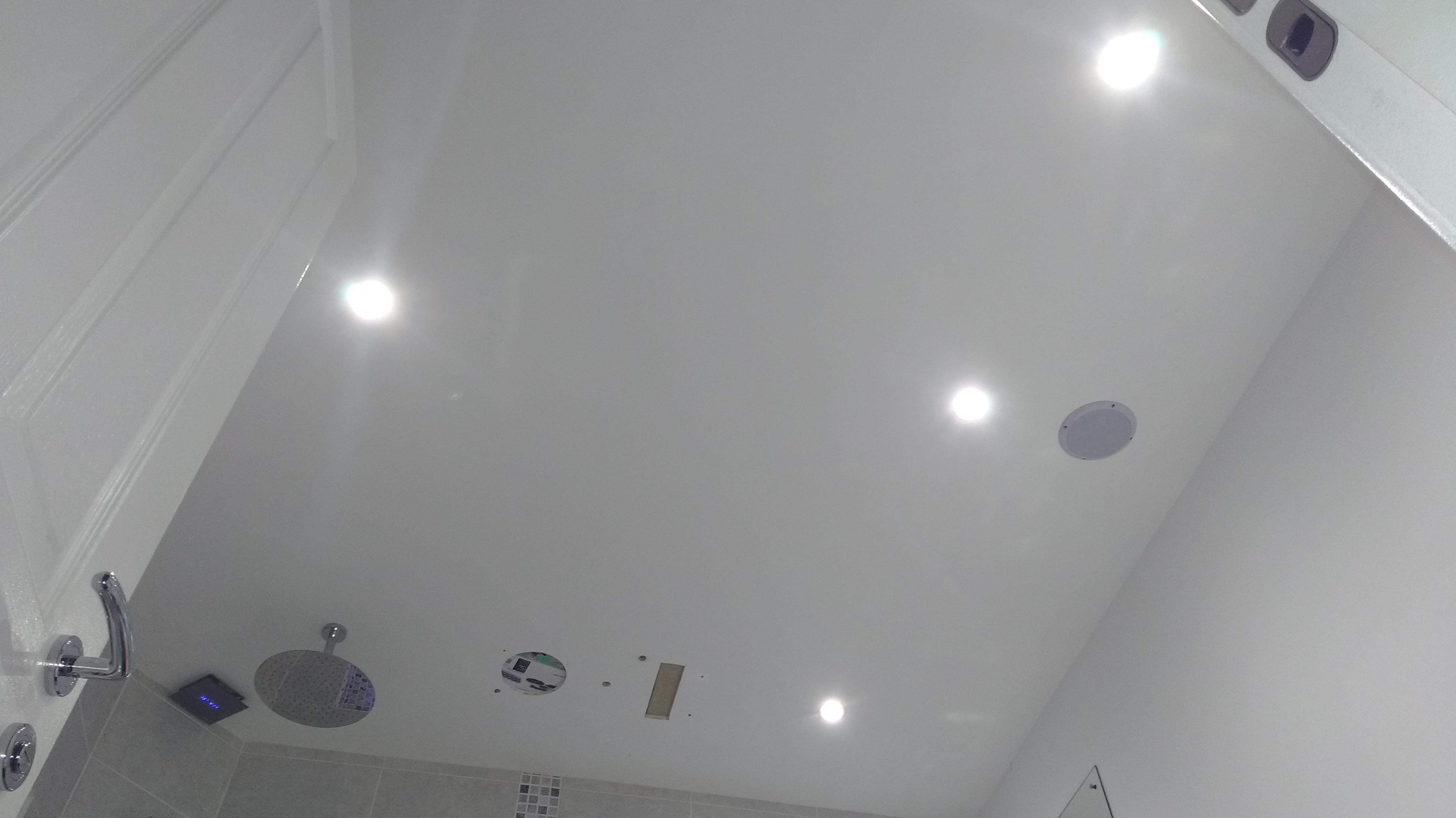

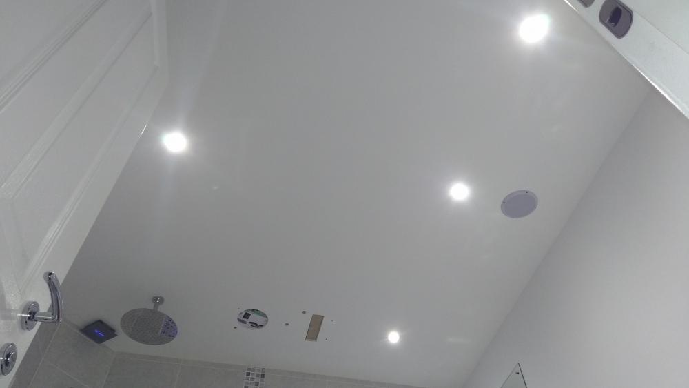

Onoff Posted January 23, 2021 Posted January 23, 2021 When I punctured my new bathroom ceiling that had a continuous, airtight vcl and 100mm of pir above, my heat losses went through the roof - pun intended. This aside from the draught issues created. The one that really brought home to me what this air tightness is all about was the old soil pipe hole through the wall. I cut a round of lightweight block and foamed it in. Even like that below I could still feel a draught coming in from the wall cavity! You think expanding foam is this magic, fix all, wonderful stuff but it needs to be done properly. You then still have the porosity of the surrounding brick / blockwork. I remember being amazed at the force of the draught on this North facing wall coming through the tiny holes. In the end I I had to dig the foam out a little and fill the recess with Fischer chemical resin. What I'm getting at is the hard learnt lesson of "fabric first". Insulate and draught proof to keep that precious heat from escaping and nasty cold from coming in!
