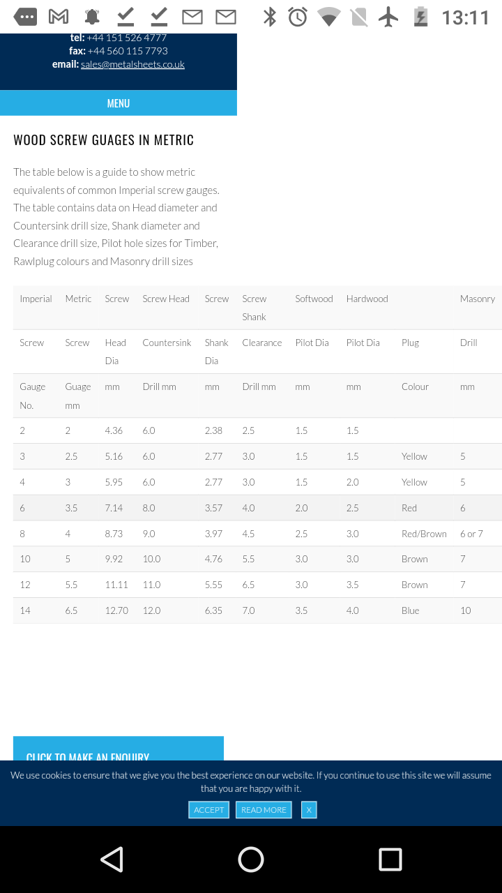

Yes my hinges like your oldy one, countersinks will indeed be on the back. So its roundhead screws, understood, but size: usually with hinges they come with/ not these/ bargain bucket jewsons 39p! So I need screws.
Ok the hinge holes are 6mm, 9mm across including the countersink bit. I bought (38mm) x 4mm dia black c'sunk jobs (for the door face side, 45mm door total: ledge + t&g door).. but not happy/ their shafts don't seem wide enough to me, or the heads wide enough either 7mm.
When I hung my bathroom door, conventional hinges, screws seemed to be very-good fit to the holes, I assume so no chance the door weight will pull hinge down a few mm's. So I must be sure of all these screws: my door is heavy.

Rails = ledges yes, the x3 horizontal members.
4mm screws are no use. You need No.12s probably.
Table below has nominal sizes and shank diameters.
Don't forget you measure a countersunk screw along its whole length, a roundhead you measure under the head to the pointy tip.
You don't want to punch out the other side of your ledge. 1 3/4" is 44.45mm. Plus the hinge thickness you should just be ok with a No12 X 1 3/4 long countersunk screw. You can always nip a bit of the screw point off with a hacksaw etc.
Check head dia on a No.12.

@Onoff apprecite that info: getting the buggers is nigh on impossible tho. 12 x 1-1/2. Or 5.5mm x 38mm.
I can only get no.10 black pan head for the frame-side hinges, but can't find any black countersunk no.10 or 12 for the door side. I must have black.. others will look awful. Huge pain this- taken 2 weeks so far 3x attempts on screws. I have my 4mm ones: will these defo not be any good?
I guess this is why hinges were 39p!

If you want to use 4mm go for it, I wouldn't as I've said. Likely nor would others on here!
No. 12 X 1 1/2" should do. Just don't over size any pilot hole.
Just get it on with whatever chunky screws you have and swap out later. 6mm black coach screws with a square head would look good...
If not black the use a black permanent marker. Clean and give the screw heads a going over with the pen. Let dry, repeat. Touch up once in place.
