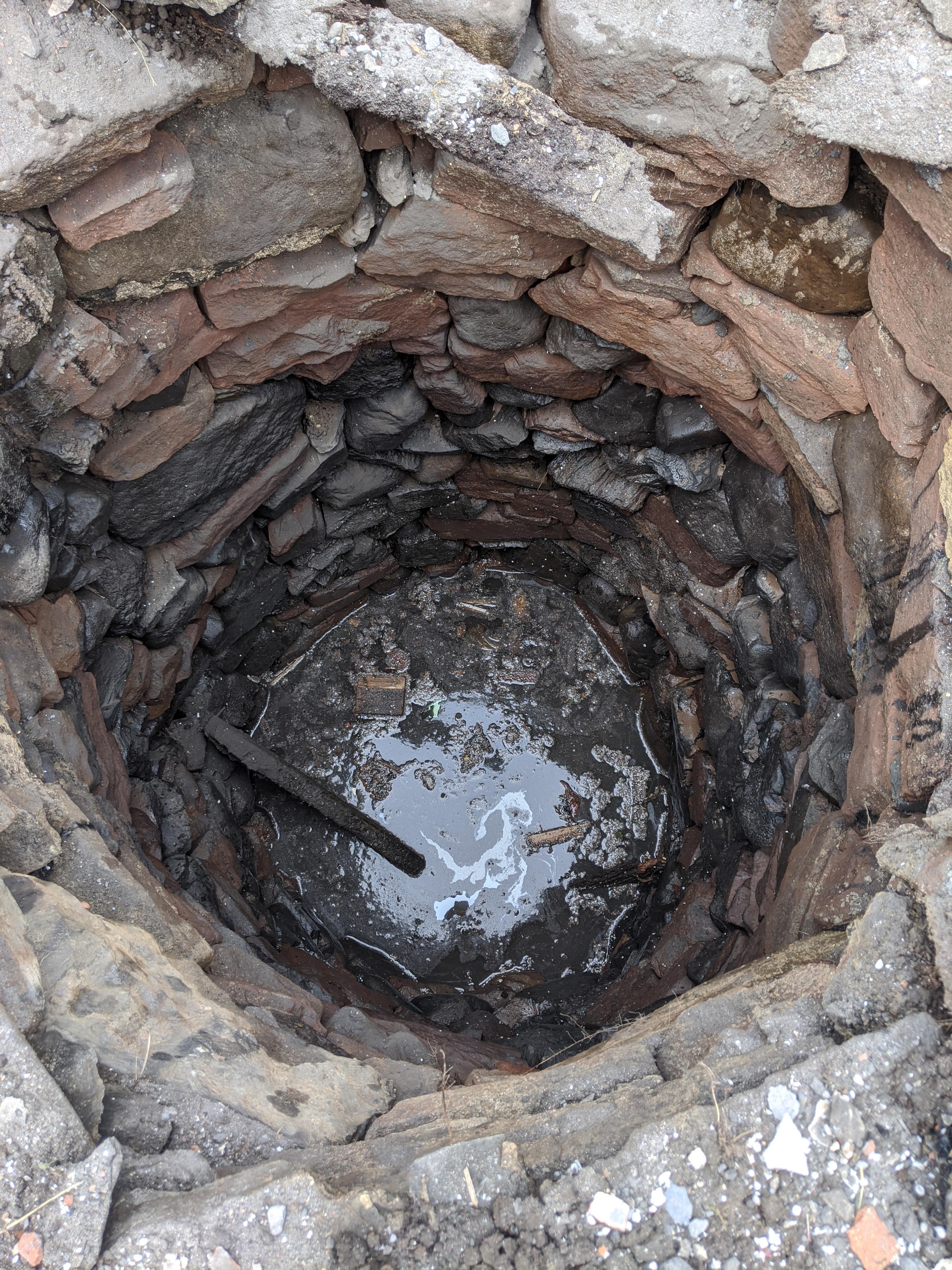

Conor Posted June 18, 2020 Share Posted June 18, 2020 Oh fiddle sticks. Right where the rear wall of the house will be. literally transecting it. Who the hell builds a house over a well??!!! 1.5m across, 5m+ deep. Loose sandstone construction. Any advice welcome.... or just laugh at me Engineer says fill it right up to slab level with lean mix concrete. Any cheaper options?! Link to comment Share on other sites More sharing options...

Dreadnaught Posted June 18, 2020 Share Posted June 18, 2020 Find someone with soil muck-away nearby and offer to take it free-of-charge (delivered)? It could save them the disposal cost. Link to comment Share on other sites More sharing options...

PeterW Posted June 18, 2020 Share Posted June 18, 2020 Needs digging out as it needs to have water in rather than mud... but got to say it would make a brilliant feature with some lights in it and walk over glazing..! 1 Link to comment Share on other sites More sharing options...

Triassic Posted June 18, 2020 Share Posted June 18, 2020 We did one at work. Back filled with 100 stone and every 500mm fill the void spaces with Cement grout. Once stabilised old mine workings Using the same technique. Link to comment Share on other sites More sharing options...
Russell griffiths Posted June 18, 2020 Share Posted June 18, 2020 You can get a product called flowable fill, it is a lean concrete mix, just back the truck up and fill it up. £400 you didn’t want to spend but hey ho life’s a bitch. Link to comment Share on other sites More sharing options...

Conor Posted May 21, 2021 Author Share Posted May 21, 2021 @Barryscotland as it was dry(ISH) we just filled it with a few cubes of lean mix concrete. In the end, the engineer wasn't satisfied and we ended up having to construct a 3000mm long, 600mm deep and 1200mm wide ground beam with 20mm rebar cage to span it. If yours is hydrogeologically linked to a ground water system then you will have to follow the EA best practice for filling wells and boreholes- usually means filling with clean stone to near ground level, then capping with concrete. Speak to your SE. Link to comment Share on other sites More sharing options...
