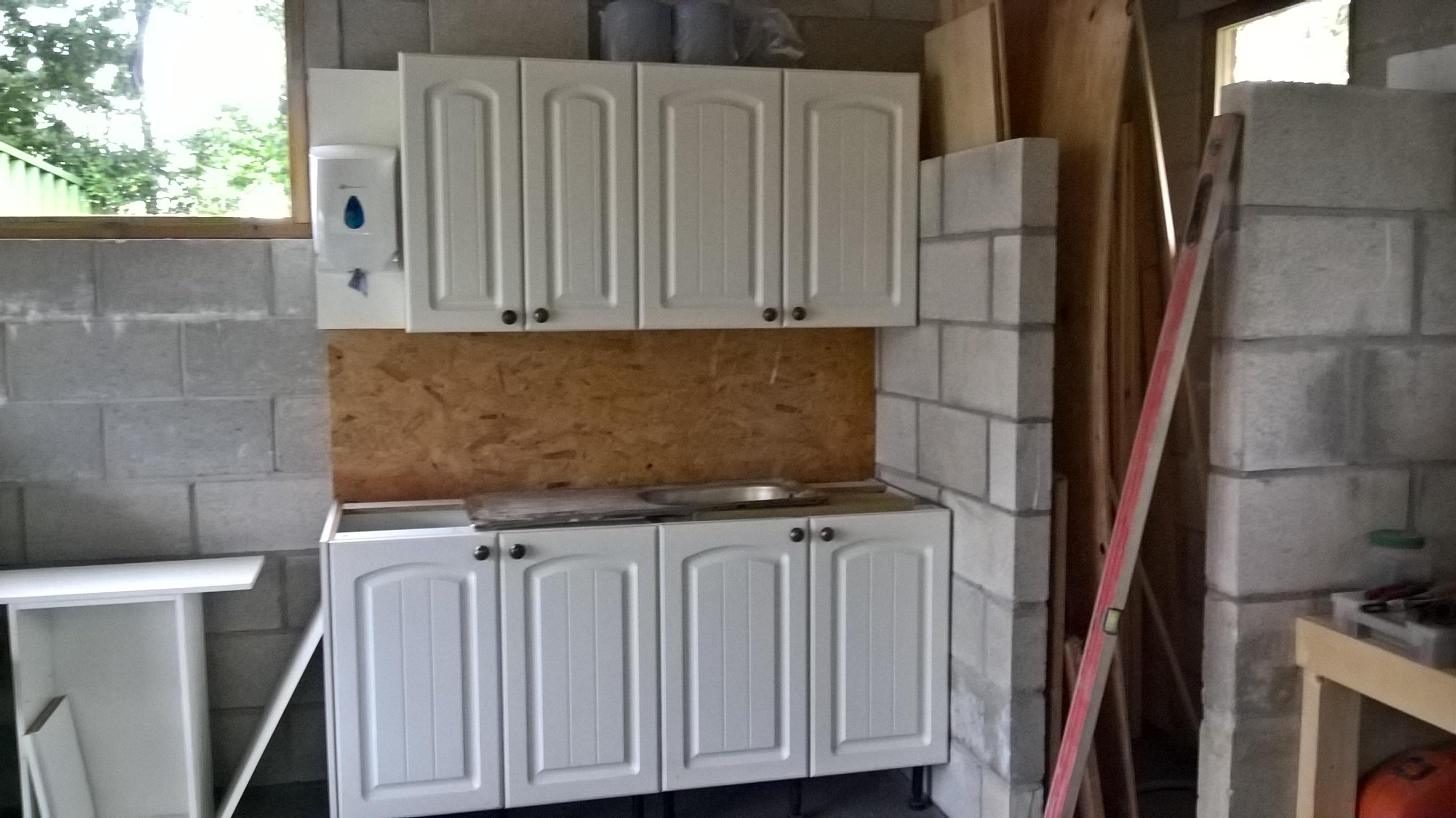

May 12, 20206 yr 36 minutes ago, MortarThePoint said: We're going to be pouring the raft for our garage/workshop in a couple of weeks. It's a real treat for me to have this space and part of the reason why we are doing the whole selfbuild thing. It's my last chance to think of some of the details to add and I thought I would ask people to fantasise a bit. They can be simple details (e.g. I am thinking of asking them to cast in anchors near the door pillars for pulley winches) to that 'if only I could' thing (e.g. I'd love a car lift but that's not on the list unfortunately). Sink with hot and cold water, maybe even a loo! Floor drain may be a good one as well.

May 12, 20206 yr I have a sink and toilet (old kitchen units), great to get the oil off yours hands before going indoors. I also have a classic and dreamed of a two post lift but dreams eh,!

May 12, 20206 yr I installed an electric over sink water heater, not really hot but warm enough for washing hands (in winter).
May 12, 20206 yr 2 hours ago, joe90 said: I installed an electric over sink water heater, not really hot but warm enough for washing hands (in winter). Someone's cast-off shower made its way above my garage sink, does the job.
