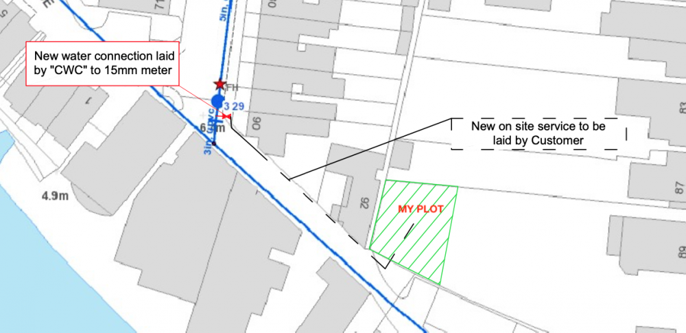

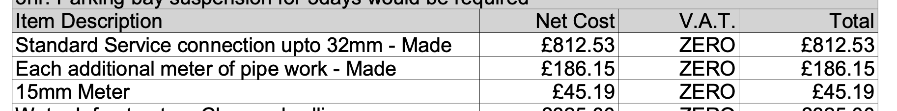

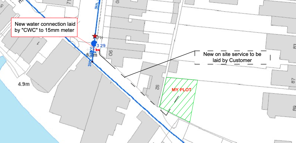

Dreadnaught Posted March 27, 2020 Author Posted March 27, 2020 (edited) @Russell griffiths, thanks again. Yes I have my quote from Anglian Water. Here it is (excluding the infrastructure costs). As they say, its for "approximately 3m x 20mm nbPE (25mm OD) with a 15mm meter connecting on a 5" CI" main pipe. The access-road surface: yes, a concrete surface (opened once already this year for my electric connection by UKPN). I have in mind to use a local digger and driver from a small family-owned groundworks company, with a breaker attachment for his digger. I am hoping he will charge me on a day-rate basis for the work. Here's the "GIS", whatever that is, from Anglian Water. It looks like a map for the work to me. I am proposing to do the black dotted-line section, the bit that says "to be laid by customer" now, before getting Cambridge Water to do their bit in the proper road later, the actual connection. Edited March 27, 2020 by Dreadnaught

Russell griffiths Posted March 27, 2020 Posted March 27, 2020 That makes a bit more sense @Dreadnaught so your meter is going down in the public road end, that will allow a fair bit of play for the connection. I had thought you where going to try and cut your pipe accurately enough to go straight onto the main.

Dreadnaught Posted March 27, 2020 Author Posted March 27, 2020 Thanks @Russell griffiths. Yes, having the meter some 40m from my plot did seem a bit odd, but the water company doesn't seem mind so I guess its OK. Do you think I can proceed as I described, with the pipe capped pipe buried on the road end, or should the pipe be left protruding above ground? At the plot end, I presume I would just leave a coiled pipe of 20m+ above ground until I get the clearance from the council to start work on site and can dig trenches across the plot.
Russell griffiths Posted March 27, 2020 Posted March 27, 2020 As long as you are happy you have enough slack for them to connect you could do either, I would rather leave it visible above ground as long as your happy it’s not a hazard. 1
