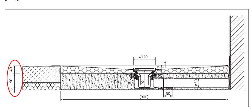

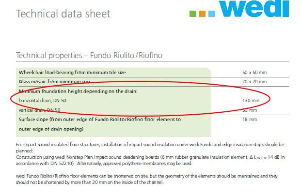

ToughButterCup Posted January 15, 2020 Posted January 15, 2020 Why didn't I think this through earlier? The problem was staring me in the face....... This is the cross section of our slab You can see that the slab is 100mm thick. (Red elipse) It has some 193 mesh in it ... And I had thought I could put this Wedi shower tray in..... until I decided I should maybe add 6+90+40 before I did anything else. So, its 136mm deep overall. This is the document that nudged my brain into something like coherant thought .... Talked to the architect ... stumped as well. I really really wanted a flat floor wetroom. Really. I'm stuffed now aren't I ? As @Russell griffiths puts it so eloquently .... URGH FOOK FOOK FOOK. Learning a new set of skills is bloody painful.
ProDave Posted January 15, 2020 Posted January 15, 2020 So it means you have to cut into the EPS a little bit?
Danny68 Posted January 15, 2020 Posted January 15, 2020 Could you not raise the floor 40mm and put the step at the door threshold, not ideal but..
Construction Channel Posted January 15, 2020 Posted January 15, 2020 33 minutes ago, AnonymousBosch said: Yes Dave, And thats not on. Why not dig even more of the eps out and replace it with celotex? Or raise the floor in the bathroom a bit. (you could lose that with a ramped threshold depending how much you need)
ProDave Posted January 15, 2020 Posted January 15, 2020 2 hours ago, AnonymousBosch said: Yes Dave, And thats not on. Why? As long as you reinstate the DPM that you will have cut to do so.

ProDave Posted January 18, 2020 Posted January 18, 2020 2 hours ago, AnonymousBosch said: Not one to give up easily, I found this .... Level Access showers - the kind of thing that gets put in to bathrooms when the bath needs to be taken out. Does anyone have any experience of using them, or putting one in? Those rely (at least for retro fit) on those horrible half height doors and a shower curtain to keep water out of the rest of the room. I don't see that solves your problem? Your issue is the waste requiring too much depth. either seek out a shallower waste or accept you will have to cut into the EPS a bit. This is the one I used https://www.impeyshowers.com/wetroom-floor-formers/level-dec-easyfit-wetroom-floor-former/ Standard trap needs 97mm below the floor or 119mm from floor level (pre tiling level) They also do a low profile waterless trap that only needs 76mm under the floor / 98mm from floor level (pre tiling) Data sheet here https://www.impeyshowers.com/media/1875/aqua-dec-easyfit-technical-data-sheet.pdf
mvincentd Posted January 18, 2020 Posted January 18, 2020 I fail to see what that Neptune tray gives you avoiding any work that the Wedi involves...either way you've got to cut some concrete out. Your dpm looks to me like its under the first 2 layers of eps so its 300 deep...you won't break the dpm. Why is chopping some eps 'not on'....surely cutting the concrete is the PITA. Where is your shower waste cast through your slab, and what size pipe ....is it in the exact spot you now want the tray waste to be? 1
Temp Posted January 18, 2020 Posted January 18, 2020 How about this... You have 100mm slab and say 12mm for tiles and adhesive making 112mm usable without digging into the EPS. Nearest I can get is a 35mm shower tray with a 75mm McAlpine trap making 110mm. However could/should set the tray 5mm higher than the floor so the door seal doesn't scrape making 105mm in the floor. 105mm < 112mm so it fit with height to spare. You could even consider a 45mm tray.. 45+75-5=115mm. Example Ideal Standard Simplicity. I think the McAlpine trap is rated for 34L/min. It comes with a 45degree bend but you can replace that with a straight connector to help flow rates?

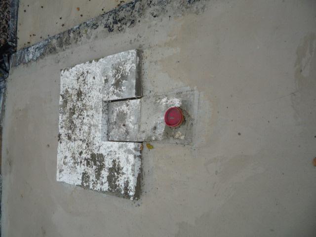

HerbJ Posted January 19, 2020 Posted January 19, 2020 You'll be fine cutting into the EPS for the shower waste. That's exactly what I provided for on my passive slab for a wet room. i did post on this subject on e-build a few years ago but don't have a copy of that post to share. So, i have provided details again I made provision for a wet room in the Ground Floor WC, though at the present, the shower former has not installed and it tiled over. I checked all this with the SE (Hedley Tanner) and the cutout in the foundation slab was formed with EPS before the slab was poured - see attachments. The plan was to install an ACO shower former and the shower drain at some time in the future, when required. We just have to remove the existing tiles and temporary EPS, rearrange the existing posh cloakroom into a wet room and lay a new tile floor with the former and drain . The waste drain will be installed in the top level of the EPS - really no different to the various conduits installed in the EPS for the kitchen island electrics. 1528-01 Foundation Plan- REV A.pdf Eastcroft Aco Wetroom gully 2.pdf 1

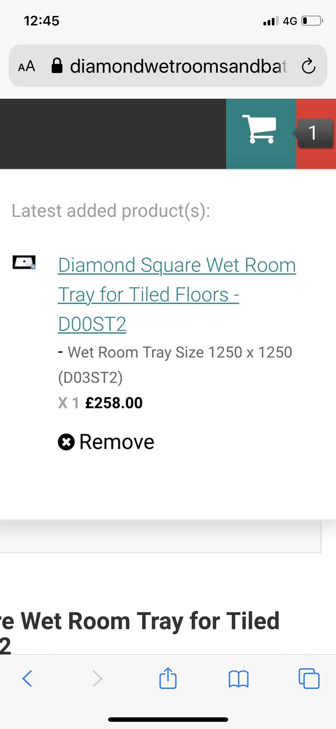

Nickfromwales Posted January 19, 2020 Posted January 19, 2020 @AnonymousBosch I see 900mm as one dimension, what size wet area are you allowing? 900x900 is a very small area if you aren’t intending on fitting a screen / cubicle of any sort. As far as your other woes, I don’t really see this being much of an issue unless there’s something I’m missing..... Diamond Wetrooms do a reasonably priced 900x900 wetroom former which is cheap enough, and GRP so no issue with mosaic ( Wedi products can compress when applying point pressure on small mosaic ) and require little in the way of accuracy of the underlying works as you can bond them down into wet adhesive to set them level prior to fixing down firmly with mechanical fixings. I’d recommend a 1200mm or 1500mm area if you’re going to all this effort. £258 for that 1250 square. Hire a concrete grinder to remove 30mm of existing floor area to accept the perimeter of the tray and happy days. “You can do it, Deeds” ?
