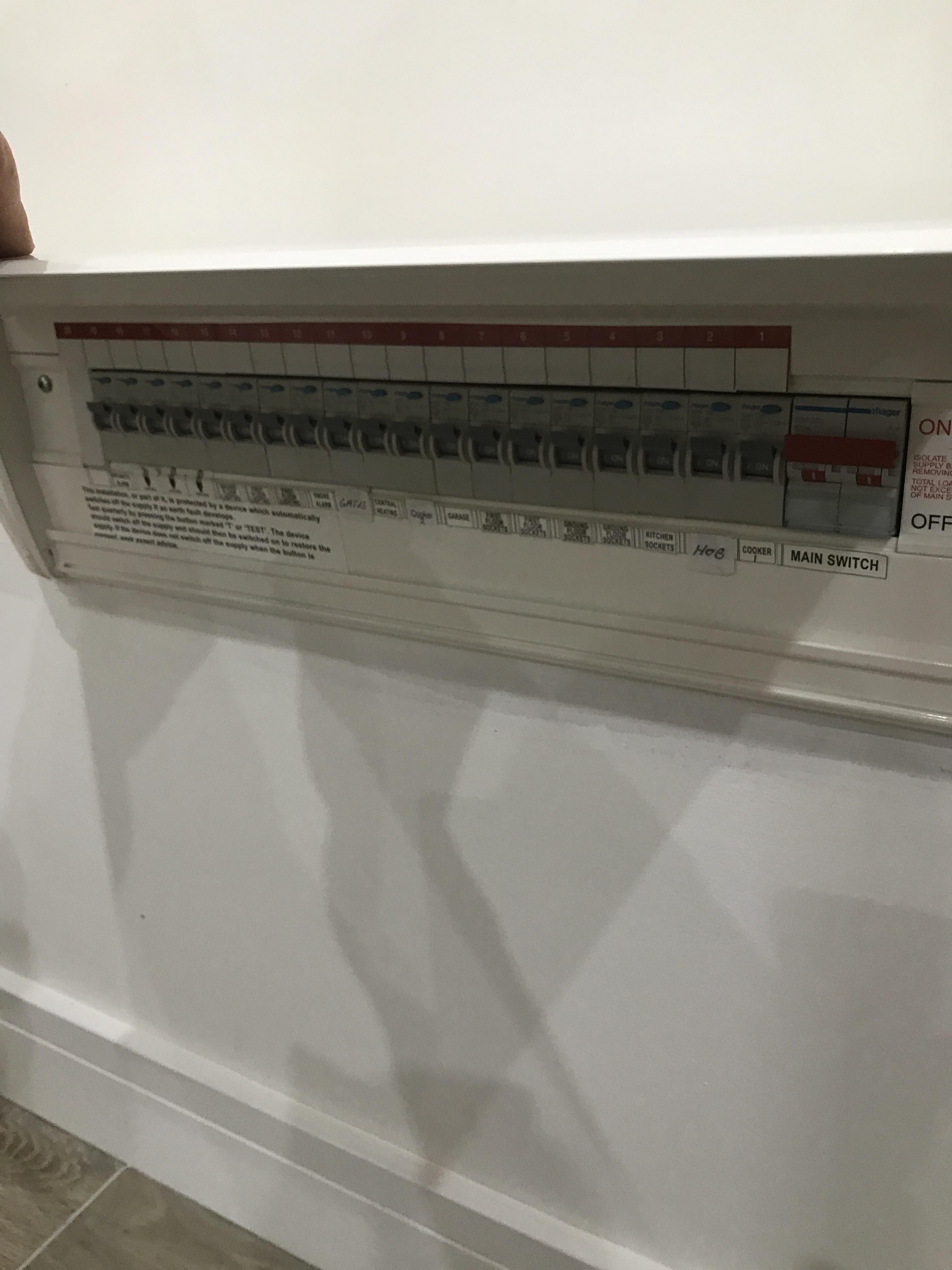

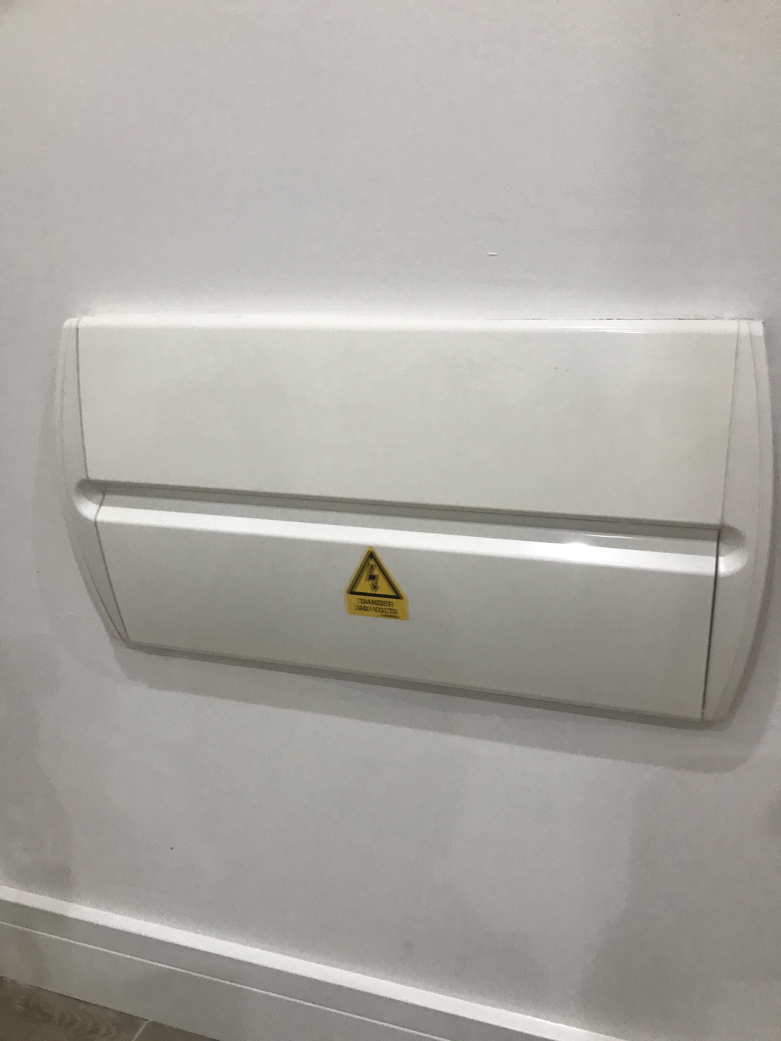

nod Posted December 8, 2019 Posted December 8, 2019 42 minutes ago, ProDave said: I chose Hager. My reason being they are just about the only make that does not keep on changing the look of their circuit breakers, so fit a new one in an old CU and it still fits, something you can't guarantee with the likes of Wylex or MK etc. What you want is a bare "main switch" consumer unit, then just buy all the rcbo's. And it must now be metal but you can't buy anything else anyway. I got all mine from ebay for a better price. Yep You gave me the same advise way back Buy your RCBOs off eBay I needed 20 Found them all online over a period of 6 months It’s surprising how many electricians have a couple over from a job or 1 in there van Most where around ten or twelve quid delivered 1
Onoff Posted December 8, 2019 Posted December 8, 2019 1 minute ago, nod said: Yep You gave me the same advise way back Buy your RCBOs off eBay I needed 20 Found them all online over a period of 6 months It’s surprising how many electricians have a couple over from a job or 1 in there van Most where around ten or twelve quid delivered @AnonymousBosch, what @nod is showing is a "flush" unit. Nice an low profile with the gubbins hidden.

ProDave Posted December 8, 2019 Posted December 8, 2019 I used a standard one, but flush mounted it. Basically the CU screwed to the OSB that made the back of the service void, then the plasterboard cut around it in front of the service void battens, just the right depth for the front to go on. You just have to mae the PB cut out accurate as there is not much overlap of the front to hide any imperfections. Mine was "pre 18th" but is a metal back with just a plastic front.

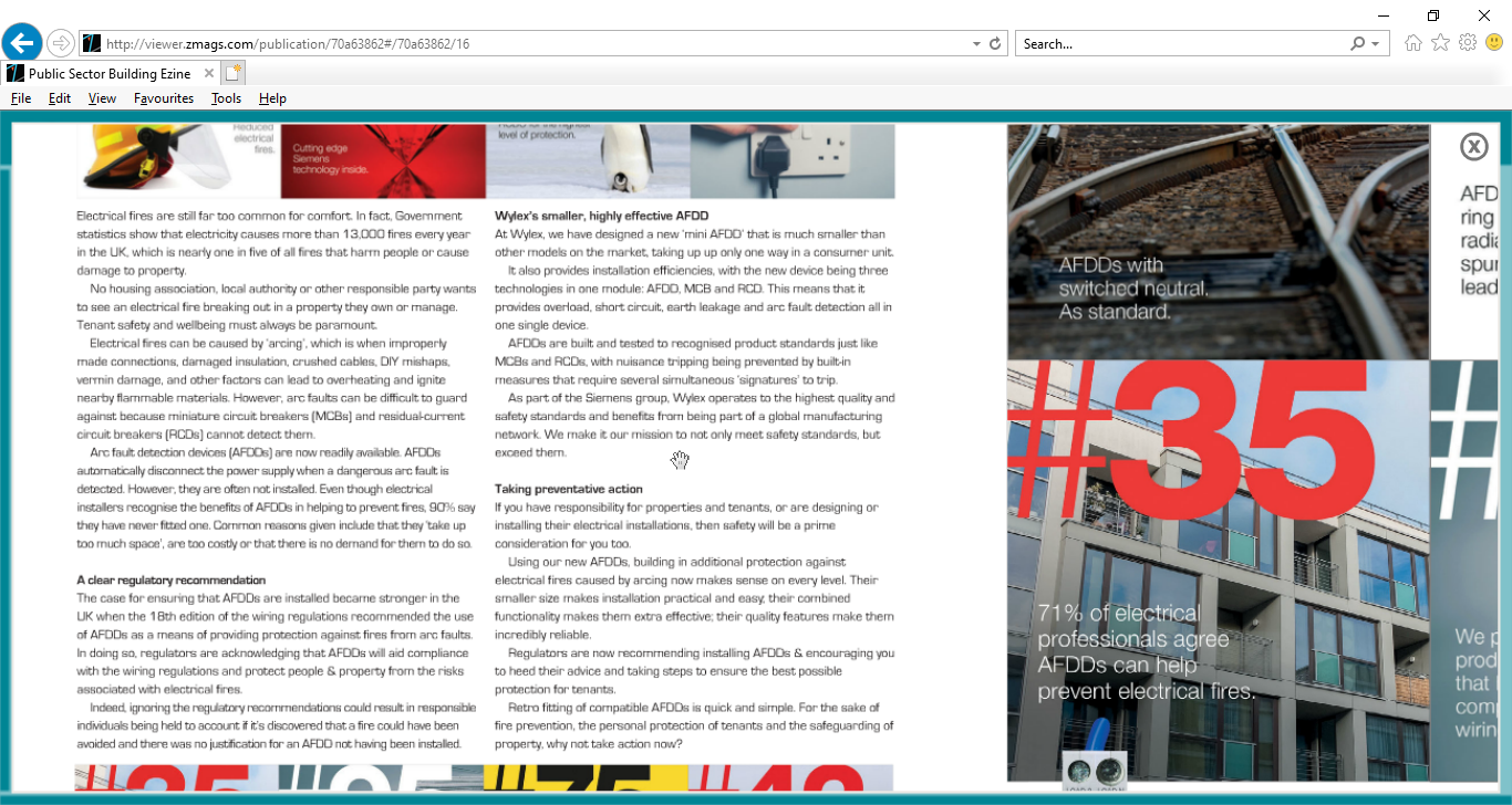

MikeGrahamT21 Posted December 9, 2019 Posted December 9, 2019 (edited) I read an article recently about a new module which is coming in, not mandatory yet, but looked really good: As with most things though, they are rediculously expensive, a full CU will set you back over £1000. They are type B RCBO modules, priced on average around £250 per module! But will give you ultimate protection. Sure prices will come down when they become mandatory, as they will, probably in 19th edition Edited December 9, 2019 by MikeGrahamT21
Nickfromwales Posted December 9, 2019 Posted December 9, 2019 37 minutes ago, MikeGrahamT21 said: I read an article recently about a new module which is coming in, not mandatory yet, but looked really good: As with most things though, they are rediculously expensive, a full CU will set you back over £1000. They are type B RCBO modules, priced on average around £250 per module! But will give you ultimate protection. Sure prices will come down when they become mandatory, as they will, probably in 19th edition £1000 / £250 = 4 RCBO’s then. Plus the CU itself. More like a £2500-£3k CU.

Ed Davies Posted December 9, 2019 Posted December 9, 2019 1 hour ago, MikeGrahamT21 said: I read an article recently about a new module which is coming in, not mandatory yet, but looked really good Maybe. AFDDs have been compulsory for circuits in bedrooms in the US for a while. Whether the arguments for them are valid there and whether they apply here (with higher voltage/lower current supplies and more-robust and fused plugs) is open to question.
