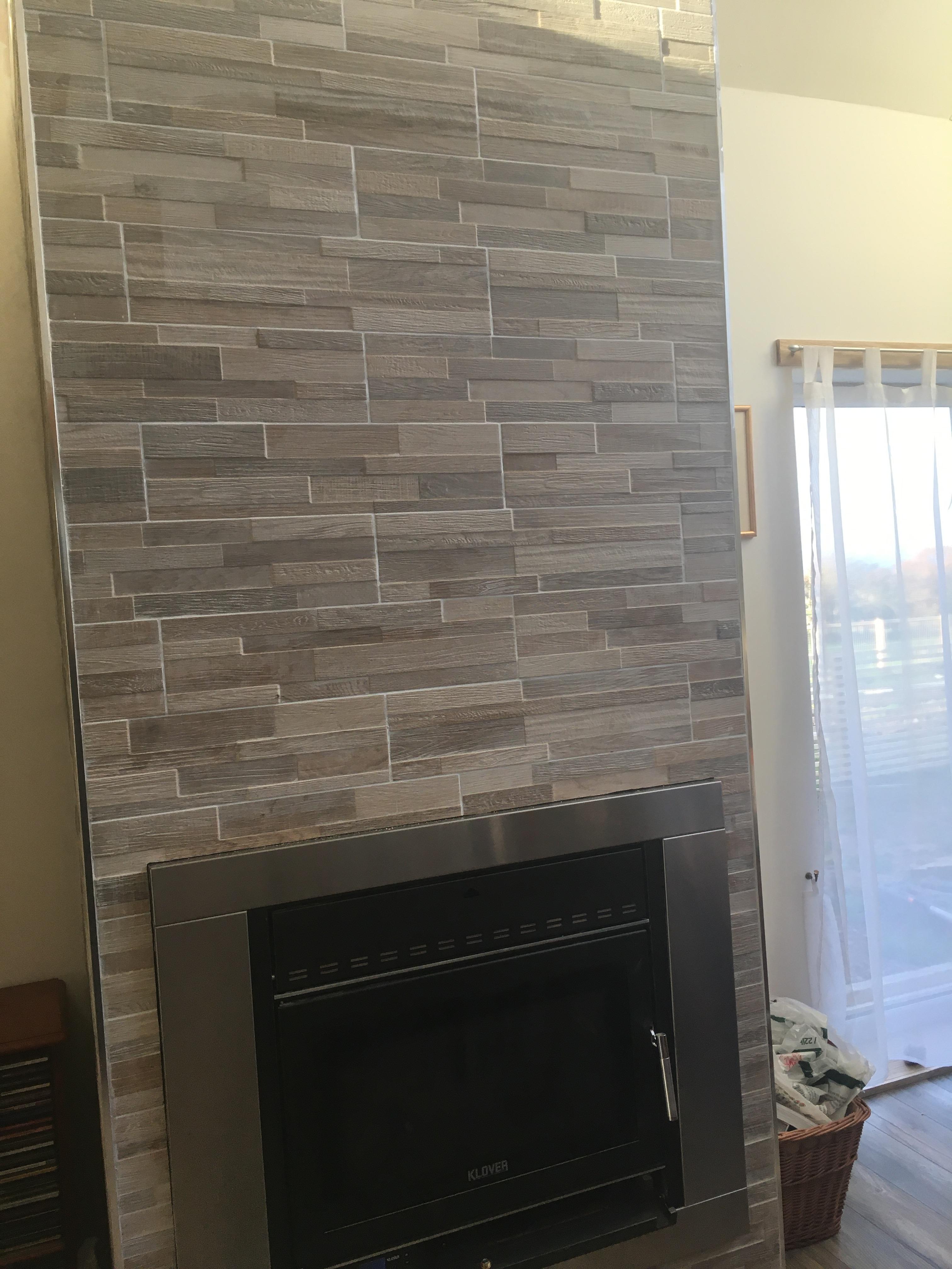

Ferdinand Posted October 24, 2019 Posted October 24, 2019 (edited) 22 hours ago, Triassic said: We want a bit of a different look to our stairwell. We’re thinking steel stairs and a brick wall. As our new build is timber frame, how easy you’ll it be to install brick slips to the interior wall? Are there any cheap options when it comes to brick slips? There are also options now which use textured porcelain tiles to get the effect. If you have larger tiles may be easier to fit. Not unlike a brick version of the "wood" porcelain tiles you get for your floor. Somebody on BH has them and likes them - @Christine Walker maybe (?) Example not recommendation: https://www.tilemountain.co.uk/blog/brick-tiles-exposed-brick-without-the-mess/ Do this properly and you just powerwash it once a year ? . Ferdinand Edited October 24, 2019 by Ferdinand
